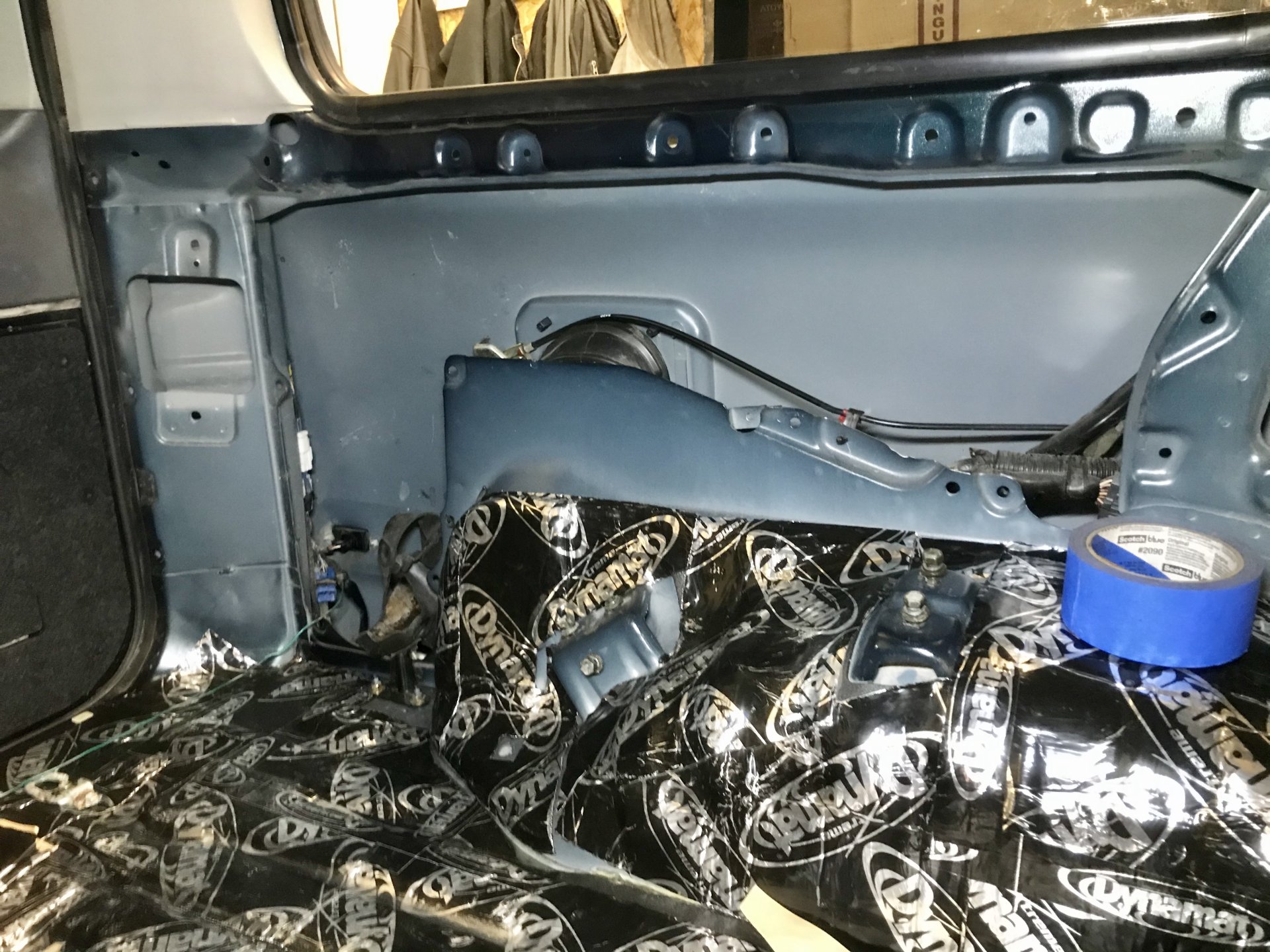

All I have left to do on Dynamat is rear quarters.
This is my LHS rear quarter, after my man Chris worked it with a hammer and dolly for a half hour. I wanted to get the hammer and dolly work done before I lay down the dynamat.

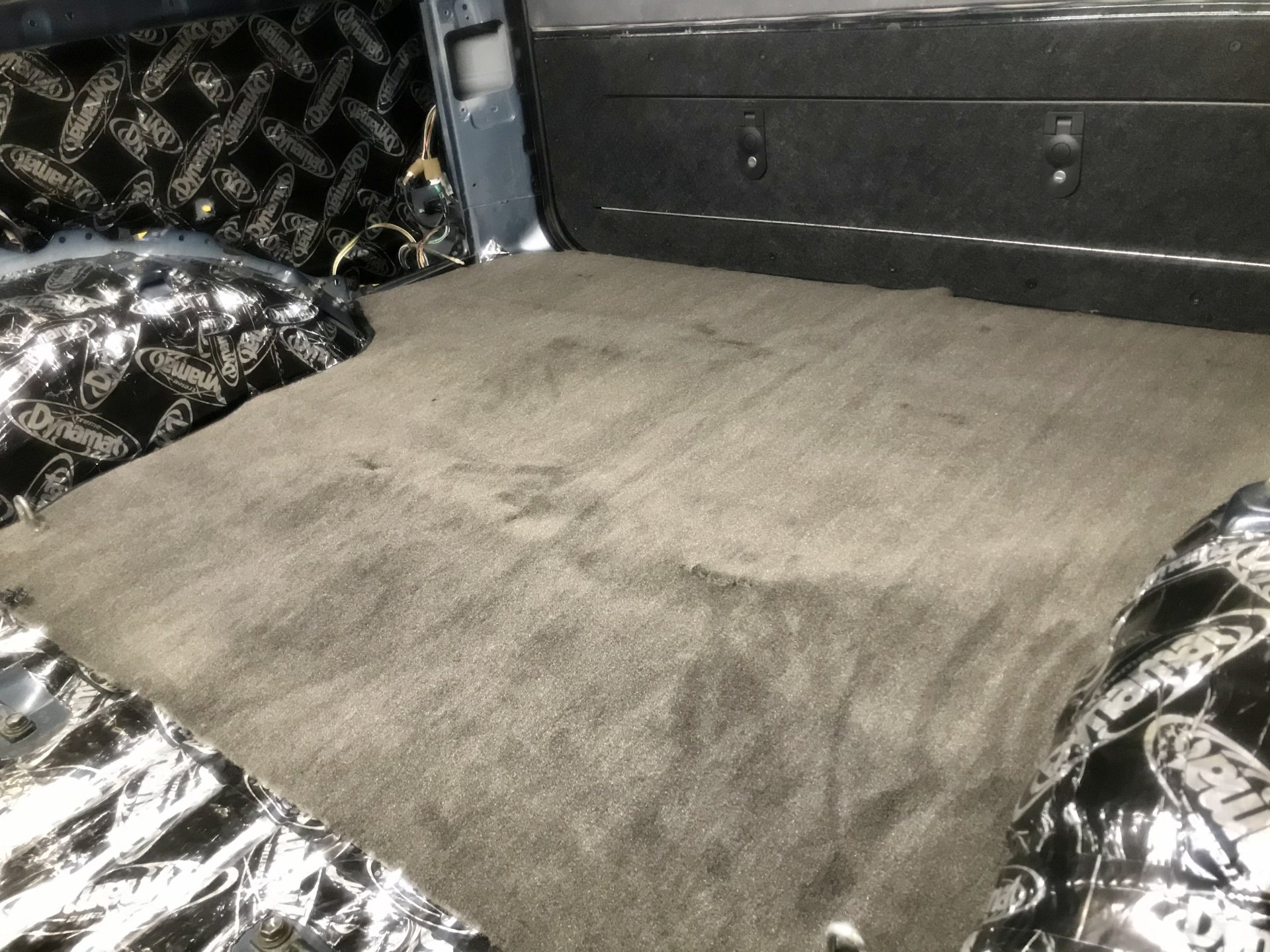

I don’t think I mentioned it yet, I bought myself a new ACC carpet kit on Christmas Eve. 🤗

How do you like the carpet? Any first impressions? I like that your dolling up the interior, make it nice and comfortable in there... you'll enjoy the ride even more
Freaking amazing. It’s going to be brand new when you’re done!
I should have bought it earlier 🤣

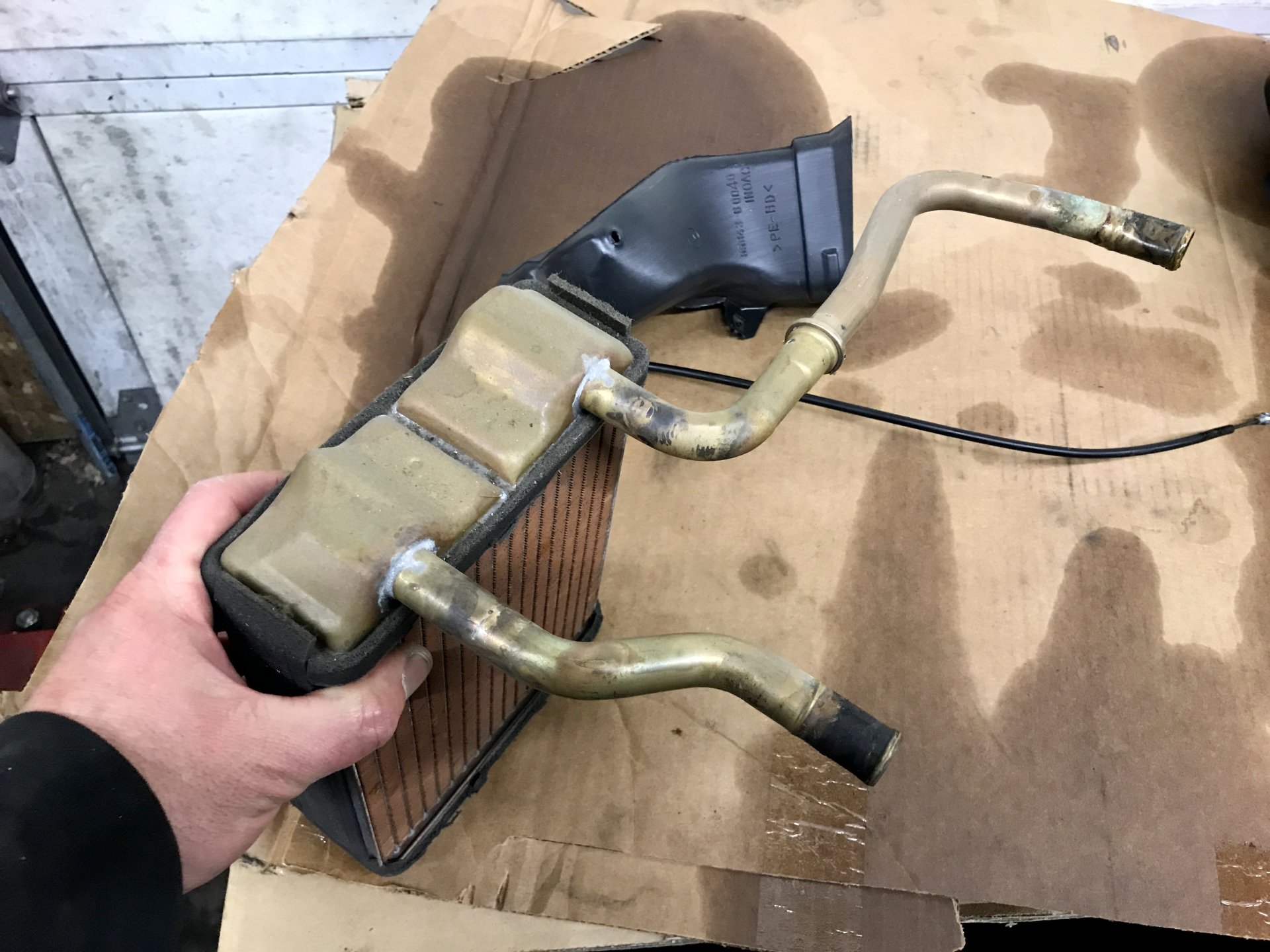

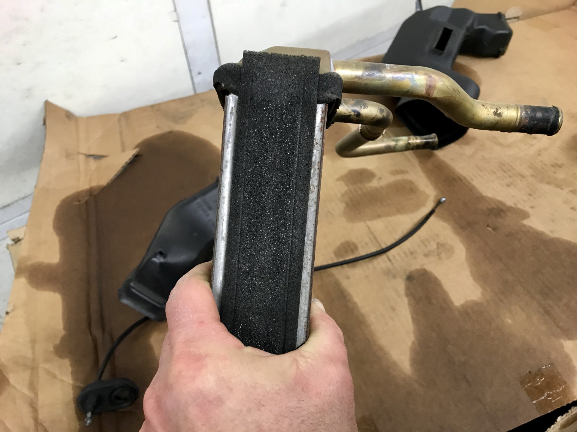

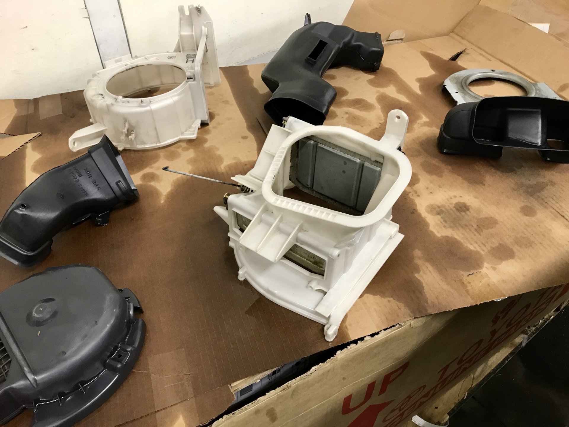

Heater core is in good condition.

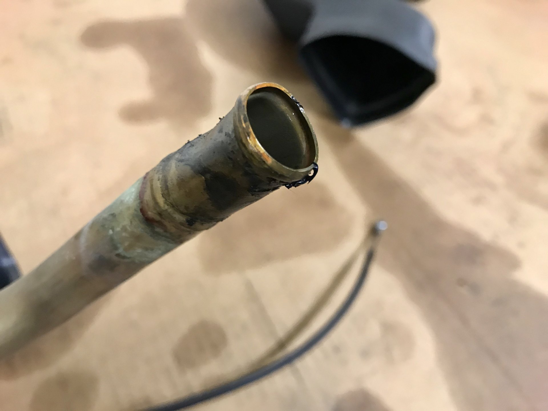

When I installed the new engine I noticed one of the firewall heater core lines was deformed. I tried to make it round again at that time, it however has leaked on me twice now.
My Cruiser is a 1/1995, crossover month. I may see if I can find the right hard line for the core and replace just that. Clean and flush the core plus a pressure test and run it. It really is in exceptional condition for being 27yrs old.
