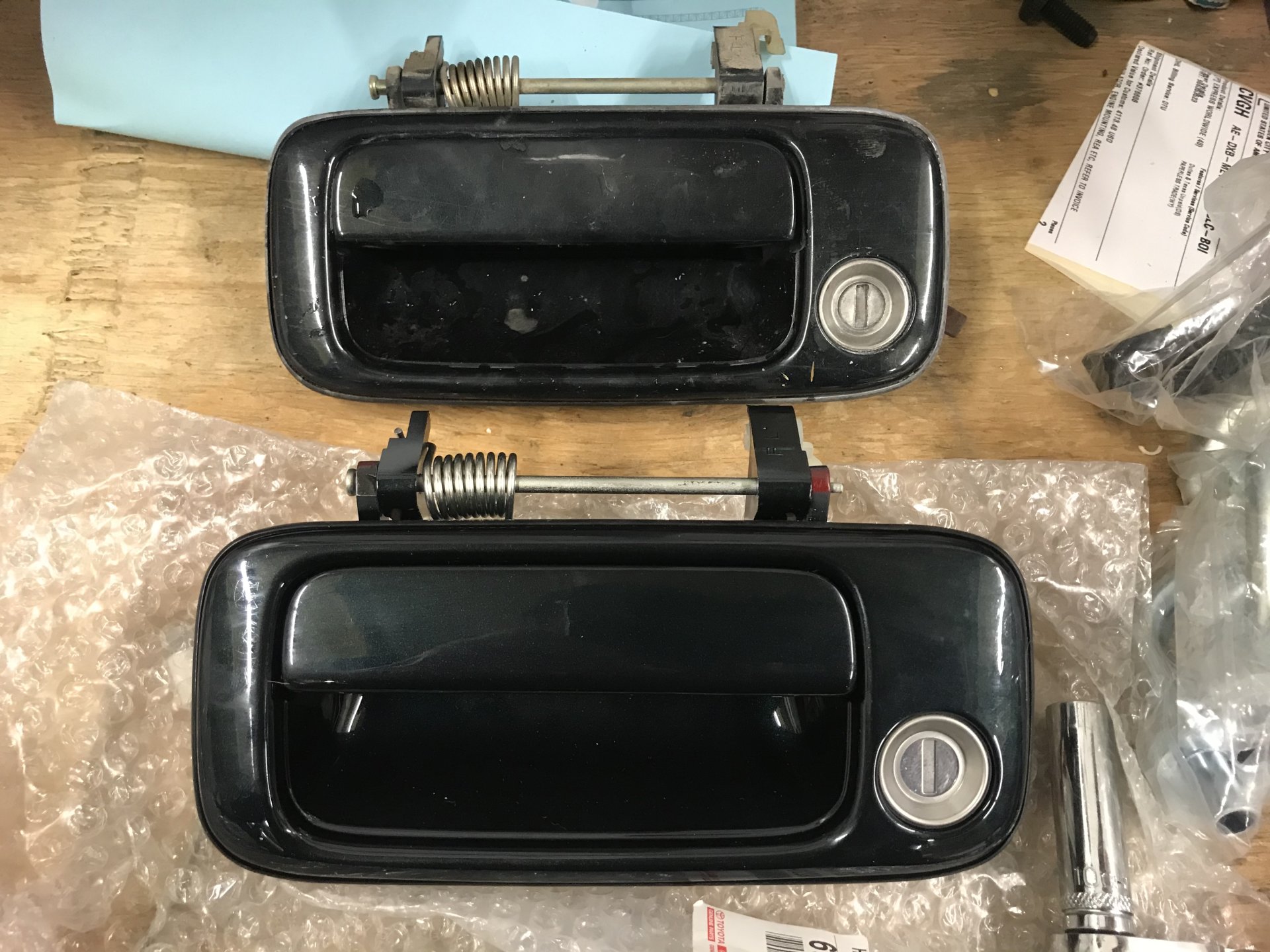

Mostly interior stuff, I am going to refresh the HVAC system as well as do some sound deadening. I have new door handles and locks but have been waiting to jump on that until I got some speakers. Today I bought really nice Morels for all around. I think I am also going to delete my RR finally and just a bunch of things all over the Cruiser. I need to replace the windshield too.

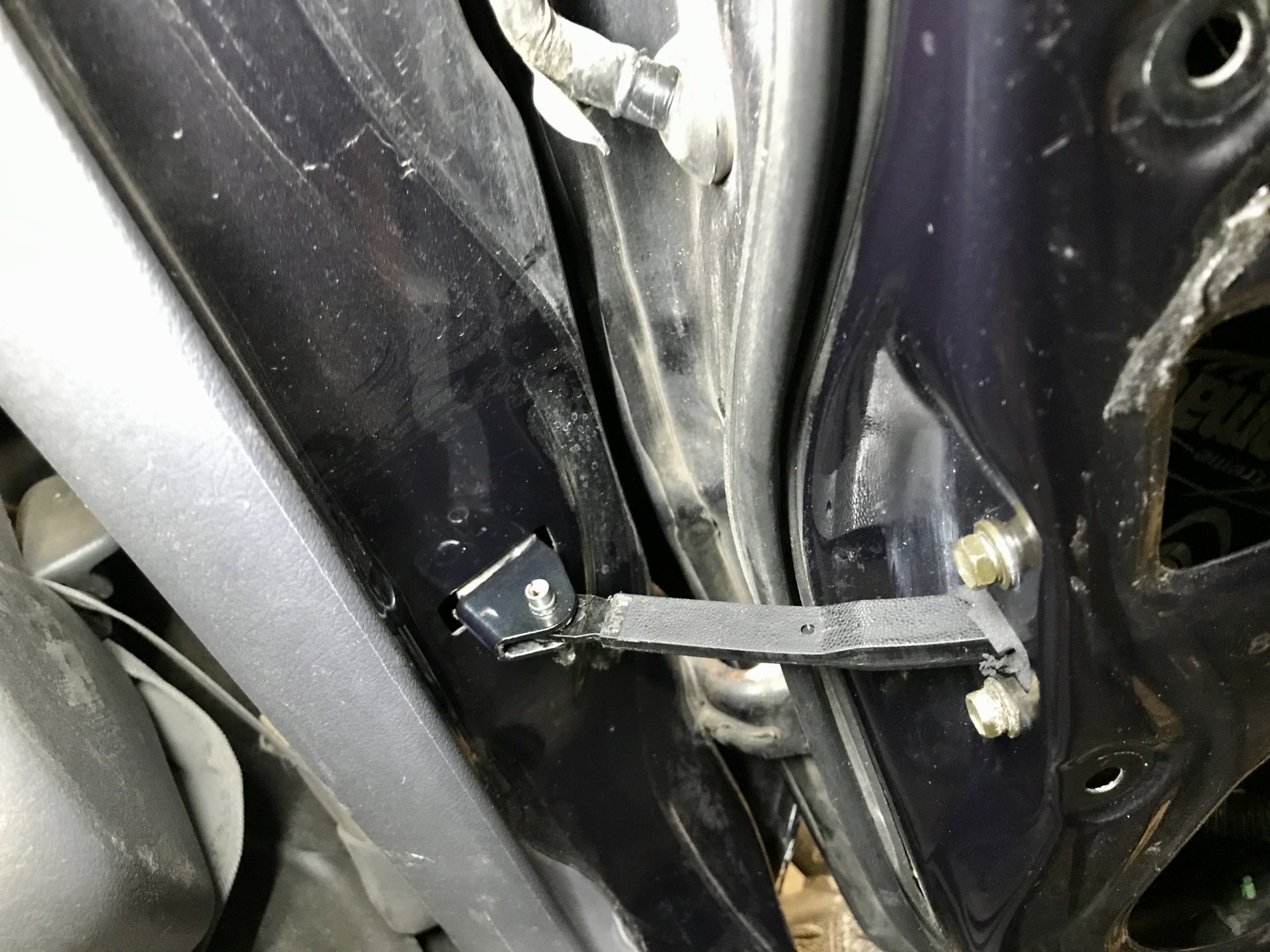

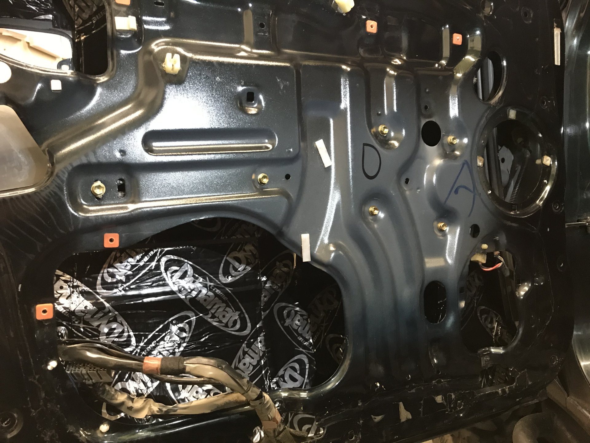

Doing my doors up.
Also a major cleaning inside them in prep for some cavity wax.
Cheers

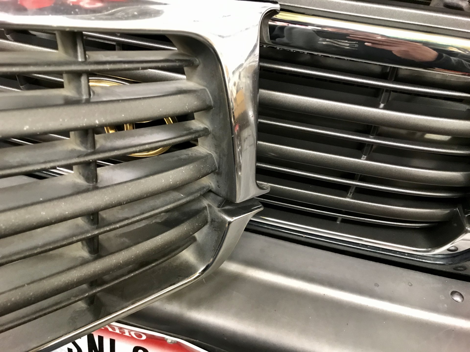

I decided to pull the trigger on a new OEM grill.
Mine wasn’t horrible with under 210k on it but it does have 27yrs and was kind of showing it.
Cheers
Sexy OEM goodness, get them while supplies last! 🥰
Polished up my gold grill emblem while I was at it.
I have an earlier “Toyota” grill I was going to install on this Cruiser. Decided to save that one for the HDJ80 build I have.
Cheers

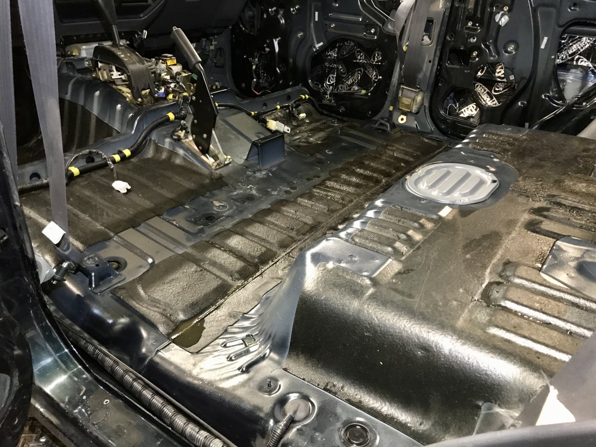

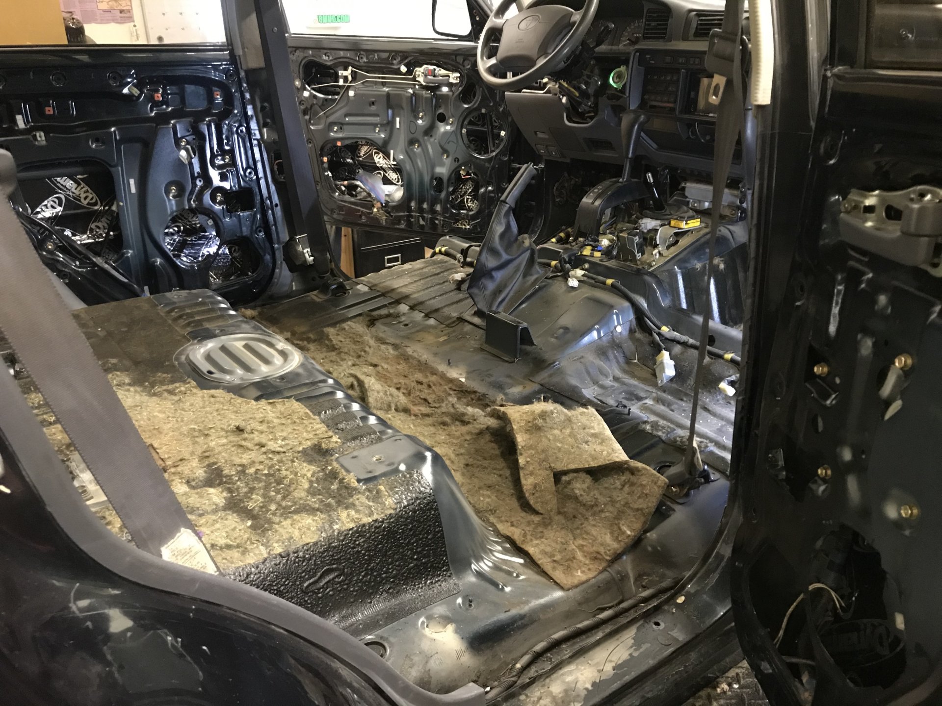

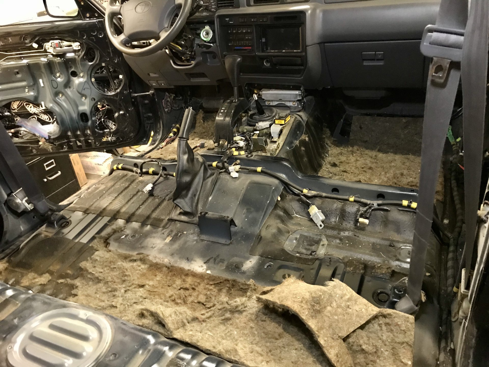

Was disappointed to find the old jute super stuck to the floor.
Real nasty, ex-soccer mom Cruiser, it definitely had all kinds of beverages spilled in it over the years.
Cheers
Good 2+hrs cleaning...

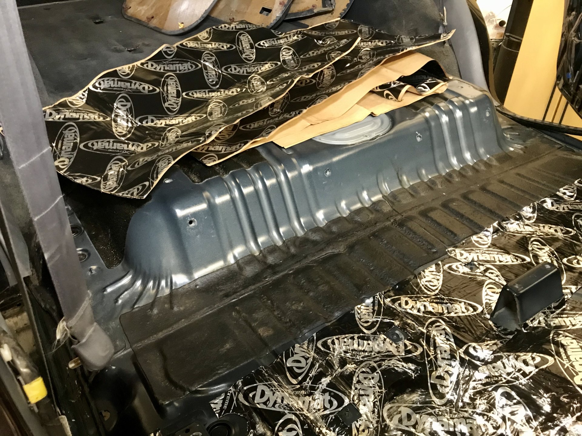

I am not going to remove the factory sound deadening. With a dry ice slurry I could have it off quick and easy but I have no concern for rust under it. So I am going to bury it with Dynamat.
Cheers

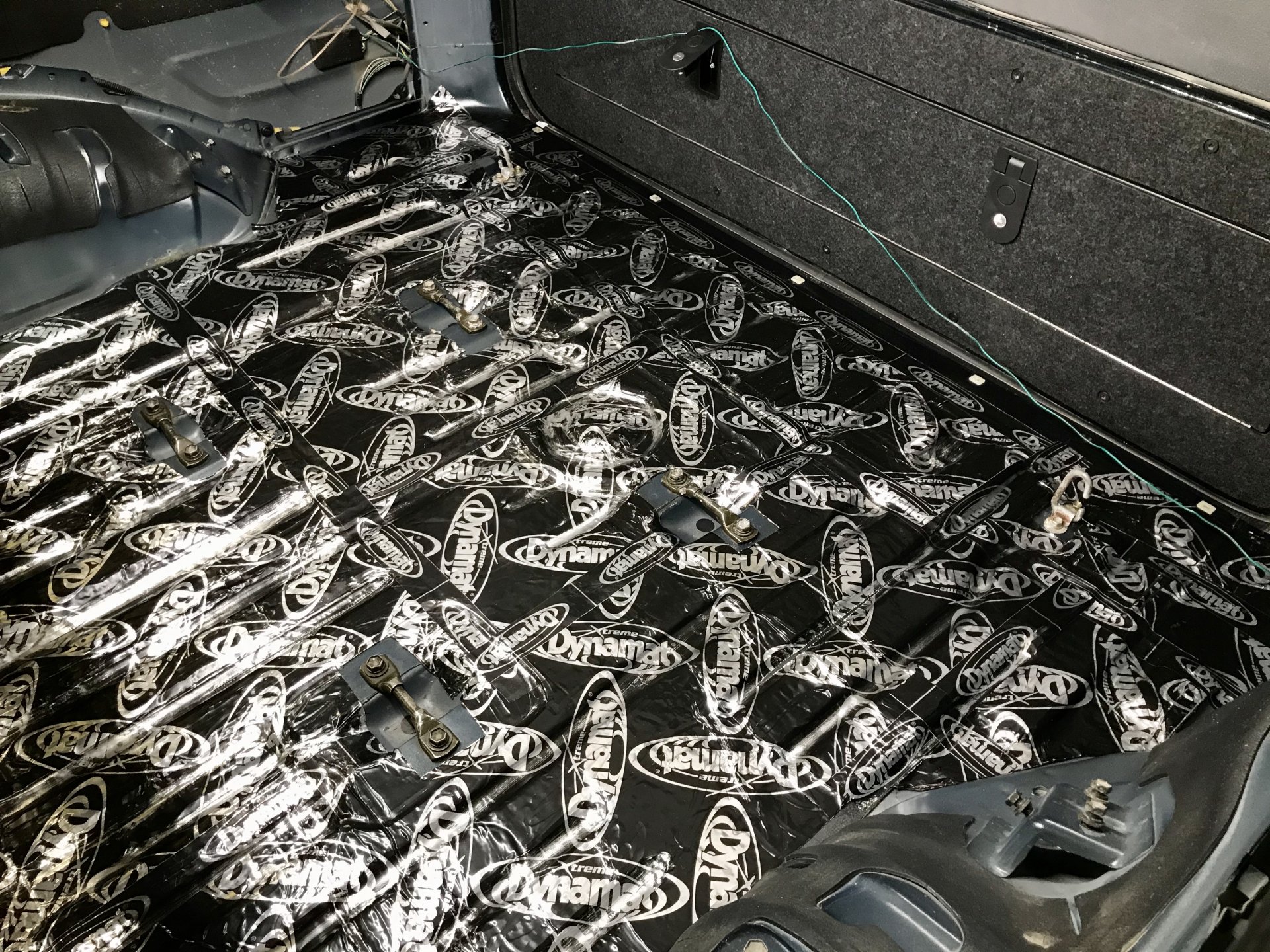

I got the rear floor done today but ran out of dynamat. So I need more for rear quarters and wheel well arches.
Cheers

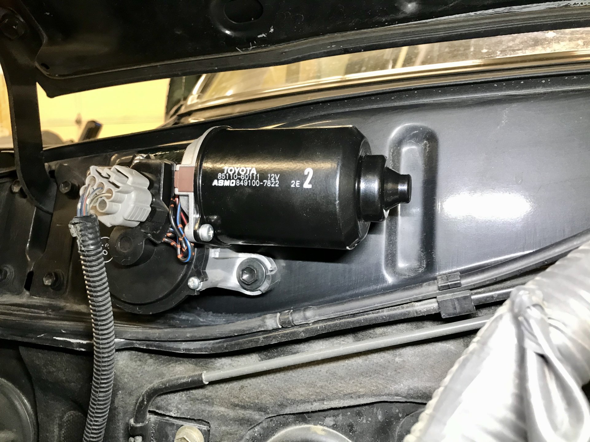

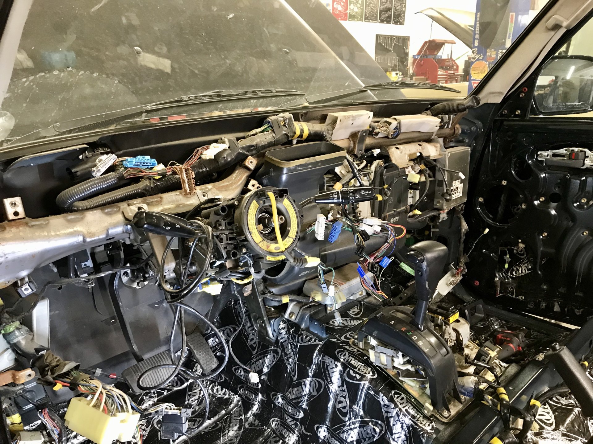

I didn’t feel like ripping out the HVAC system at the end of my day on Sunday. So I did this instead.
Should be good for the rest of my life and or ownership. Like a lot of things I am doing right now, get them while supplies last is the reasoning behind refreshing components.
