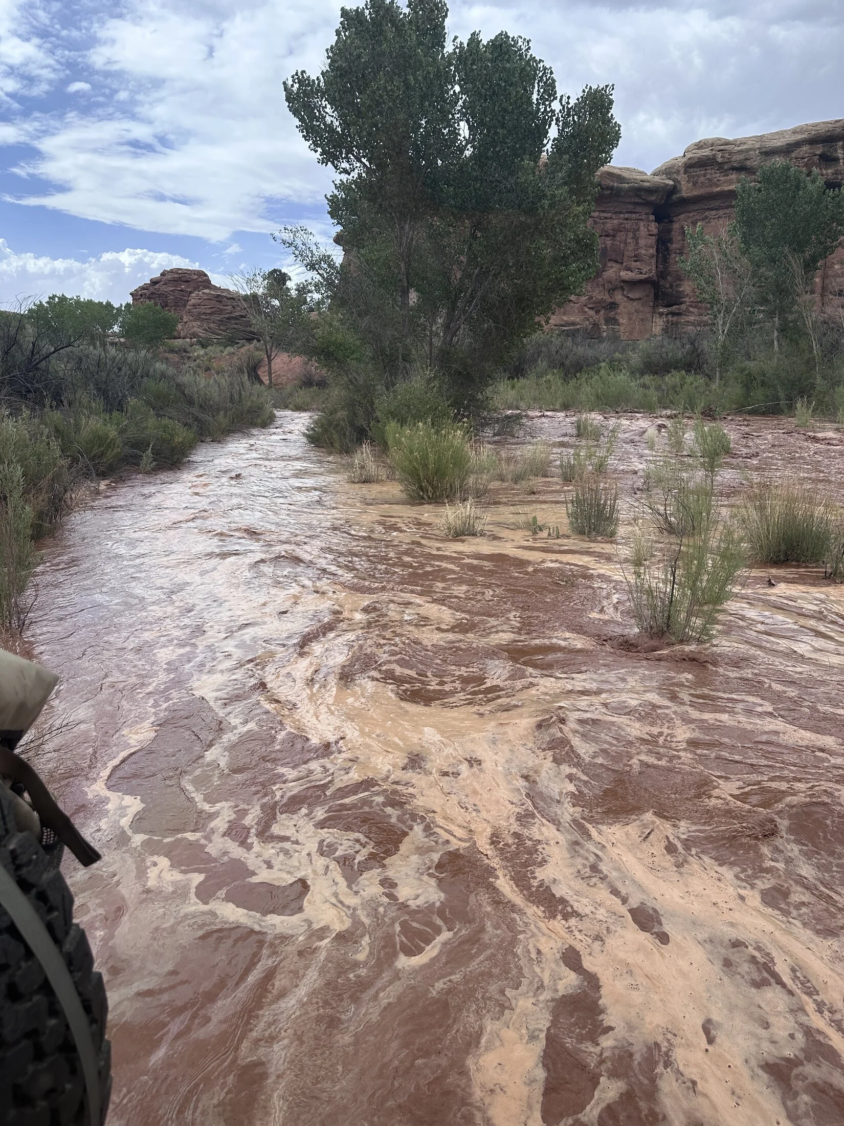

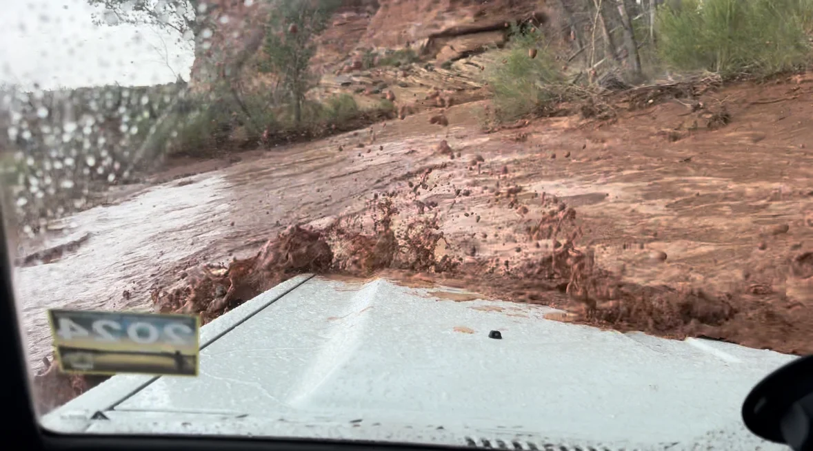

Got hit by some flash flooding in Utah that got pretty harry. We had to navigate through water over the hood for many miles.
We made it out safe but had to drive the Troopy almost 100 miles before I was able to get it to where I could look at it.

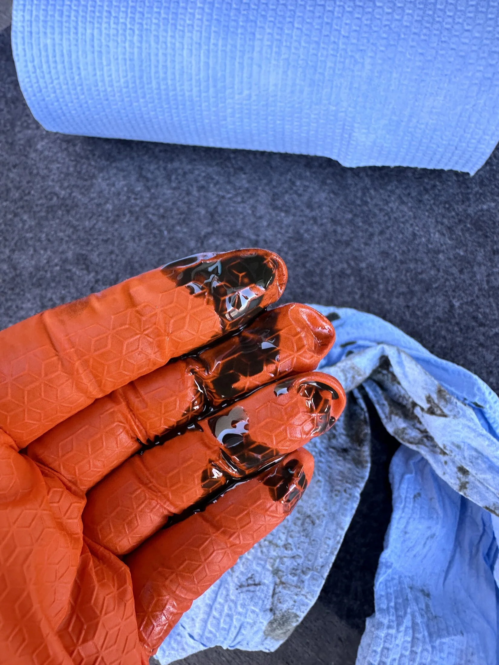

Drained the tranny, transfer case and the differentials. Seems that water was in all of them.
The tranny was the most concerning as it spewed fluid out of the fill hole.
I am noticing a “humming” while in 4th and 5th gear. I am wondering if the water detonated my H55F. Any insight would be appreciated!
Yeah, I didn't think it looked too watery, but I am confused as to how so much fluid came out of the fill hole...

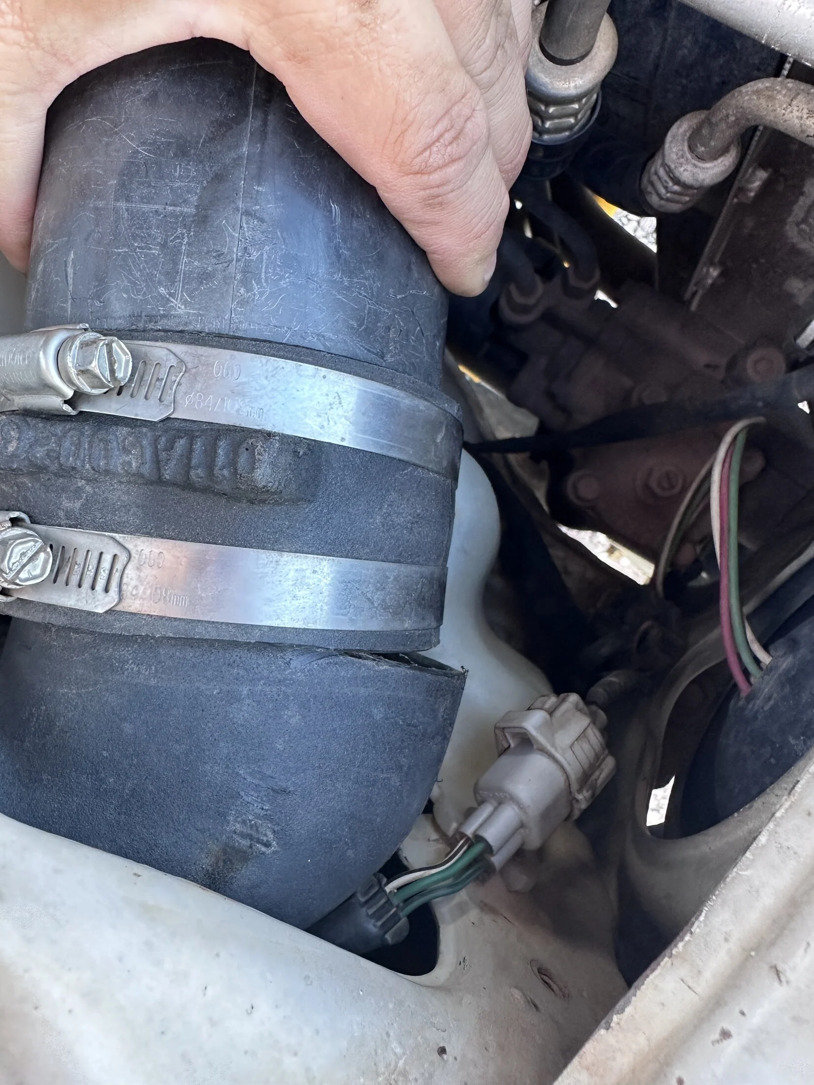

I did you engine survive when the snorkel wasn’t even seated? Or is that why you are currently upgrading to a 1hd?
Luckily the engine did not sustain any damage. The Snorkel held on just long enough and there was just a little dust in the airbox as normal. My 1HZ is up for grabs though, if anyone is interested. I just wanted a more powerful motor and turbo combo so I can cruise up hill faster.

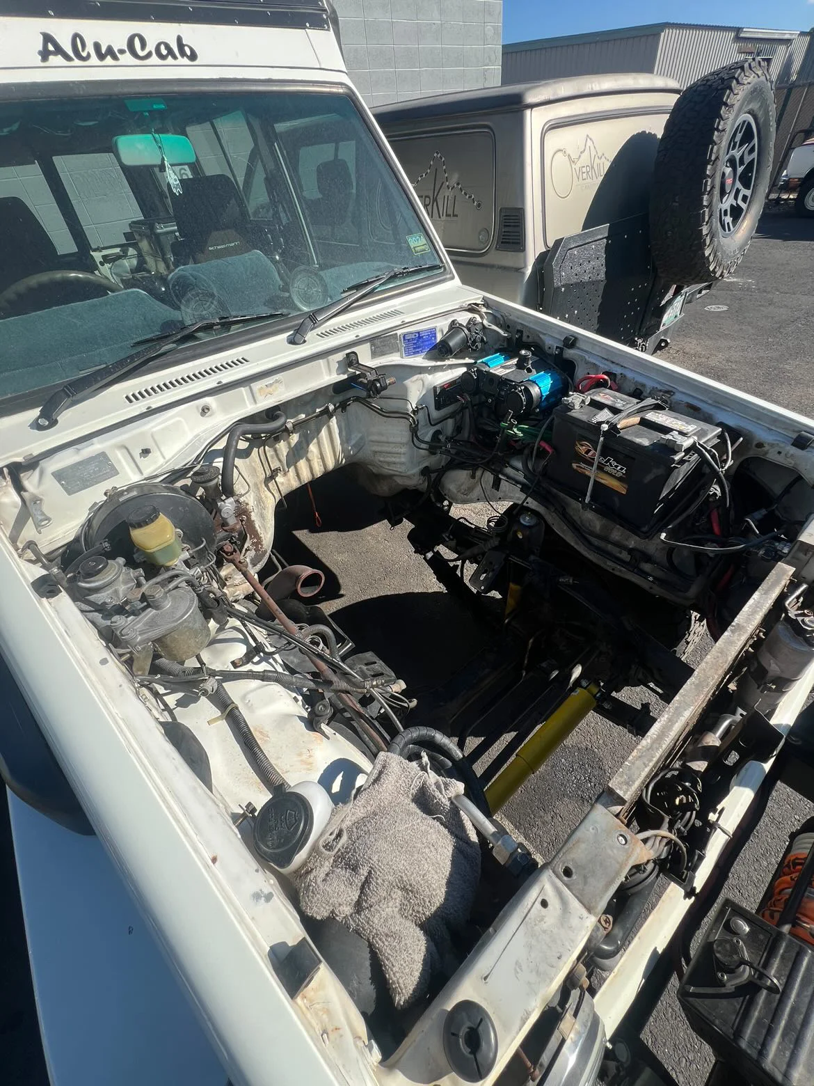

A few months ago I pulled the Troop Carrier out of the garage to drive for a few weeks and quickly discovered that I had a pretty significant electrical issue. This electrical issue lead to tons of troubleshooting and parts replacements which ultimately lead to me having to remove my transmission access panel and most of my interior to get access to other hard to reach areas of the truck. I am terrible at taking photos of stuff when I am working on it, but I am trying to do better if only to help out the next guy who might embark on this journey.
I never bought this thing in hopes of a restoration. That being said, I like to take care of my things and I like to do things to the best of my ability. I discovered some rust and figured since I have the truck torn apart, it would be the perfect time to do some projects that I know have been needing to get done. I also discovered some pretty horrendous wiring that had probably been done many years ago when the truck was in Australia. What started as a simple fuse check had now turned into a full blown ordeal.
