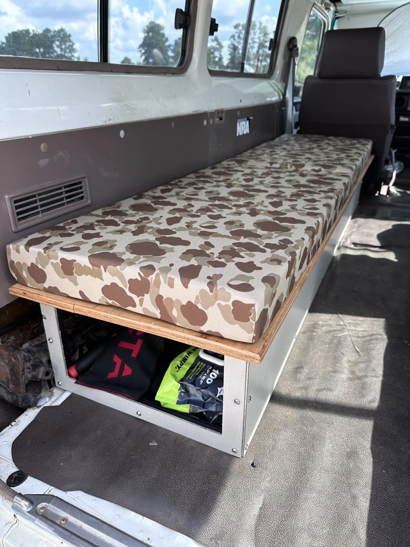

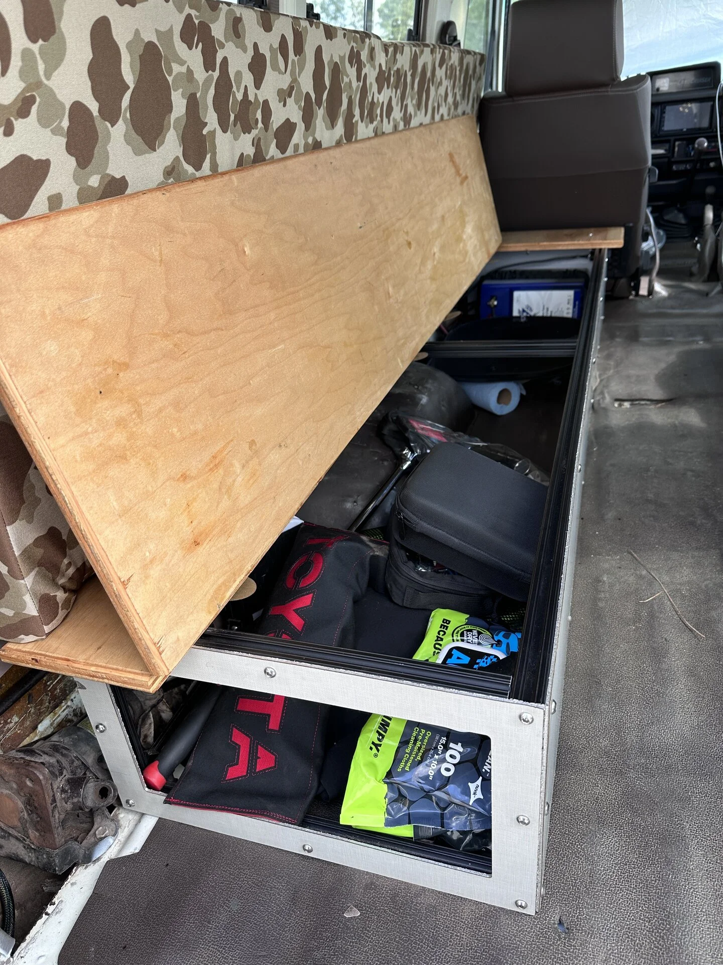

Finished up the bottom cushions for the bench. I wanted something durable and easy to remove. I also wanted them to fold up when accessing the storage below the bench.

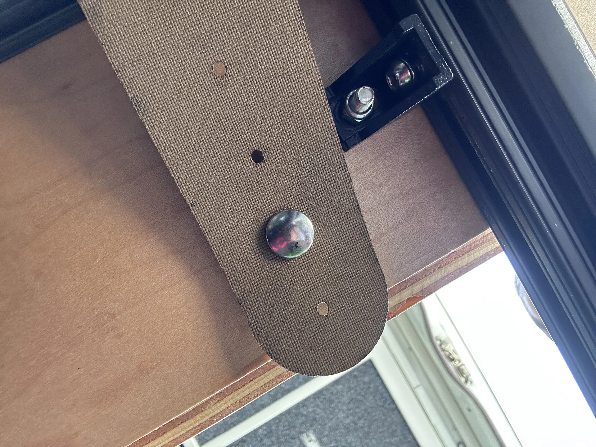

I used a set of snap fasteners to secure the cushions to the underside of the bench.
Seat material is 500D Cordura Nylon.
Cushions are made with “firm” 3 inch foam.
Also nice to sleep on when we have 3 people traveling.

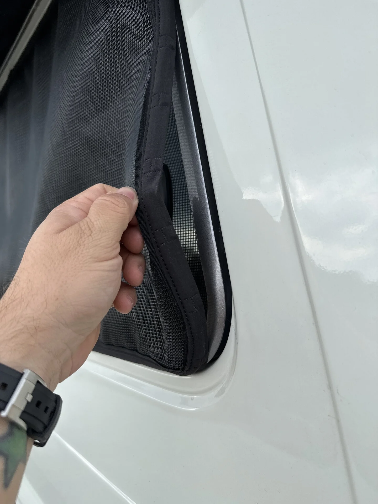

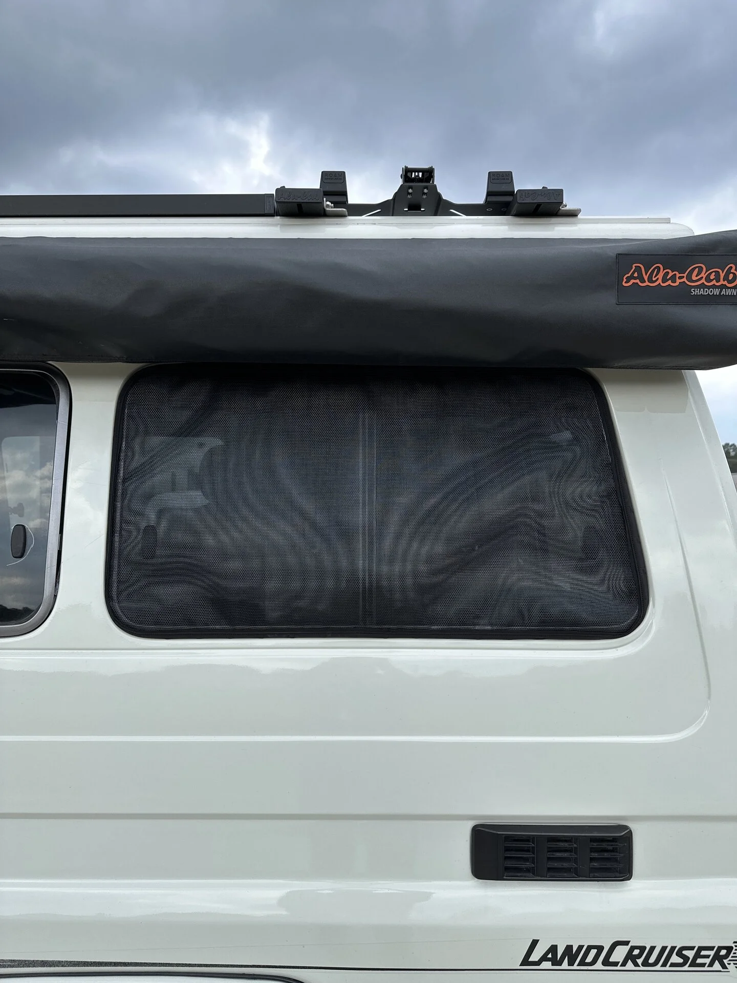

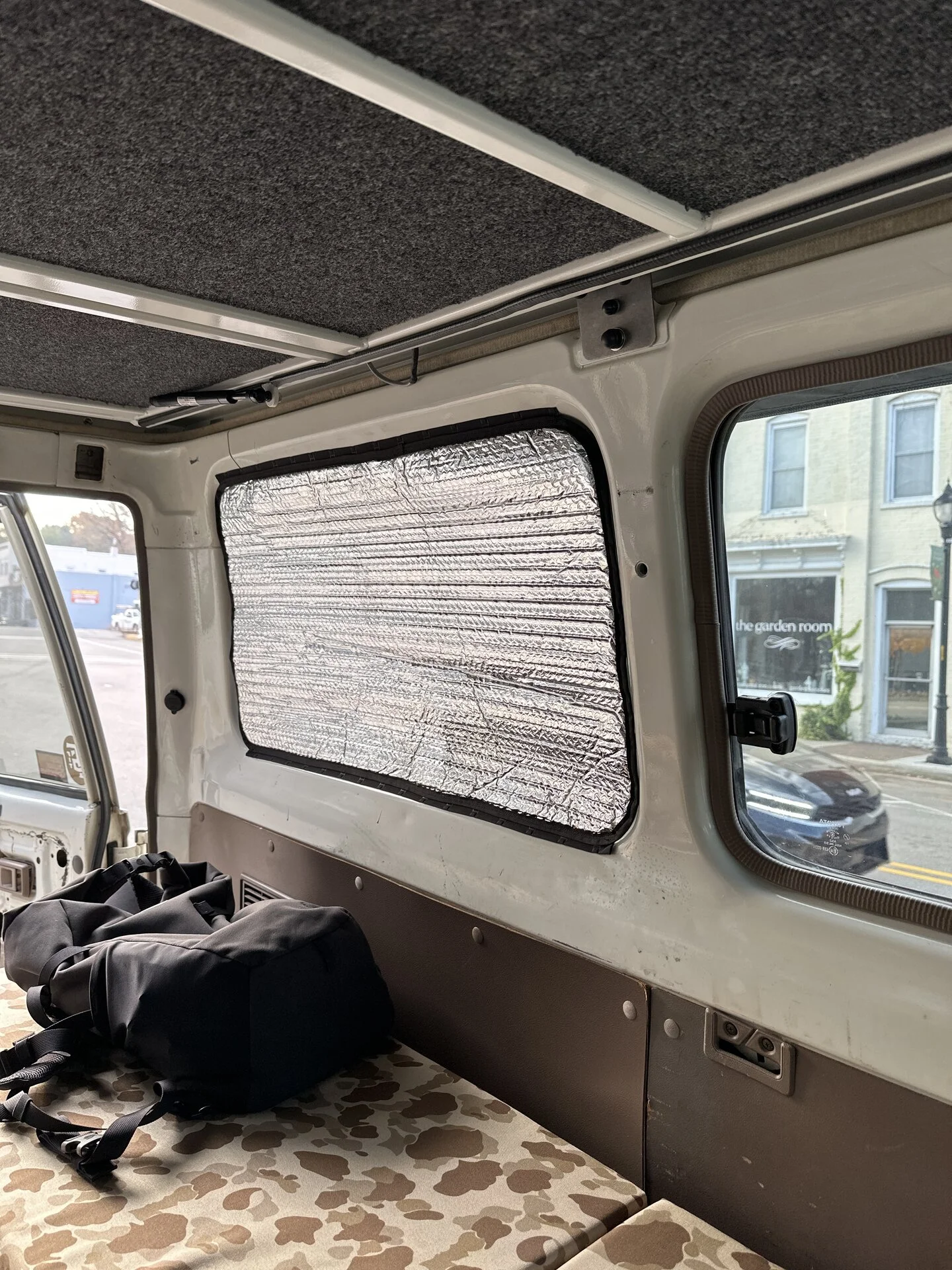

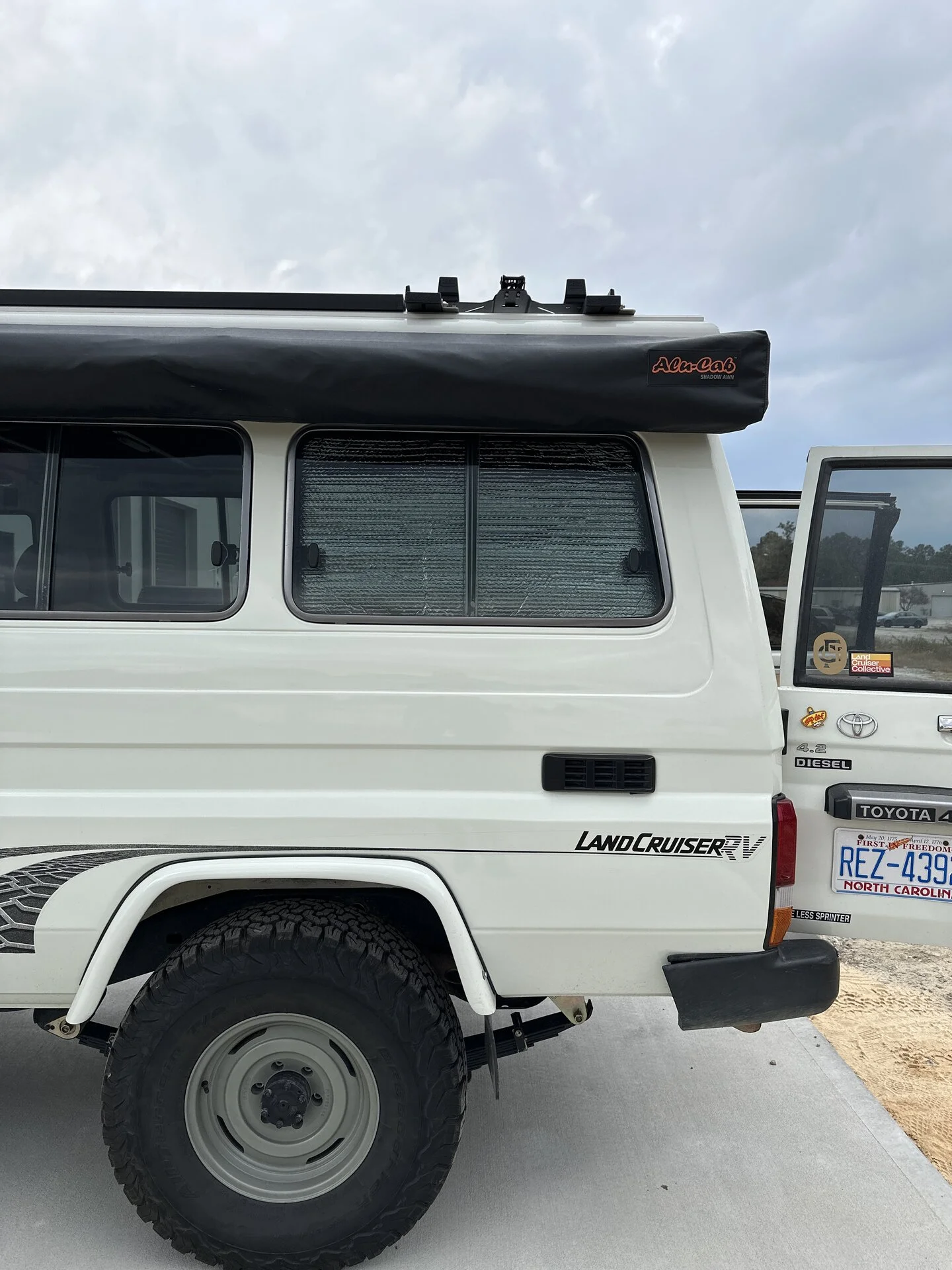

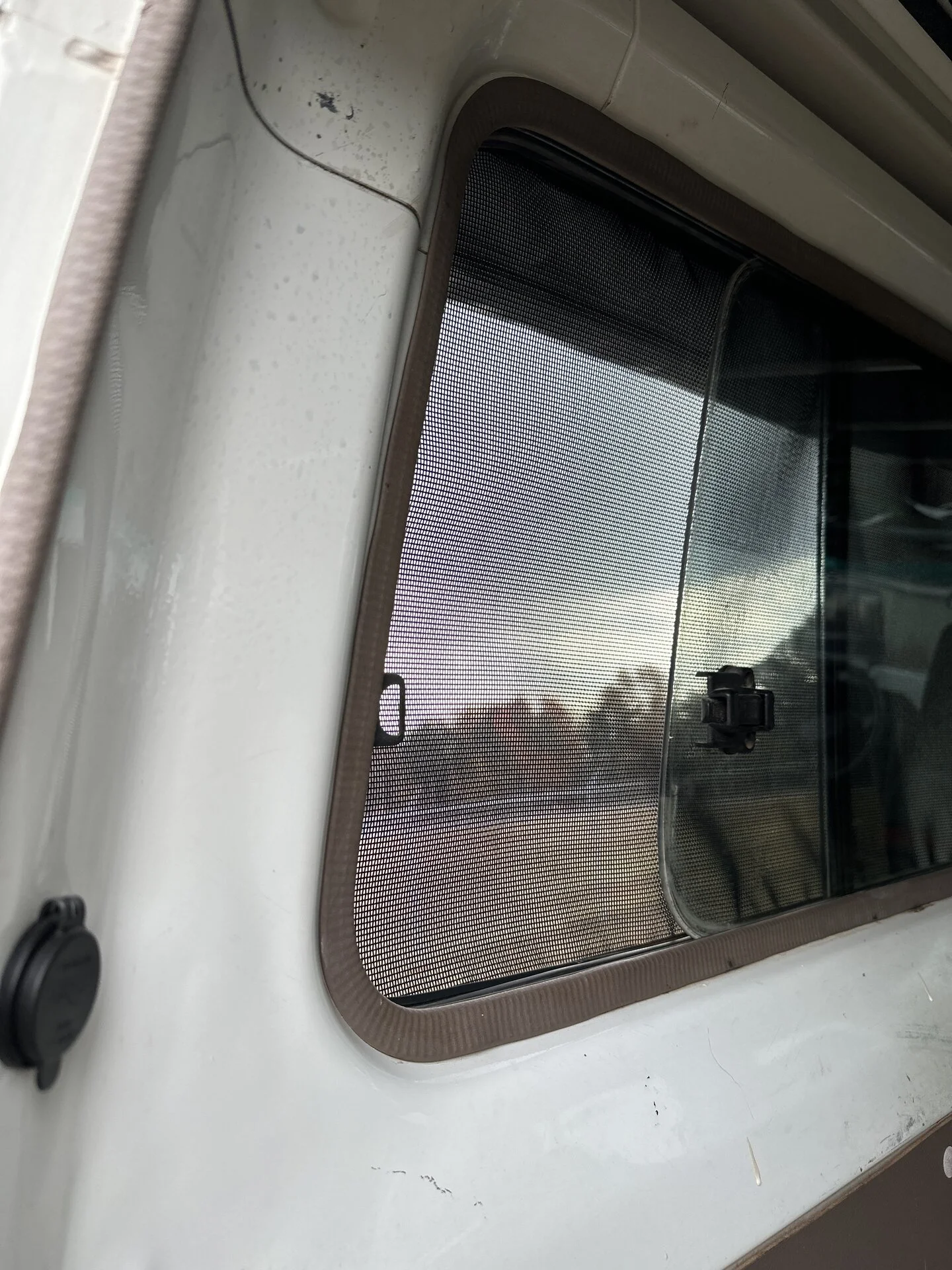

I think they look fine - if you don't want them I'll take them off your hands. What is that magnetic cloth strip? And what foil cloth did you use? I've been planning on sewing up a set.
Thanks! They will probably be just fine!
As for materials....
Reflectix BP48010 Double Pack Insulation, 48 in. x 10 ft​
and
C-Zip 5cm magnetic zipper chain. (I think it was the 5cm)​
