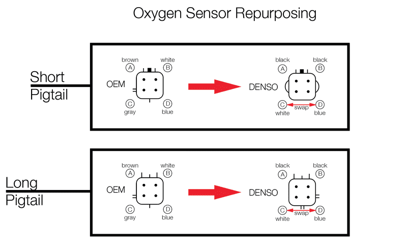

Just did this last weekend...
Here's the relevant thread. You're going to want a depinning tool and swap out the connectors to reuse your old one. The pins were a bitch to get out, I ended up cutting apart the new (unused) connector instead of depinning that one. Napa had the Denso model I needed for the swap in stock (234-4157 shortpigtail).
Do not re-pin the O2 sensors from that OBD2 years. I tried and mine failed after less than a year causing me not to pass emissions. I ended up getting the Bosch O2 sensors and they seem to be working well, just passed emissions for the 2nd year in a row. Some will say the Bosch ones are garbage and do not last but Bosch has been in the game for awhile.
Hmm... I based my approach on your comments in the thread. Whelp, I guess I'll put in an order with a Japanese supplier for the OEM set.

My fault for never following up. After doing the re-pin I was having a rough idle and could not pass emissions. I got down under the 80 and tested for resistance on the O2 sensors and they were way out of spec, double what is allowed per the FSM.

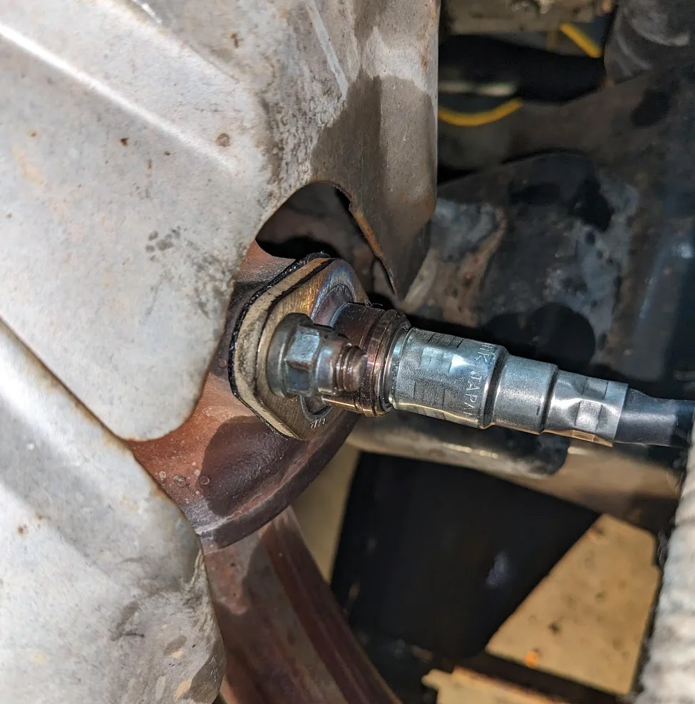

Referring back to a similar thread from last year, 89465-69115 appears to be the correct part number for the right side (OBDI 93-94). But there is some conflicting info on if this is the longer pigtail, in which case it would work on either side, or the shorter. see below Post #56, and again #72-76. Can anyone confirm that using two part no. 89465-69115 would work with no further modification for this application?
Oh, well i just order 2 of them, spliced the wires and put in both exhaust manifold spots and haven't had any issues. Also passes Smog in CA & WA
