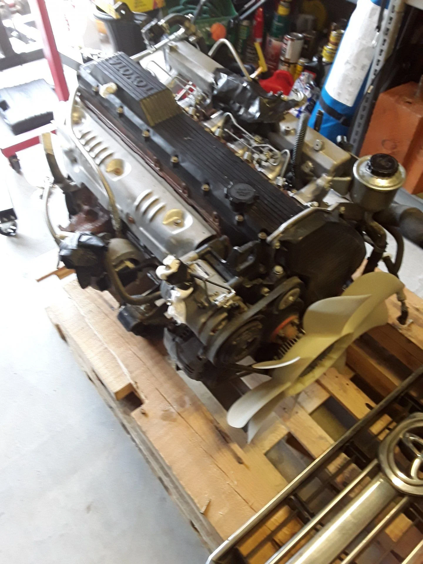

Firstly, I am the proud owner of a 1991 Toyota FJ80 3FE. My rig only has 148k miles on it. I have had the vehicle for 2 years and I absolutely love it. Recently, I have acquired a 1HZ-turbo with only 19k miles. The turbo is a DTS turbo with a HPD intercooler. All is in great working order!

I have decided to attempt the conversion myself... I have successful pulled the 3FE and the transmission. The idea was to mate the 1HZ to the A440F by way of a different bellhousing. I assumed that the flexplate/driveplate would be interchangeable, but that isn't the case. The back end of the crankshafts are different (bolt pattern and center hole). Going over COAs, none of which I'm sure will work.
COA 1 swap back end of crankshaft from the 3FE to the 1HZ, and get a bellhousing that mates with the 1HZ.
COA 2 convert to a manual (R151F), and all that goes with it.
COA 3 go with LS swap 😒
Any thoughts y'all?
I have a rebuilt H55f 5-speed with the correct bell housing sitting in my barn. Just a couple hour drive for you.
It was great meeting @jmlockwood and the H55f is going to be a life saver for this build. Truly a great guy.
I owe everyone an update post this weekend on the status of the build, and a status on the 1HZ mated with H55f pre-install.

Once I had the 1HZ mated to the H55F I was able to determine that none of the original mounting locations would work. I found a local metal fabricator and welder to design mounting brackets and weld them to the frame, but he got busy with post hurricane Lura relief in Louisiana. Luckily I was able to find another metal fab shop to do the work. The mounting brackets are expected to be ready this week, but I will have to put on my welder's hat and mount them myself.
While waiting I spent my time ordering a ton of parts. Most of them has arrived.
I replaced all the front and rear control arms, sway bars, linking bushings. I already had OME suspension, but I went ahead a replace the old shocks with new ones from OME.
I can't wait to get the mounting brackets so I can move this project along.
