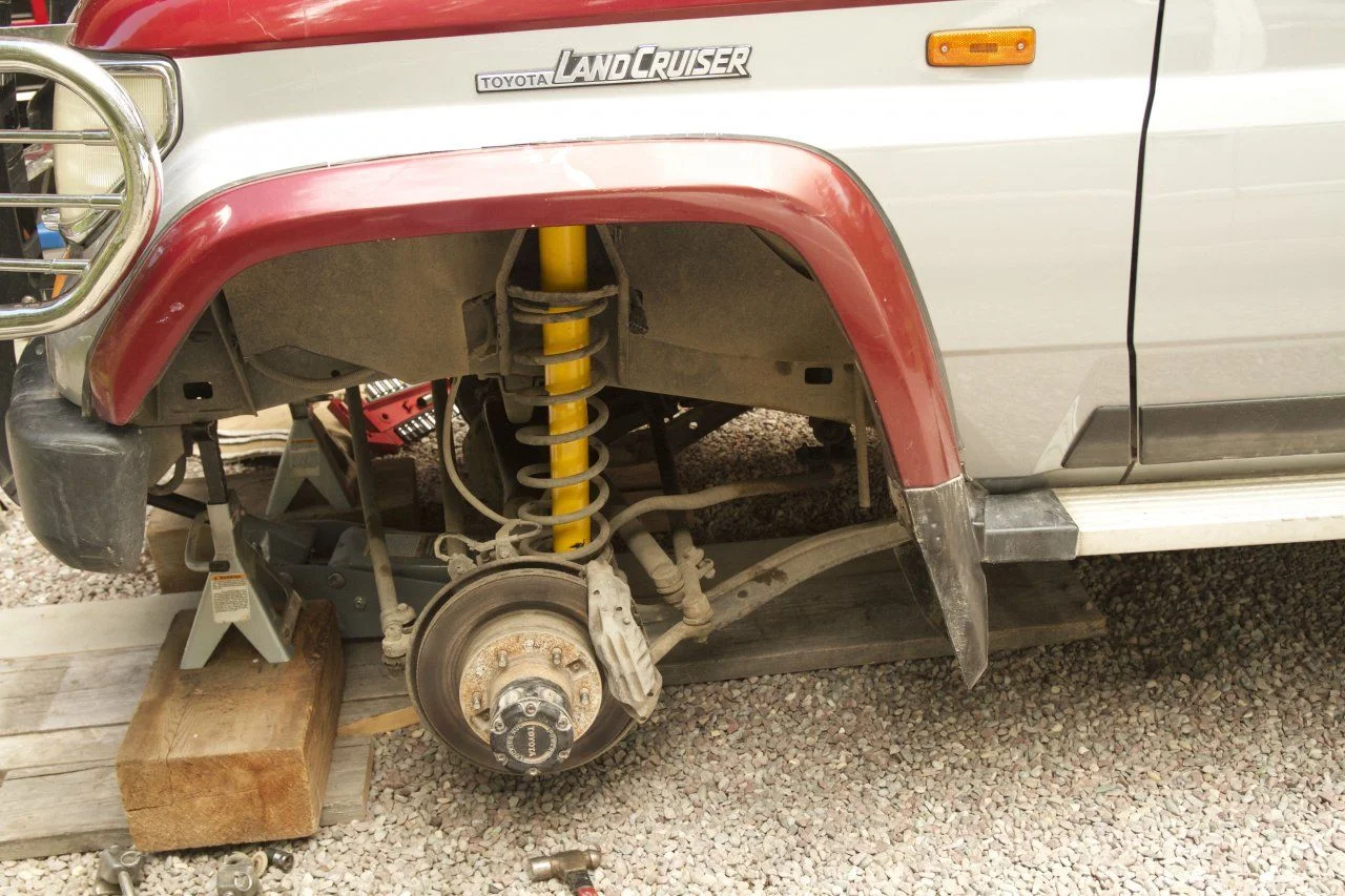

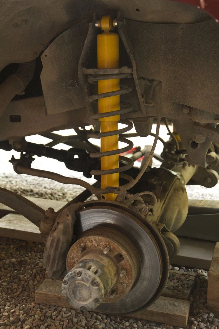

Finished the fronts today.
The front rides much softer now.
