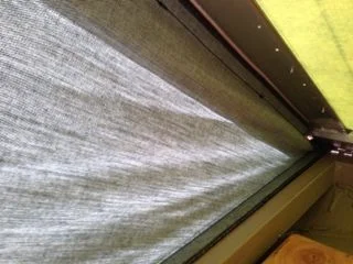

some skinny bungee cord type of material can be wrapped around/ run from verticle to keep the fabric panels a bit tighter...
Thanks for the encouragement
It got me started.

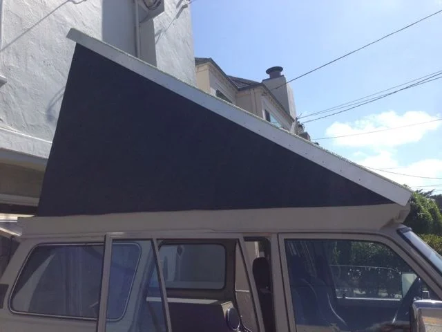

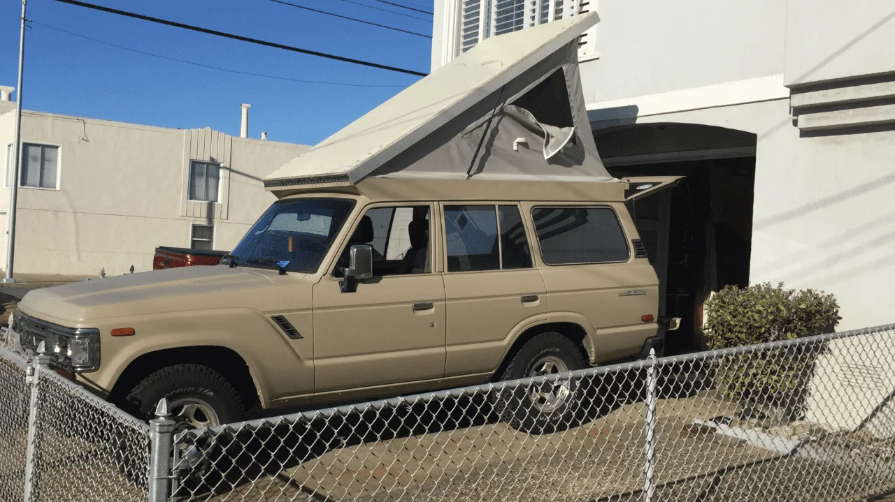

I made some adjustments to the struts, tightening the fabric. Seamstress will make adjustments to the pattern and hopefully have the sunbrella fabric sewn. I'll take "Lambcrusher's" advice and sew in a slot for the bungee cord.

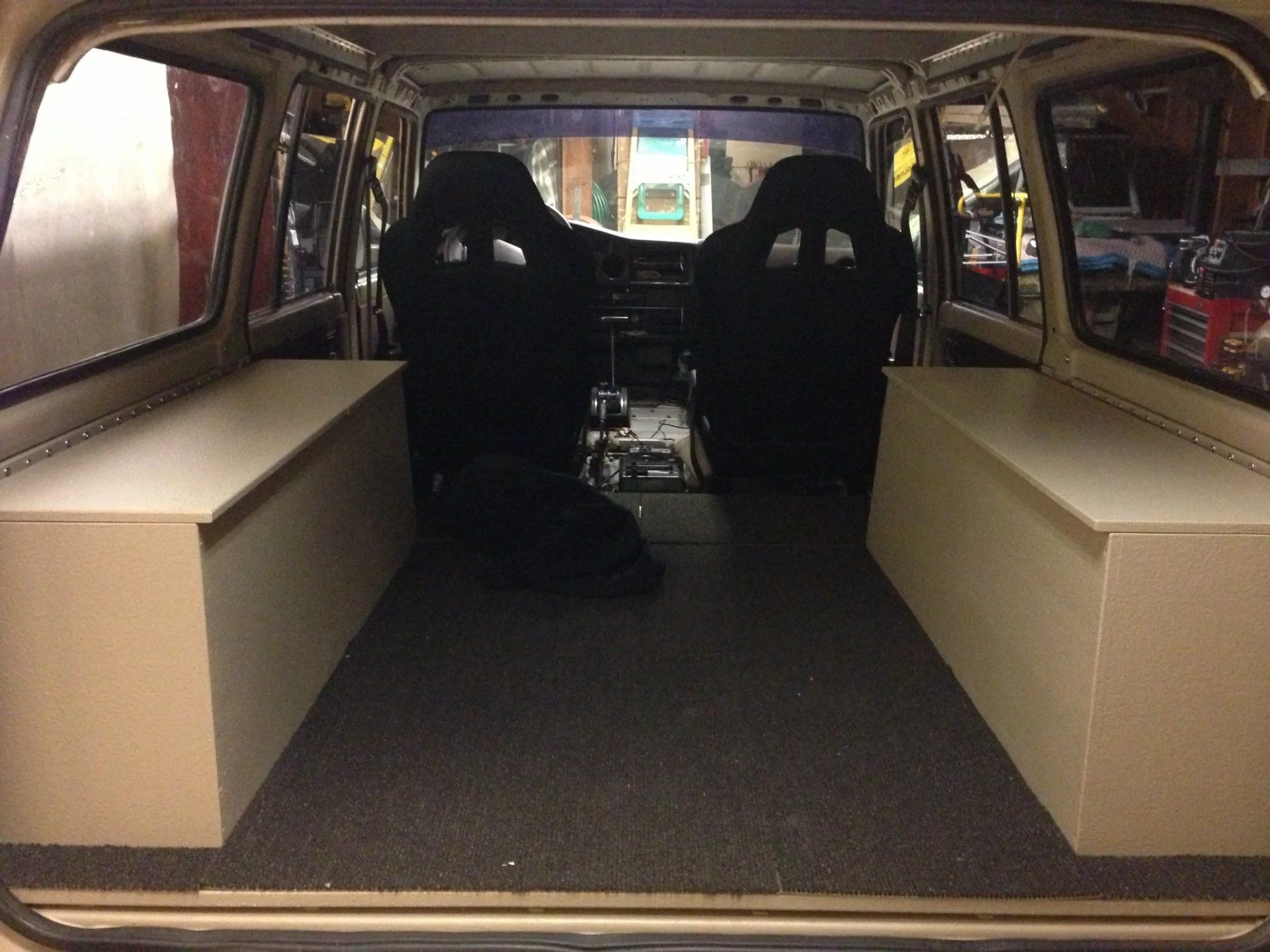

How does it look on the inside?
THREAD RESURRECTION!
I SUMMON THEE @sfcruiser! I'm genuinely interested in this! Please let us know the current status of this build!

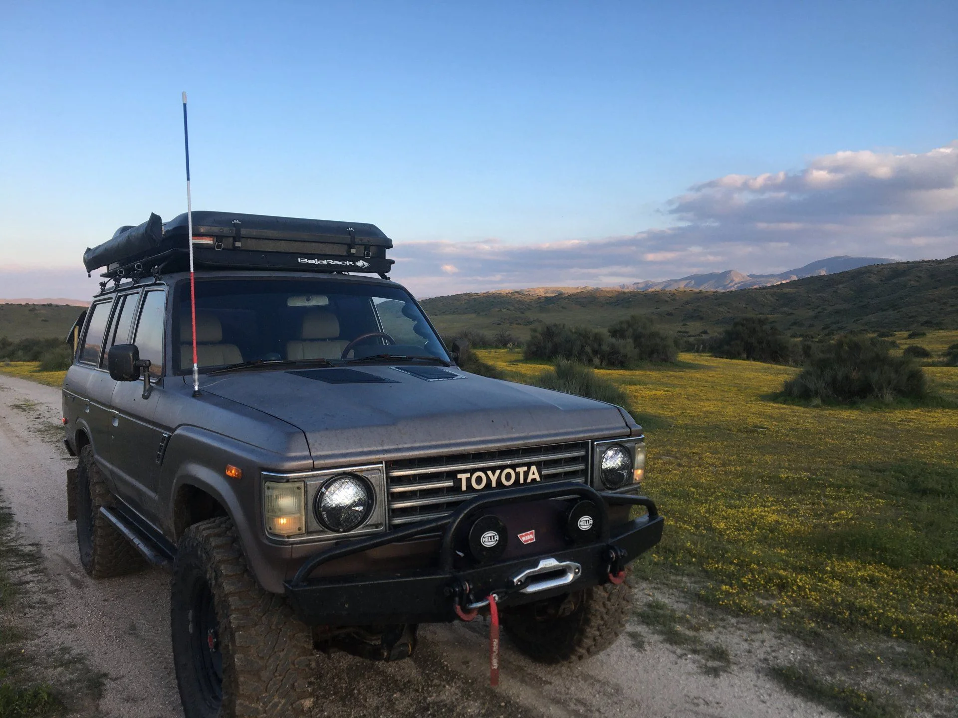

This project was placed in a shipping container back in Dec 2016. Not much has changed since the pics were posted. Now that I have some free time. I plan to finish this build. I just ordered a lift kit from Cruiser Outfitters. I'll get some pics of the interior when the lift kit arrives. Any suggestions on bumpers?
Wow! Did the container go anywhere or just sit in storage? I like 4+Bumpers, since I have one. Trail Taylor has them but not sure if he is still doing 60’s. 4x4Labs make a nice bumper too. Look through the Vendors list.

I'm running 4plus/MaF, and really like it.
Thought about running an OG ARB for the 60 series for a better winch mount than a Warn HS9500XD, but the main deciding factor was approach angle. The ARB sat out so far that limited my approach, and the 1-2 times a year when I'm REALLY hopping that ditch/log/etc, I love it.
