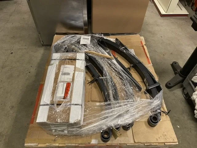

3” lift arrived 👍

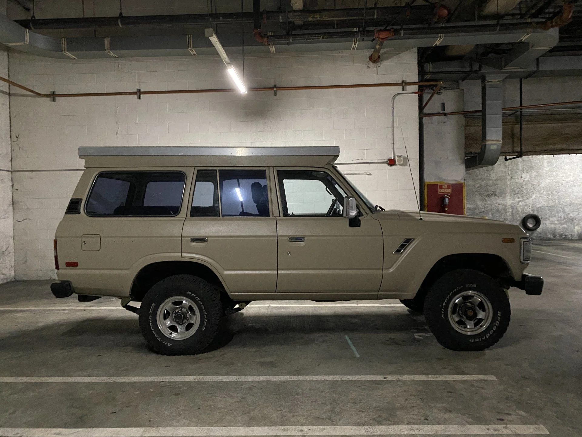

Slow progress, better late than never. Just need to seal the top, considering having it vinyl wrapped. I'll post more as things develop.
Wow. Great work. Why did you need to seal the top?
The top Nidacore is fastened to the aluminum frame with screws in case i needed to remove. I hadnt finalized how I wanted to seal. or make permanent.
