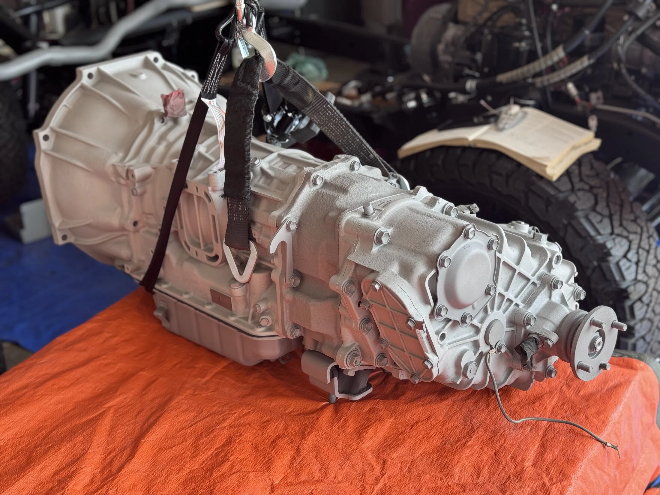

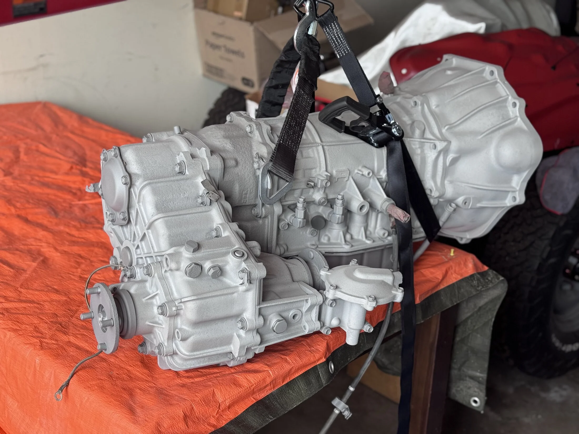

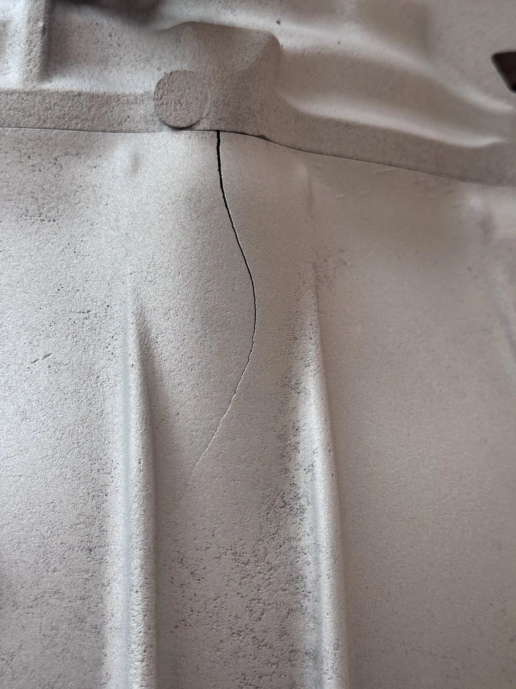

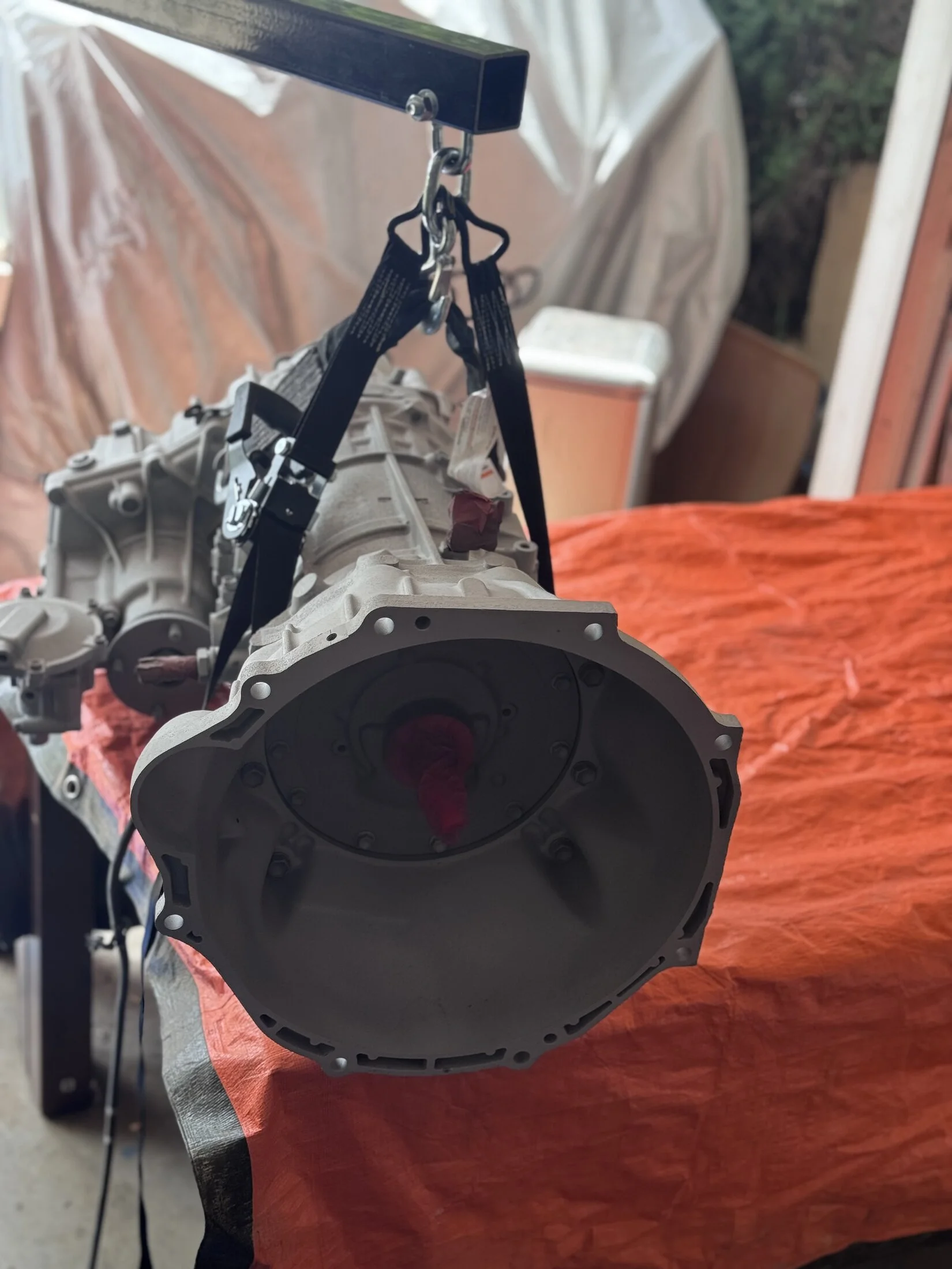

Someone torqued the bolts of the bell housing to the trans to freaking like 90-110 lb should’ve been 50 on top 2 and 30 on bottom 4 …. InsaneGot my transmission back sand blasted af of course the sand blaster messed up and cracked the bell housing, SOR was $400+ eBay was $270 with shipping and then cruiser parts was $55 !!! LOL

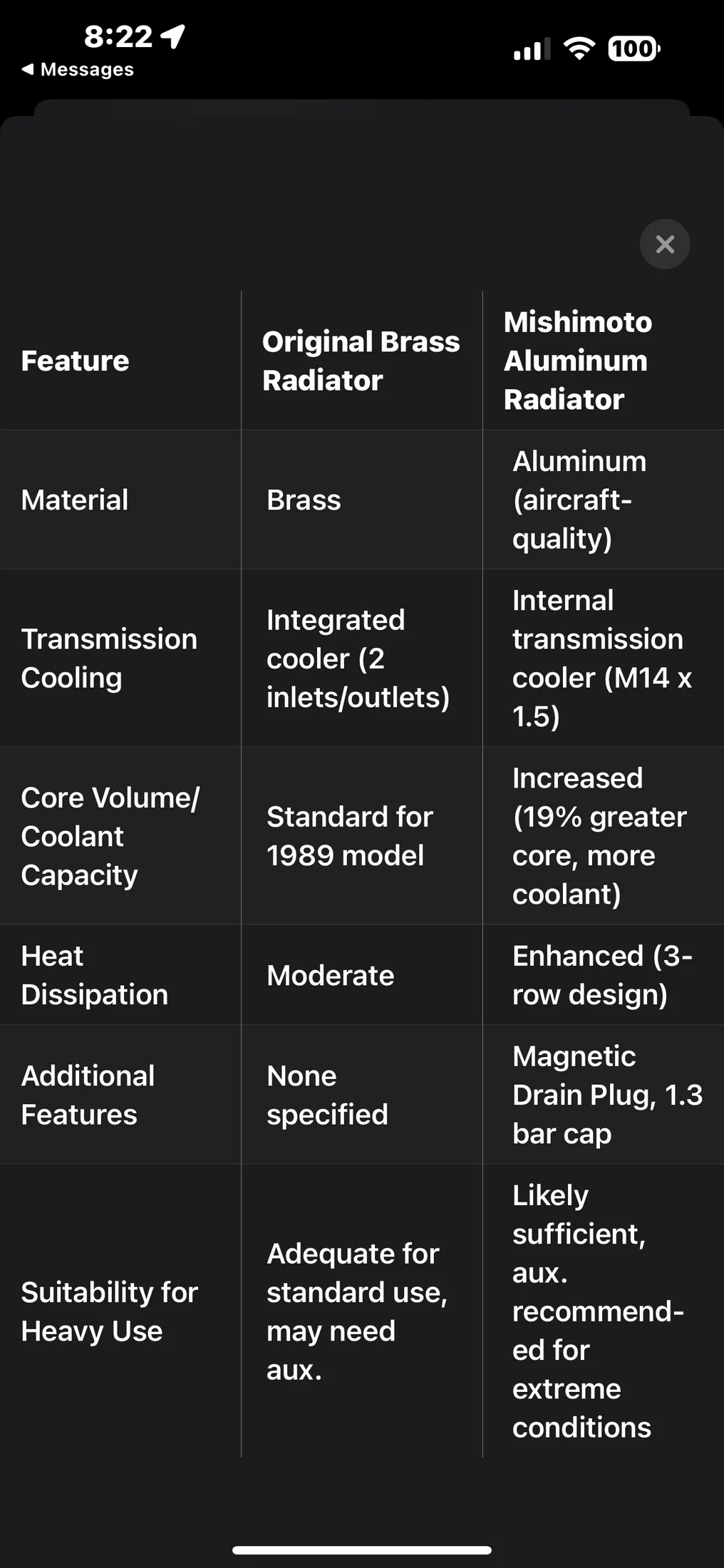

Were the lines routed into the radiator then into the cooler then back out to the transmission if not that's how it should be and yes that's the main problem is overheating with those transmissions hence the adding of an aftermarket transmission cooler.You know what I found out today, the radiator has the trans cooler lines going into the bottom of the radiator …. I thought I needed a trans cooler separately but then realized the diagram goes straight to the radiator! … anyone with auto Fj62s know why my truck had a aftermarket universal auto trans cooler ??? Do these overheat
Lots of information about it and in the faq section.Were the lines routed into the radiator then into the cooler then back out to the transmission if not that's how it should be and yes that's the main problem is overheating with those transmissions hence the adding of an aftermarket transmission cooler.
Yes exactly that’s how it was, with the original radiatorWere the lines routed into the radiator then into the cooler then back out to the transmission if not that's how it should be and yes that's the main problem is overheating with those transmissions hence the adding of an aftermarket transmission cooler.
I’m just thinking logically, for example if I install it in front of the radiator it’s taking away from the airflow of the radiator being a couple degrees higher, I might put a separate temperature sensor on it to see what it’ll do in terms of fluid temperature / with without the separate trans cooler on top of the section it has in the bottom of the radiatorA cooler is cheap insurance and the truck is already plumbed for it. Why wouldn’t you install one?

Run bothI’m just thinking logically, for example if I install it in front of the radiator it’s taking away from the airflow of the radiator being a couple degrees higher, I might put a separate temperature sensor on it to see what it’ll do in terms of fluid temperature / with without the separate trans cooler on top of the section it has in the bottom of the radiator

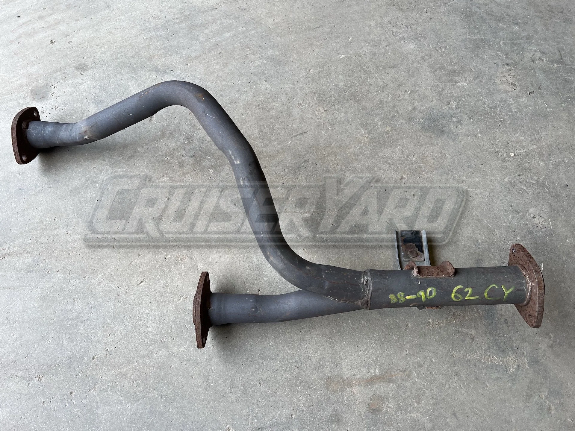

I am considering ditching my completely stock FJ62 exhaust from the manifold to the muffler. Cruiser Matt has a sweet stainless kit in development that has headers and combines the pipes into one collector. I just have to wait until Christmas to ask Santa (SWMBO) for one. Not sure if you want to check out Matt's kit first?Anyone got a 89 fj62 y pipe exhaust? If not I’ll weld one myself can’t find it
I’ll check it out good ideaI am considering ditching my completely stock FJ62 exhaust from the manifold to the muffler. Cruiser Matt has a sweet stainless kit in development that has headers and combines the pipes into one collector. I just have to wait until Christmas to ask Santa (SWMBO) for one. Not sure if you want to check out Matt's kit first?
