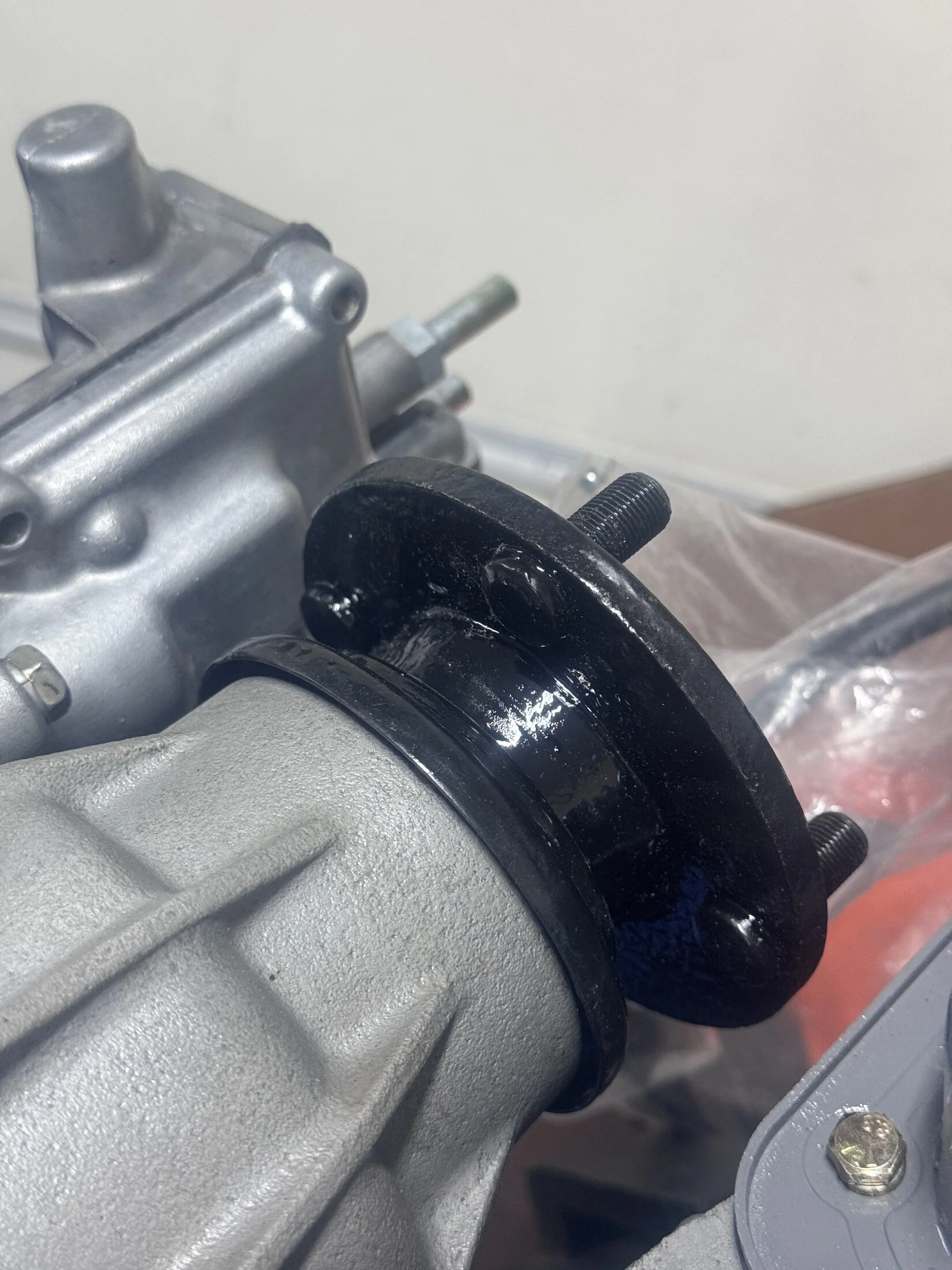

I think I would recommend you just go with underdrive transfer case gears, espceially since you have the transfer apart already. (I sell these too)
I don’t know what that is :( can you send a photo? What does it do?
You would replace the input gear and hi-speed output gears in the transfer case. It would act the same as having 4:56 gears.

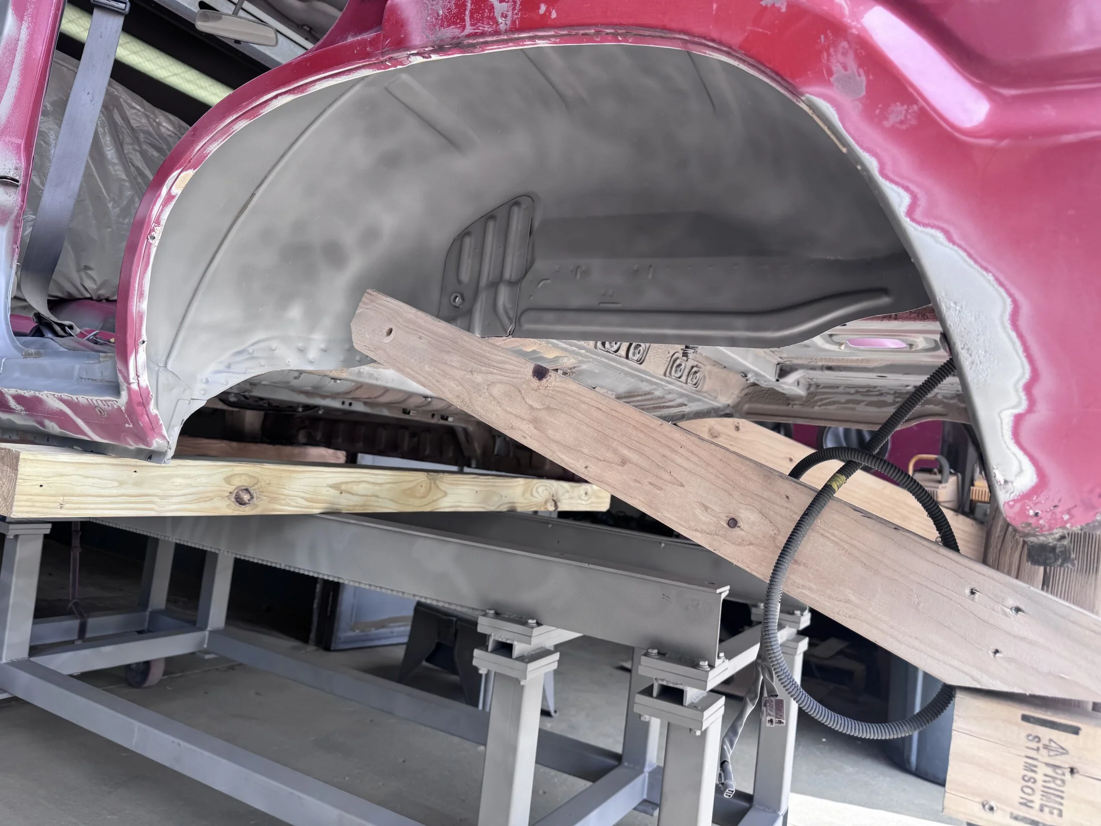

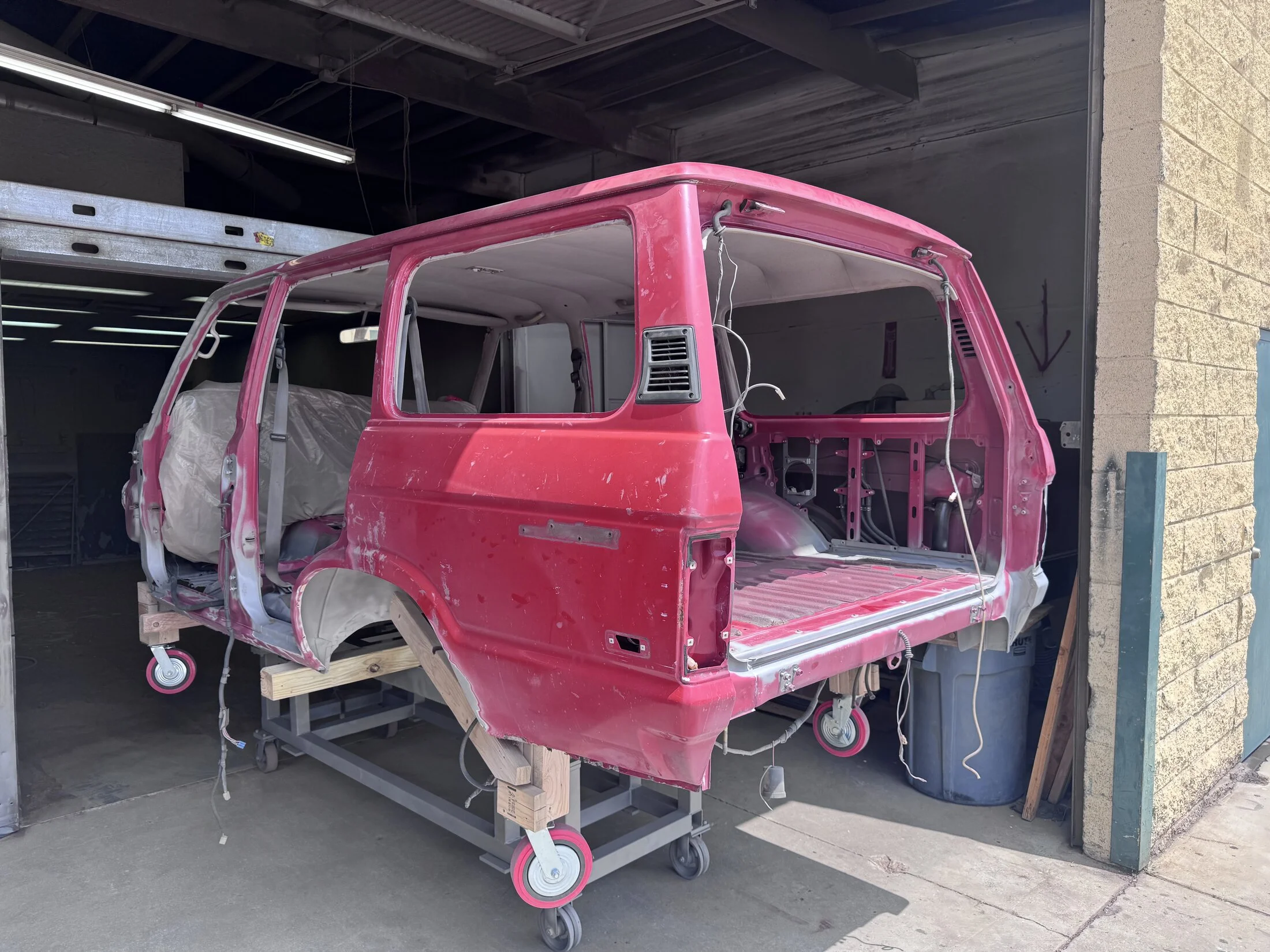

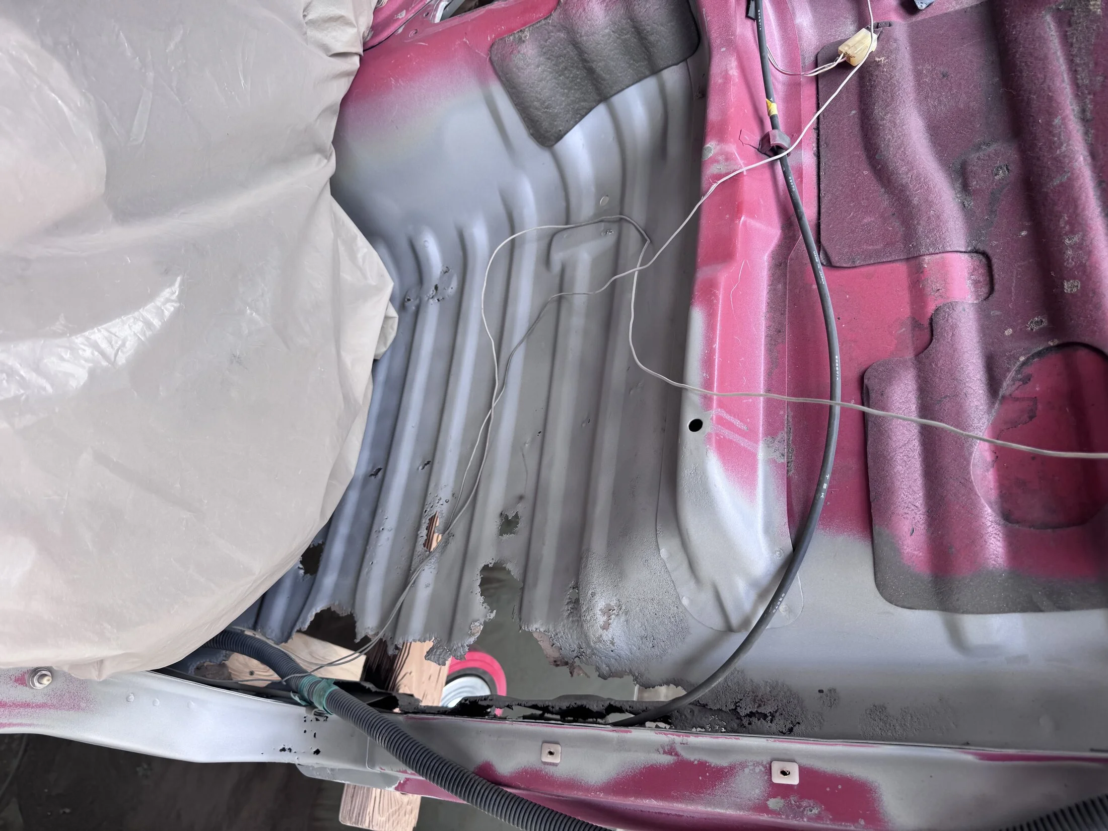

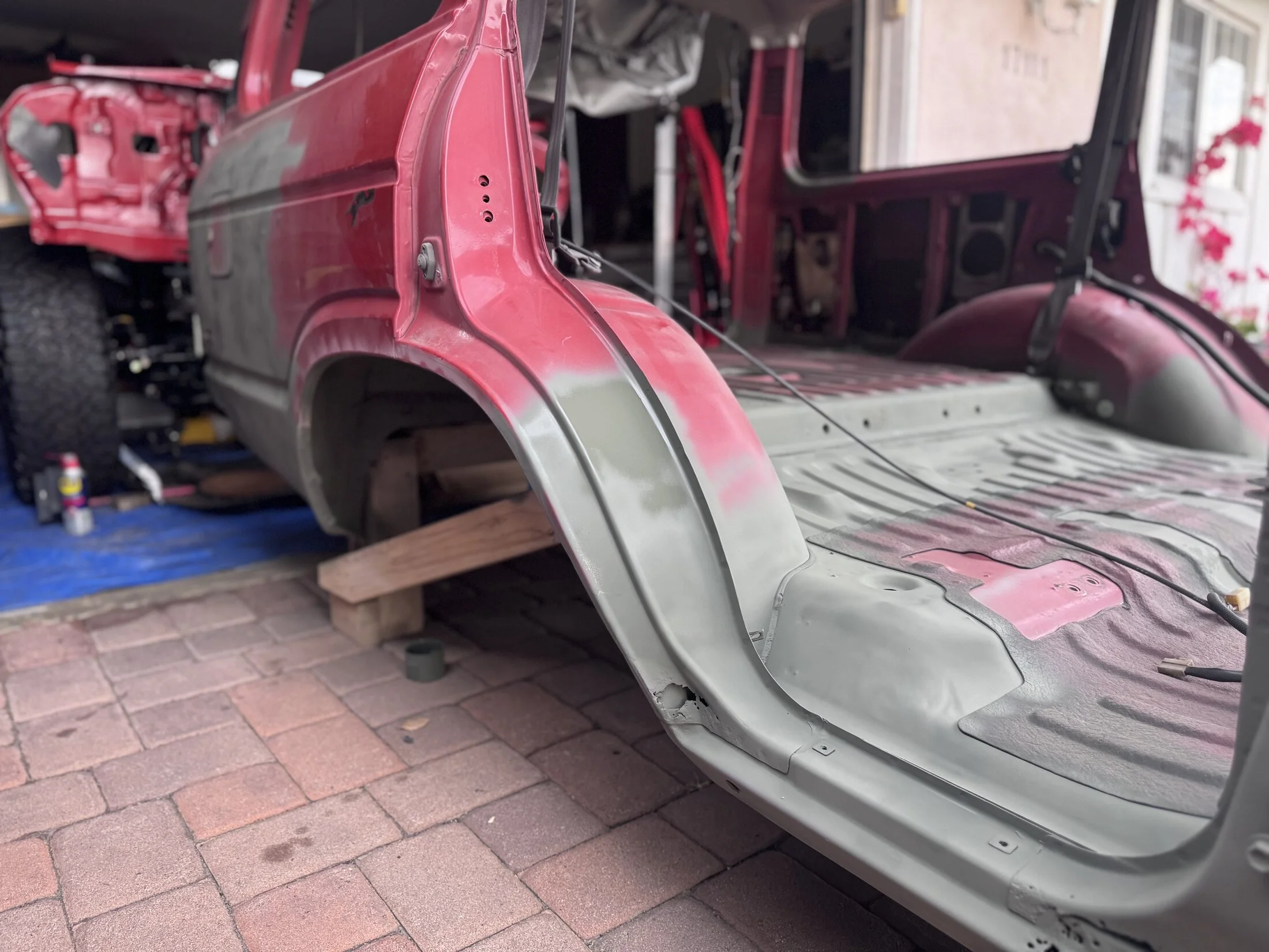

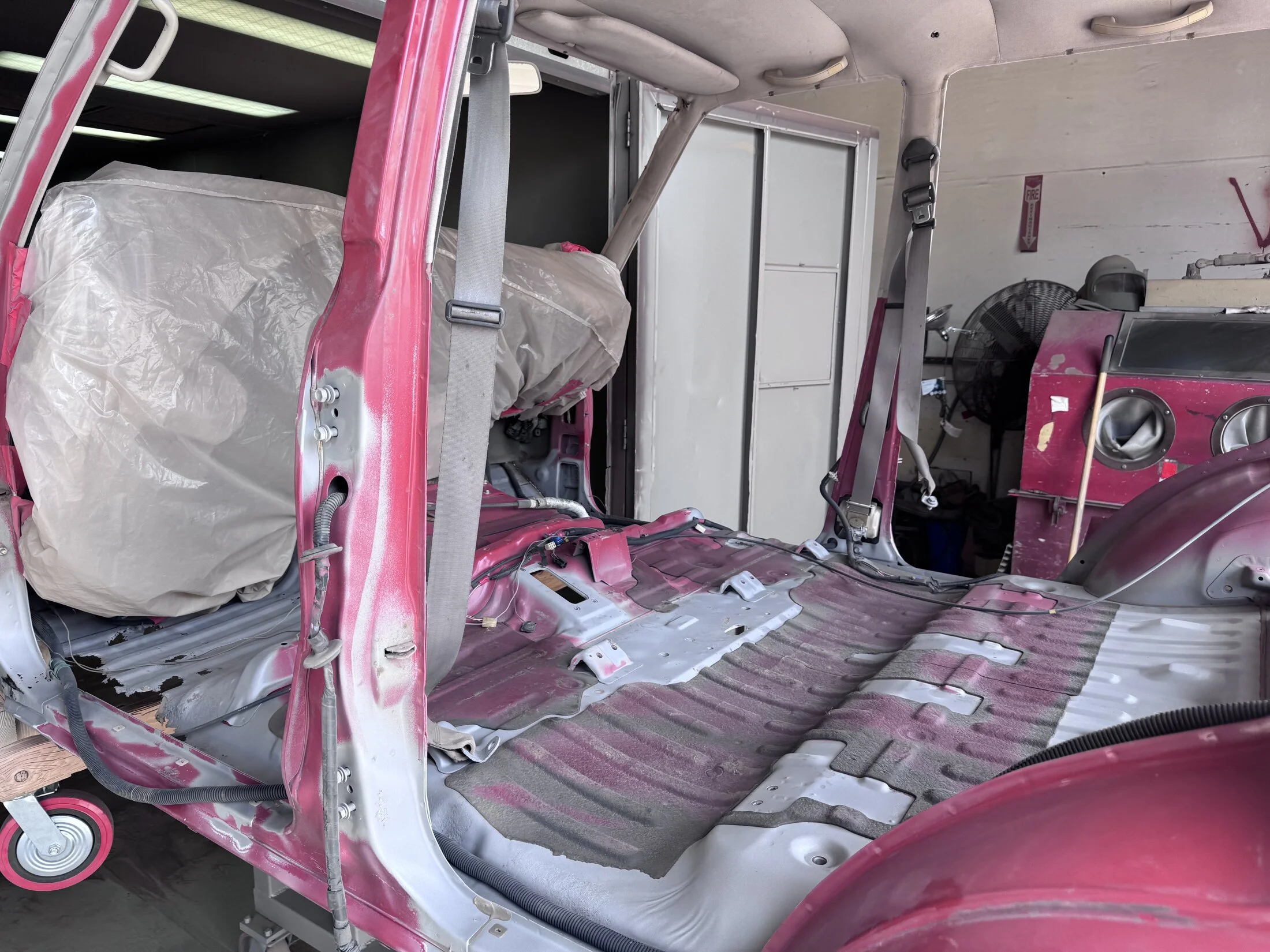

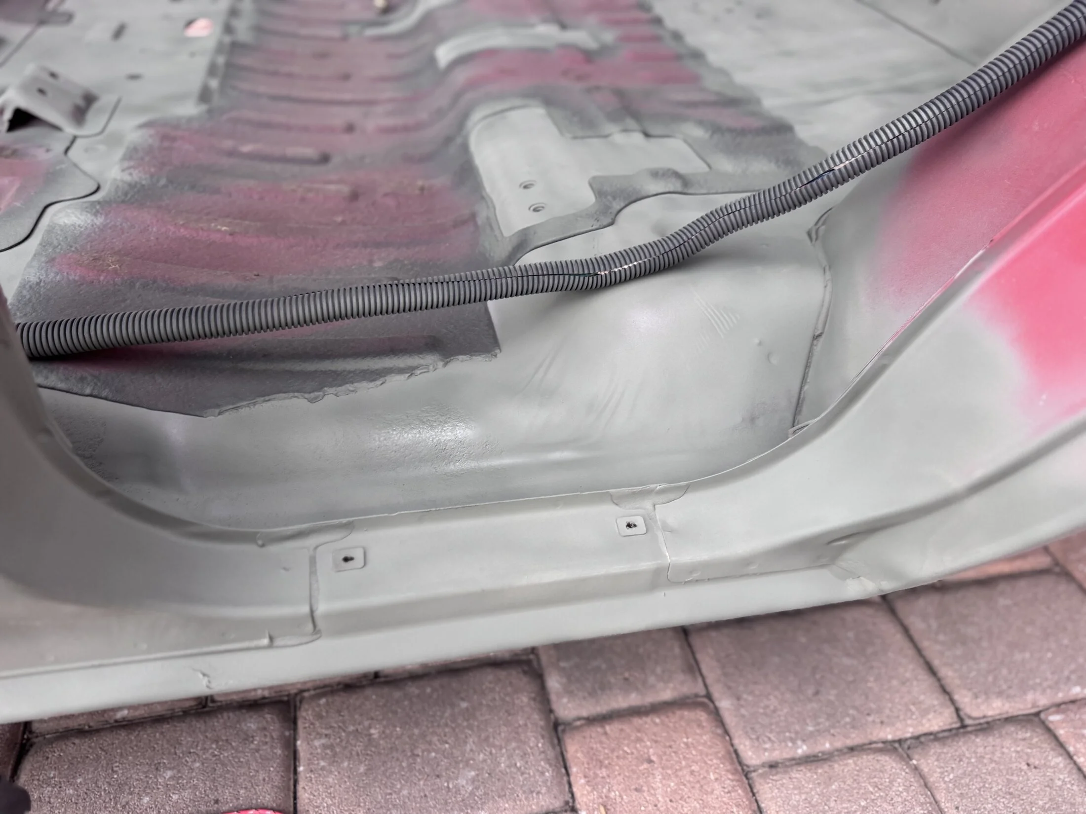

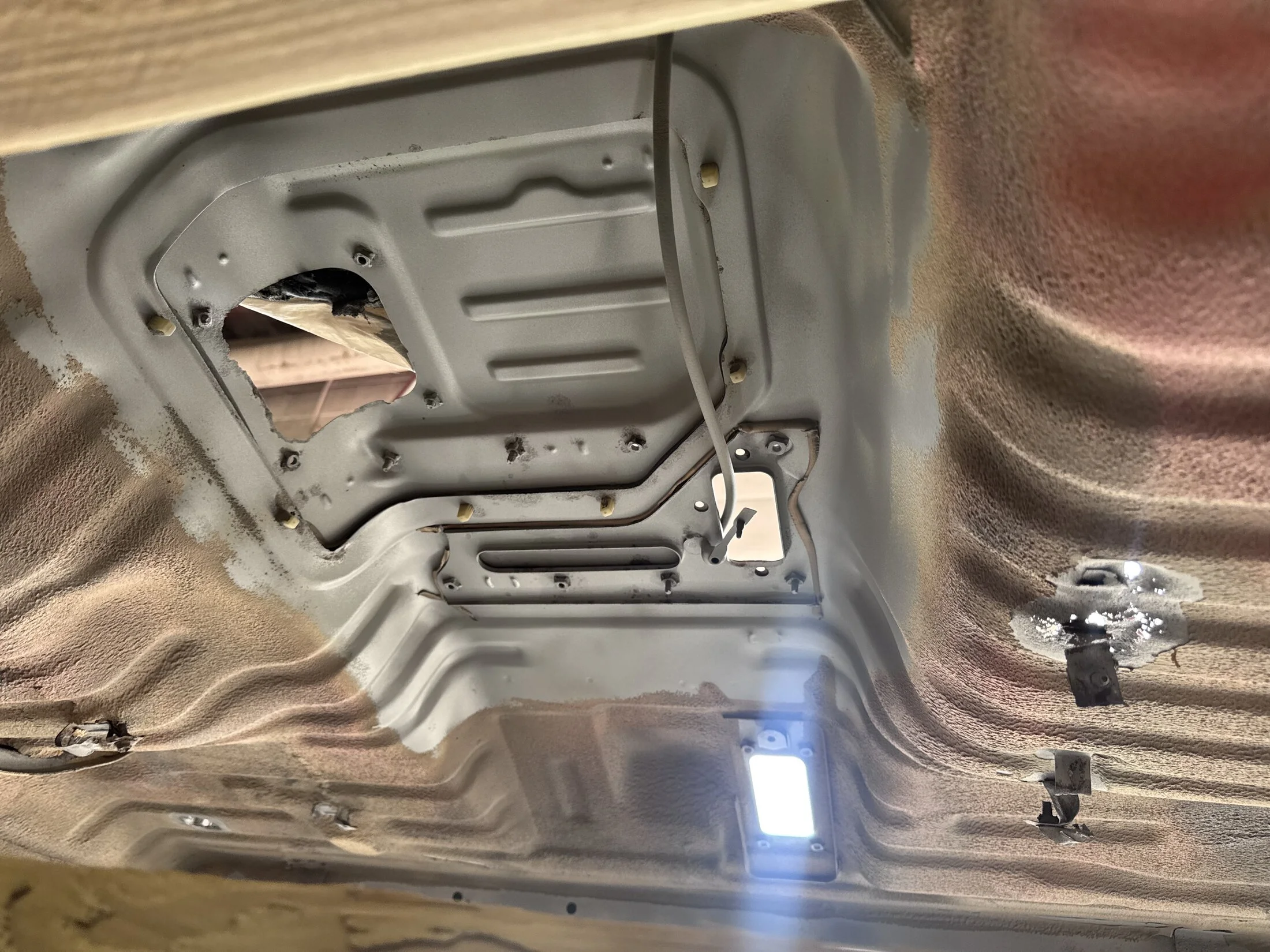

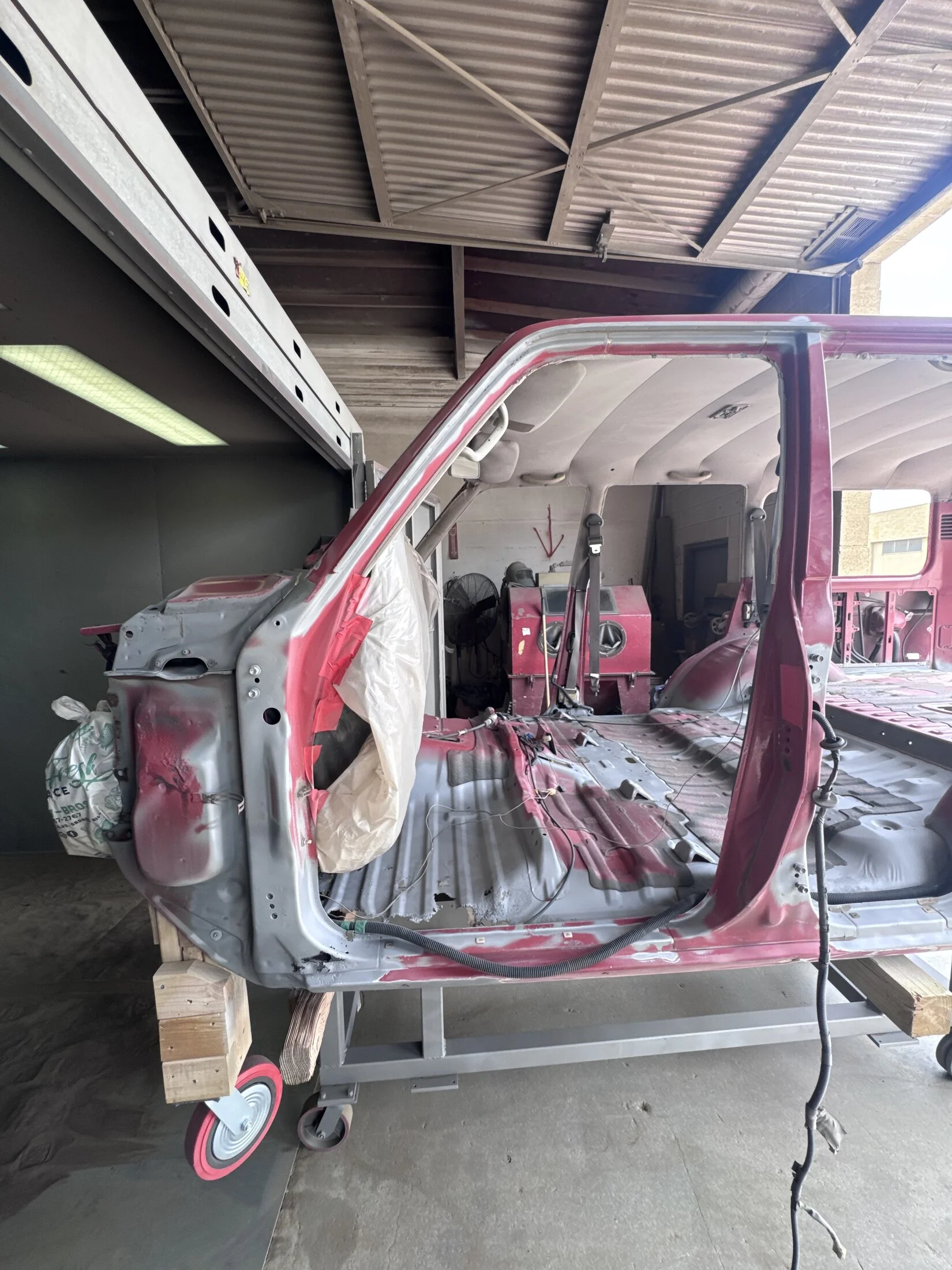

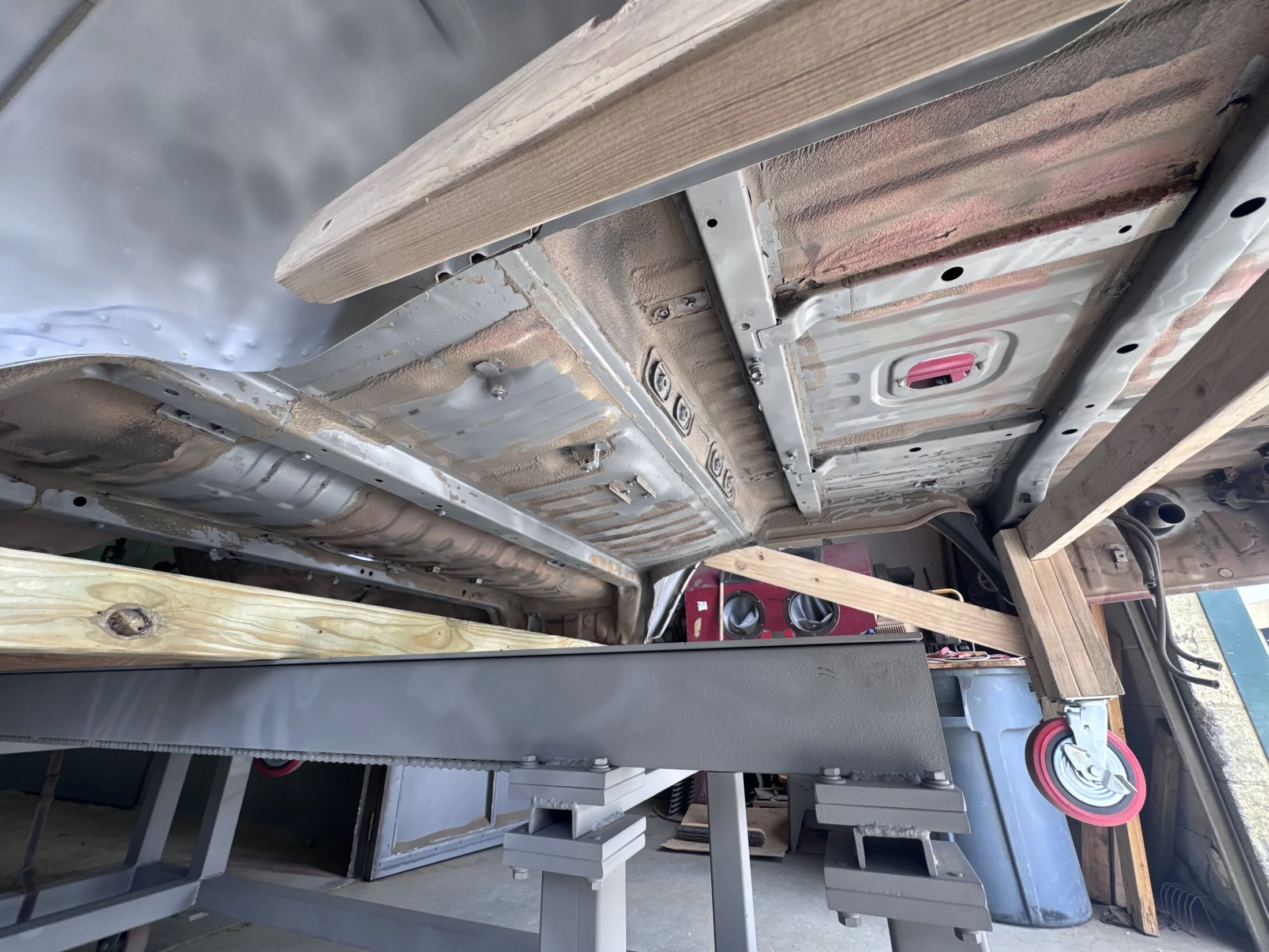

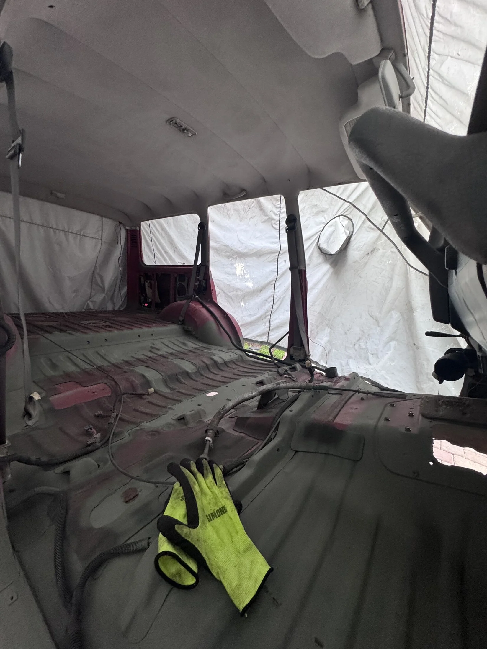

Sand blasted the rust off

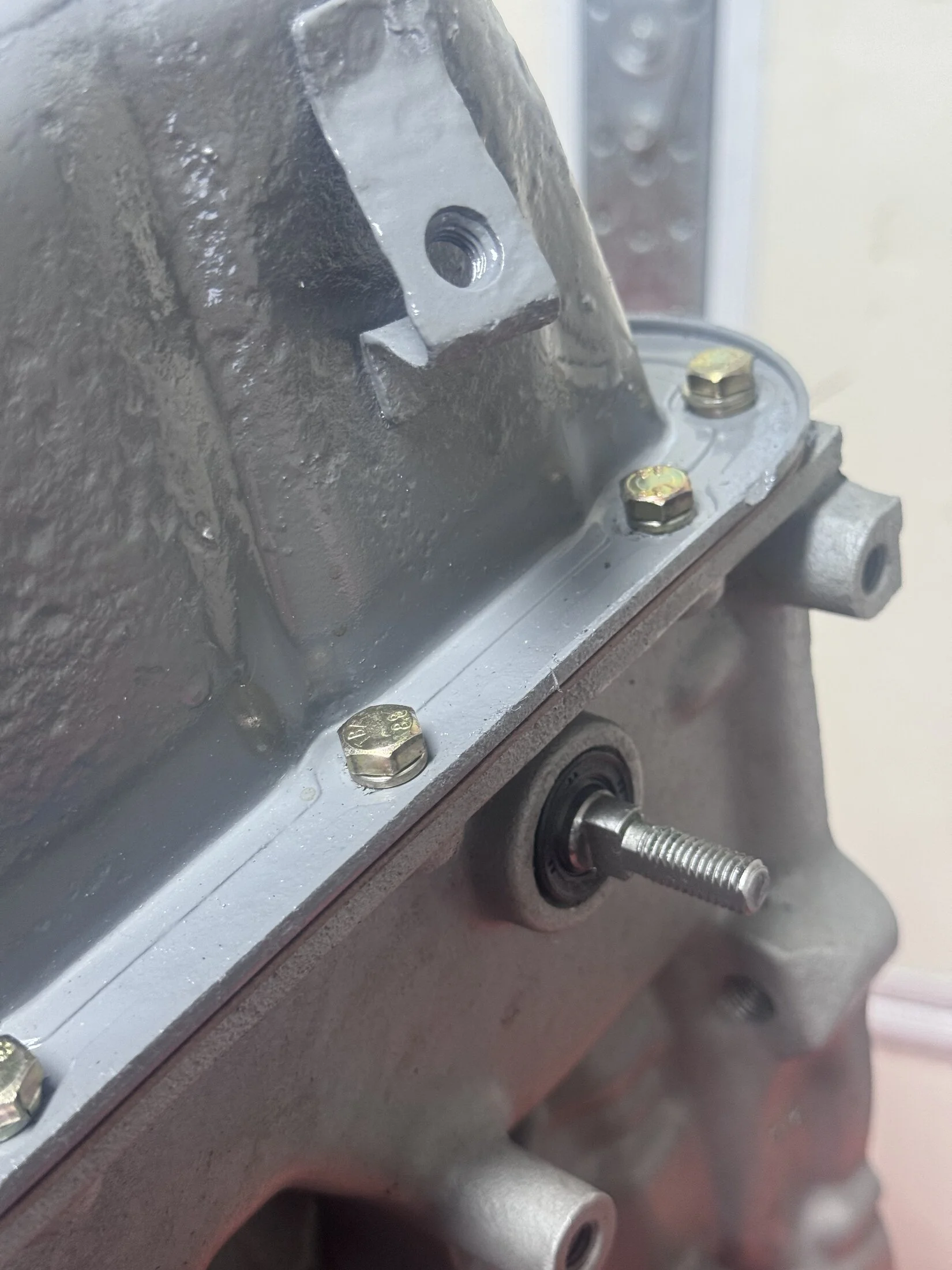

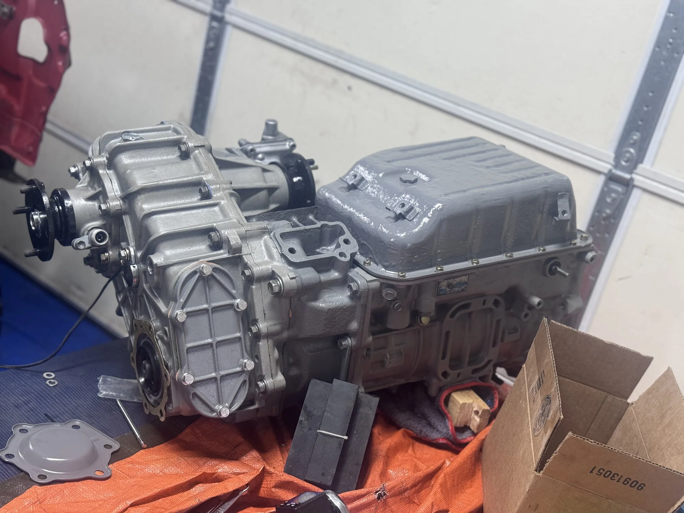

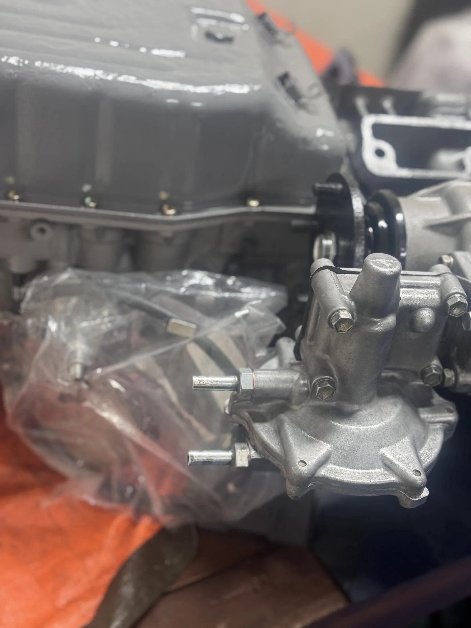

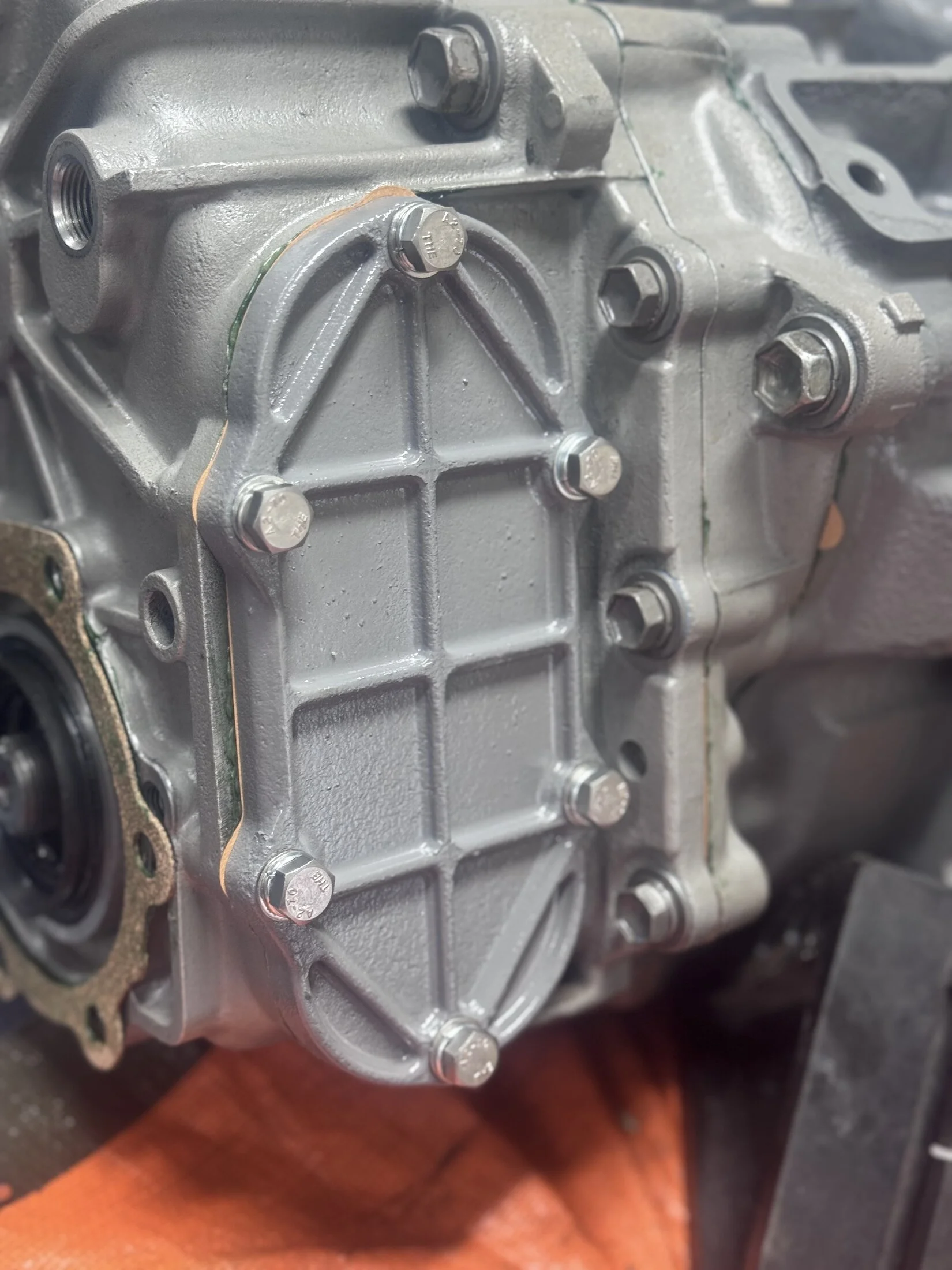

Transmission done, next I’m getting lockers most likely ARB air lockers since they’re true lockers front and rear and getting 4.88 gears front and back

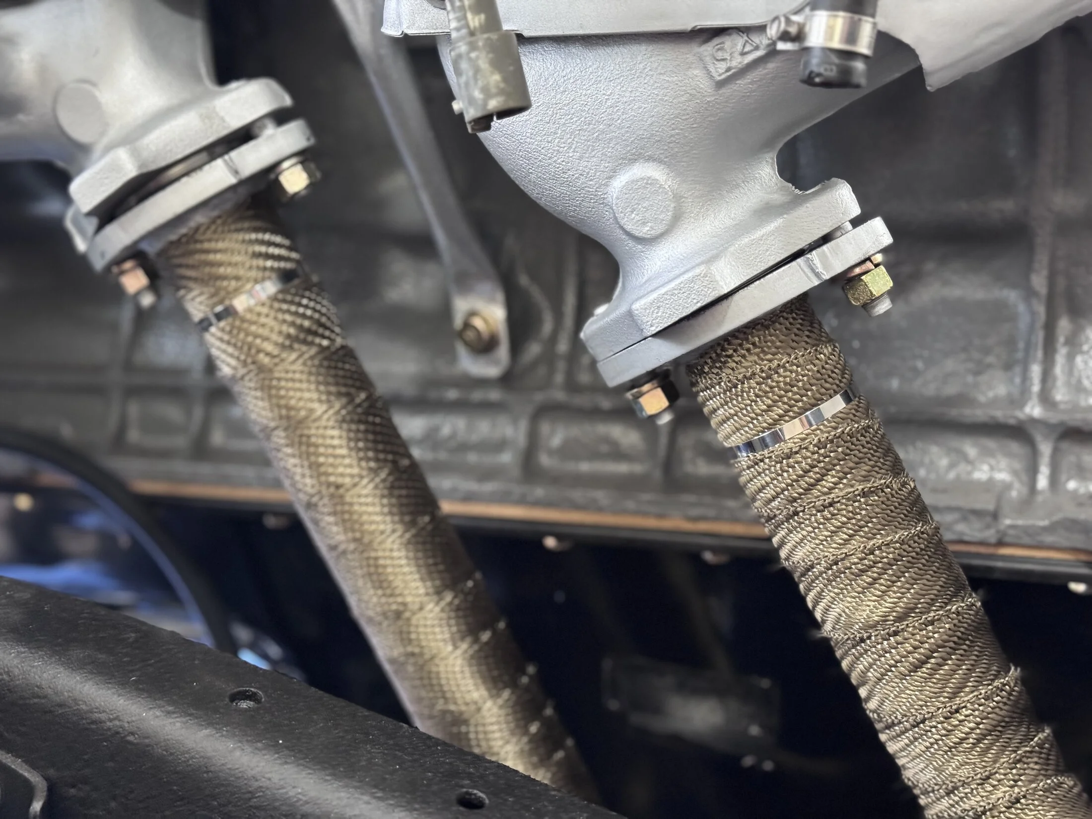

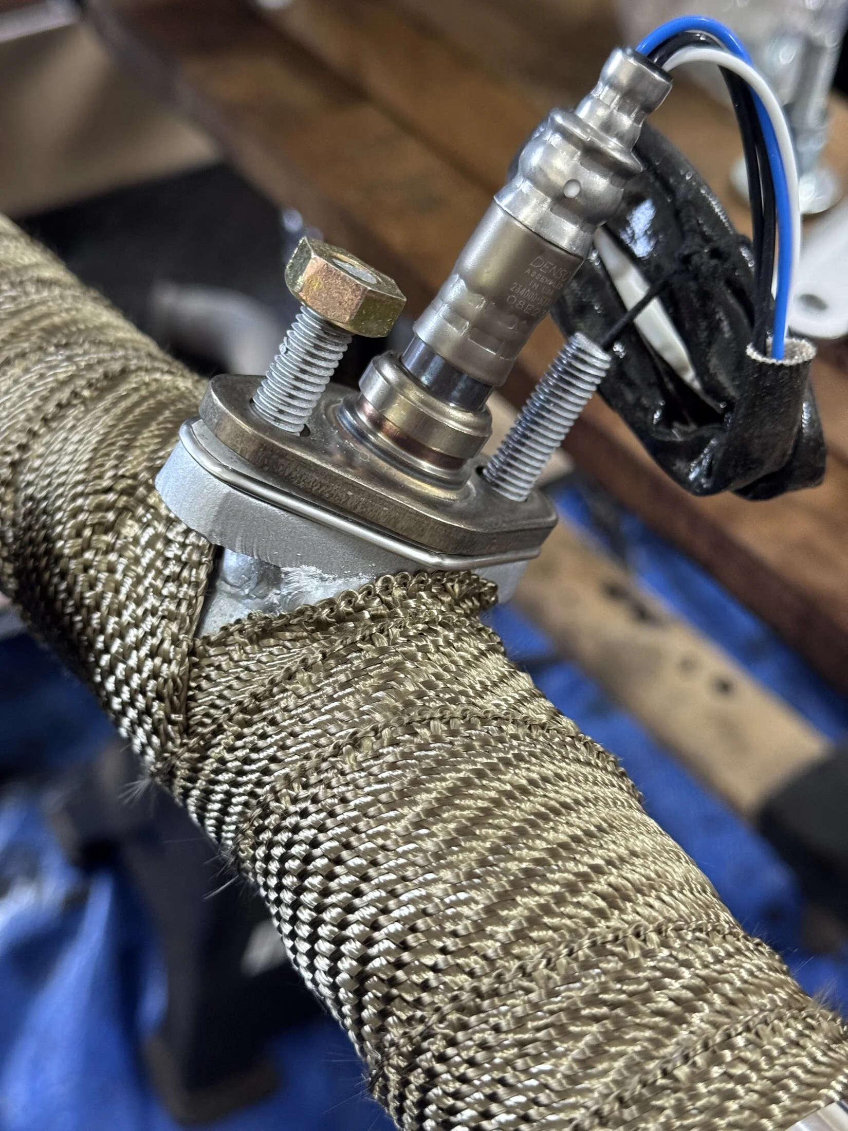

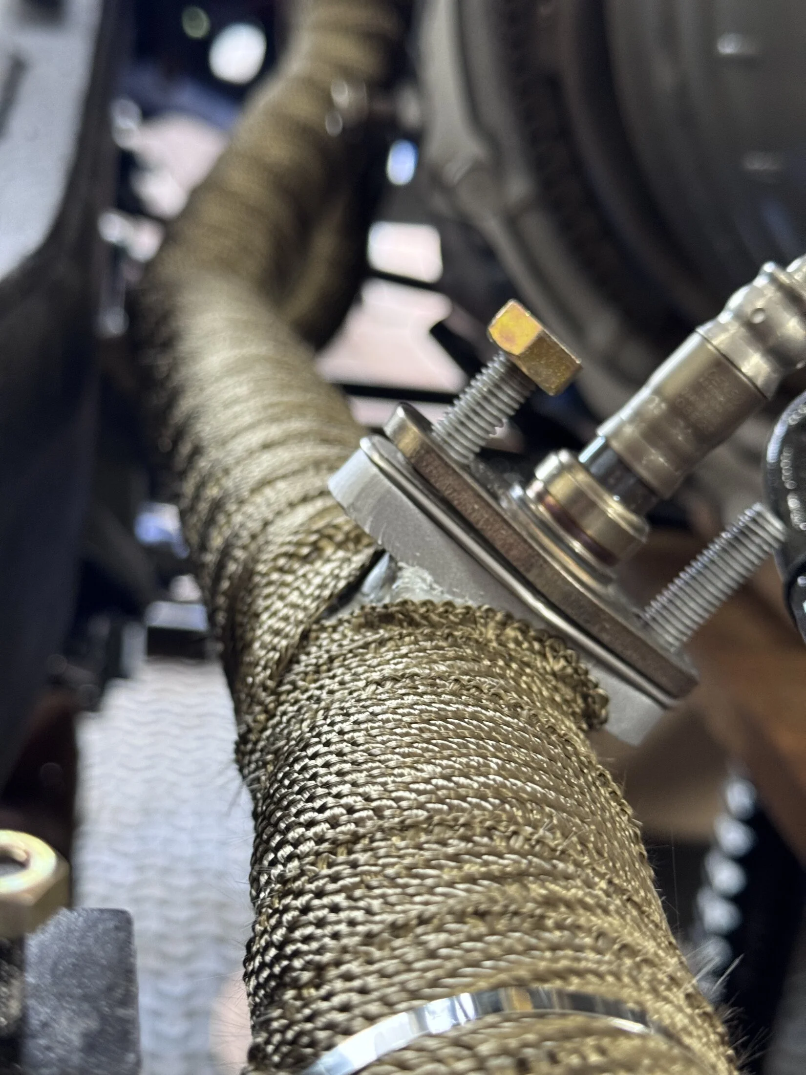

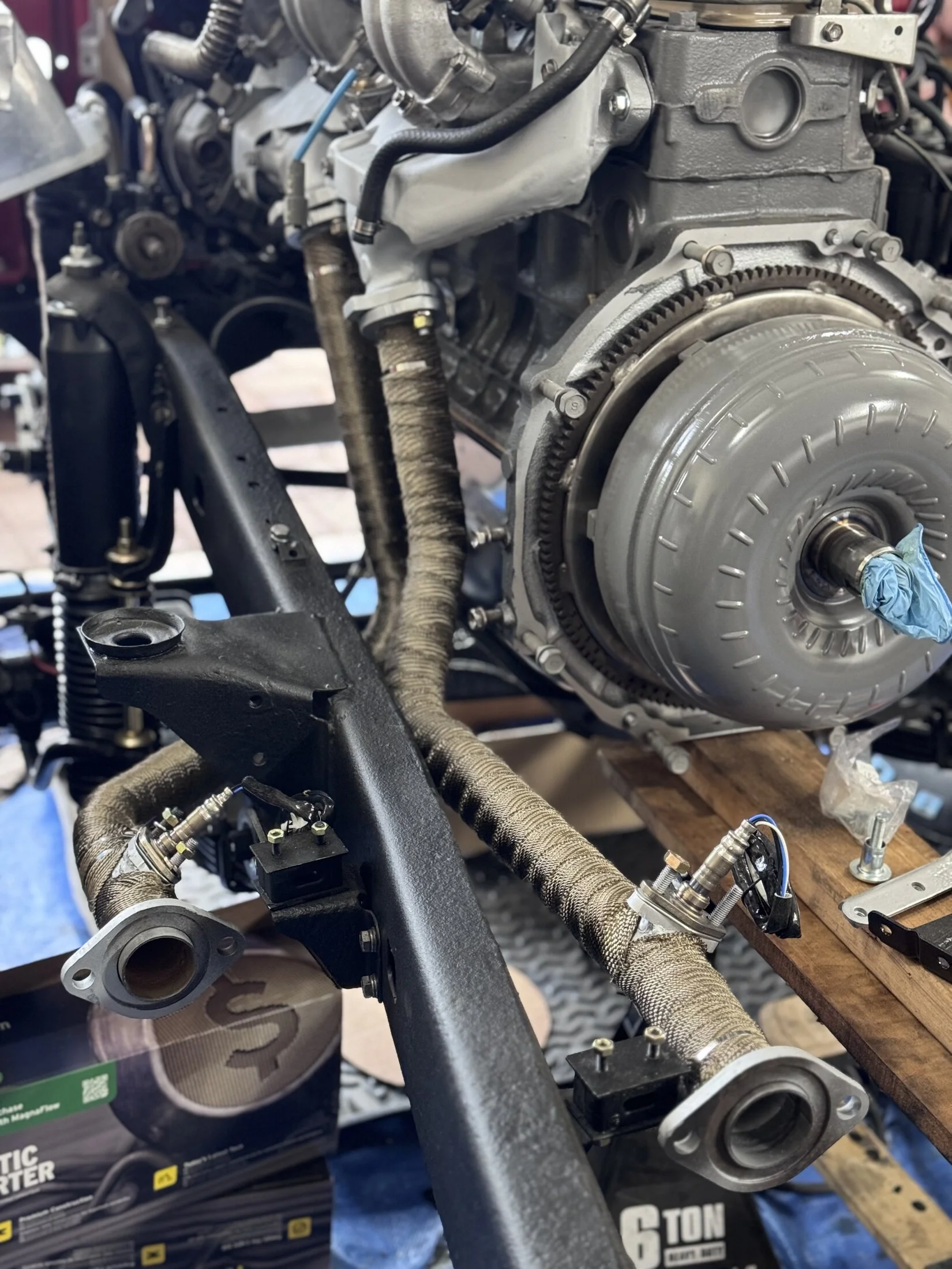

Design Engineering made in USA titanium exhaust wrap
  • Withstands 1800°F direct/2500°F intermittent heat
  • Promotes increased flow for improved performance
  • Reduces temperature & vibration breakdown
  • Extremely pliable for a tight and secure wrap
  • DEI HT Silicone Coating not required
  • Pre-wetting roll not necessary for wrapping
  • Hi-tech carbon fiber look

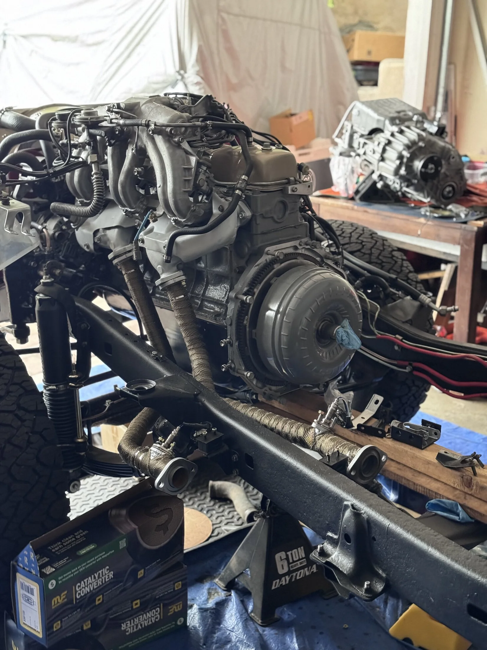

New oxygen sensors & catalytic converts coming in next $1k for the converters, California rip off at its finest
I noticed that the rotting / and rusting was under the exhaust, I’m guessing the heat from the exhaust unwrapped probably burns off the protective paint over the years and then moisture works itself in, so this wrap should be able to protect that and prevent it from happening

The exhaust wrap looks great! I will follow suit once I get the CM exhaust header kit at the end of the year. Great job!
