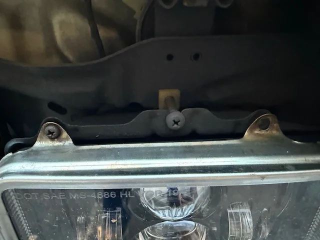

During the process, I replaced all of the screws that hold the frames that hold the light housings in the truck. If you ever do this or replace your lights, these will be a nightmare. Replaced with stainless screws, so hoping they will hold up for another 35 years.
HA. I just had the same experience while "replacing a high beam bulb real quick". She's sitting with the front end ripped out waiting on replacement hardware and grommets.

Yeah. I also ordered a bunch of replacement grommets, but was able to get it back together for the time being.

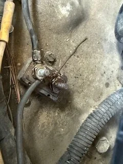

Anyone know what this is? Is it important? If so, any clue on part#?
Sits on passenger side wheel well, between washer reservoir and air cleaner.
Looks like a fried aftermarket circuit breaker notice both wires on the same terminal. Trace the wiring down and see what it hooked to or not hooked to and repair it the correct way if it's even needed.

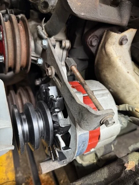

So, here's the current state of affairs. I got a lot done, but nothing finished.
I was able to get the bracket with the broken screws fixed and painted. A buddy of mine was able to weld on a bolt and we were able to get the broken bolts out. As part of this process, I cleaned up all the threads, applied some anti-seize, and got new hardware (where applicable) to make sure there aren't any issues in the future. When I removed the bracket, I was getting a little dripping (maybe a few ounces over 24 hours) from the water pump gasket. It appears the dripping has stopped now that everything is reinstalled and torqued to spec. I also got the Power Bastards (I just love the name) alternator mounted. The one I took off was a re-manufactured unit (no clue on age). Here's what that looks like at the moment.

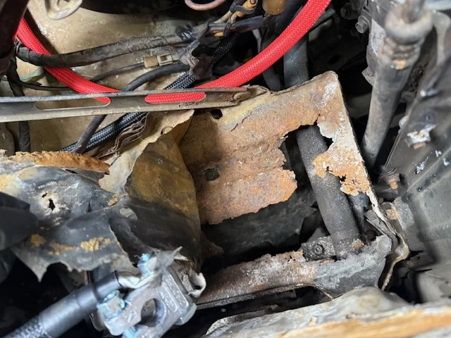

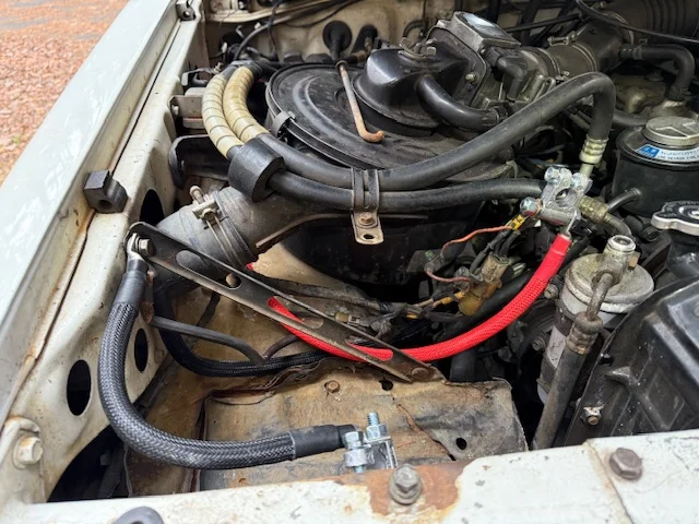

I also got the @Fourrunner battery cables all installed. Probably would have been easier in warm weather, but they are all in and are beastly. I left everything unhooked for 2 reasons. 1: I have new stainless trays incoming. 2: My tray is basically non-existent. So, that should be complete as soon as the new trays arrive.
Cables that are visible. You can see the quality.
What's left of my current battery tray. LOL

These cables and the stainless steel tray were one of my first projects. The cables really made a difference on cranking/starting and weird electrical fluctuations that I can only attribute to bad grounding. It all went away after that. My battery tray was in similar condition, basically peeled it away.
Yeah. I generally equate all electrical gremlins to bad grounds, bad relays, or a bad alternator in these old trucks. I may be wrong, but it's how I see it.
Very excited about the trays. Going to install one on each side. I'm not a huge overlander, but want the ability in the future to take longer camping trips and run all the electrical I want (fridge, inverter, etc.).

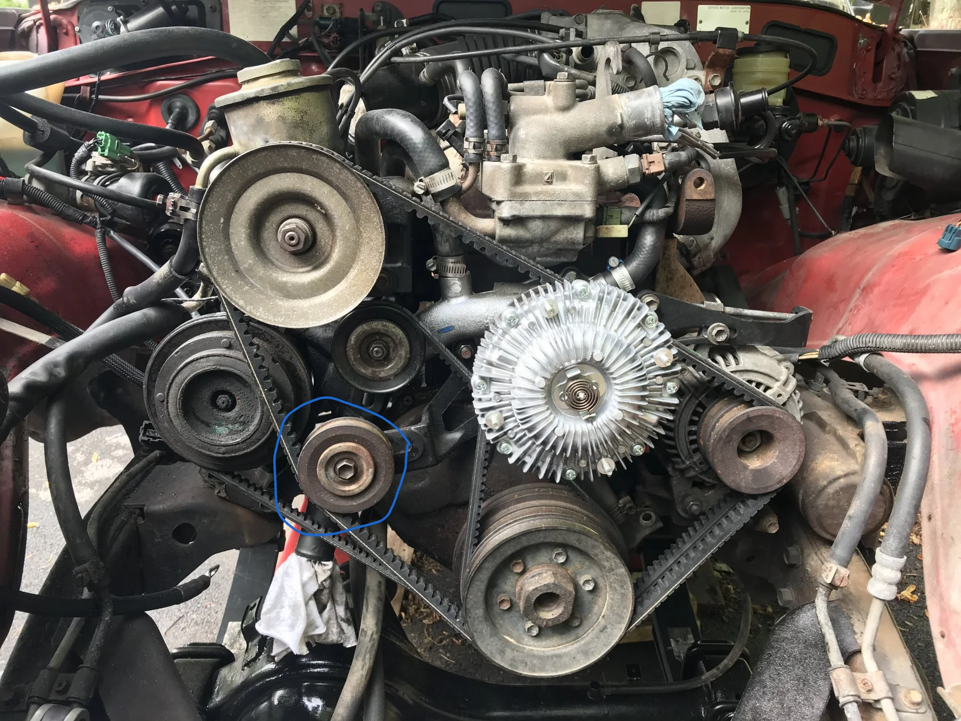

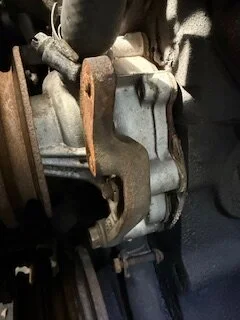

One of the reasons I only put on one belt was that I have new belts coming Thursday and I didn't want to do all three belts twice. The other reason is I was having trouble with this idler pulley. It seems that the bolts moves freely, but the pulley doesn't go anywhere. Can someone confirm that this is in fact supposed to move? Not my picture, but it is the pulley I'm referring to.

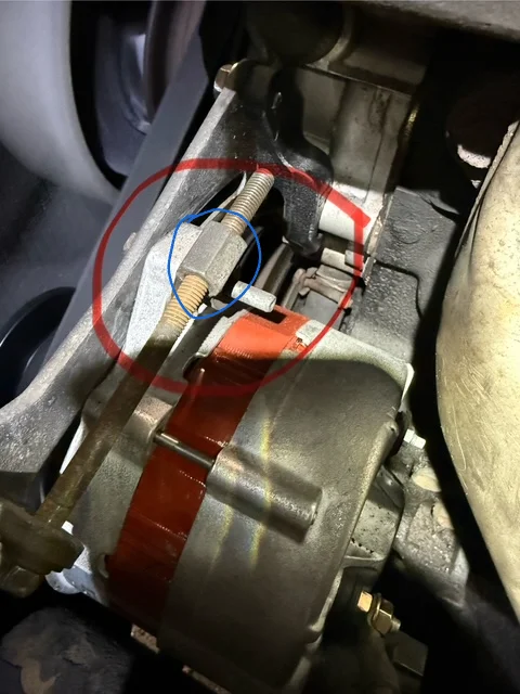

Next question: I was putting the alternator back together. It seems like the nut (circled in blue) should have treads that connect it to the bolt on the front of the bracket, but it doesn't. Is it supposed to "float" or should it have threads that match the bolt on the front?

Yes, that is the AC idler. Loosen the center bolt and move it with the adjusting bolt.
The bracket on the alternator just floats on there! Loosen the bolt on the front, use the adjuster bolt to tension the belt, then tighten bolt on front.
and the bottom bolt.

Ok. I think I circled the wrong idler. Lol
The on for the AC moved fine after I loosened the center bolt. The other idler (for power steering) does not move when the adjustment bolt is moved. Tried loosening the central bolt, but it just moves with the bolt.
Ok. Any ideas on this pulley? Adjustment bolt moves in and out, but the pulley is not moving horizontally as the bolt turns. Bolt on the front doesn't seem to be holding anything in. Thoughts? Ideas?
