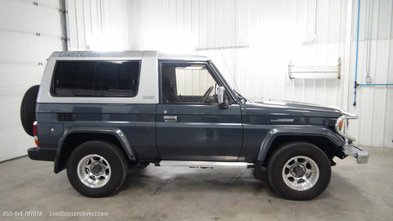

You guys are almost convincing me to put them back on. They are in pretty good shape. I thought the fronts weren't OEM, but maybe they are. I don't have a picture of the fronts but they look this.
the rears look alright. I'm not sure if the are completely OEM or a combination of OEM and aftermarket.
The fronts look like this with the cutouts. Not sure if they are OEM or not. This seems to be the only reference I have found to them.
The flares are aftermarket.
These are factory for the LX. Base models got the flat ones with the notched bottom.
1897916
1897917
I do not recall OEM flares appearing before the HZJ73 in 1990. The flaps for those integrate with the flare in the same manner as an 80 Series.
I borrowed this from Land Cruisers Direct. Thanks Steve.
1897926
Very likely. They do make them. I have considered them but I resist drilling into my fenders and quarter panels. I really like the OEM flares but the cost is astronomical and figuring out how to get all the brackets in the right places makes my head hurt. I'd almost rather buy an HZJ73 to get them. :doh:
