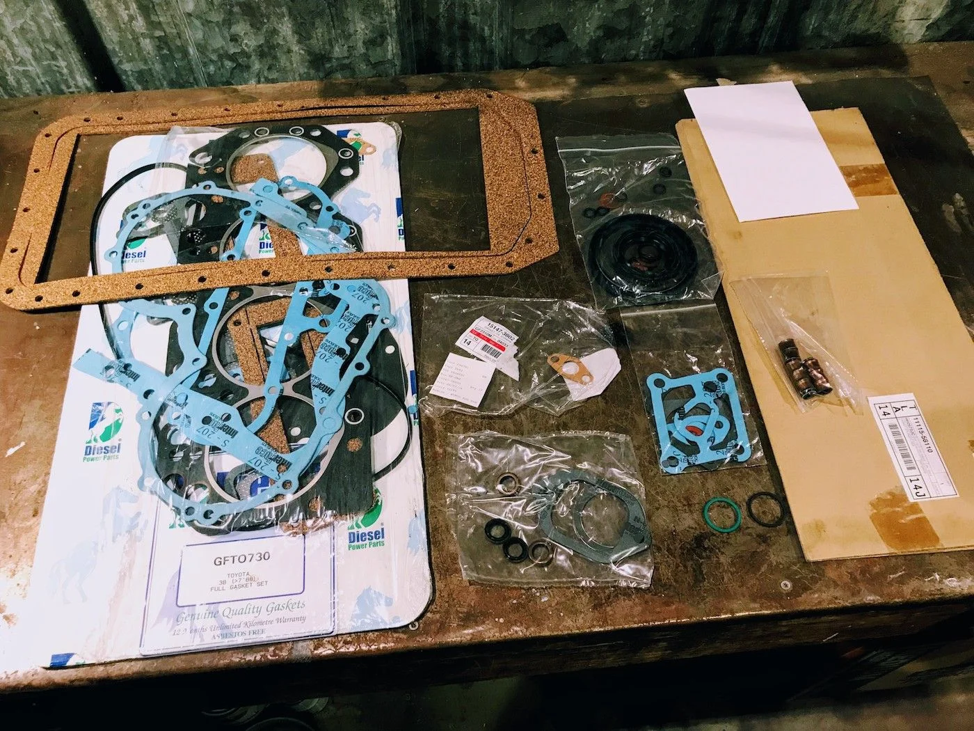

Gasket stash along with OEM headgasket on right. Should have everything I need. I went ahead and ordered an H55F input seal and gaskets for that cover since I'm right there. The rear main didn't seem to be leaking, at least not much but the bell housing had oil so might as well take care of that.

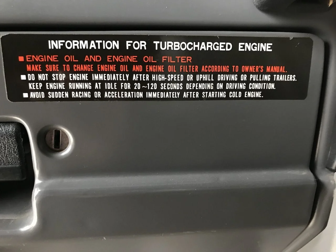

Not sure how much "sudden racing" I'll be doing but hopefully it will scoot along good.

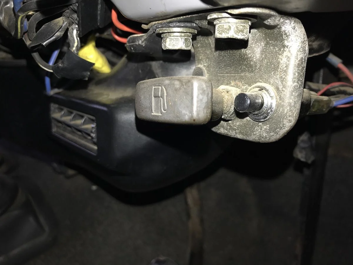

Mystery button by fuel door release. I have no idea what this goes to. Ejection seat? Oil slick? There are aftermarket air horns on this BJ74, but this seems like a weird place for a horn. Any common mods that aussies know about? It is a momentary button.
