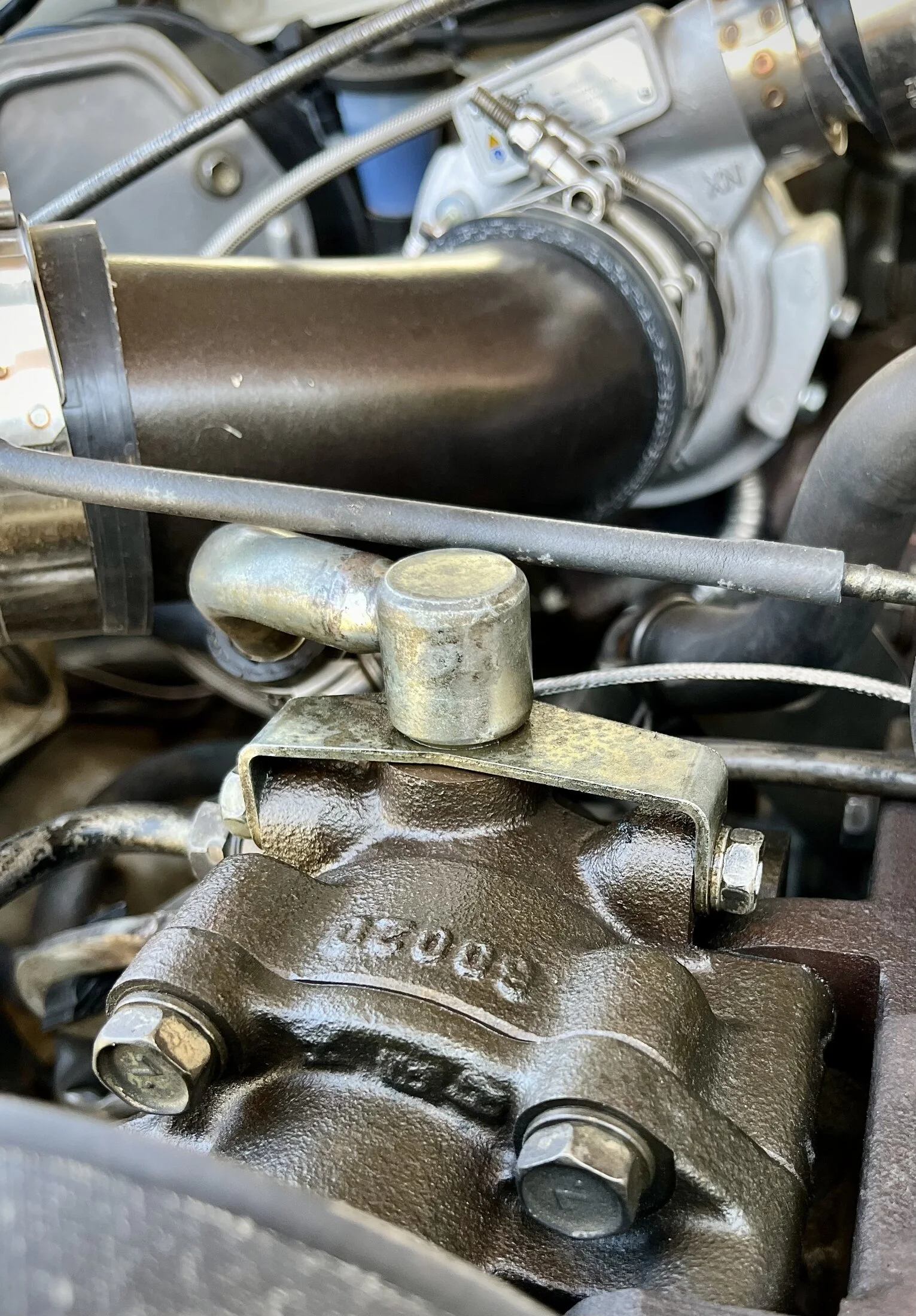

Replaced the O-ring on the top of the power steering pump. 96711-19013

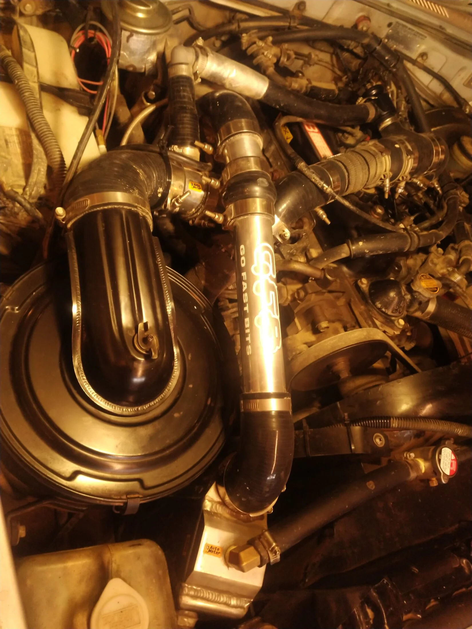

You have the 13BT right? If you search for my old BJ70 thread you can see what I did for an inter cooler.

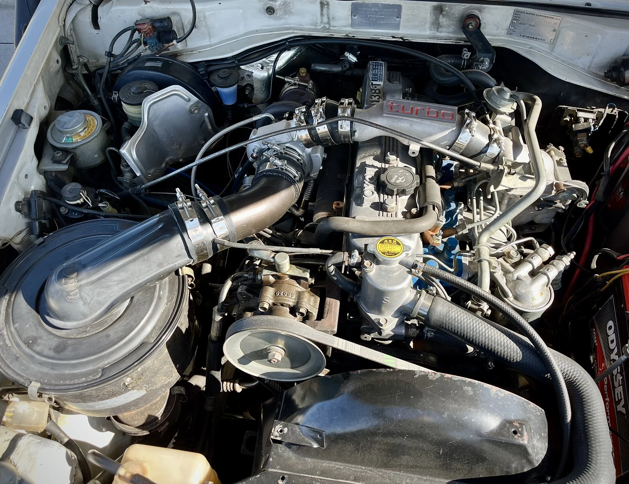

Here’s under the hood. Packed
This thought keeps bumping around in my

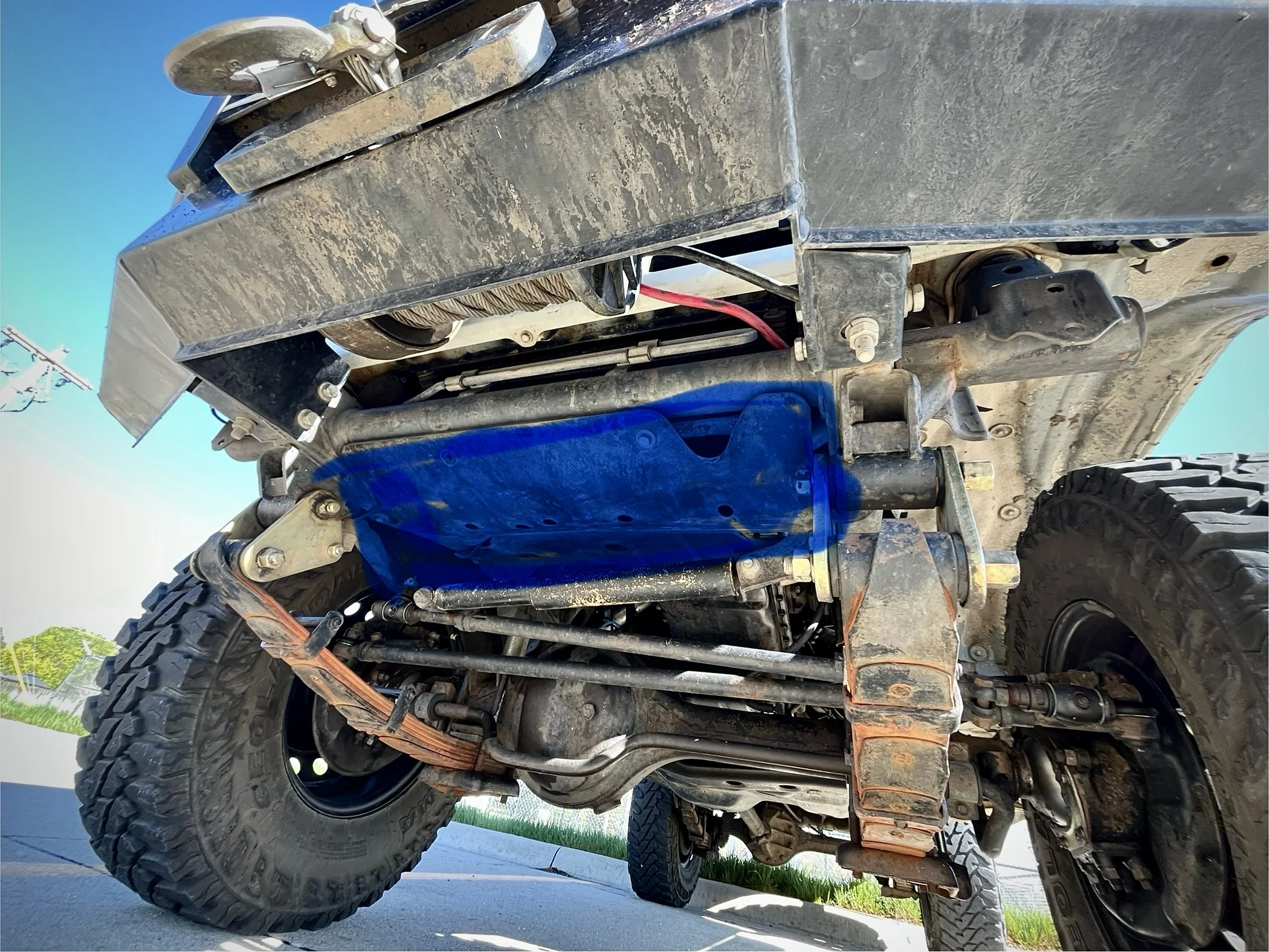

Head. Now it’s less protected for tough rock crawling and road debris, but I honestly don’t know how much of that rock crawling I’ll be doing in this 😂
Place it here, downwardish facing. Possibly that shield spaced down or some protection under there. I might not be able to find a decent size to fit there.

@Rigster

yeesh! There doesn't even appear to be enough room to change your mind in there!
I think if you want to keep costs down you might need to look at changing out the airbox solution you have to a K&N type and plunk a W2A in that cavity.
I would avoid putting anything down low where crap from the road and trails would beat it up... even without rock crawling, it would take abuse over time down there, imo.

Yeah. Not a lot of great options on the narrow nose 70s. That said I don’t need much cooling as it doesn’t really get that hot. I’m sure it’s still better overall to have that safety built in for hot weather/hills.
The only reason I think of the bottom mount is just ease of install and there is a lot of airflow. This isn’t a short cart inches off the highway so it should be fairly protected.
You will be well aware VW TDIs use side mount inter coolers on front of the tire that has to pick up a ton of crap from the tires.
Doesn’t make my idea a great idea…
You can see my steering stabilizer has taken rock chips and hits, but that was painted 5 years ago with cheap spray paint so it’s not actually taken that much damage all considered.

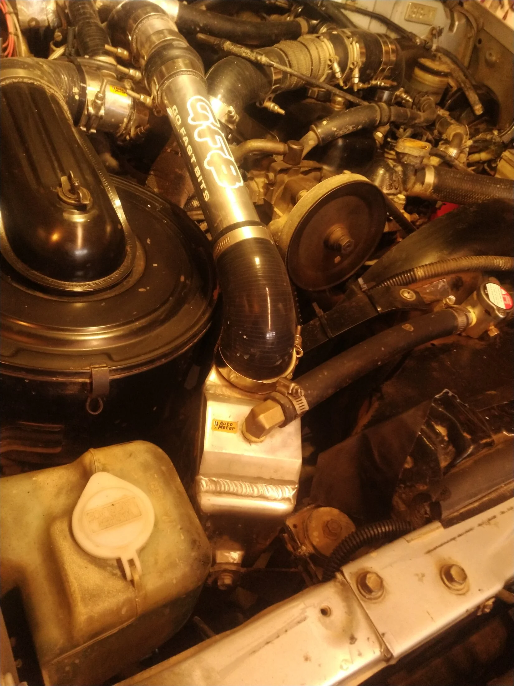

i put my water to air vertical where the rad overflow is and moved the overflow to the other side of the rad, works very well and lots of room for a heat exchanger in front of the rad
is it a pipe clusterfaulk.... yes
is there a better way to run the pipes... yes
but the room exists and is doable
reclocking the turbo to point down and running the charge pipe on top would be a better way but im not tearing this apart

Very cool , thanks! I was just looking at that spot at lunch. Decent room for tubes and such there. Clocking the turbo would make a big difference in routing.
