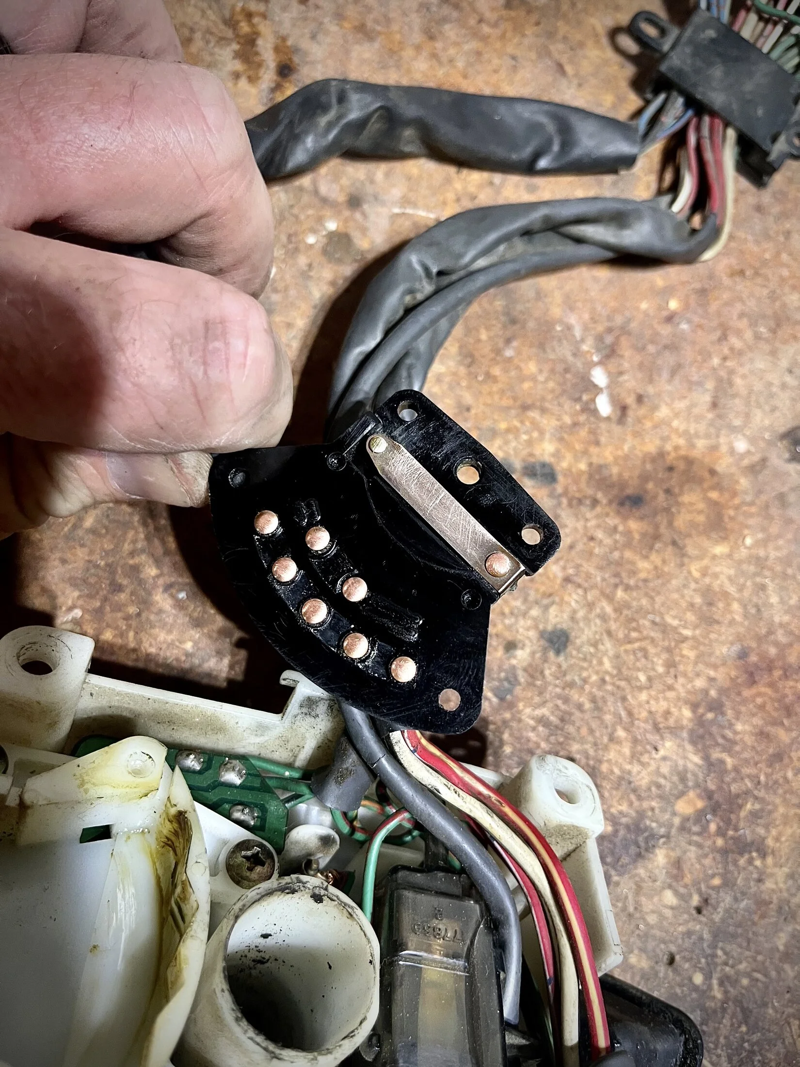

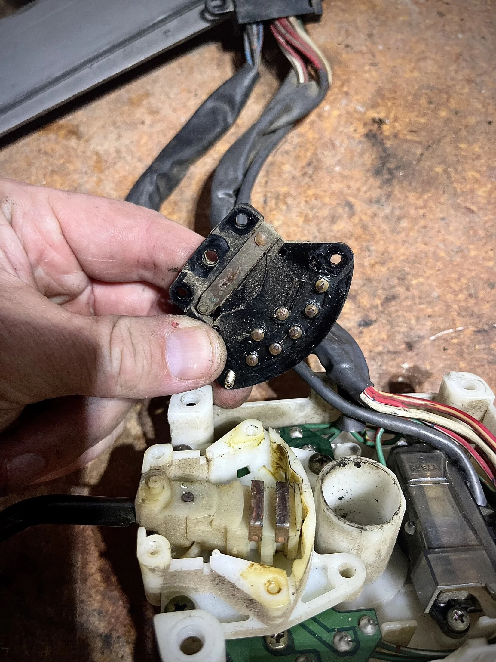

Anyways, my wiper mist/spray wasn’t working on the stalk, and wipers are sloooow. Also prepping to do another test with @CruiserTrash high beam indicator fix fornthe koito kit.
Take off steering wheel, remove the clamshell, mine is just barely hanging on. I need to look up part numbers for a new one.
A couple screws and 1 connector later you can pull off the turn signal/light unit.
On the right side where the light/turn stalk goes into the unit, 2 screws hold a bracket that keeps the stalk in place. Under there gets really dirty and you can clean it. Use deoxit or something similar. CAUTION! There is a spring inside the stalk with a small ball bearing at the end. That’s what gives it the ability to stick in place for bright/low and hold back for brights.
If you lose that, you can find another, but it will be a pain.
My other issue, my wash/mist function doesn’t work. Pulled apart the back side of the wiper section and you can tell all the contacts were just dirty. Cleaned, light sanded (possibly too much) then put back together. A little dielectric grease will help.
My mist/wash function now works. Somewhere back in Australia, the bogan fix was to tap into the wire and add a button by the fuel door release that activates the wiper spray…😆🍺
Now my wipers still aren’t great and barely go across the windshield if I’m not moving. You can also hear buzzing in the left /passenger footwell which is where I assume the wiper relay is, when it really slows down.
Is my motor shot, or is this a ground issue? I cleaned the grounds on each side of the body in the footwells I read about before. I’ve lubricated some of the linkage before, maybe time to do it again? Any other thoughts?

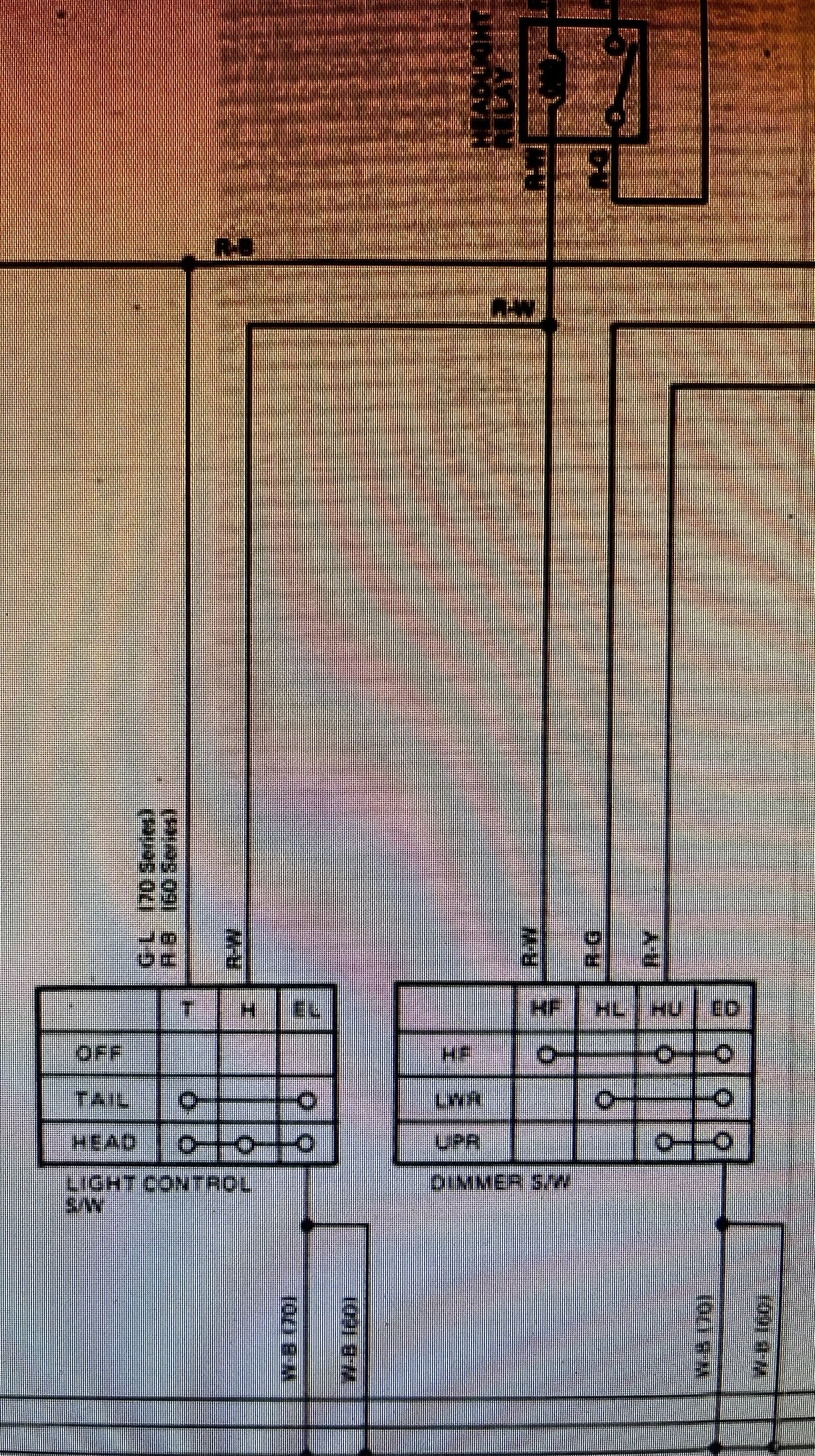

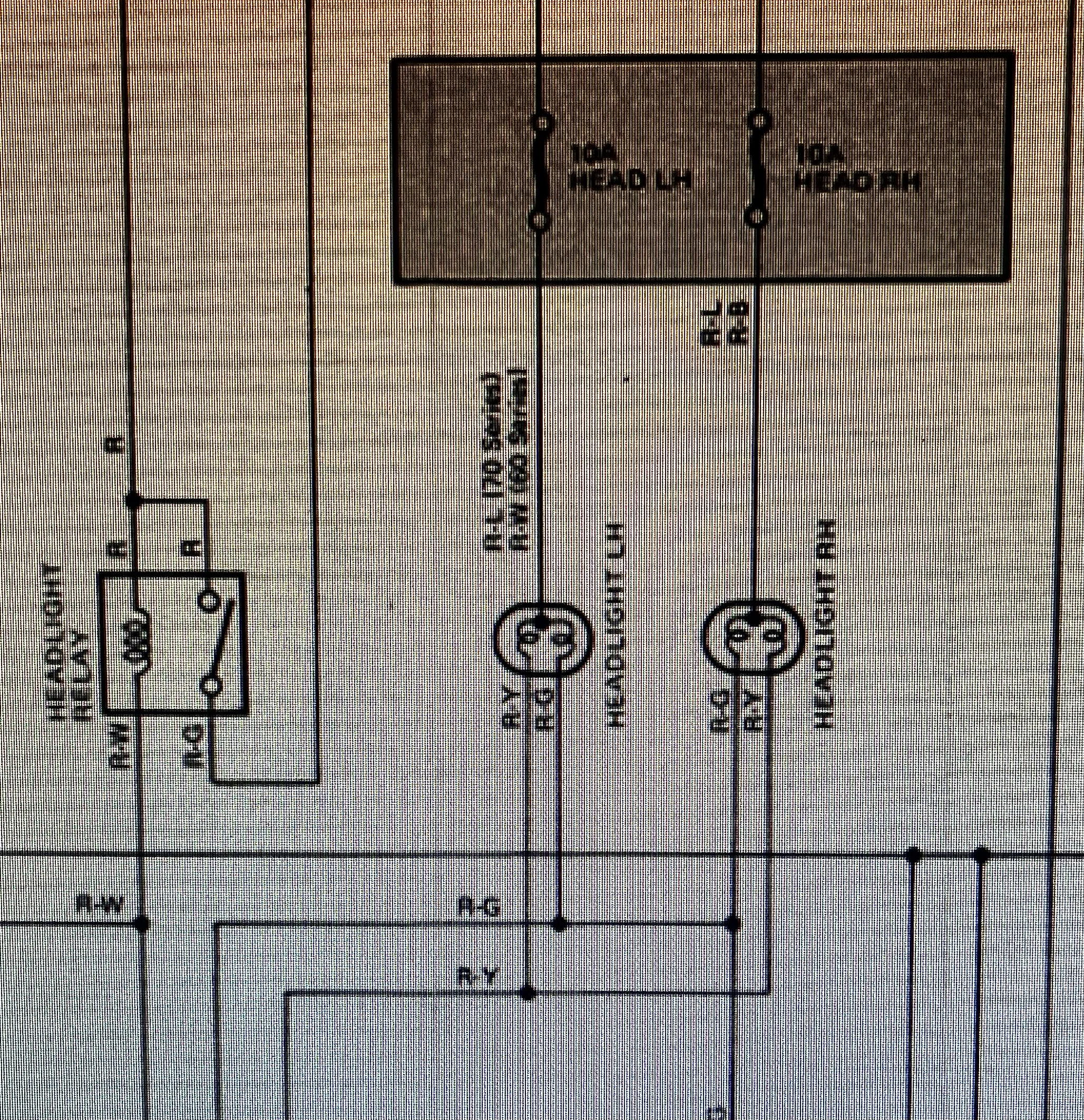

I found these remarks in the diagram referring to 60/70 differences…hard to see, but is that what you are talking about where they are switched.
No 60 series here :) just a 70.
Not sure when I’m headed down there, not sure I’ve ever driven my 70 to Denver 😂 Might be taking a small trip here soon, although I don’t know if I’m going that way.
Just the arrangement of the wires at the H4 plug.

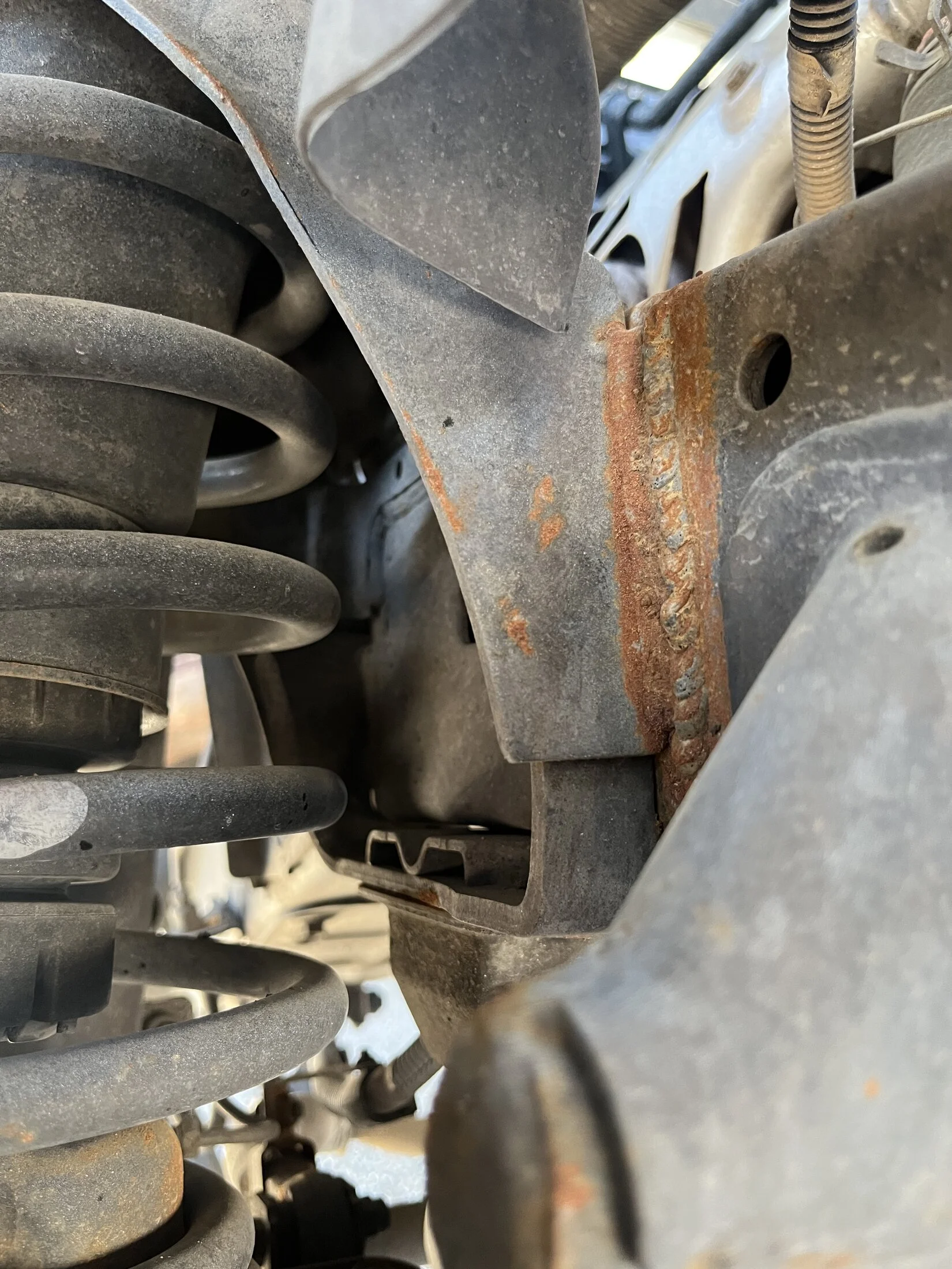

80 series story…I checked out a low mileage 117k 80 series this week. I knew it was repainted badly by the pictures, but a locked low mileage 80, I can put up with a lot.
Paint, awful…like Temu Maaco bad. Drove it, lockers work, drives like 118k I’m torn but going to offer less. I start digging around more, hmm appears the replaced the whole front clip…with a white one, then painted the rest white.
Slept on it, came back the next day. The number in my head is $4500. Climbed under it again.
Hmm, Mr Toyota had a bad welding day…
Checked the other side
😳. The frame had been cut off and replaced! Badly! I felt bad for the guy, he paid $18k sight unseen right after pandemic. I said really, I’d buy it for $2k for the drivetrain/axles but if I were you, I’d try and sell for more, but explain the situation.
He thanked me, was a good guy and sold to the next person for around $4-5 I think. He did disclose it to them.

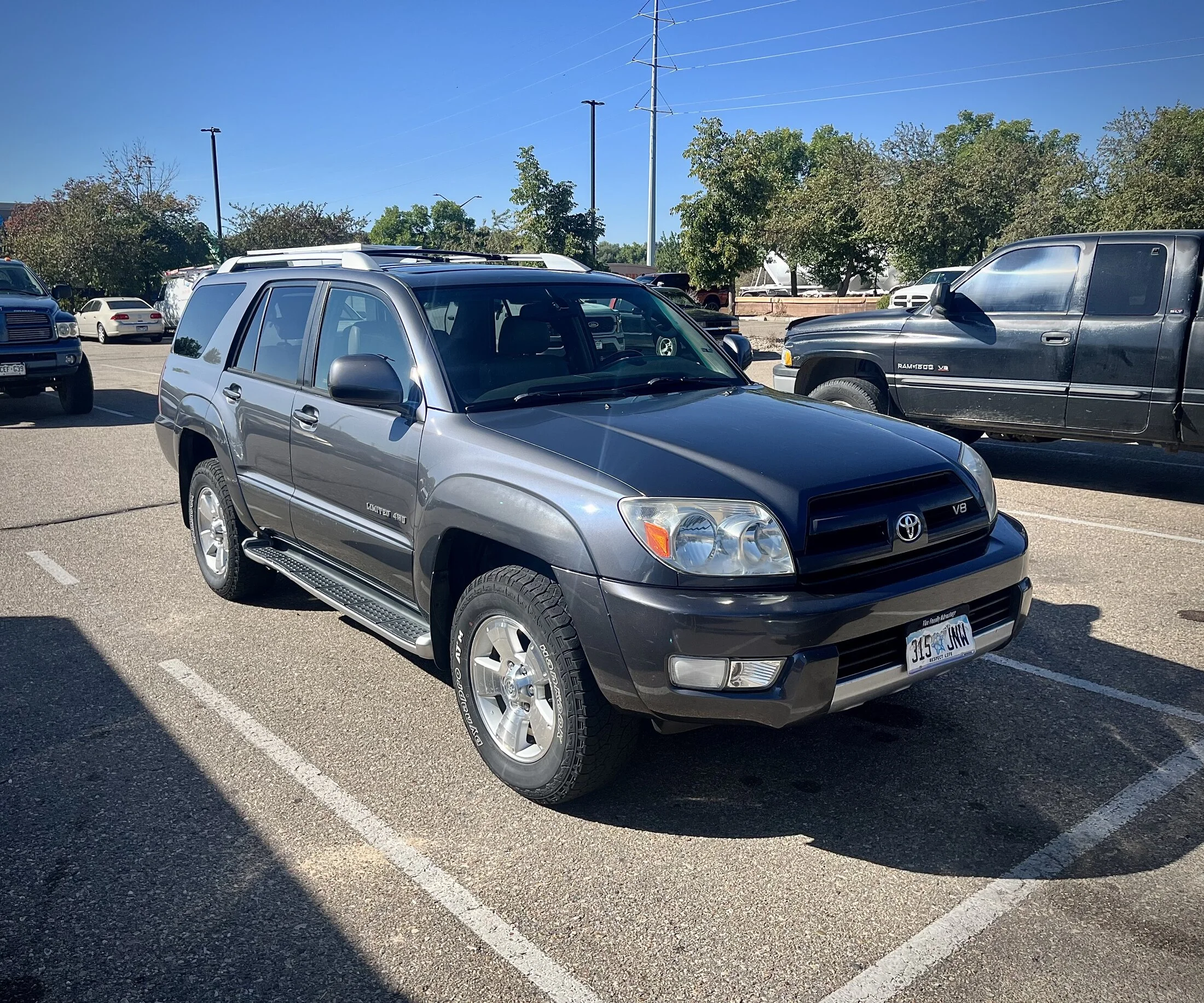

1 guy had a manual 3rd gen 4Runner. Looked clean, was literally 3 miles from us. We get there, all paint is jacked, 1 rot hole behind fender and just sloppy driving. He admitted 2 years ago this thing is $3-$3,500. He was asking $8k. $8k!
Instead we found this 1 owner v8 2003, with higher miles but really clean yesterday….for a little over 1/2 of what the 3rd gen guys were wanting. Inside is fantastic, clean local car.
