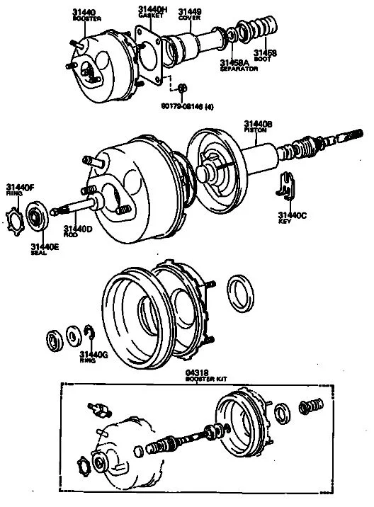

so if it's not one thing, it's another. I talked to John (gofast) when I first got my cruiser as well as Alberto about my clutch suction noise and they helped me figure out it was my clutch booster. I've had the cruiser for a while with the issue hoping to be able to not have to dump more money into it, but it is making more noise (suction) and I want to get it fixed before it completely takes a s*** on me.
can anyone recommend if it should just be rebuilt or if I need to replace the entire booster? Toyodiy shouws part numbers for internals and the entire booster. Also, what is the purpose of the clutch booster can it be possibly eliminated (dumb question I know), I have never seen one on my pick-up and other manual vehicles.

yes, it can be eliminated
have you done a vacumm test at the booster?
have you pulled it off and taken a look at the seal at the back?
they are really simple to work on.

The booster can be easily rebuilt, had mine rebuilt locally for about $200. Before that I tried a chinese replacement, did not last long. They are reasonably easy to remove not that big deal.
Or they can be eliminated, would need a few parts and I am not sure the firewall pattern is the same, just fit a manual setup from a lower spec model. Need the master cylinder and possibly some rod from the pedal to cylinder, toyo diy should show the differences.
Any brake shop should be able to rebuild it easily.

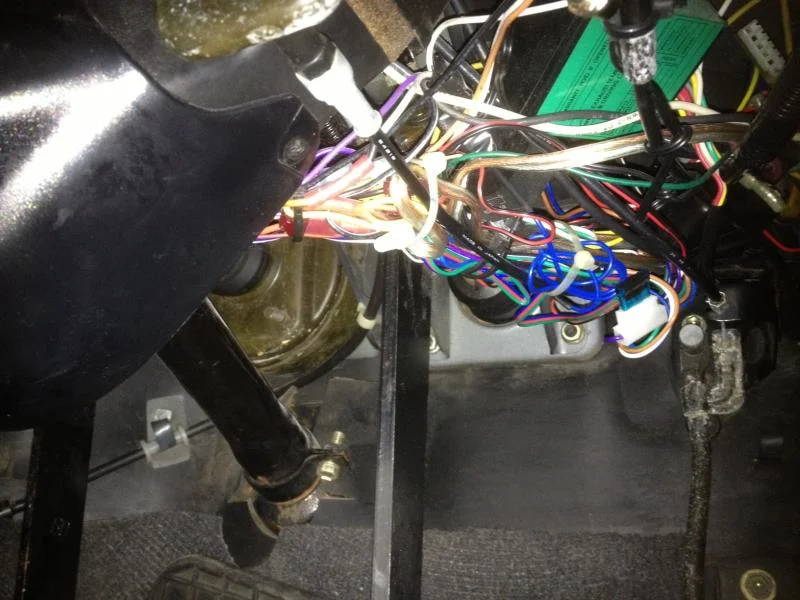

some are outside the firewall, take a pic of the clutch booster. i am curious.
Thanks Hultsy. Right now I'm hoping to do what will be more "reliable" and economical. If that means removing the booster then I will. I'm trying to understand how much harder it will be to push the clutch in and why they are there to begin with. Just seems like another thing that has to be possibly fixed and/or maintained.
Wayne, this is an old photo when I was removing all the bs wiring...I'll take a better one tomorrow, but for the time being here it (partially) is.
