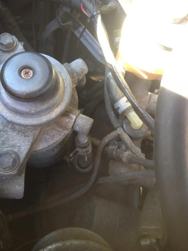

so I had it in today and like everyone else he figured on here my sporadic issues are with fuel starvation and air getting into the injector pump from where it is leaking.
They found the leak which almost stops once heated up and figures I should replace all the seals/gaskets. He informed me you can usually get kits to replace all the seals for around $40-50 and once I get that he will replace them for me. So, does anyone know if these kits are still available to replace the seals?
uploaded is the injector pump for my cruiser.
