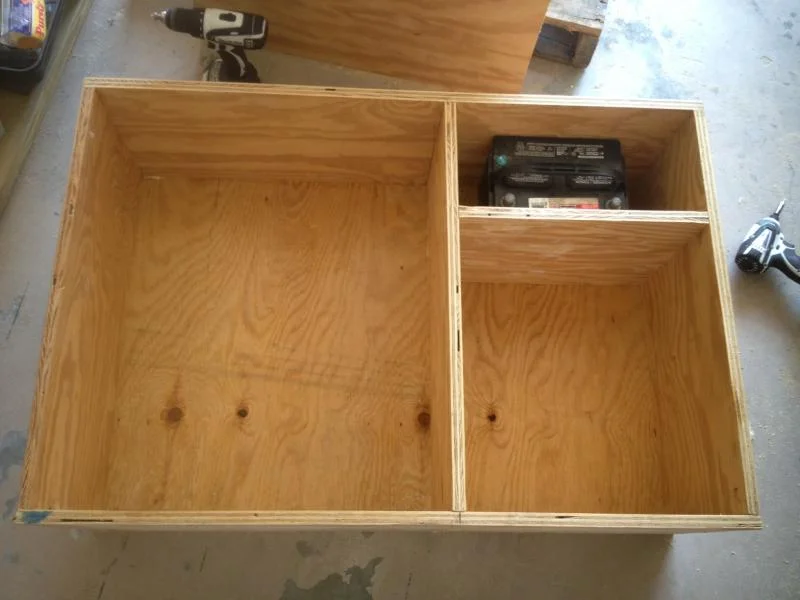

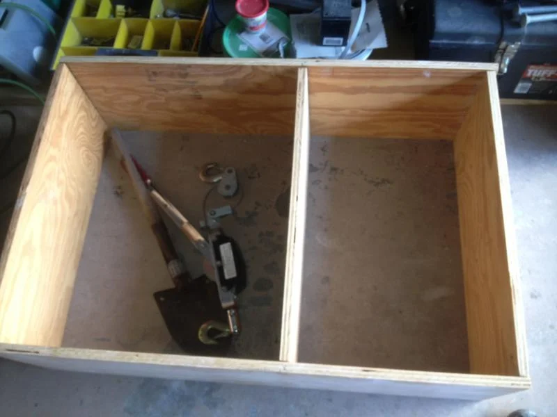

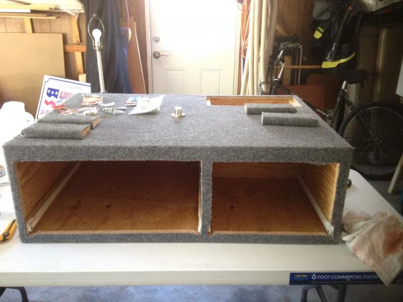

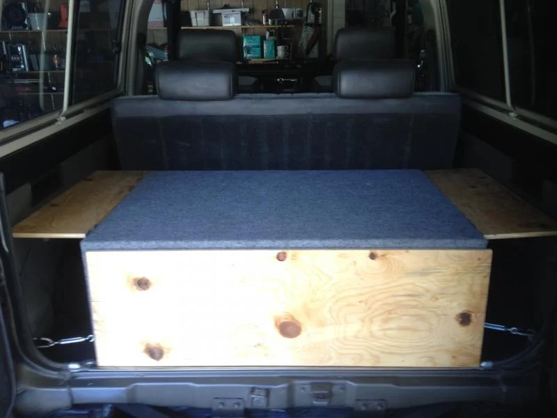

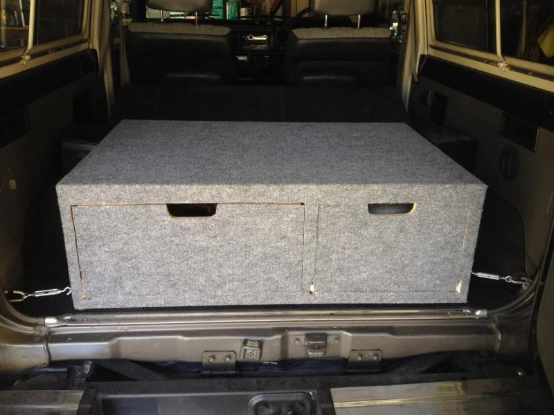

Progress on the box. It is not finished yet, but I was finally able to put it in. It is no where near as nice as some that have been made, but I'm happy with the results.
Where there is regular plywood those will all be on a hinge and my fire extinguisher and speakers will be mounted on the sides. The front piece will cover the drawers and have a lock on it, I assumed it would give the box a cleaner look. I'm still looking for low profile tie downs so once I find them I will be putting them on top. When the seat is laying down a piece will be made (attached to back of box on a hinge) to go all the way across on top of the headrests.

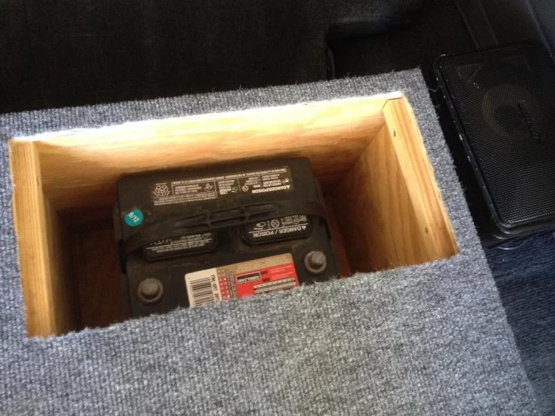

I have a spare battery and eventually would like to use it for 12v cig. lighter, power my radio, etc. Does anyone have suggestions on a way to be able to charge an extra battery up in the rear other than having to plug it in every night?

Looks good ! Search for some air line track for a top mounting solution for on top of the box. As for keeping the battery charged I guess you could attach a smart node / switch to keep it charged. I use a t-max kit on my other truck and it works great. However don't think it would work on 24 volt systems. I will be watching as I want to run my frig and would add a third battery also.

yeti - Thanks, I'll google those. I'm pretty sure that won't work with 24v, sadly. Too be honest, you may figure something out quicker than I can. I've been googling for a couple weeks now and can't figure out anything other than a solar charger or trickle charger...but nothing practical. I disconnected my radio, need to get it properly wired as well with the 12v converter. I'm thinking I will tap off a continual feed and go from there to the converter rather than the feed that dies when ignition is off.
Jericho - Thanks a lot, I kind of wish I went with black carpet, but oh well. It's taken a couple months to get them done, little bit here and there with the old man helping. Not sure I understand, did I secure the box in the back or the drawers? The box is secured, the drawers currently aren't, once the other piece get carpeted and I get the piano hinges on it will have a solid front with a lock to keep them in place. Right now they are pretty heavy with gear, so I don't see them opening while accelerating.

I have it in place with these. The two seem to do the trick.
You should really do more to secure these drawers to the vehicle. If you ever get in an accident or roll over that is a lot of weight flying around.
The turnbuckles you have are not offering much downward force at that angle. Try and go with a minimum 45 degree downward angle and also angle them to pull back at the same time. Add another set to the front and have them pull down and forward at the same angles as the rear set. I also removed the latch in the center of the floor for the rear tumble seat and have 2 bolts coming up from underneath into the drawer cabinet using T-nuts.
