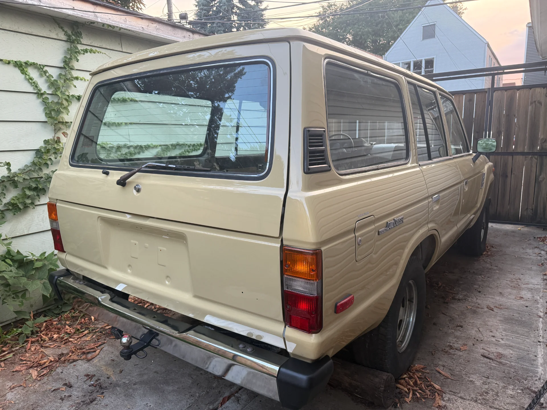

I wanted to get it looking like an actual FJ60 again and started working on the rear door panels. I added sound deadening to the rear doors and cut new vapor barriers and used butyl rubber to attach them. I took some notes from Proffits Resurrection vids on YouTube and used their favorite 'brown' tape at the bottoms of the vapor barrier, lol.
Rear door panels on!

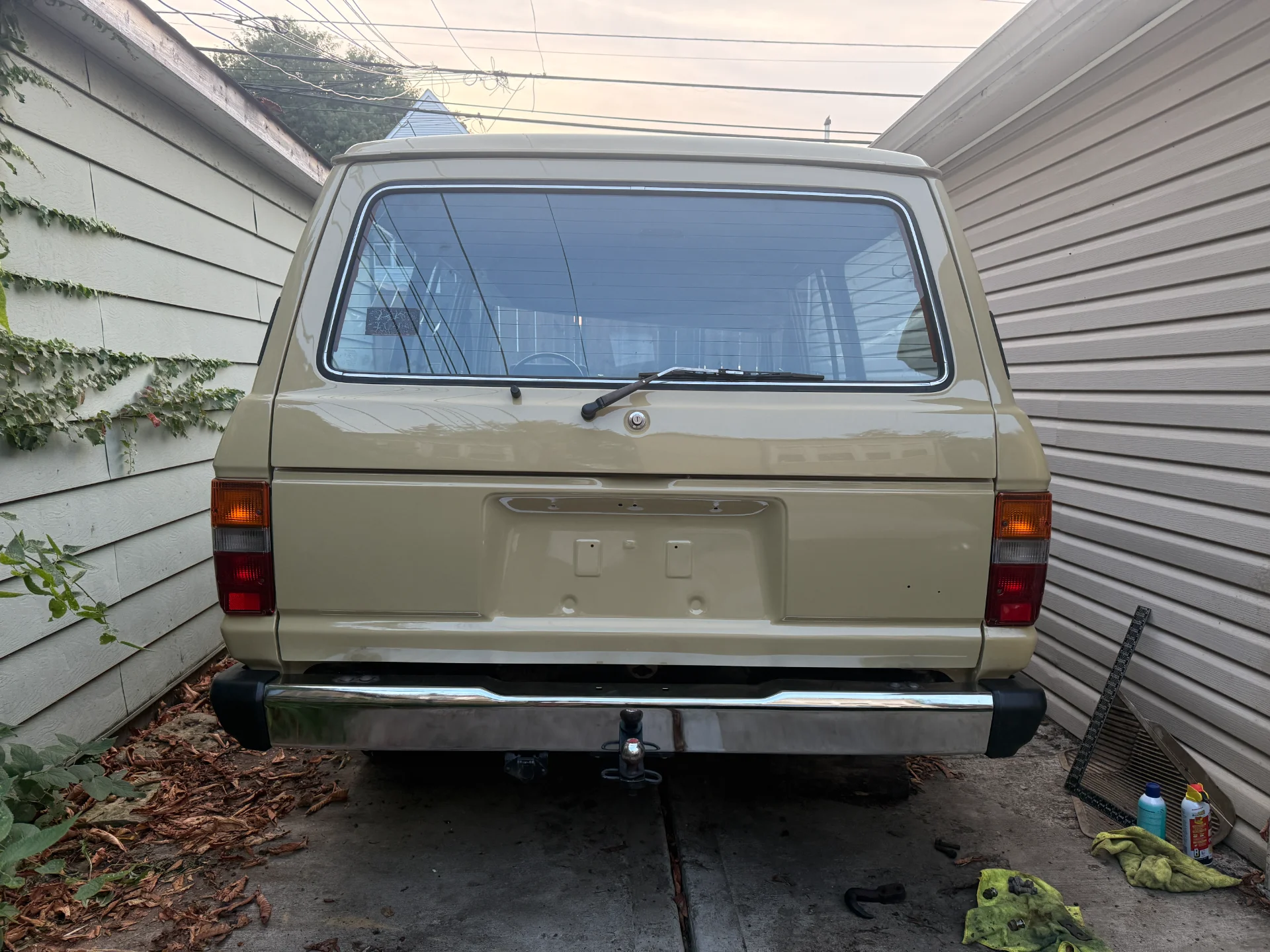

On the topic of making this thing look like a truck again I put on:
- New OEM tail light lenses
- New OEM rear bumper
- Used OEM front bumper
- New OEM bumper caps front and rear

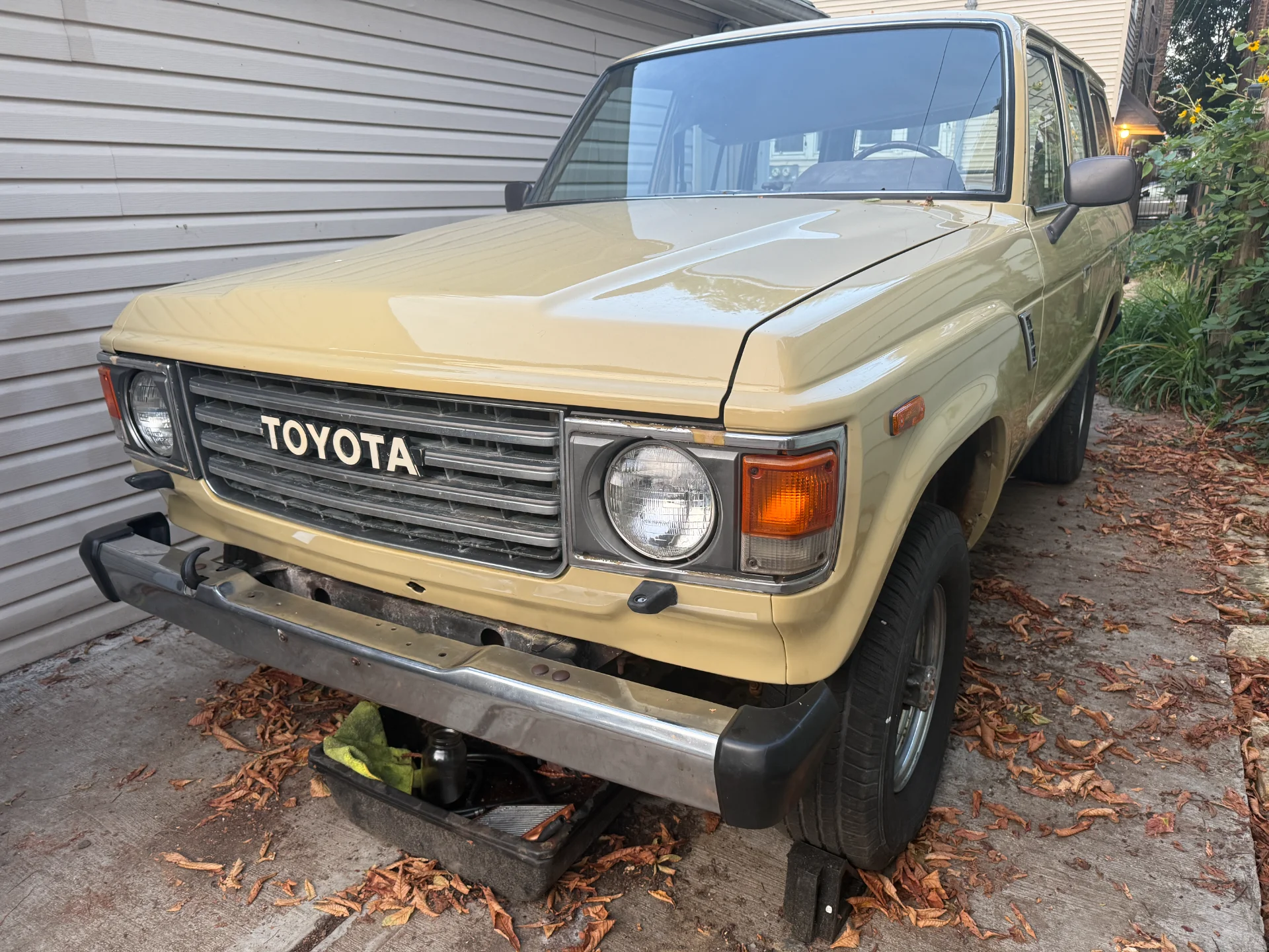

- Used OEM front turn signal lenses (I have new ones waiting to be installed after I get the front fitment correct)
Looking like a truck again! Panel gaps look decent but could use a few minor adjustments to the hood and headlight bezels.
I absolutely love this color. The hatch is fully 'closed' here and I need to adjust the latches to correct it.
This pic gives a better look at where/how the tail gate and hatch need to be adjusted. Right now the hatch is sitting too far to the right while the tail gate is sitting too far in on the right.

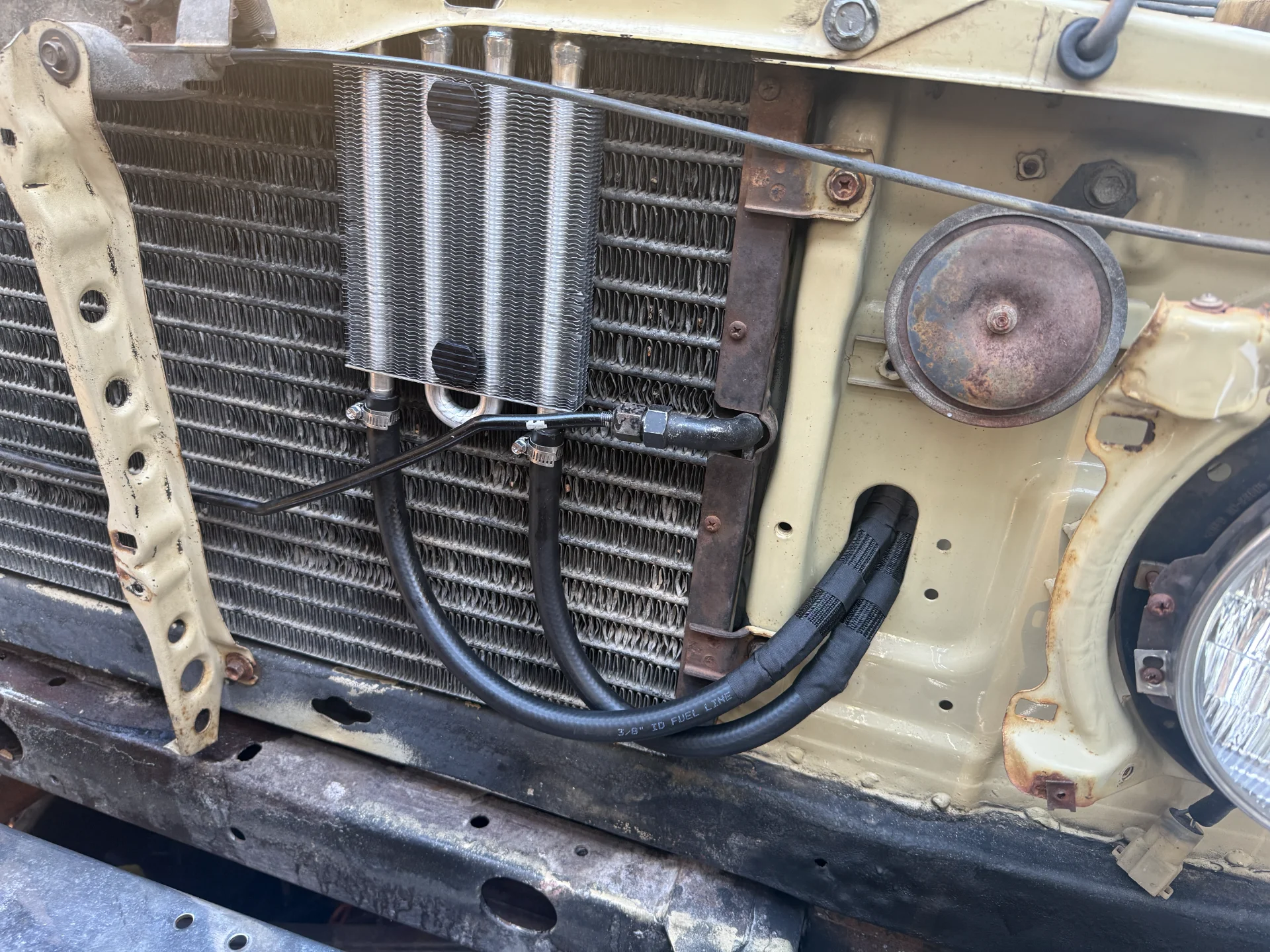

Hayden cooler and line replacement in!
Trying my best to make this build as clean as I can but I'm by no means a professional. Just a normal dude with access to a few tools and a little bit of time.
Unfortunately, even after replacing the lines and cooler the fluid is still leaking, or rather spraying, into the engine bay under load when turning the wheel left/right. The good news is I have two used power steering pumps on hand and a rebuild kit with the goal being to rebuild the better of the two and reinstall. I did some reading on rebuilding the pump and know about the brass bushing that is machined to each pump. Fortunately there is no play in either of the shafts of the two extra pumps I have so fingers crossed I can get a few (hopefully hundred) thousand miles out of both of them.

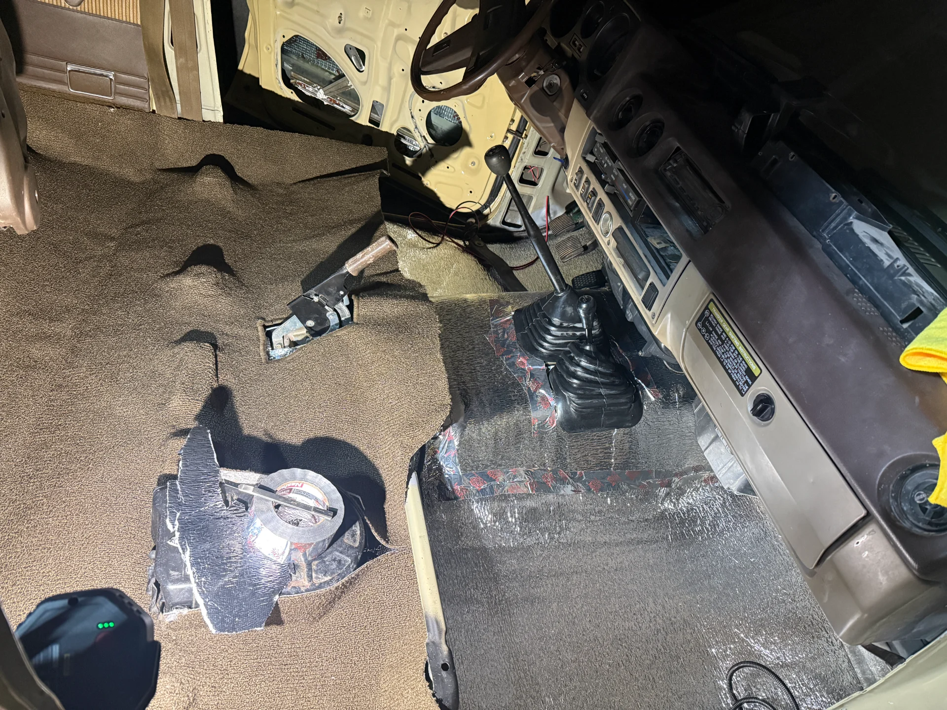

I started to move onto the floor pan to prep for the carpet install. I took care of a few rust spots, ground down to bare metal, treated with Ospho and lastly painted with rust reformer. I didn't feel comfortable using 100% coverage with the sound deadening here and make sure to only apply it to areas where there was clean original paint underneath (outside of the portion of new metal welded in near where your left foot would sit).
I brought the truck back into the garage after this and it sat for a few weeks until I had time to work on it again.
I bought the non stick foil type insulation and covered the entire floor with it. I also started putting the rear section of the ACC carpet in! Yes, I chose the easy route and left the rear heater in. My rear passengers will appreciate it in Chicago's cool fall weather. The carpet is only mock fit here, I still need to cut holes, align certain areas, etc.
