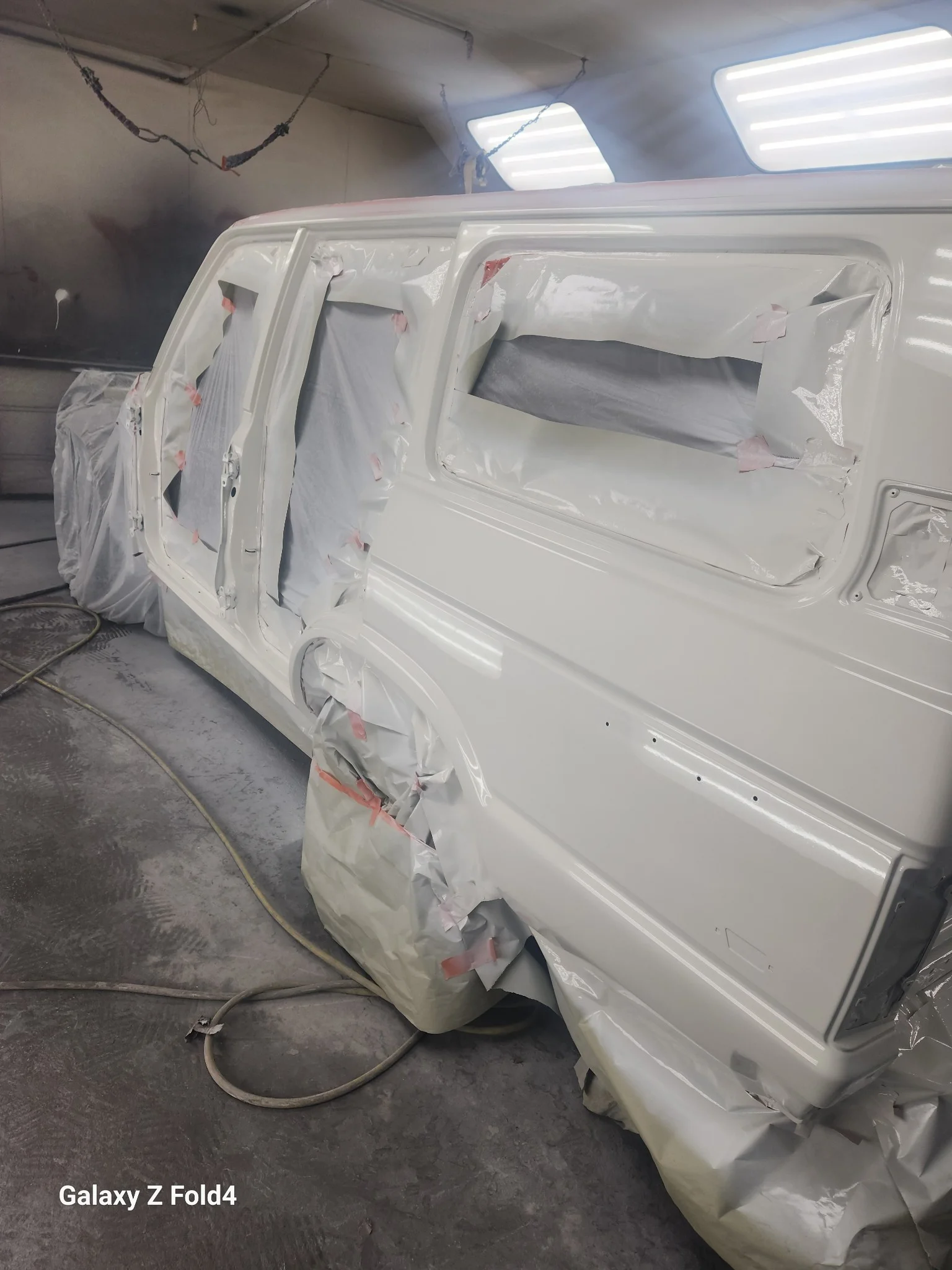

Happy to report that the truck has finally been primed and painted! Fingers crossed, I'm planning on beginning assembly next week and hoping to have this thing road worthy again by the end of January.

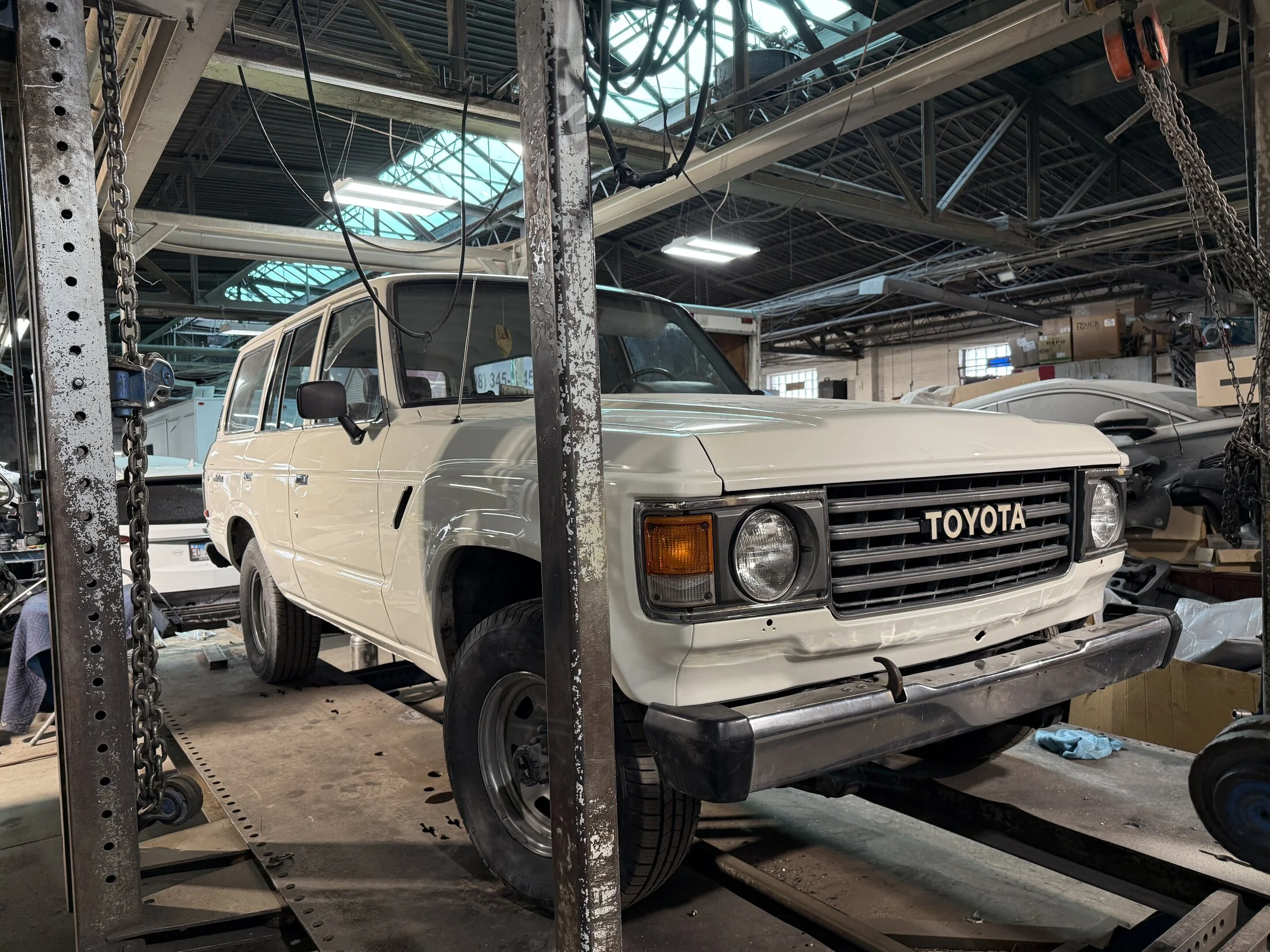

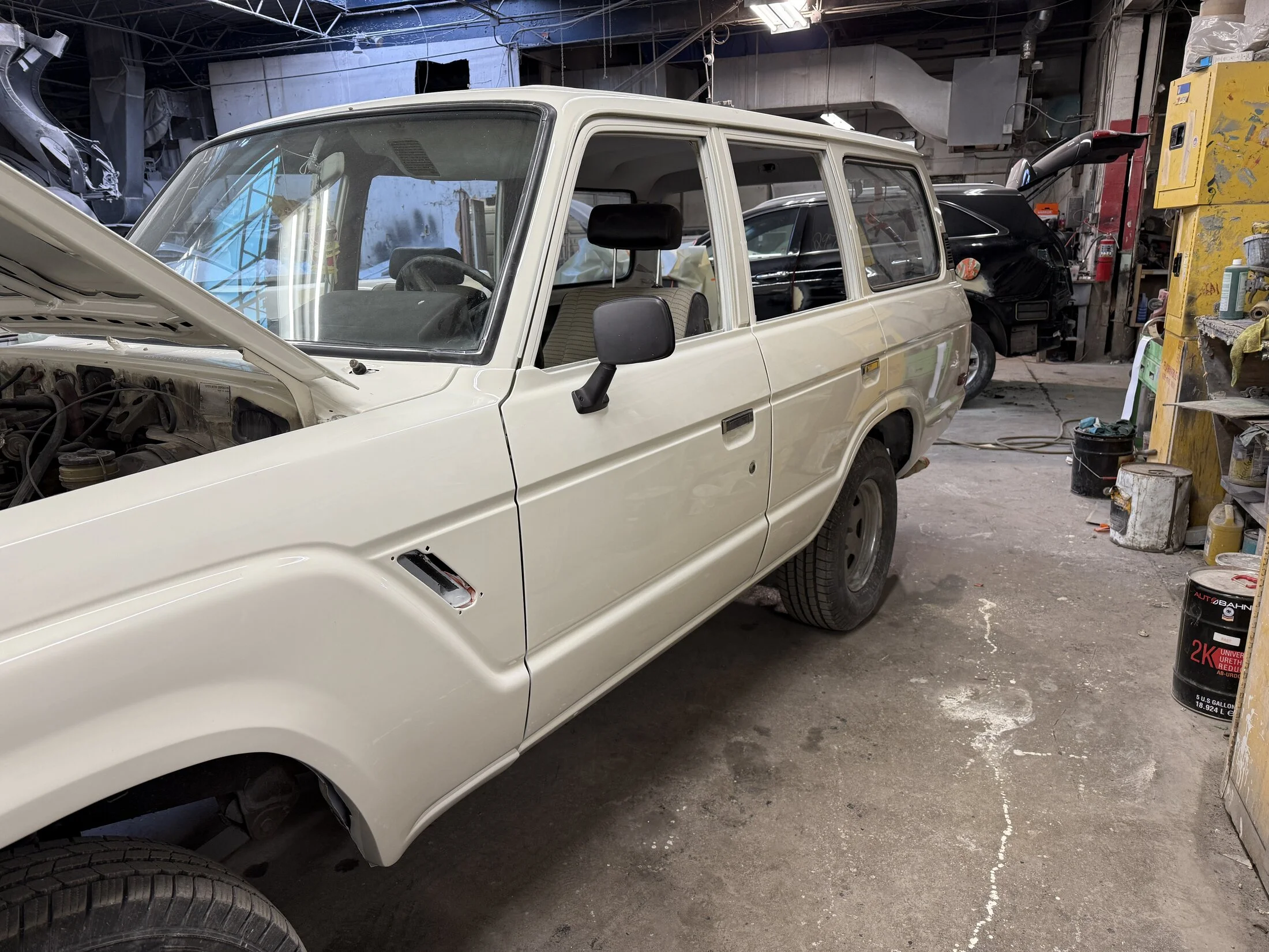

Its finally starting to look like a Land Cruiser again but putting it all back together is taking a little more time than expected, but thats just how it goes. The paint looks so good in person and I'm really, really pleased with how it turned out.
Anyway, heres a quick update on progress so far. The doors/hardware, fenders, and hood have been put back on the truck. All of the windows have been reinstalled as well. I went with an OEM front window gasket to retain the chrome strip. We also painted the red tow hitch and trail tailor rear crossmember black.

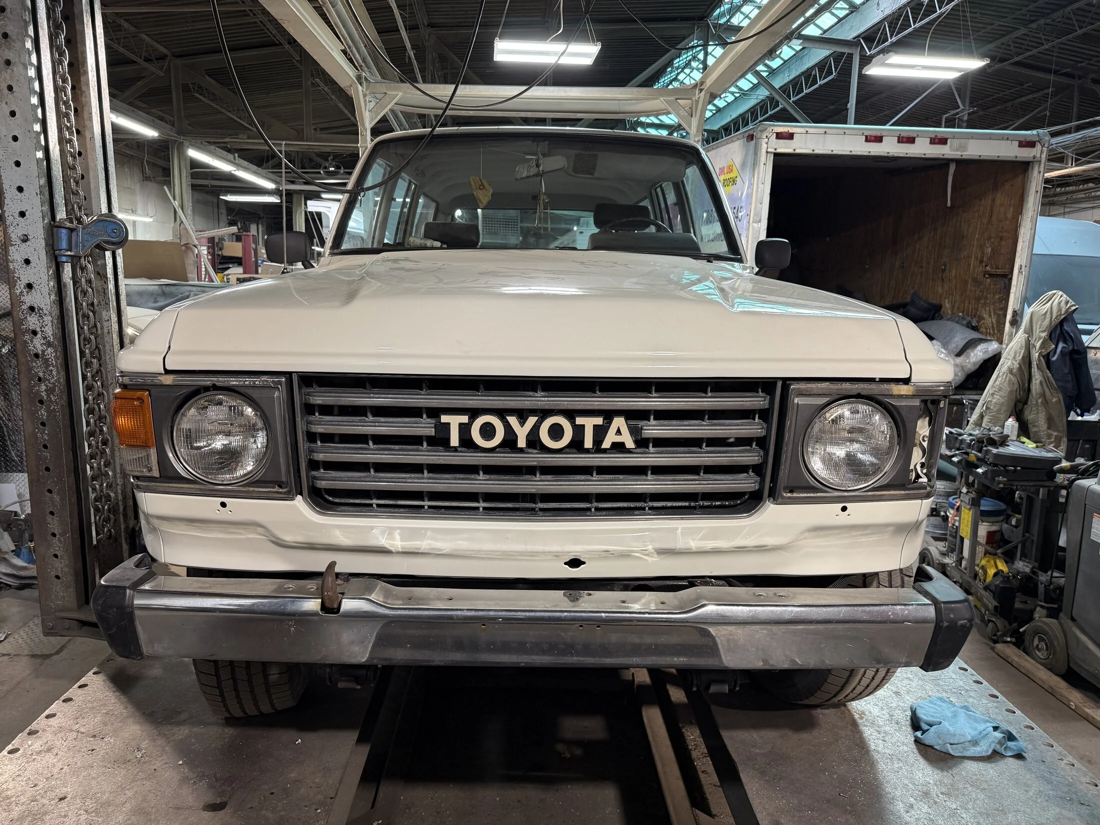

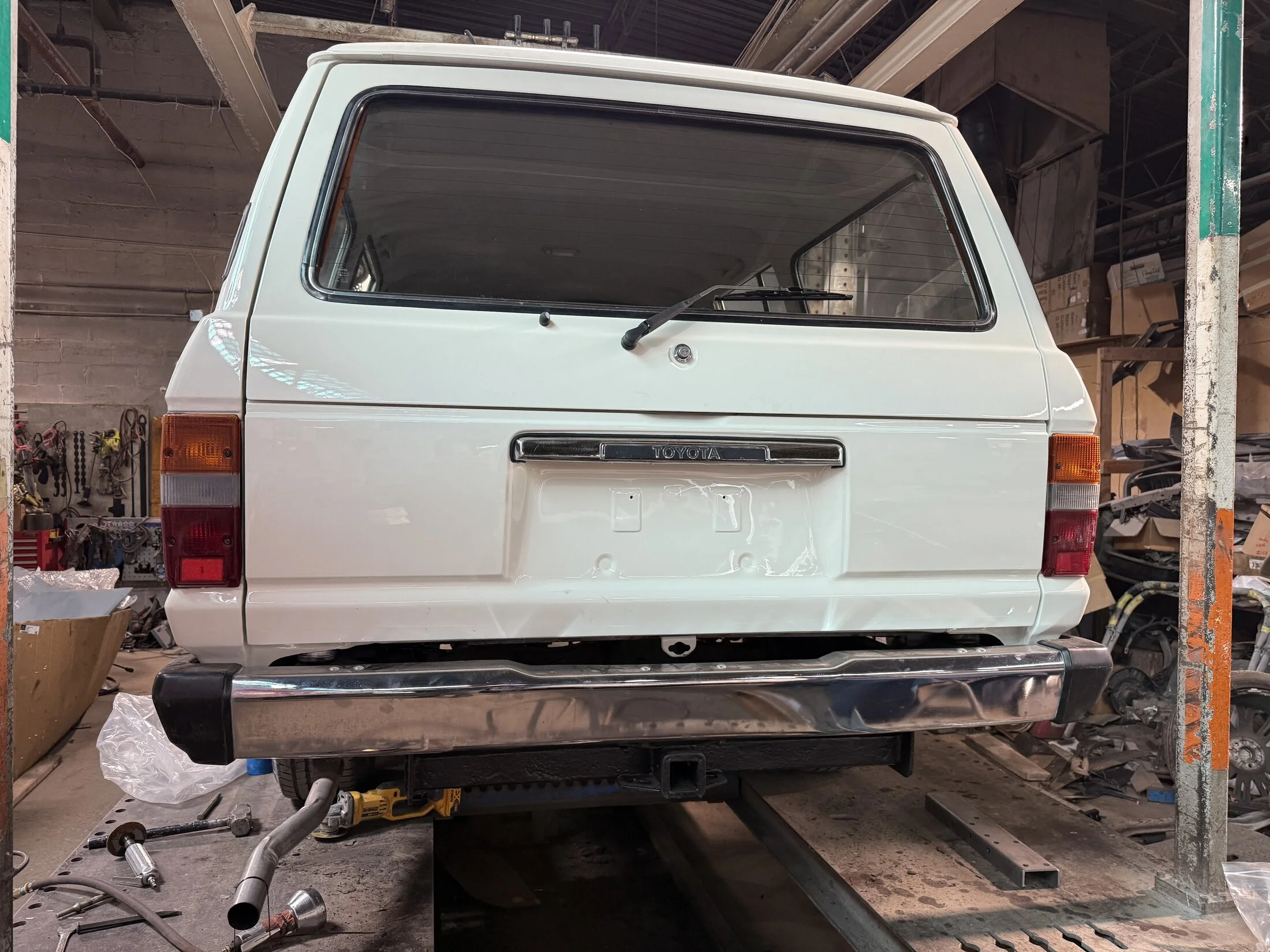

Well, its a month later and not much has happened. Finished installing the TrailTailor C Channels and working on getting the body fitment on the front-end correct. The fenders and headlight bezels are especially troublesome, and I think this is an issue overall with FJ60s as I took a look on BAT and lots of the restored/repainted FJ60s on there have funny fitment of the hood/fenders/headlight bezels.
Anyway, I'm hoping to finally fine tune the panel fitment this week and get this thing out of the shop!
Are you sure you have the headlight bezels on tye correct sides?
I think so, but the ones on the truck now are from another FJ60 and the body guy is just using them for fitment purposes. I have the better condition originals in a box that I'll install when I get the truck back to my house.

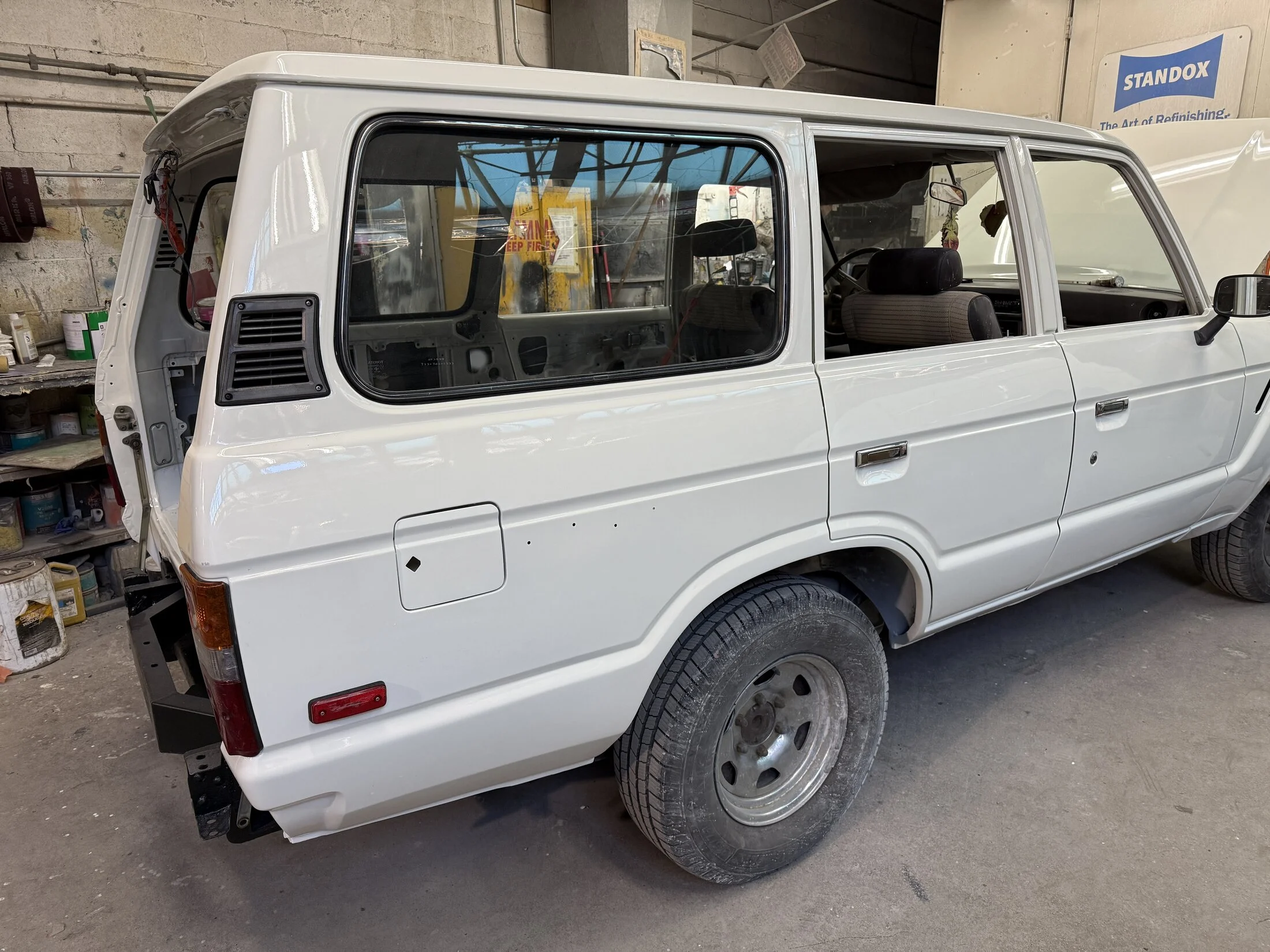

Lots has happened since February. The White Fj60 is 99% completed. I installed 31x10.5x15 BFG KO2s, fully assembled the interior, fab'd new vapor barriers for the door panels, and cleaned/updated some of the vacuum routing/wiring in the engine bay. After replacing the rusted metal in the wheel wells they were sanded down to bare metal and painted black. Below are some pics of some of the things I've done since the last update:

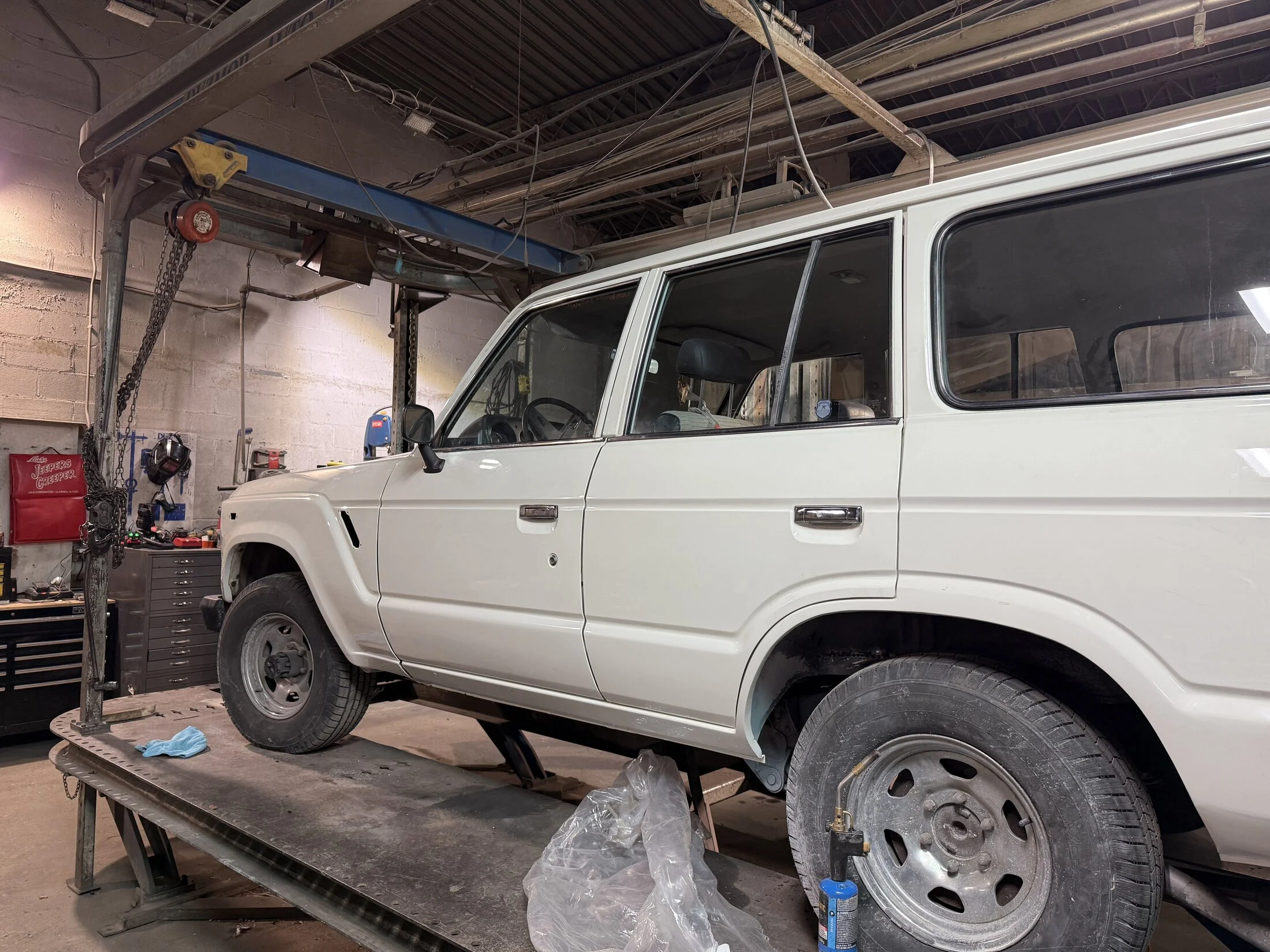

Wheel well post-rust repair. Sadly the wheel wells could have been taped off better but I didn't have the time to do this myself so the guys at the shop helped with it. I can clean them up later.

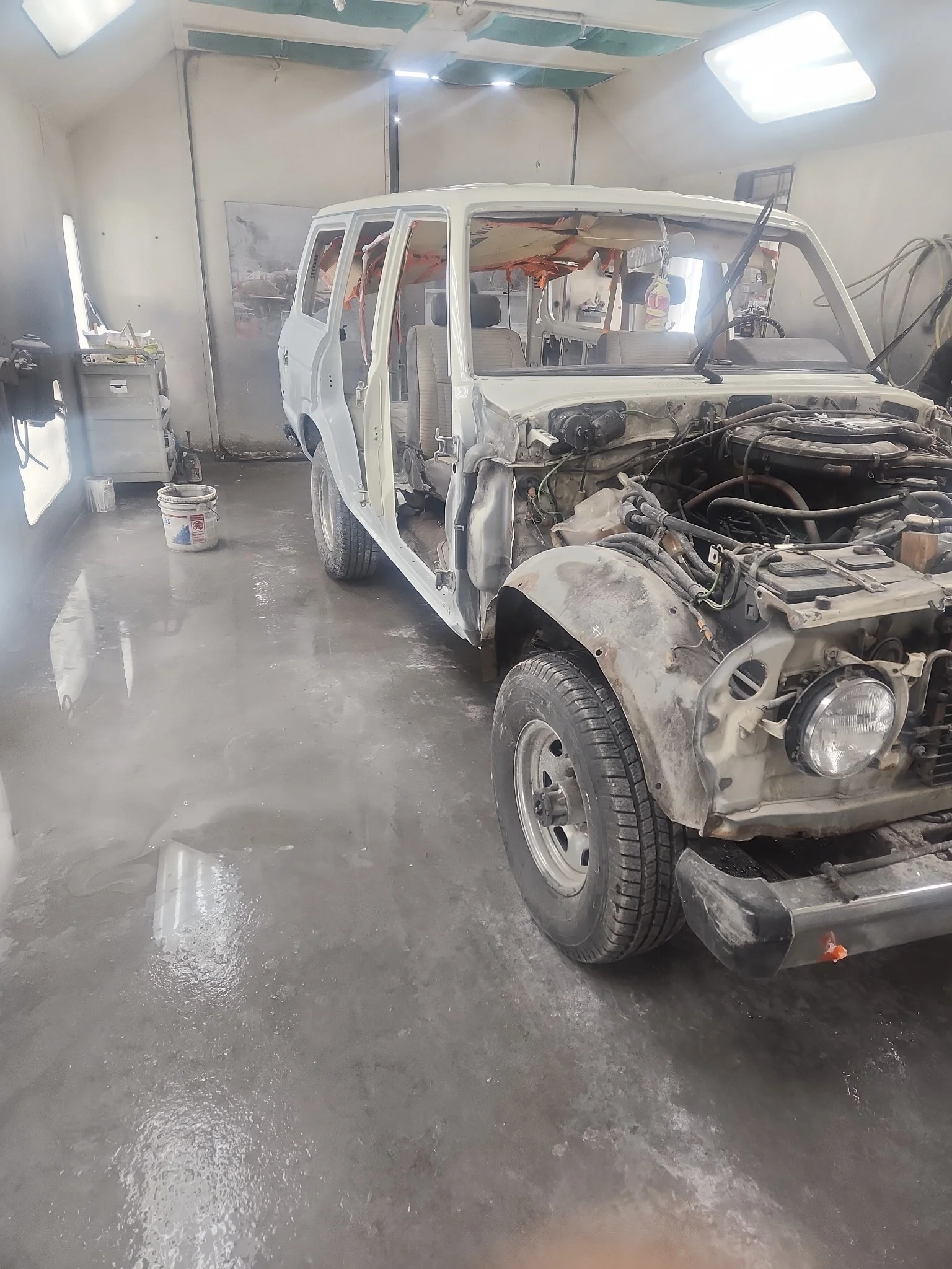

I had it shipped directly to the shop to get started on the paint and body. This one got the same full windows out refresh that the white one did. One of the rockers needed to be replaced and so did the rear left door, but the seller provided me with both of those. The quarters were in decent shape so I didn't have to source new panels through Wolf Steel and instead patched the few minor areas of rust which was a time save.

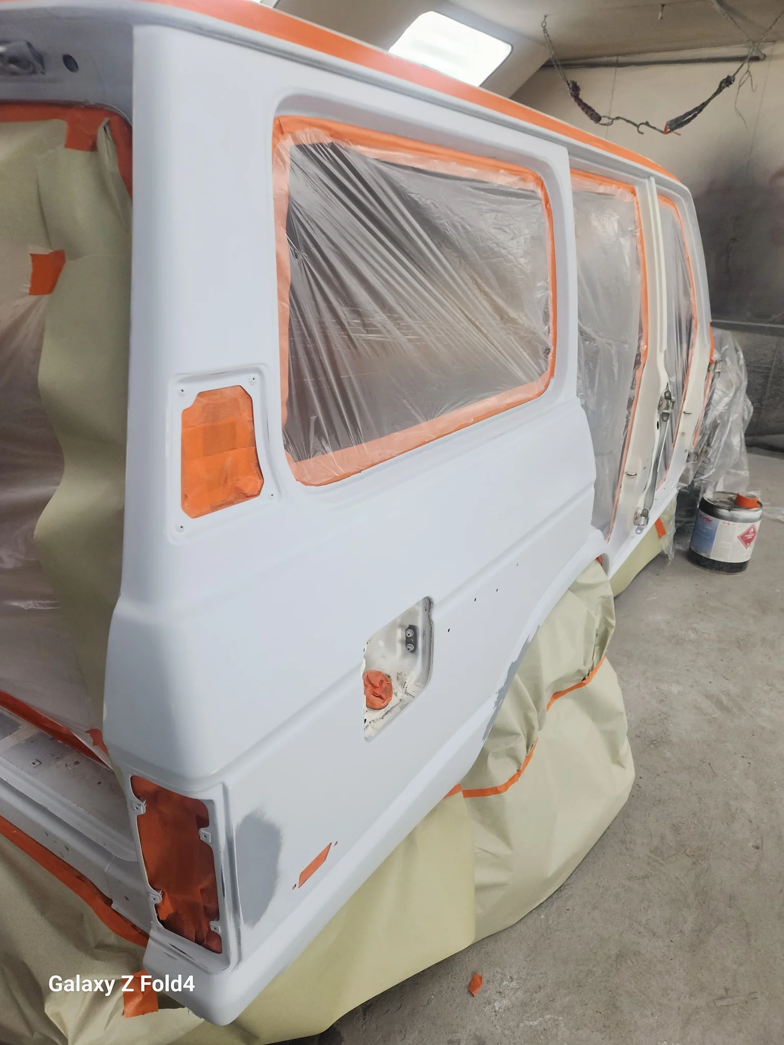

Finally it was time for the spray booth. I opted on not removing the fenders this time around so that I didn't have to adjust panel gaps too much afterwards.
Primed!

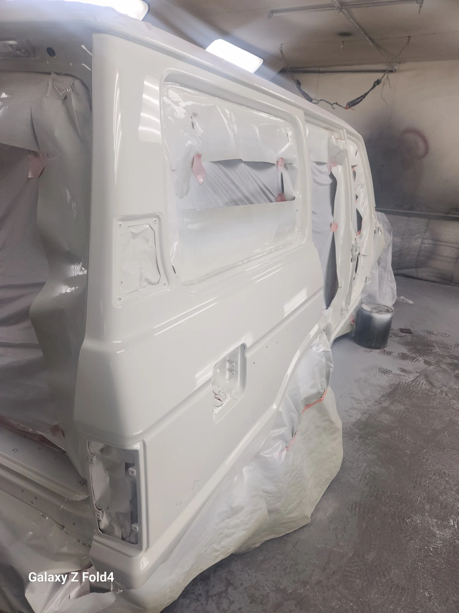

Paint time!
This is a day or two after the paint baked in the spray booth. PPG and other quality paint/clear was used and I'm extremely happy with how it turned out. It didn't even need a wet sand or buff! This is probably the nicest the paint has and ever will look. Only a little better than the factory single stage :cool:
