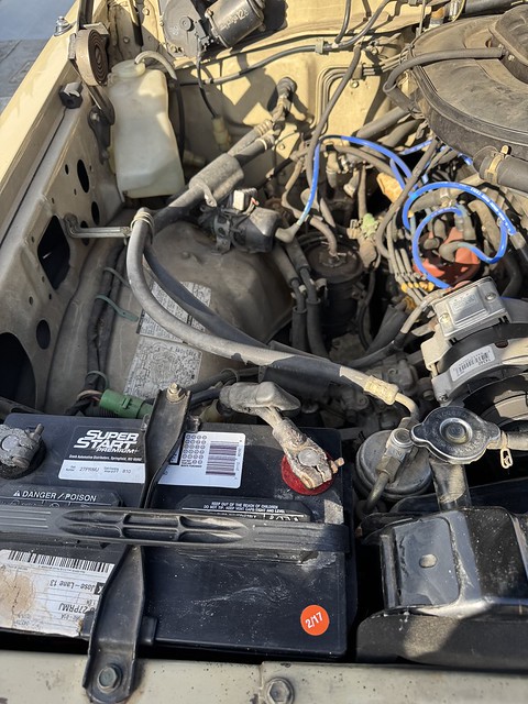

Once I got back, I decided to clean the accumulated dirt and dust in the engine bay. Here is a before pic.
Here's where I stopped. Only did most of the pax side. It was mostly just dusty.

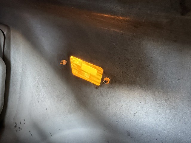

While cleaning up, I discovered that the turn signal light had seen better days. The plastic bulb retainer literally crumbled in my hands... Found replacement lenses on Cruiser Corps along with a bunch of other useful parts that I'm going to order. But, I have no idea how I'm going to fix/replace the plastic fixture that the light bulb actually plugs into... Anyone got ideas?

Not totally understanding question on the lights. if the plastic base for the exterior lights are falling apart you probably need all new entire assembly (not just lenses). The seals will leak and the bulbs won’t stay in place. Aftermarket replacements are pretty easy to find. OEM are tougher and expensive.
I was checking the air filter and noticed that the circled red (vacuum?) hoses are a little hard. And the hose to the PCV was cracked. I'd like to replace them if there are any good replacement hoses. I haven't been able to find these on the Toyota parts website. Are these available? Anyone have part numbers or links?

the PVC hose you can use Amy hose for it.
But, most of those hoses are NLA.
I do have some used ones for the front of the side of your cruiser.
Take care on the big ones in front they are not available. A little hard and even cracks on the end typically aren't a big deal
Others you can make work with new hoses. Search there's tons of info on them
Thanks fellas. I found diagrams in the Emissions Manual PDF. I was trying to find part numbers for them yesterday but totally struck out on the Toyota parts store website.
You are correct about "tons of info" :) I found so many threads on all sorts of hoses. Felt like I was looking for a needle in a haystack :) I actually just tried chatgpt and it pointed to a couple of good threads on here that I had not yet seen so I'm going to review those later after work. I'm rather surprised the AI helped.

Of all the hoses you circled, the one closest to the firewall can be found at City Racer. Ventilation hose
