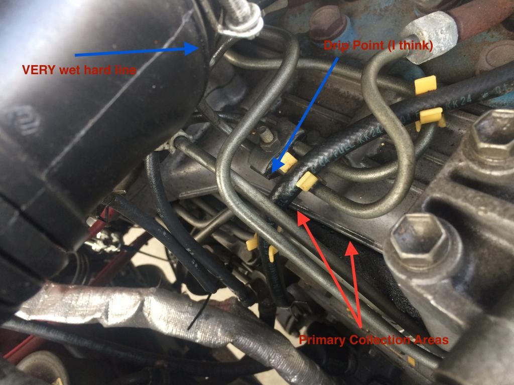

So. I found out that its NOT oil thats spraying a fine mist near the air intake. Its DIESEL! Finally, enough collected for me to take a sample and sniff test. Its diesel for SURE. Heres a picture or two of the situation.
There are no apparent holes anywhere. Everything looks pretty secure. However, I have pointed out collection, drip, and wet spots. The spray is not huge, nor is it plentiful or wide spread. Its just.... there. Im kind of concerned about having vapor or diesel mist floating around my engine bay.
Is it possible a hard line is cracked and is leaking? This problem only started recently (to my knowledge). There isnt even enough fuel loss to create a drip trail. Its just kind of "misted" up there...... very perplexing. At idle, theres NOTHING going on. No spray, no mist, nothing. Only after 4 solid hours of driving at 2,500 rpm did the problem become apparent when i did my routine 150 mile "bay check". What do you guys think? Any process of elimination I can do here? Ideas? Where could it be coming from?

I've had issues with my fuel lines leaking. all of them except one were from broken fuel lines.
the time i had a mist / leak like that it took me 3 days to figure out. turned out to be the fuel filter gasket. replaced the fuel filter and problem is gone.

I had small misting of fuel on the hard lines and around the filter when i bought the 61. The 12ht had been sitting for 10 years, only started and run now and then. So i changed the fuel filter and gasket, drained oil fuel, changed oil and added some fuel lubricating smoothie.
Takes up moisture in the fuel, lubes the rubber and lines and whatnot. Also loosened and cranked the hard fuel lines at the injector and pump.
It solved my misting, worth a try.
