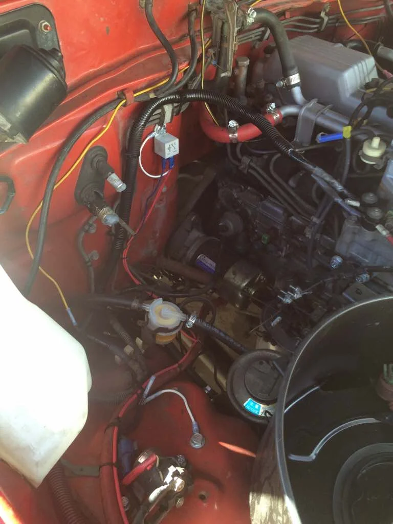

I didn't like how my power steering return line was secured with zip ties (that won't last forever) and my throttle cable was hanging down onto the alternator belt. So I got all that stuff secured properly.

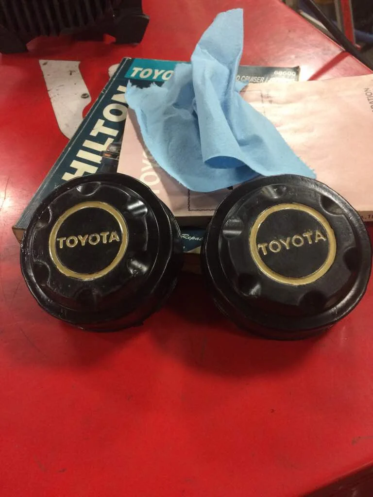

I also painted these up. It's nearly impossible to do the toyota letters right, but it's a decent 10 foot paint job.
