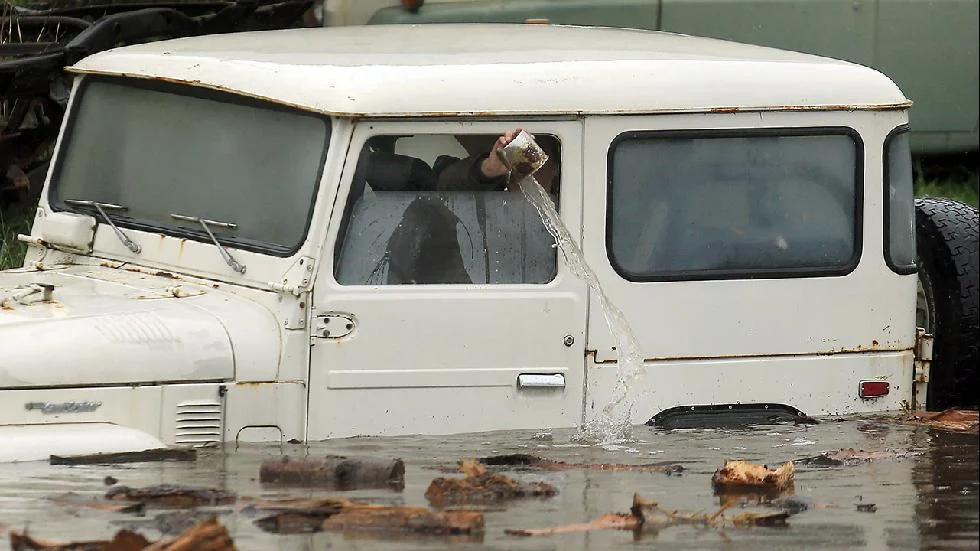

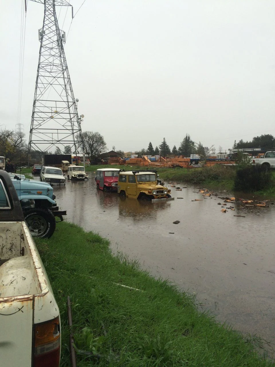

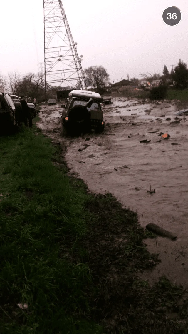

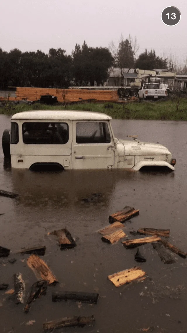

In other news! I got my moment of fame when a massive storm struck California last week. Sonoma County had massive flooding, and I went down to Mudrak to check on my truck/the shop. The back lot filled with over 4 feet of water at more than a foot an hour. It was insane. But I made it into the newspaper!
All the rigs were safely rescued. We got most of them out before the water level got too high. Needless to say I got good at snatch recovery in water.

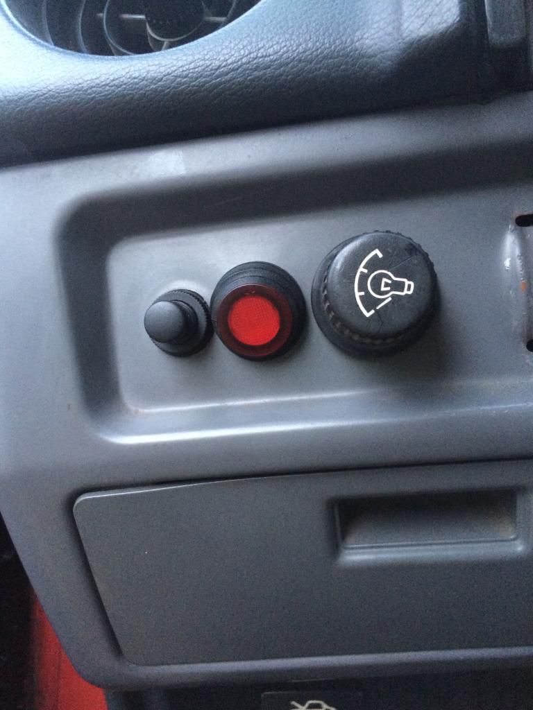

The switch panel looks like this.
The black button is for my fully operational glow screen. (I never use it. The truck fired right up even at 22 degrees on a cold morning)

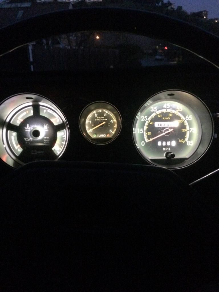

On to another cool addition. LED DASH LIGHTS!
I completely replaced all the lights in the dash with LED's. I had some time on my hands so I added a dimmer. Its pretty slick I must say. The original dimmer knob works as it used to. I installed a dimmer for the LED's and it was totally worth it. They go from SUPER bright to full dark.

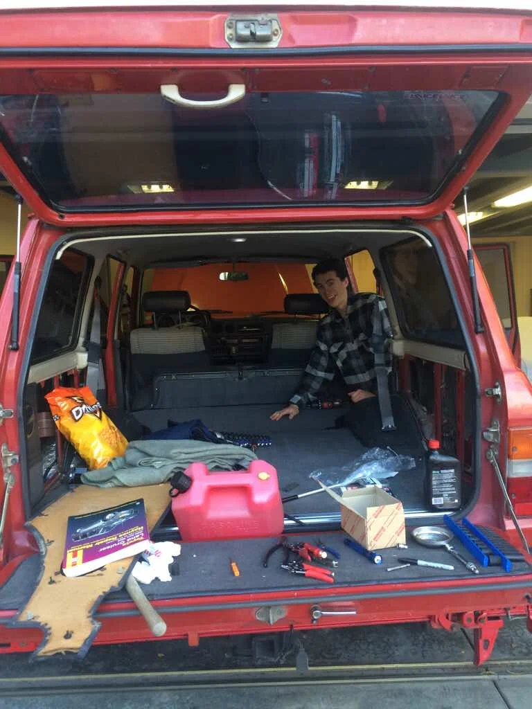

Then my friend and I got to work on the rear belts, and storage compartment.

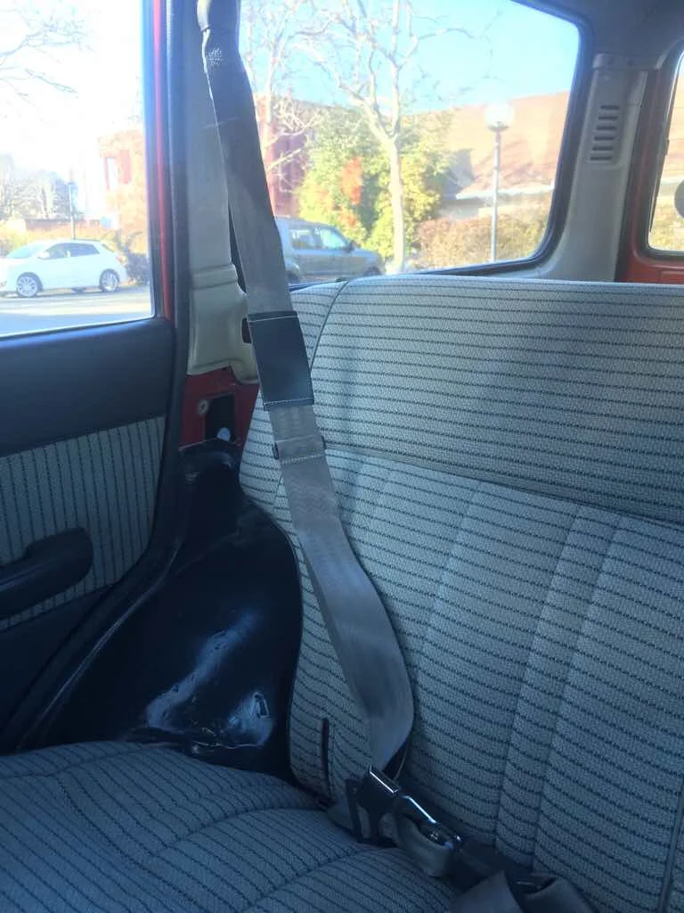

Got the shoulder belts installed.
(What a PIA to get the nuts up into the pillar. Got good with magnetic rod)
Brand new belts from toyota. Love em.
