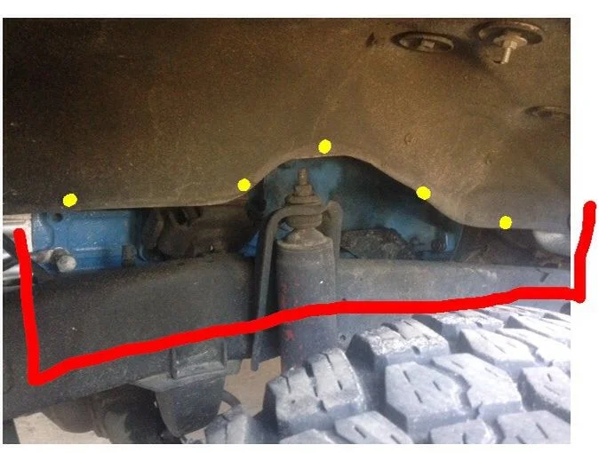

Does anyone have the formal name and part number for the rubber "splash guard" on my HJ75? It attaches via screws or fasteners. (Yellow)
53737-60040, SEAL, FRONT FENDER APRON.
It is a superceeded number and is the same for both sides. I needs to be trimmed back on the side the exhaust exits.

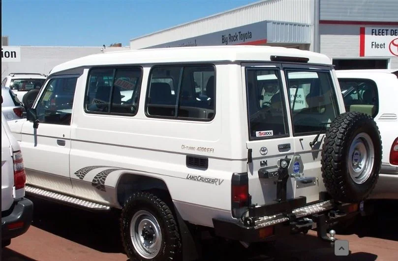

Although I've never really been a fan of the 75 Series Troopy, I must admit that this particular one makes me think I should reconsider my position. :)
Photo shamelessly lifted from the Chat Section.
OH man....My loins are disturbed.....:eek:
I have always found the roofline to be a negative feature but in this case the positives far outweigh the negatives.
the troopy is a great rig
if
you need a Toyota suburban
you need an enclosed work truck
you want an expedition vehicle for one or two
if you have 11 kids
but as a DD or a small family with young kids the troopy can be a beast.
me, i lust for one
if equiped with AC then check internal roof gutter for rust
A pilllars rust badly
they are LOUD inside, picture the old 40 with the roof on X2
without a turbo they are slow
