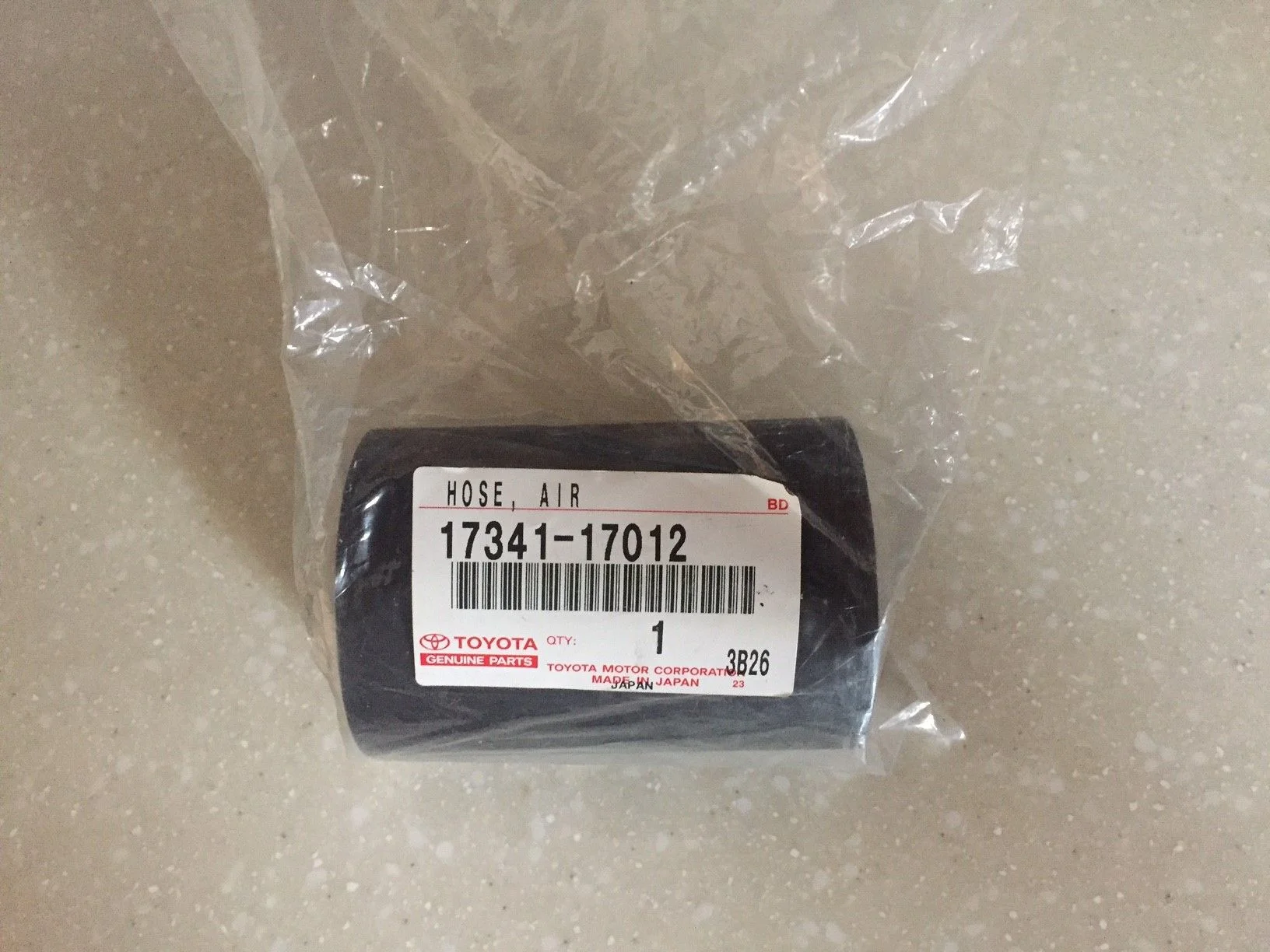

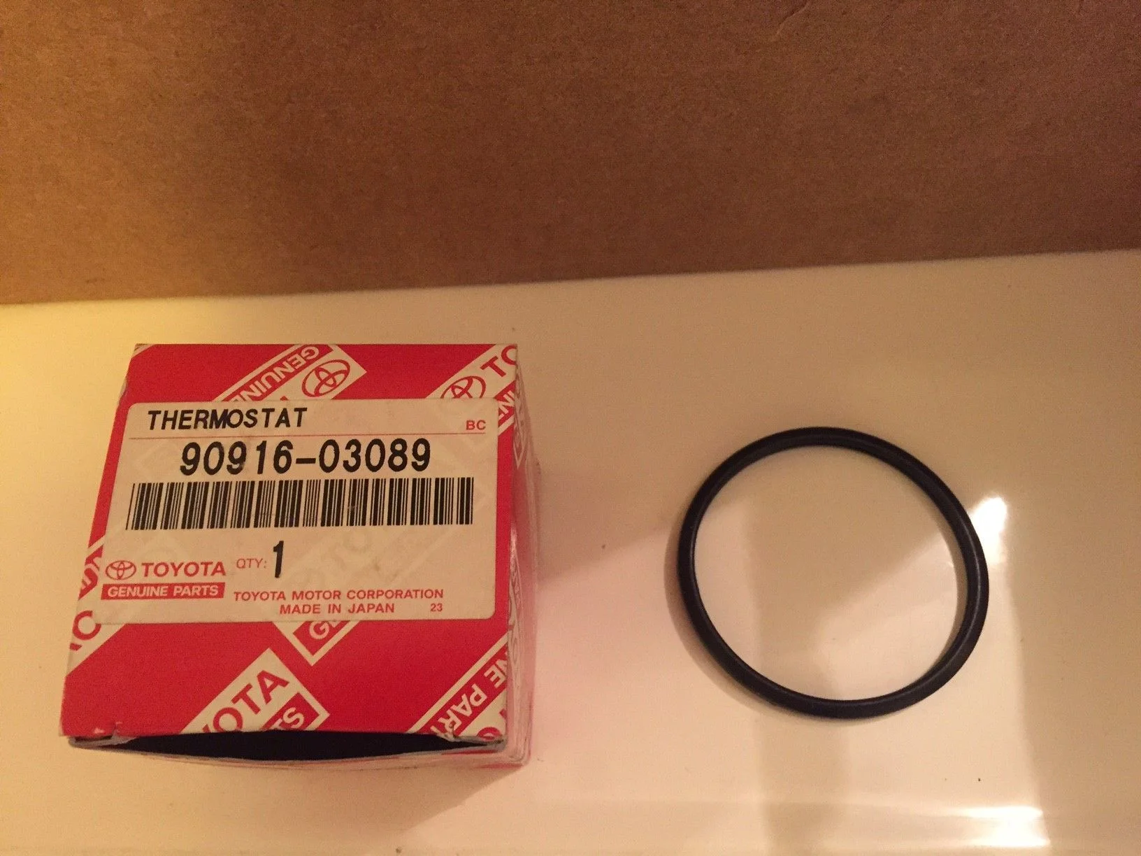

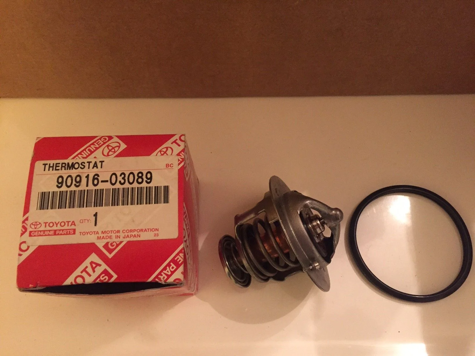

A couple of more part numbers for documenting purposes
1. Insulator of CT26 Turbo:
2. 1HDT Turbo Intake Pipe:
3. Turbo to Intake Pipe Hose:
A little bit of a photo dump, mostly for my documenting purposes to know what has been done to the 70 and drivetrain.

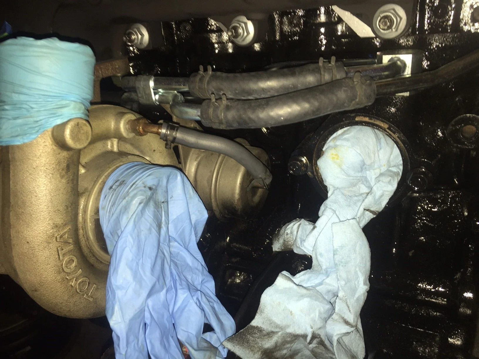

Photo of new wastegate hose installed:

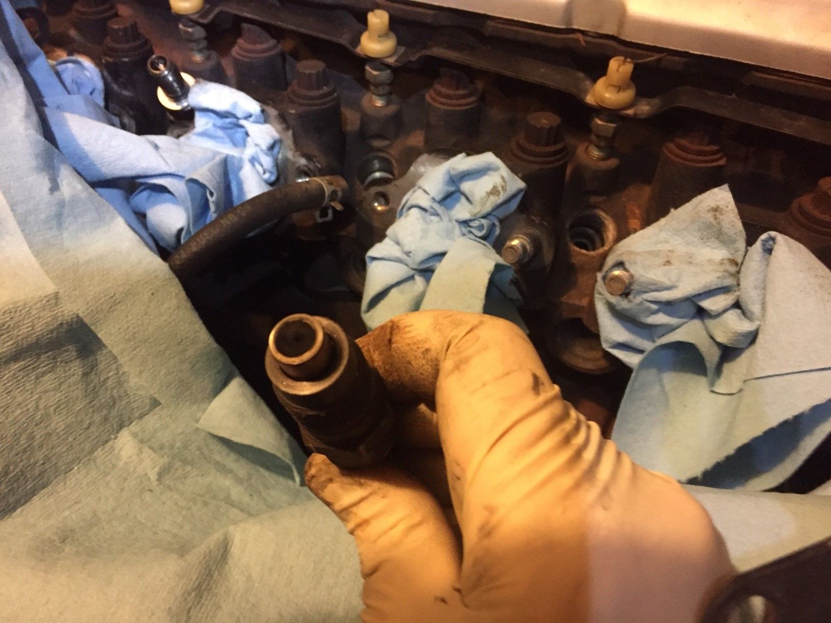

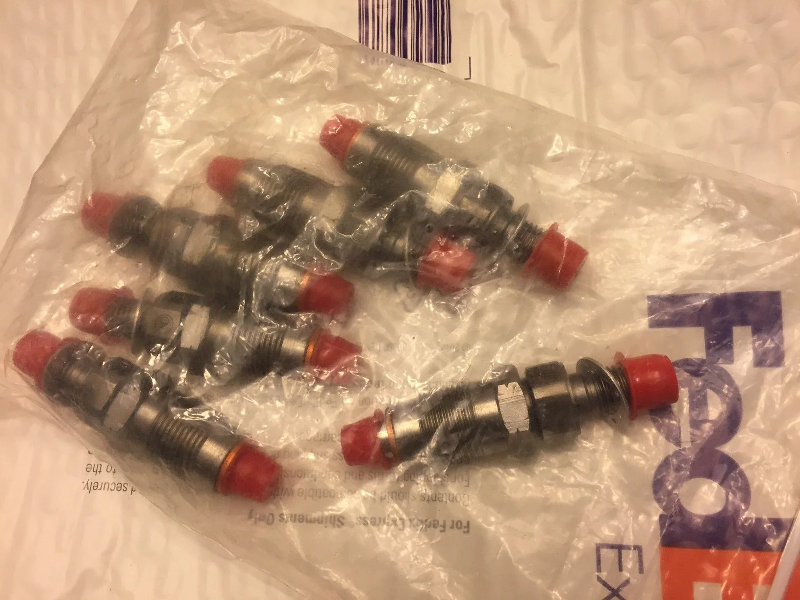

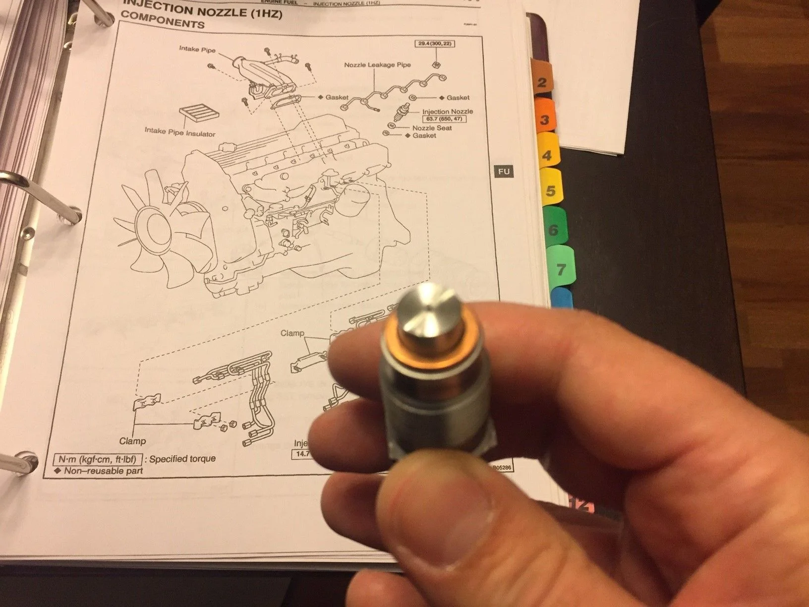

I pulled the injectors and sent them Progressive Truck and Tractor to get rebuilt. Dusty and Len did a great job and turned around the injectors super quick.
http://progressivetruckandtractor.com/
Before:
After:
Injectors Installed:
New injector seat and nozzle washers were used for each injectors.

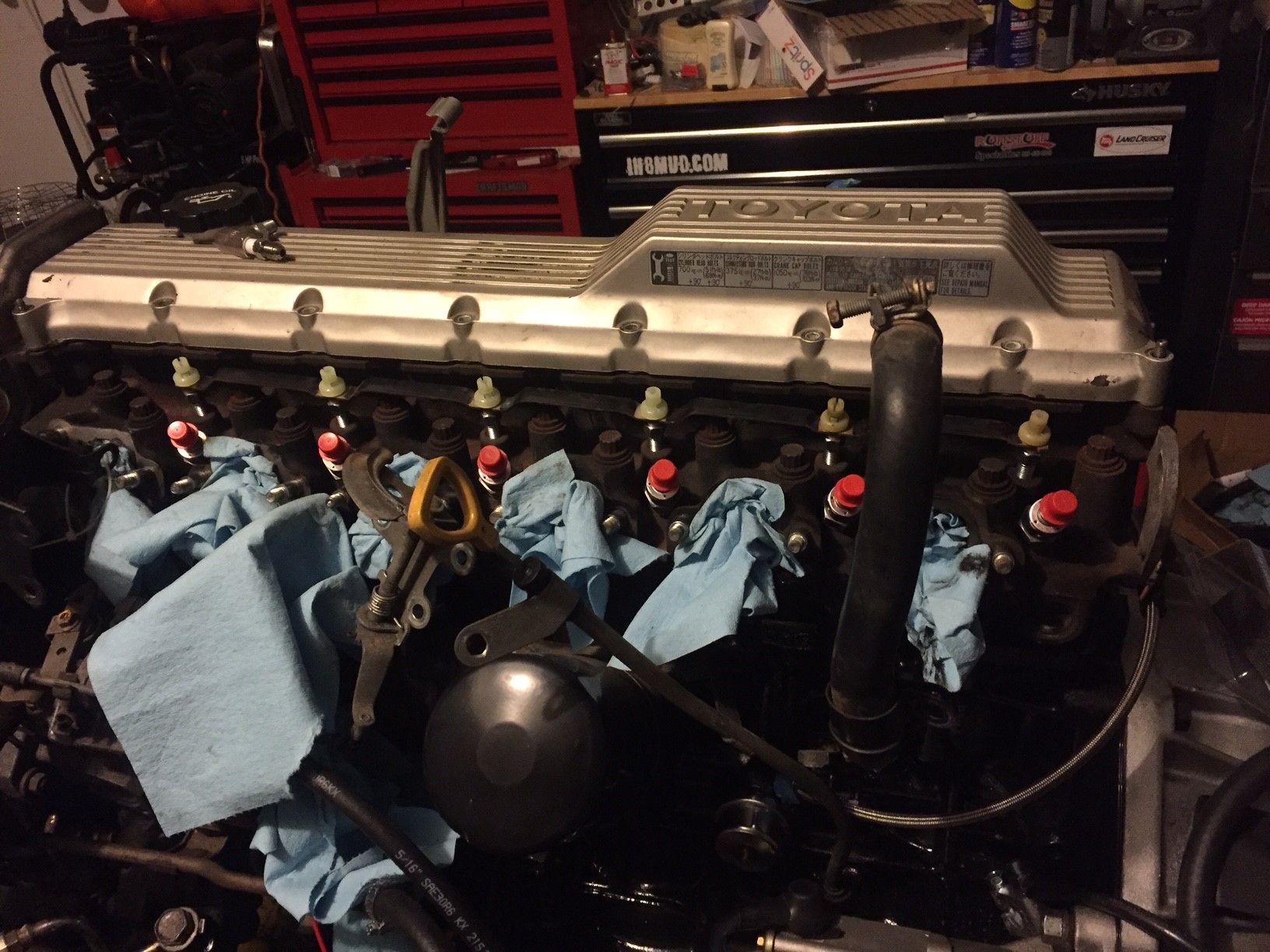

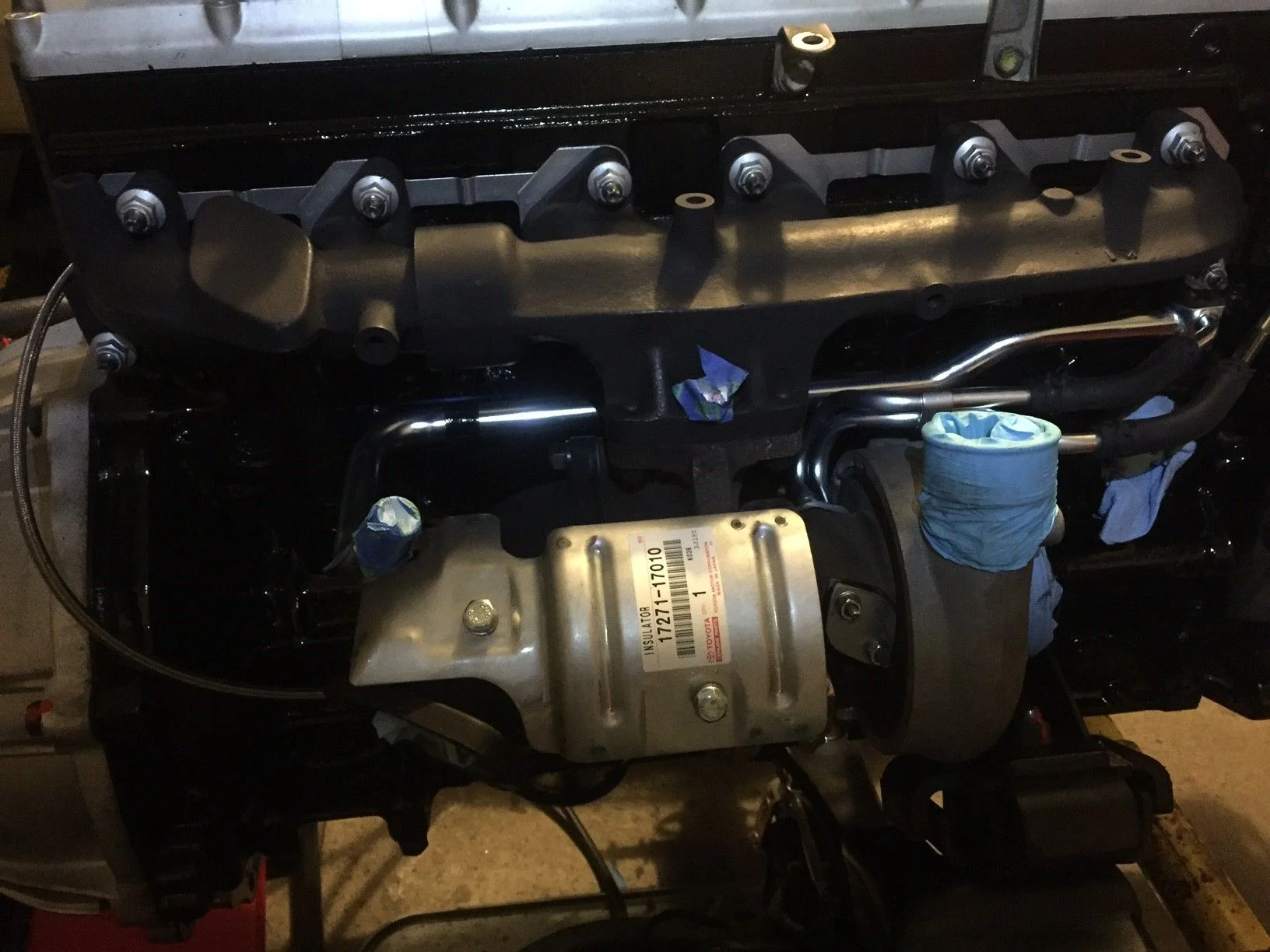

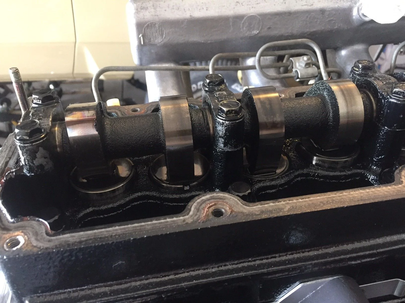

Since I had the valve cover off, I went ahead and checked the valve clearances. They were all within the acceptable range according to the FSM. After this, I installed the intake manifold with the Toyota gaskets. The gaskets were part of the Engine Gasket kit that I've posted before.

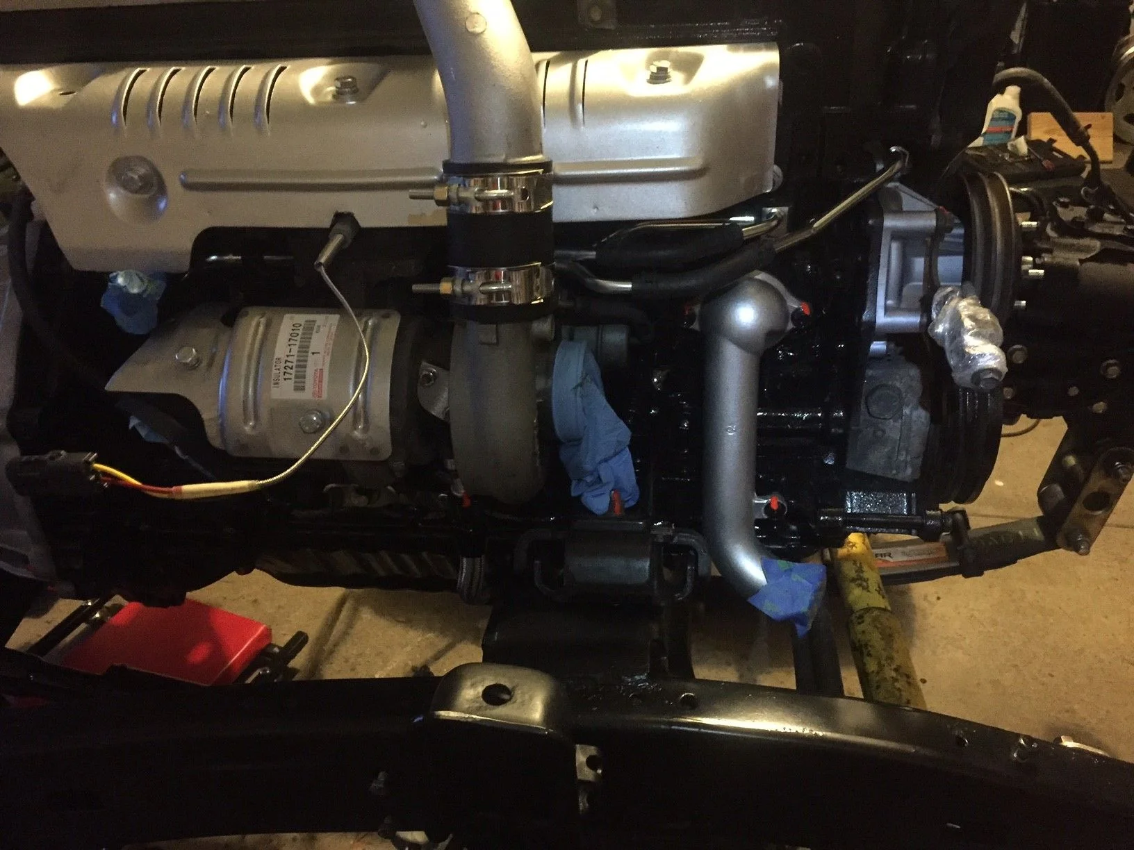

Installed the exhaust manifold heat shield and notched it to clear the exhaust probe.
And finally installed the cross-over pipe.

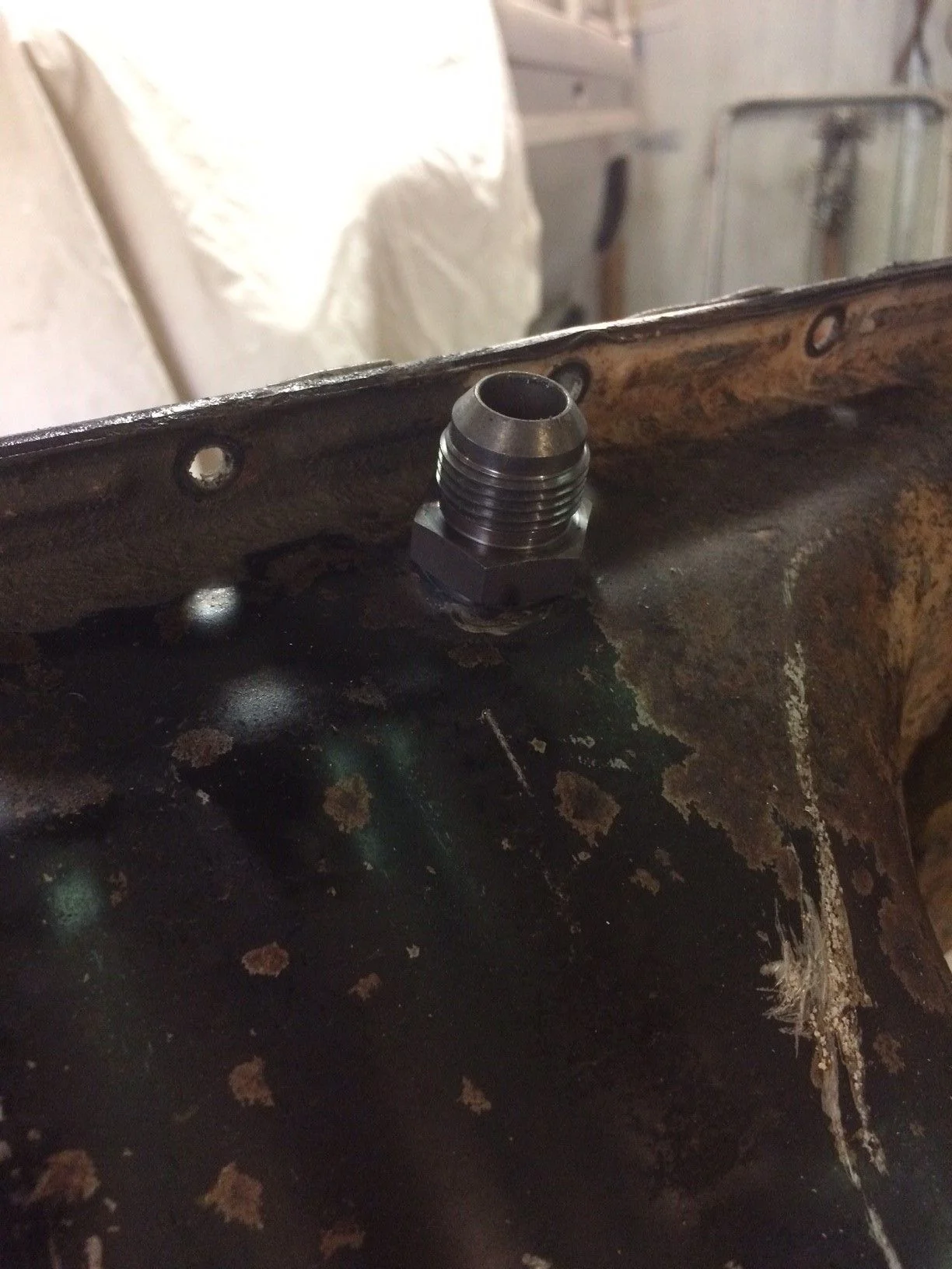

Turbo Oil Supply and Return:
As mentioned before, Rob Smith at Odd Iron Off-Road welded the AN-10 bung to drain the turbo oil back to the sump.
Over view of Odd Iron Off Road and offerings for Land Cruisers and off road vehicles

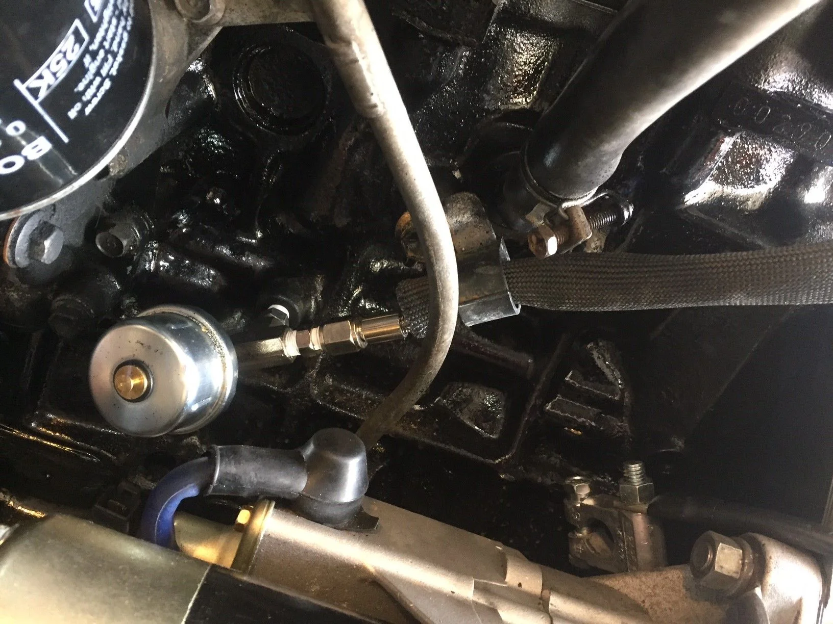

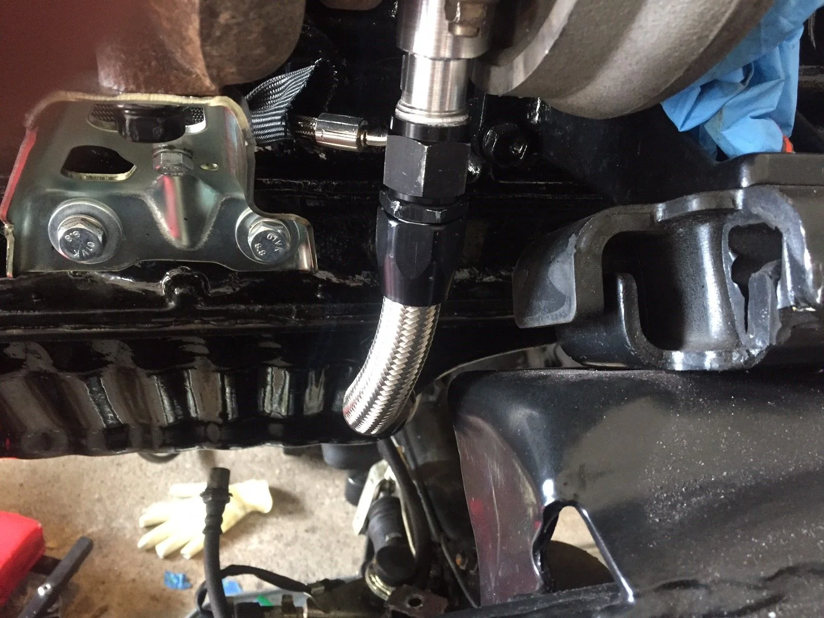

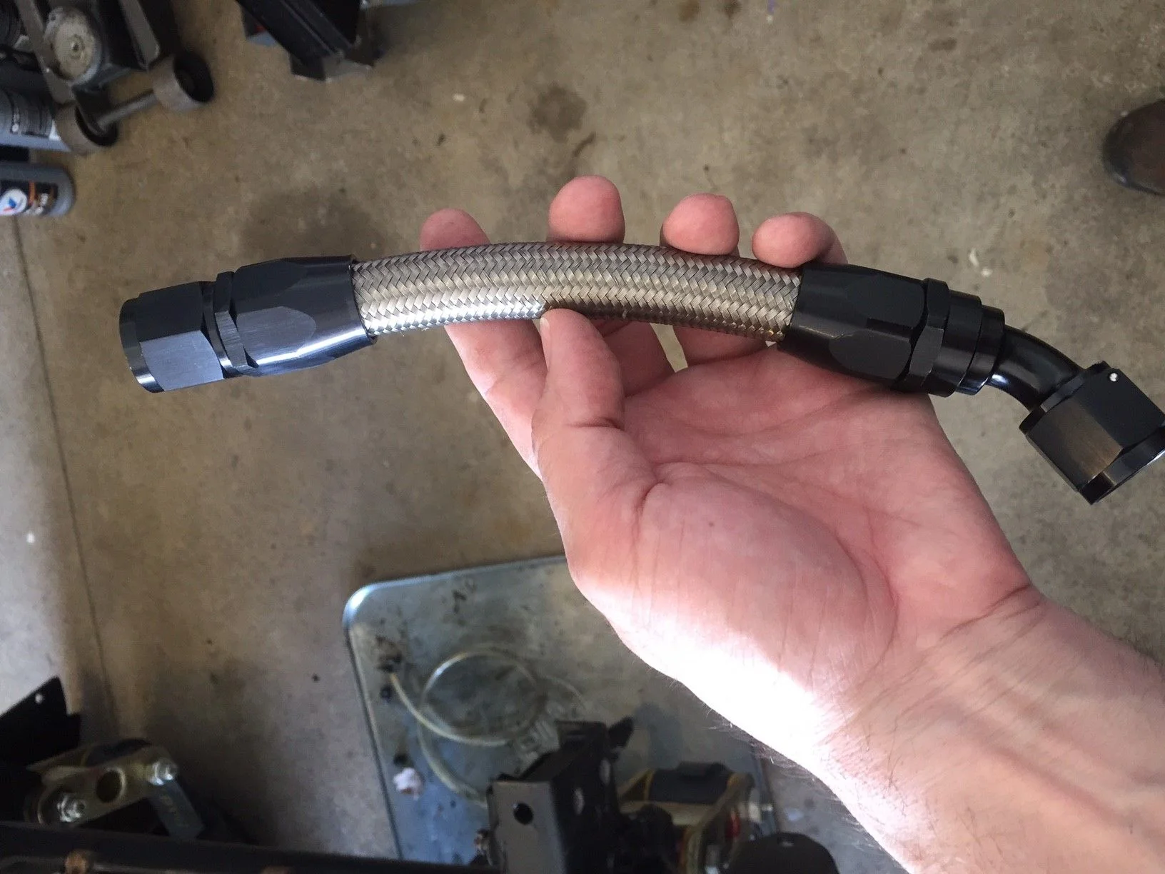

Rob also provided all the stainless steel braided lines and fittings to complete the connections for the supply and return of the oil for the turbo. On the supply side Rob provided an assortment of fittings to be able to T off the stock oil pressure sender, clear the engine block, and connect the turbo supply line. One side of the T still holds the factory oil pressure sender as shown in this picture:

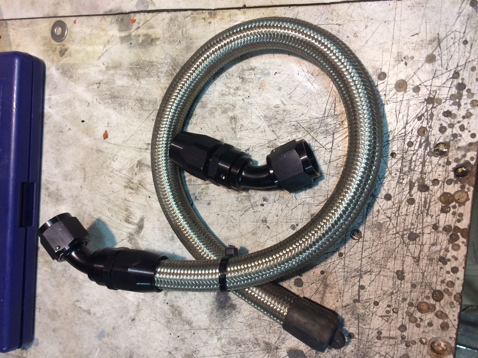

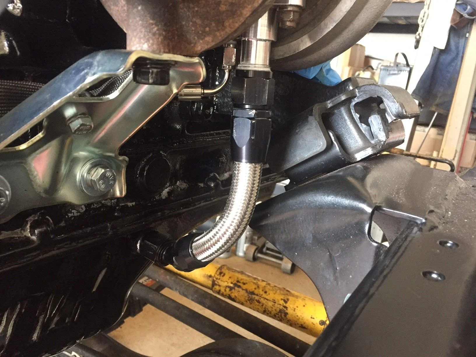

On the return side, a stainless steel braided line was also used with two fittings to match the length that I needed. The drain line turned out like shown in the pictures below:
I cannot say how thankful I am for Charles @Gun Runner 5 and Rob to help me with this. All the information on the threaded size connections to the block and turbo was made easy in a one stop shop to get all the correct fittings at once, rather than having to hunt them on eBay, Amazon, or specialty hose supply shops. Also, prices were more than reasonable for all the connections.

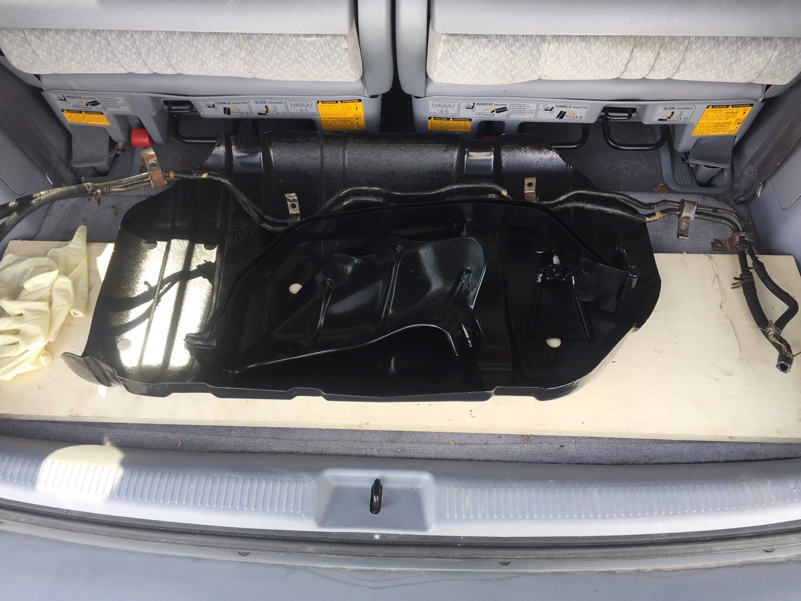

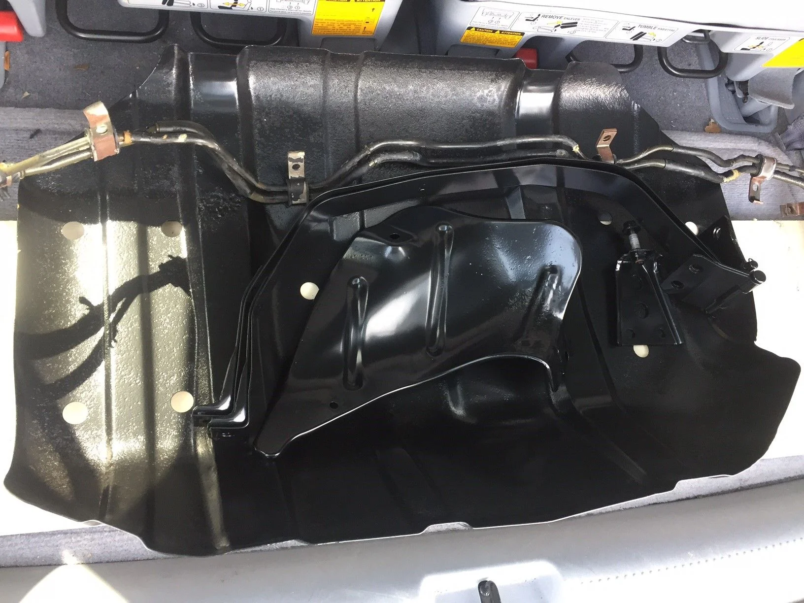

Last week I had the fuel tank skid plate, fuel tank straps, and wheel well fuel cover plate cleaned and powder coated black. Also got the frame fuel lines that Joe @joekatana gave me cleaned. Thank you, Joe, for providing so many parts with the 1HZ to make it easy for us.
All the cleaning and powder coating was done at American Metal Cleaning.

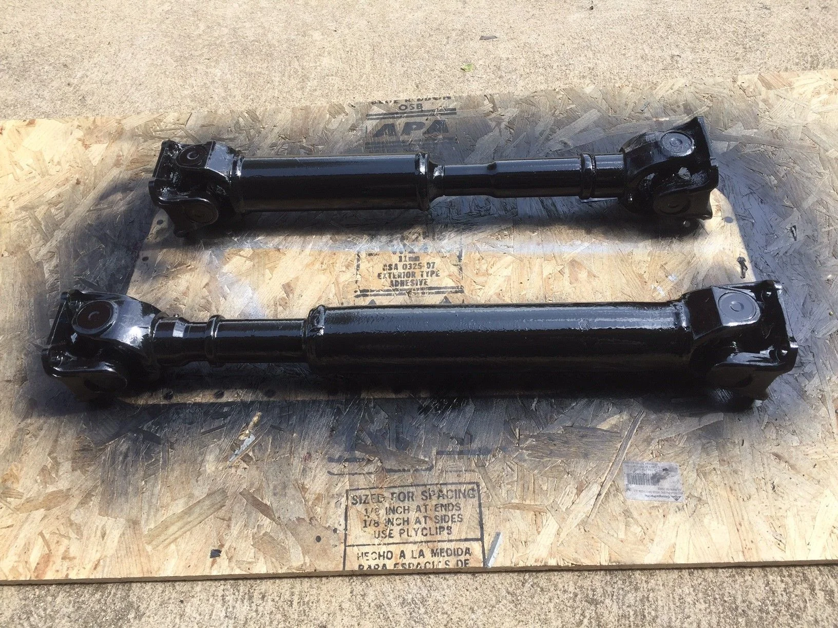

Also cleaned and painted the drive-shafts in my fancy paint booth @cruiserdan ;)

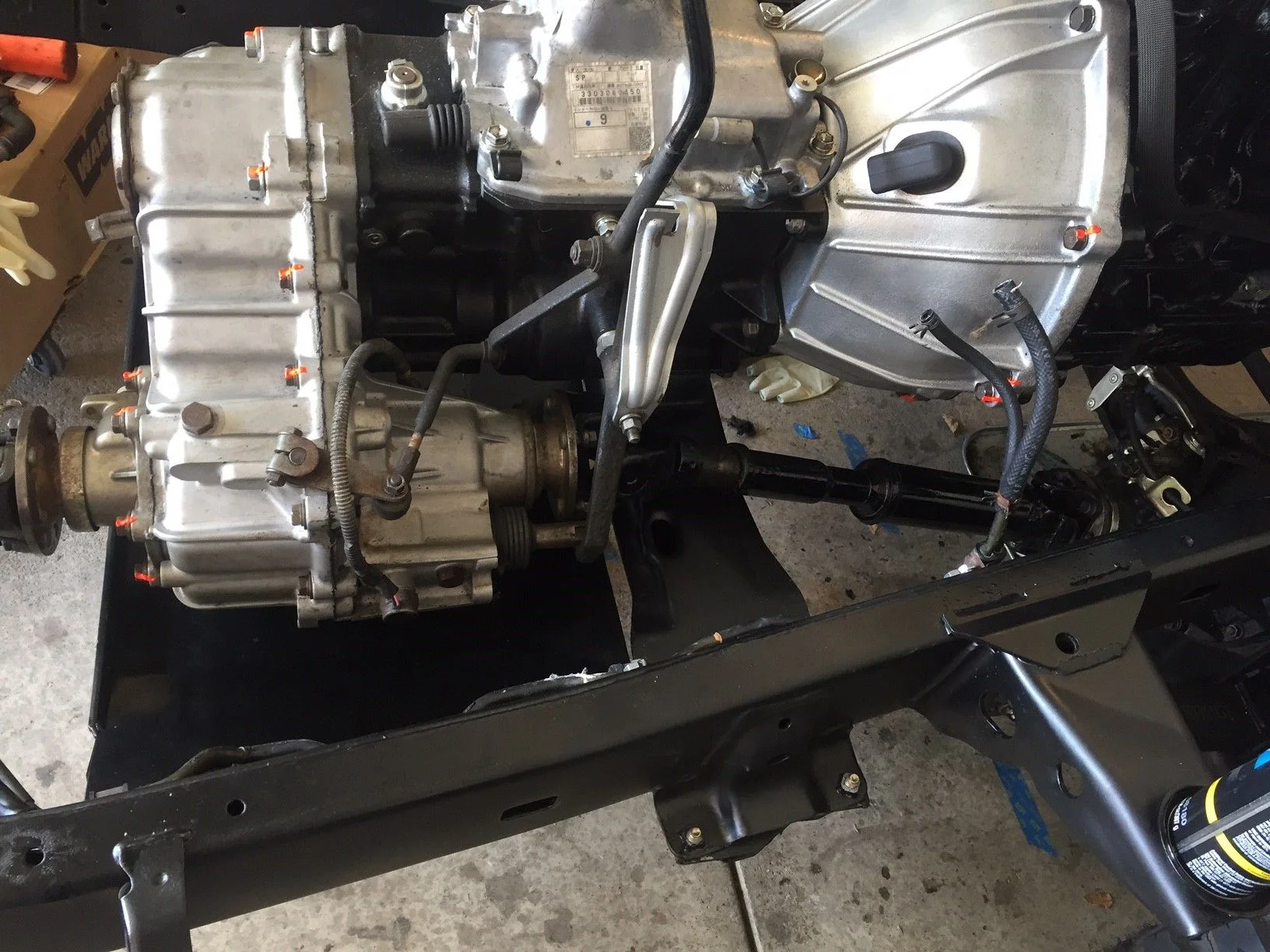

And installed the drive-shafts, fuel lines, and Cruisin Off-Road Skid Plate. I had to clean it since it had some dirt and dust from last time in Moab

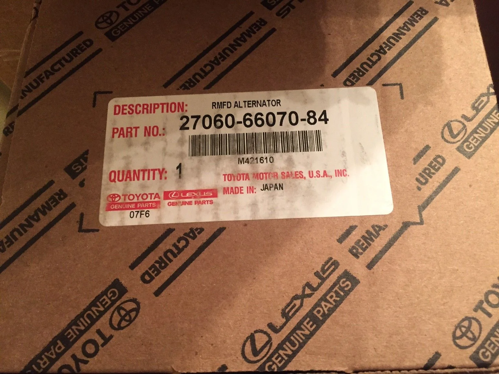

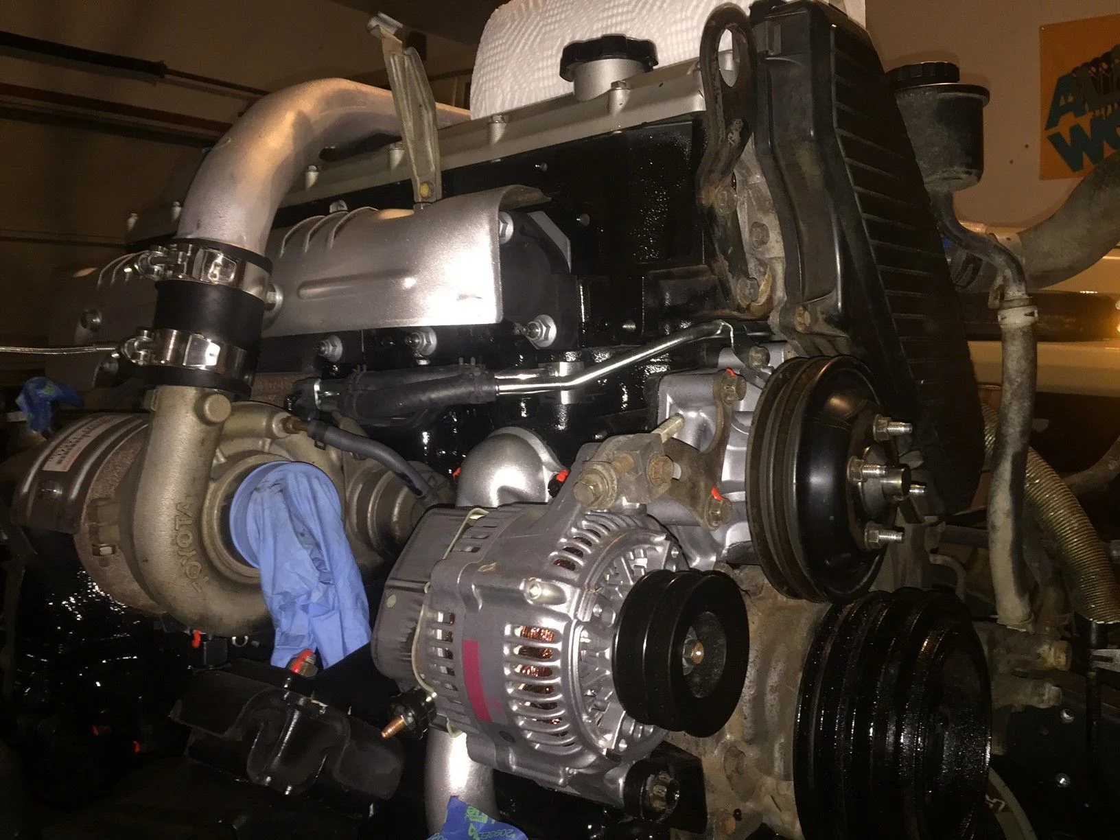

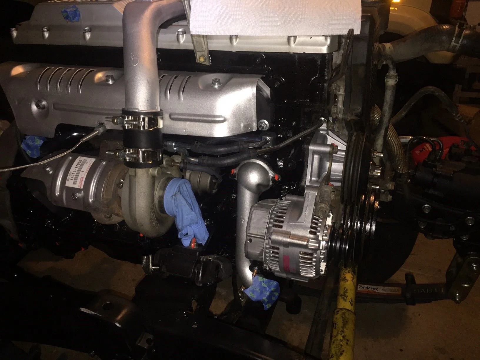

Got a Toyota Remanufactured 12 Volt Alternator (same as alternator for 1FZ). Part numbers are listed in photos below:
And installed it on the engine:
Don't you want to run a tundra 150 amp alt in there .. perfect time for required mods to make it work ..
Hi David!
You know, when I thought about it I had already the 90 Amp alternator in my hands. But compared to the anemic 35 - 40 Amps that I got from the 3B alternator, the 90 Amps will do great, I think :)

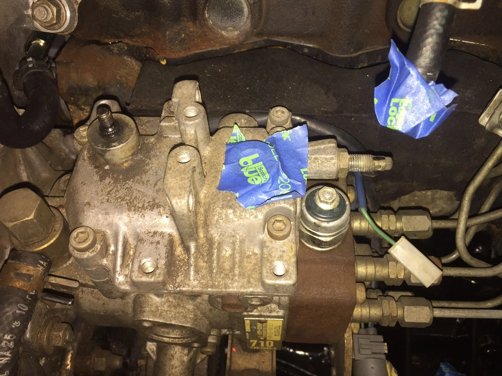

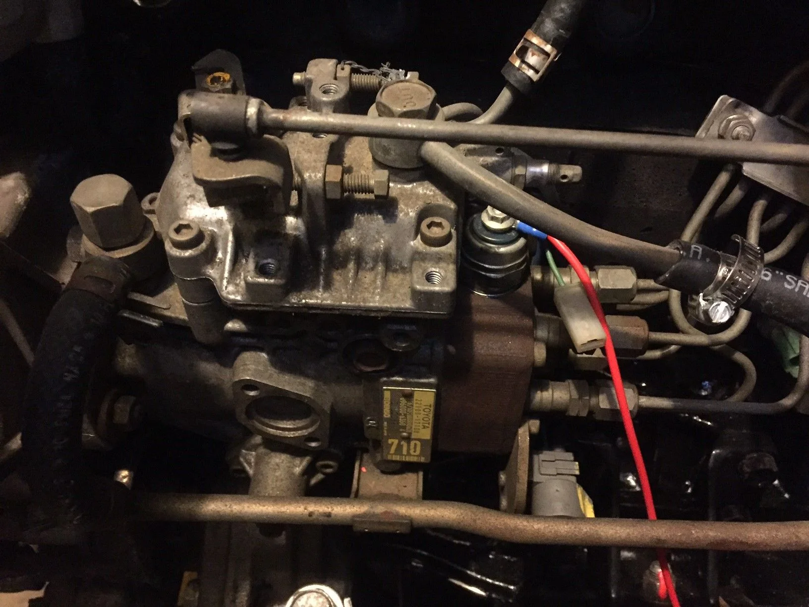

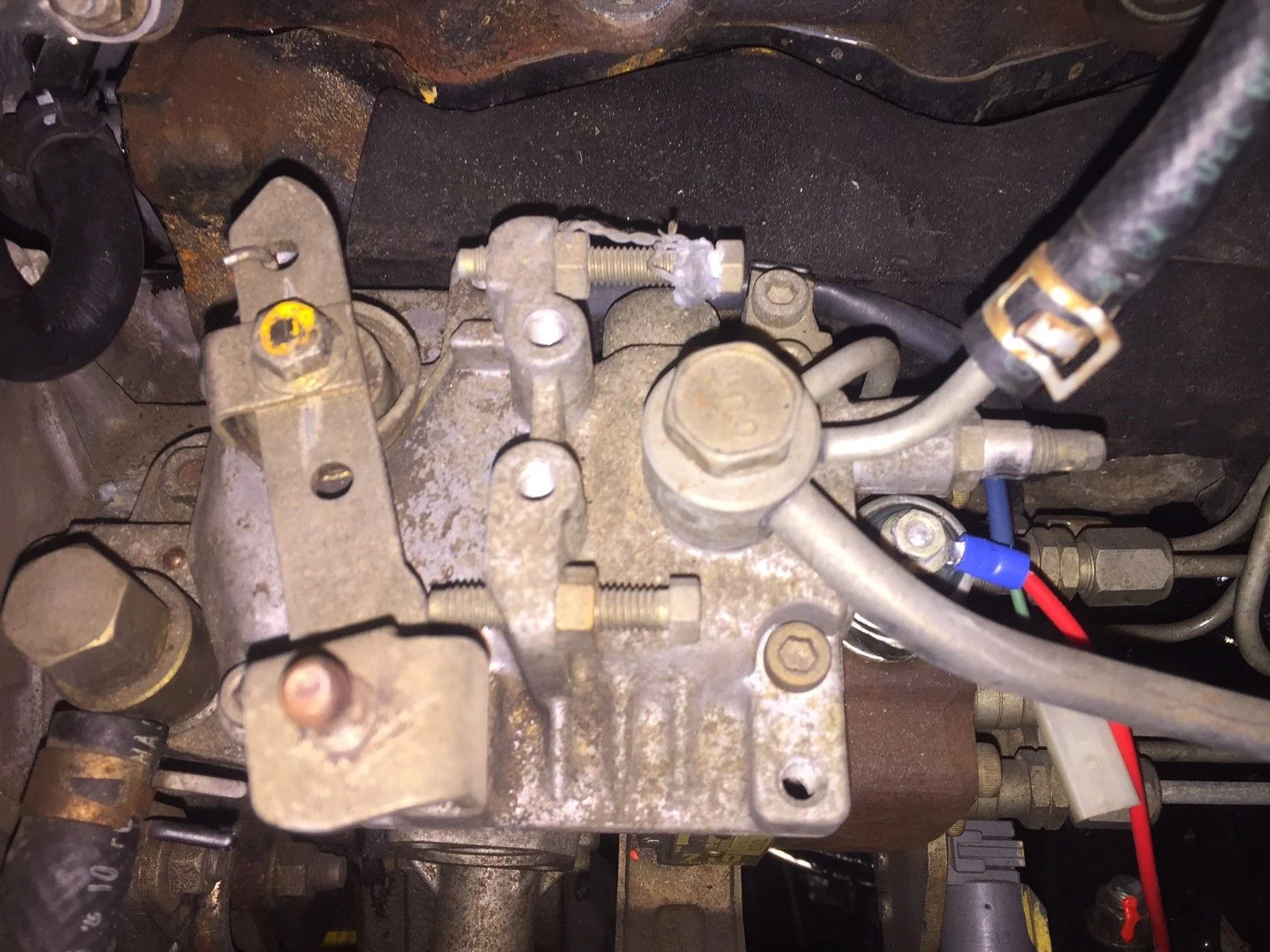

Let's get a little familiar with the 1HZ (Non-turbo) injection pump:
Removing the throttle linkage would get us this view (to remove the throttle linkage just gently pry under the clip and it will come easily undone):
Let's identify some key components:

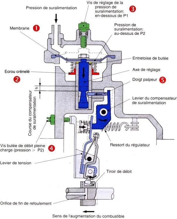

And a good cross section diagram of a Boost Compensator for a Cummins VE Pump. Unfortunately, the diagram is in French:
The internals of the VE Pump from a Cummins, and other VE Pump equipped engines are not exactly identical to the ones on a 1HZ, but surprisingly very close.

First off is to remove the Throttle Lever, there is a line-up mark on the throttle control lever and also on the throttle control rod (screw). Make sure you note how this was assembled so you can install it in the same position once you are ready to assemble. Then also remove the idle speed screw and the maximum engine speed screw (I counted how many times I had to spin the screw to remove it from the marked position, but then learned that this doesn't matter much as adjustment will the boost compensator will be much different than for the non-compensated pump):
Then remove the banjo bolt for the fuel return line. Notice that the lock-collar that was installed in the fuel control screw is also removed. You grab this collar with pliers and the collar with cleanly split open, making it very easy to remove. Remove the fuel control screw (once more, I marked it and counted how many turns I had to spin it in order to fully remove it).
Then, remove the five (5) Allen screws, four of them hold the injection pump cover to the injection pump body, and the last one (behind the pump) holds the wire for the engine speed sensor (Tachometer pick up location). To remove the cover, gently pry it off the base, while pushing down on the throttle control rod to separate it from the top cover. The throttle control rod is lightly held to the injection pump cover by an O-ring (new one is supplied on @Akella 's kit). You will end up with something like this:
