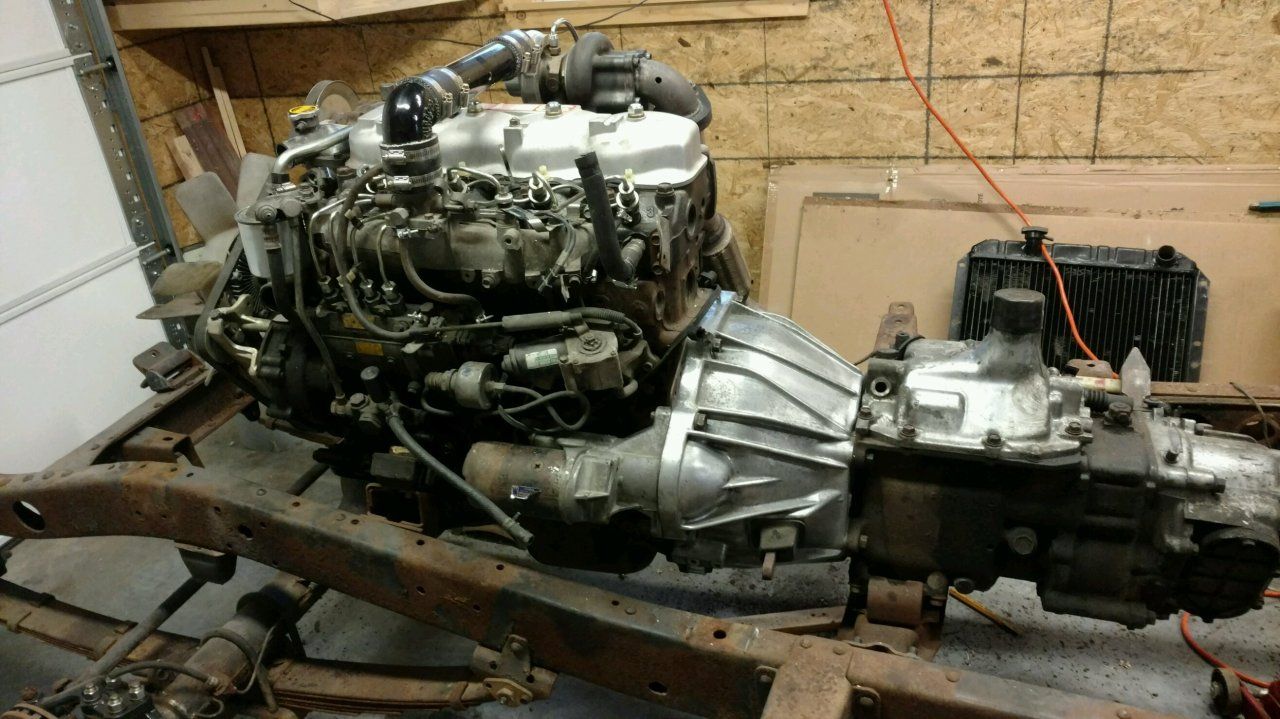

And then, this happened:
For Sale: - [OH] 3B-Turbo, H55, and Split Case
John @Recon1504 bought the 3B + H55 off my BJ70 so I went ahead and pulled the drivetrain.

Cummins 4BT ...... It's on the pallet waiting for pickup.
Nice!
So what motor is going into that 70?
It will be a 1HZ with the H55. Everything takes me forever and a day to do, so progress is slow. I still need to pick up the parts to do the swap. It will be Toyota engine. No Cummins on this one :).

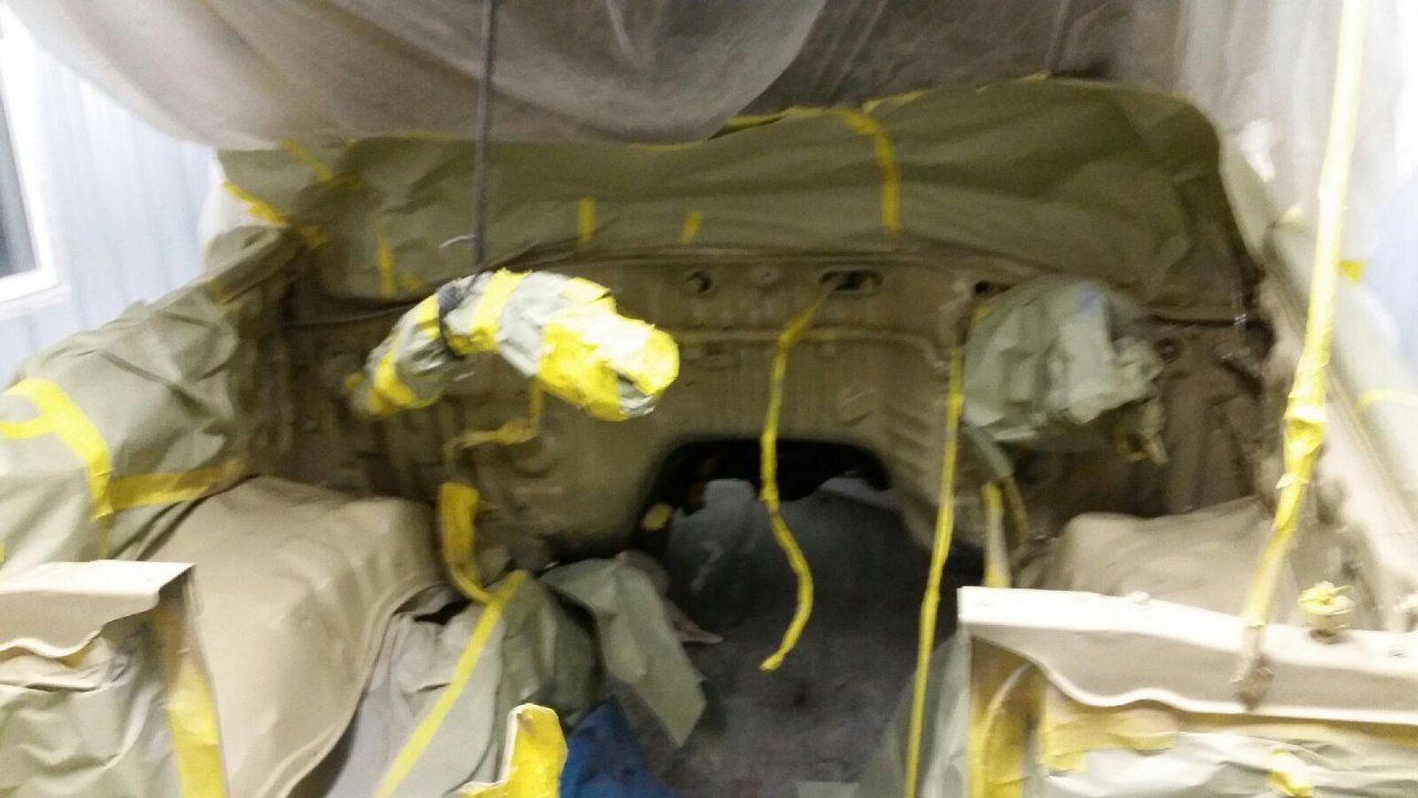

So, one thing that bothered me ever since I painted the truck, was the two-color engine bay. Jeff (the paint guy) did as best as he could to paint the engine bay the first time with the engine and all accessories in place, but it always bothered me when I opened the hood. Even when this truck is not a show-truck, I wanted to make it look more "factory correct".
Once the 3B-T engine was out, I called Jeff and he came and picked up the 70 and painted the engine bay to match the rest of the body.
You can see the lines where the Tan and the Brown color met before Jeff painted it.
