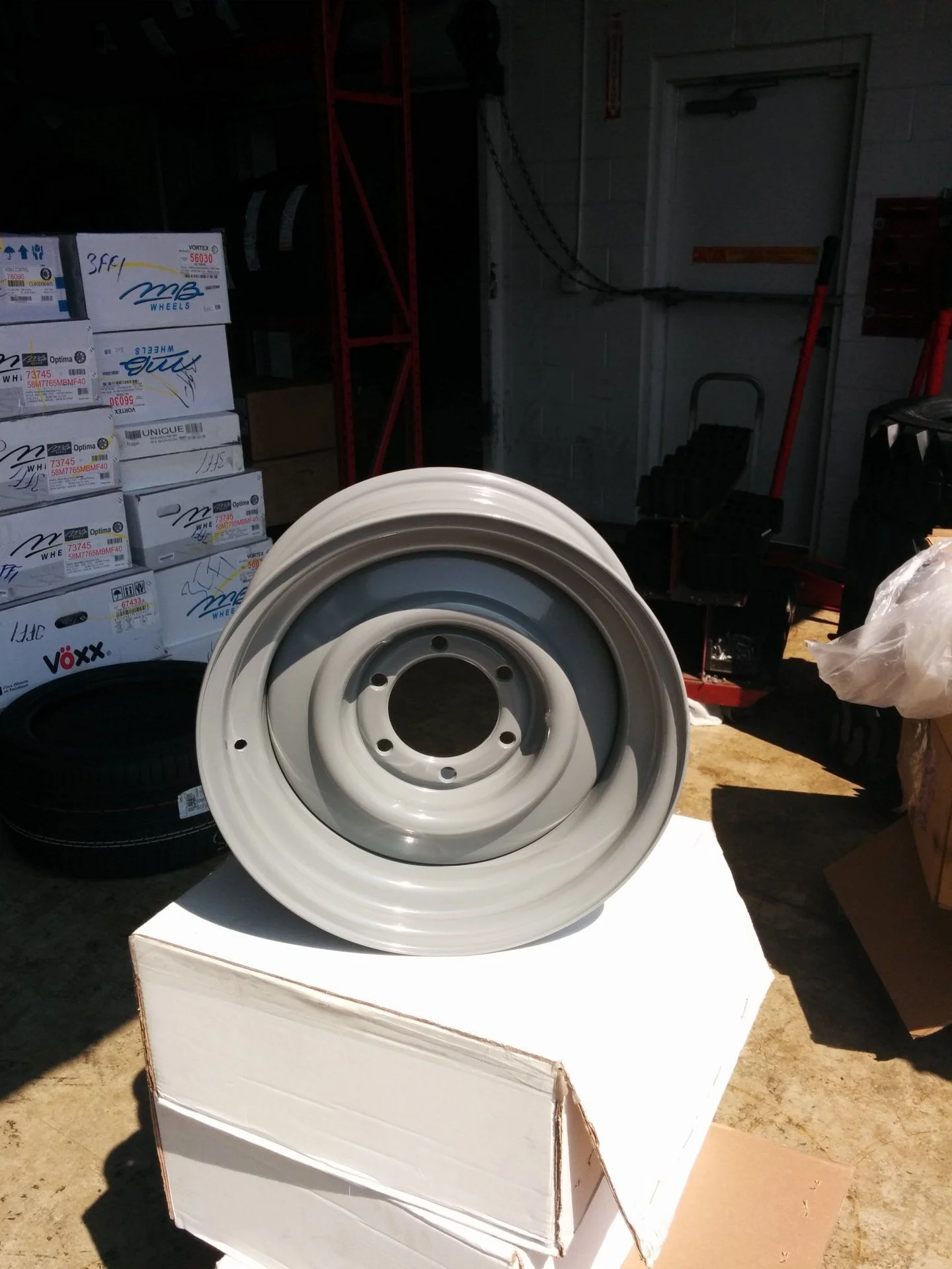

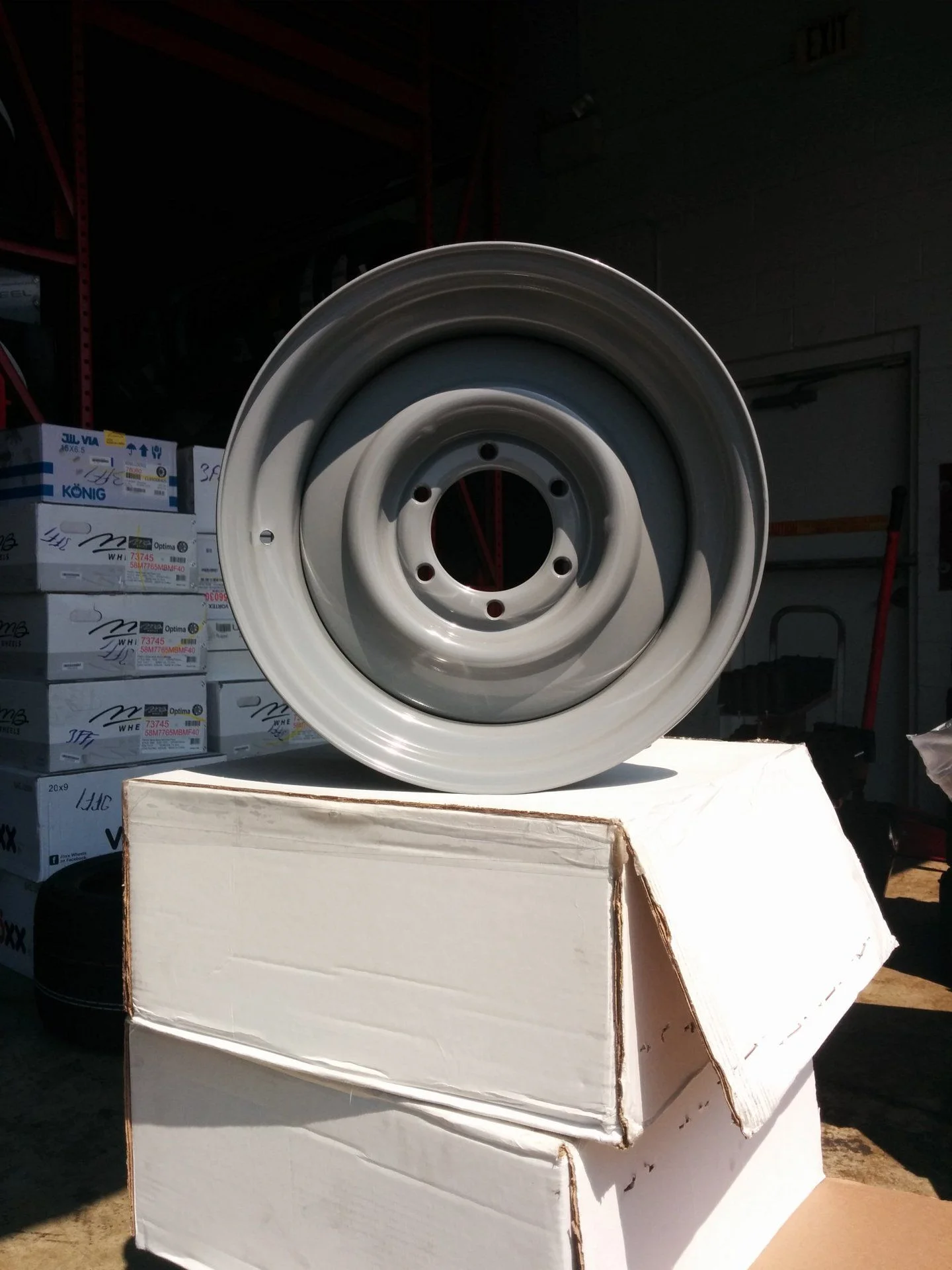

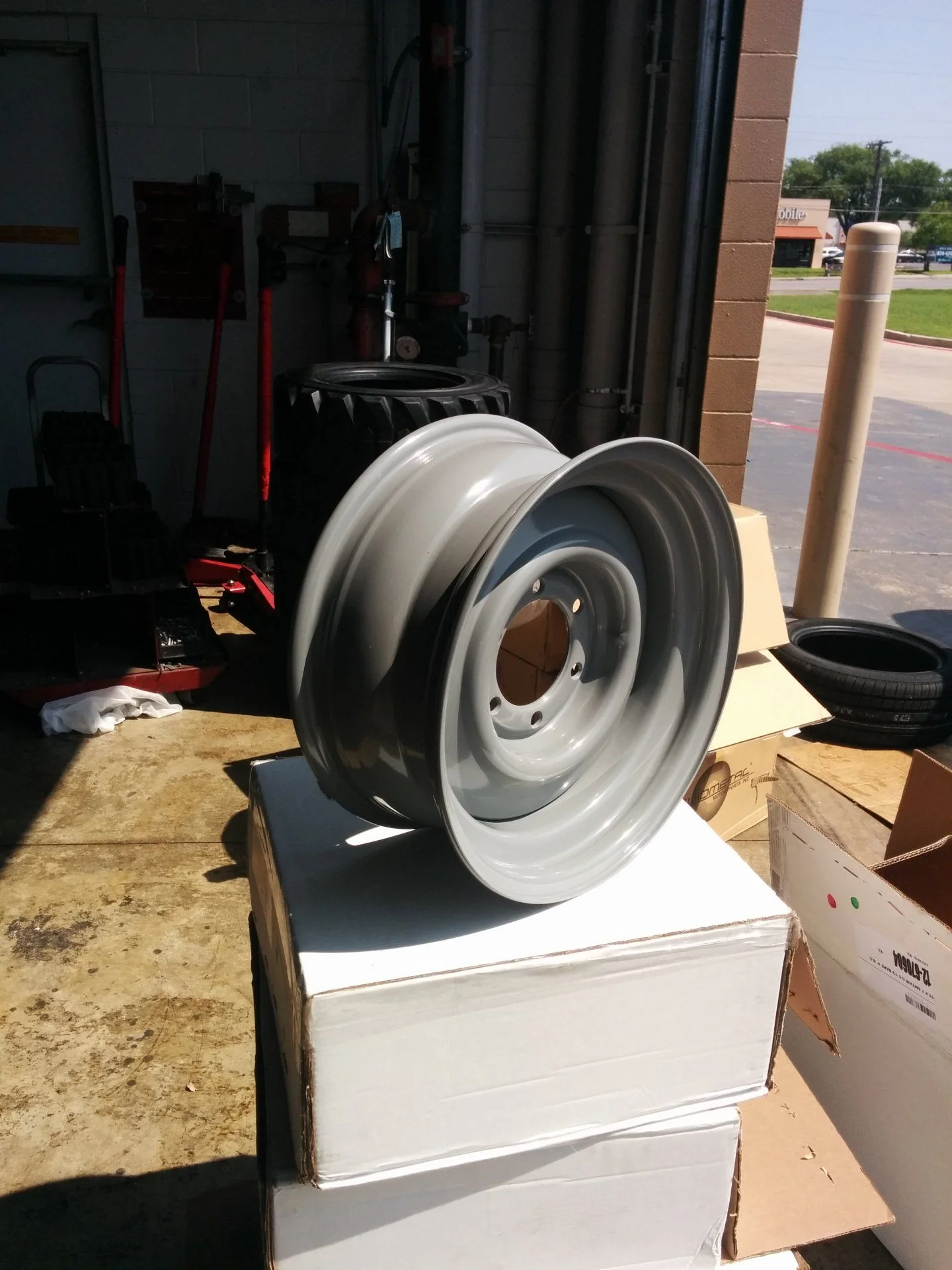

Wheels: Wheel Vintiques 12 Series Smoothie Wheels - 16 in.x 7 in., 6 x 5.5 in. Bolt Circle, 4 in. Backspace (12-670604)
Tires: BF Goodrich AT KO2 (235/85 R16) (32 PSI)
Powder coat: Prismatic Powders RAL-7037
Lugs: Zinc Plated - OEM Acorn Style (CruiserCorps - 549-282)
Classic look. I like the Eurospec mirrors as well. Very nice!
Yeah man, Ive been rocking those same wheels, same size.
They come in gray primer, I just sprayed mine with Rustoleum Professional High Perf Enamel in Dark Machine Gray.

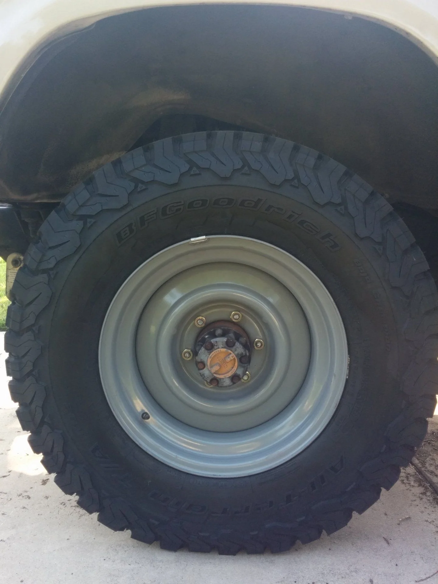

Inside pic of the TRE would be helpful.
A 15" rim gets a lot closer to the TRE than a 16" rim does (that 1/2" really helps).
I'll likely do a 17" rim in the same style for a project I'm considering.
@B H Wondering what suspension you are in those photos? Thanks

Hey @B H , what suspension system does your cruiser have? Thanks.
