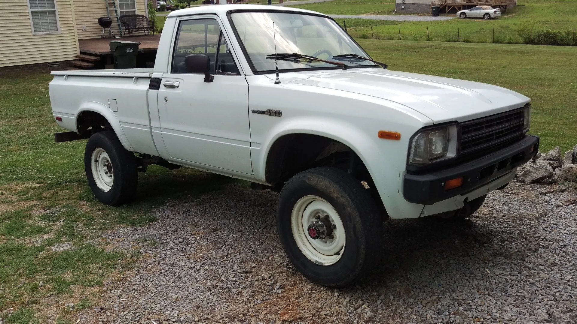

So i bought this 83 pickup from a guy in bakersfield ca for $3000 in 2016, he was only the second owner and this pickup is 98% rust free and no dents or damage anywhere. Which is pretty amazing since he used it as a work truck for 15+ years, so i was amazed at how perfect it was and offered to buy it on the spot and of course he said no but i left my number and 4 years later he called and i drove from Nashville to Bakersfield to buy it from him.
So this is the truck I am working with, i also have plans to make her a true SR5 eventually. That was the only thing missing that i really wanted, the SR5 looks the best in my opinion. And i do not want a "clone" so when i get a solid frame and vin numbers she will be a true.

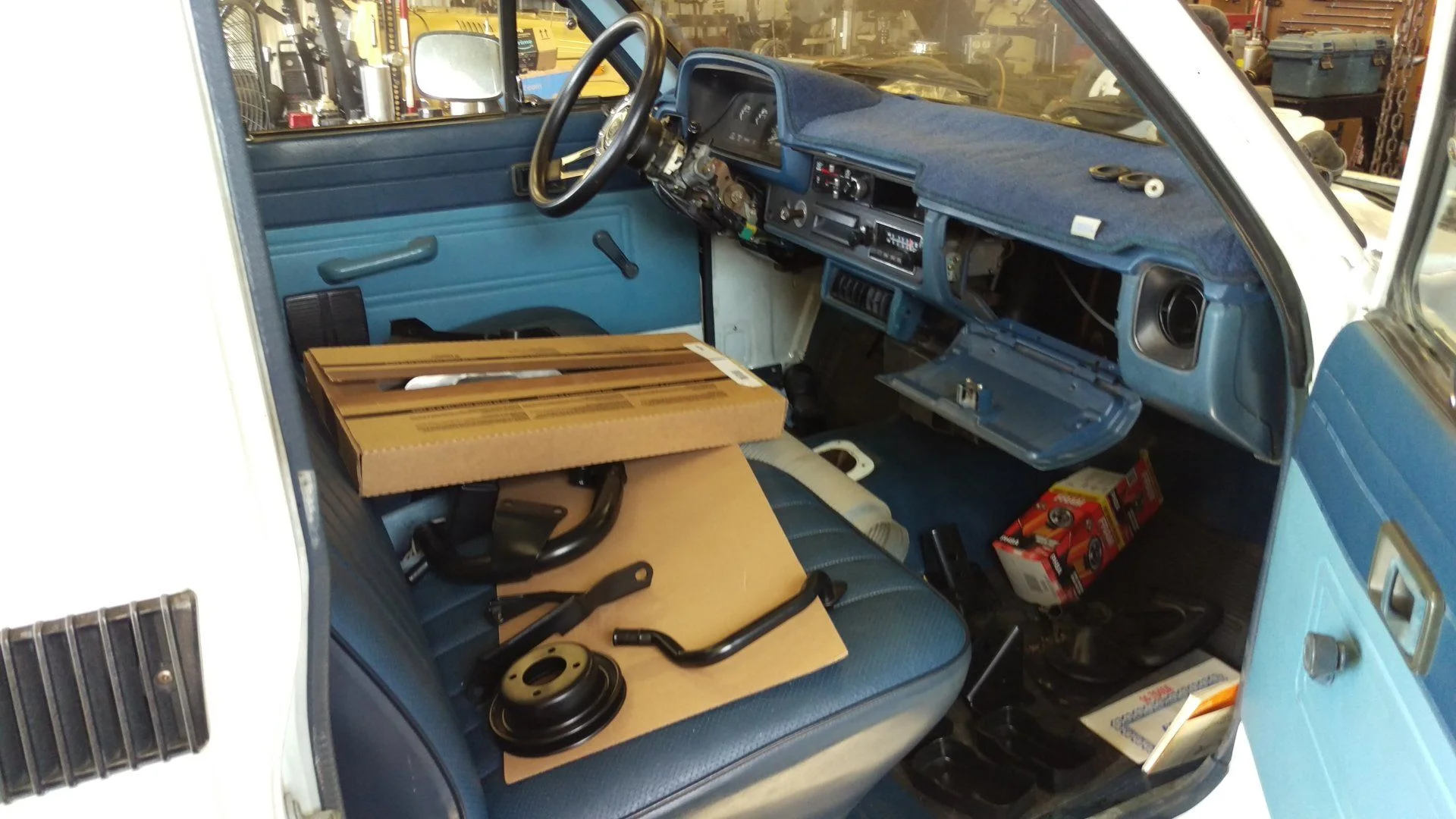

The interior was in excellent shape and all of the parts are there except the tilt steering colum covers. So i really want to ditch the bench seat and get some buckets 100%, and the carpet and headliner will not be factory, im going to go my own direction when that time comes. I do not have a first interior picture when i just bought her, this is after i already removed a few pieces and such.

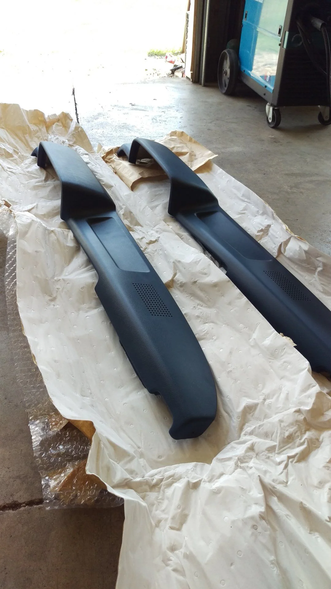

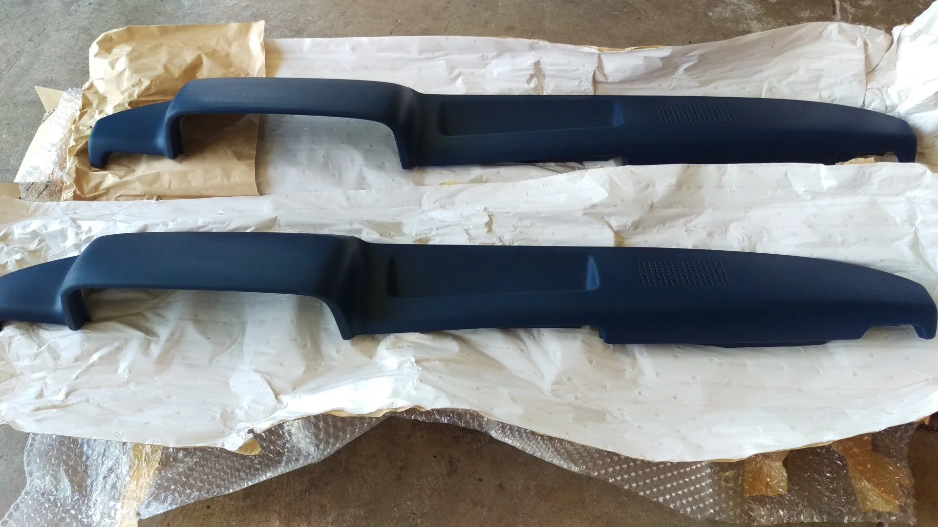

So i was lucky and so excited that i was able to buy a brand new dash pad in the right color that well i could not help myself and i bought both that they had in stock. I figured that i plan on keeping the truck my whole life so i would probably need that second new dash pad eventually.
2030922
Man this part is priceless in my opinion and is a must no matter the cost. I only paid $200 a piece and a $100 in shipping so not to bad in my opinion.

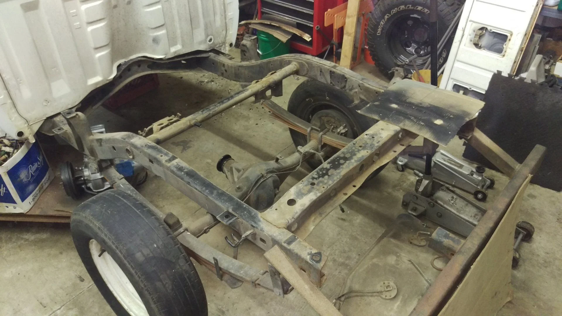

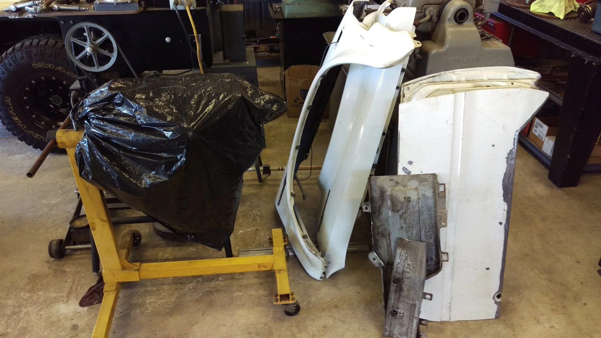

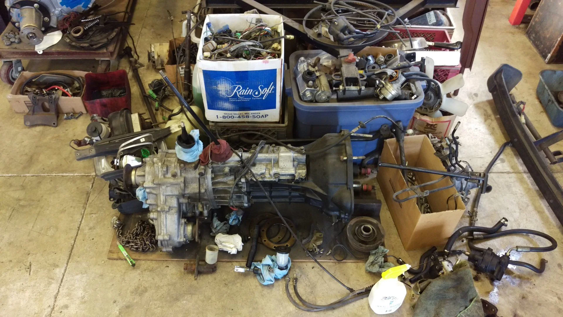

So as far as progress goes, i have the entire pickup disassembled and in pieces, every single nut and bolt. So far all of the body parts are in great shape and do not need replaced. Even the paint on the frame is in amazing shape considering its age.
Im also just alittle all over the place when it comes to this build, i will be working on this resto in between all of my other projects i have on my 2016 Tacoma, 70 FJ40 and my other 1982 SR5 pickup. This resto is definatlly going to take a couple years since im not a millionare and retired lol. But so far ive made pretty good progress i think, but it is always easier tearing it apart vs getting back together.

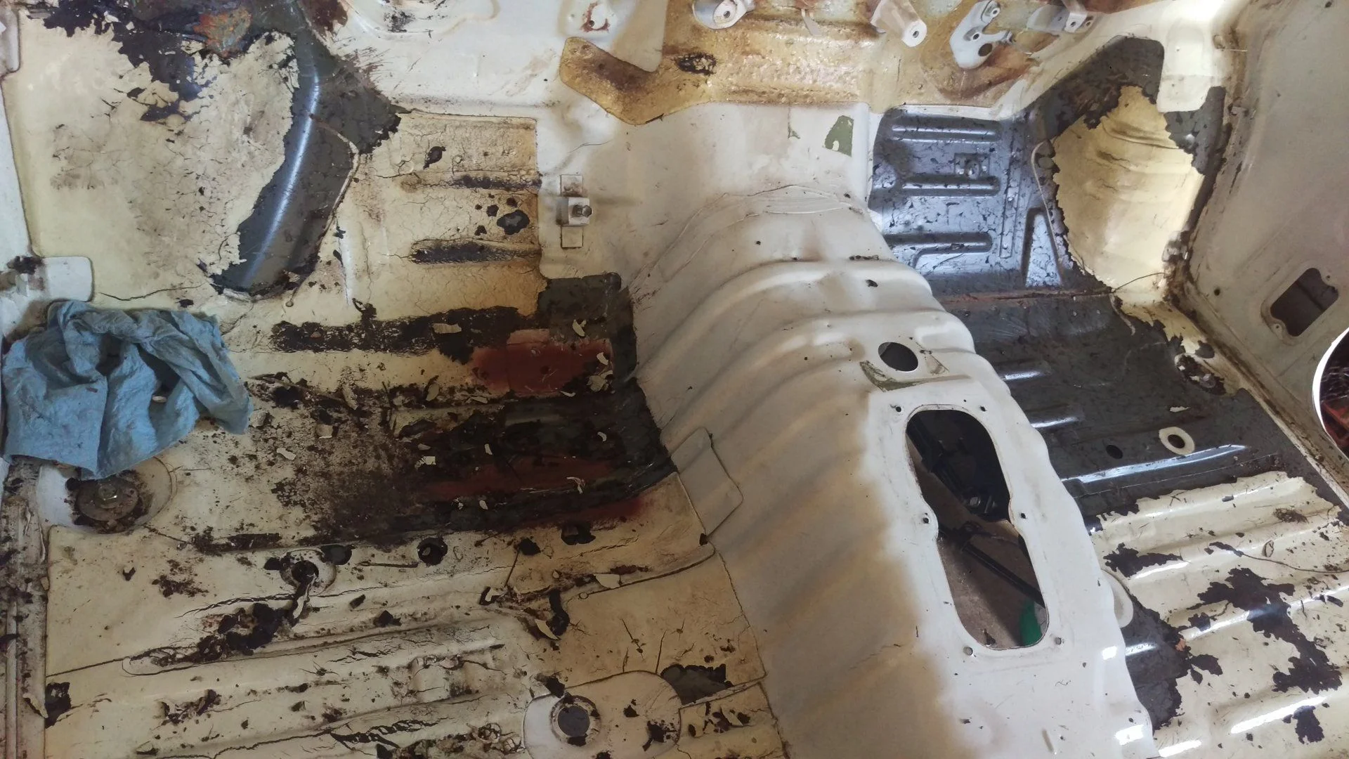

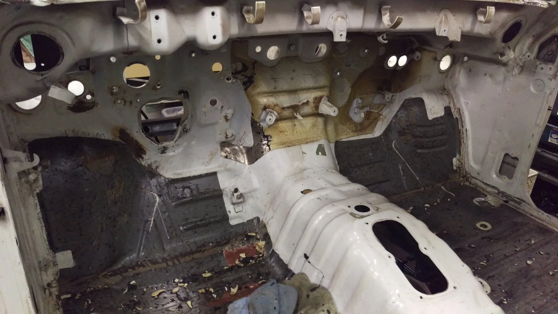

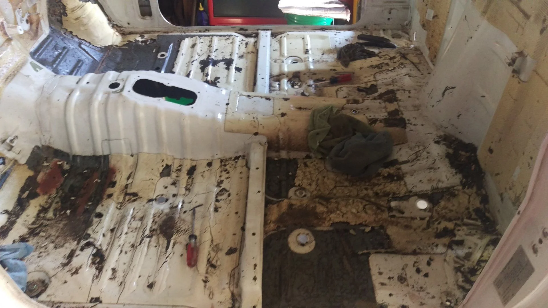

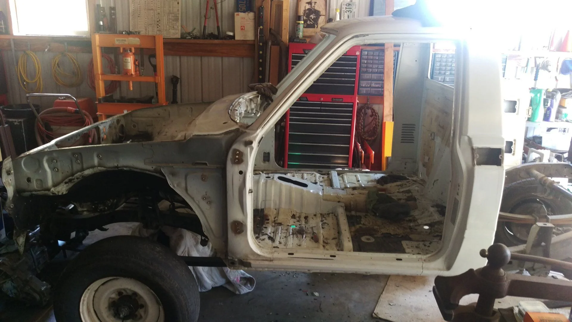

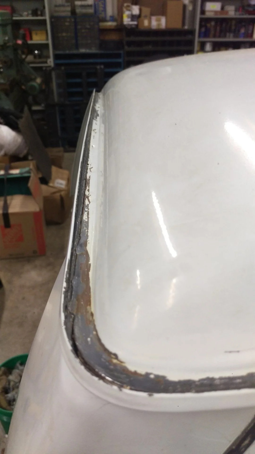

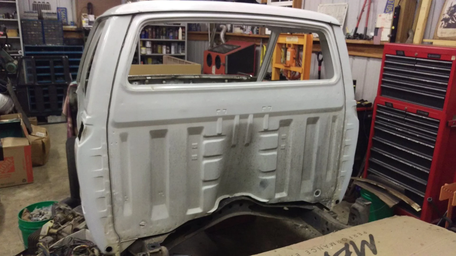

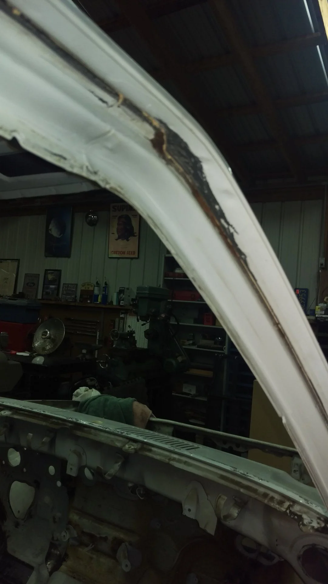

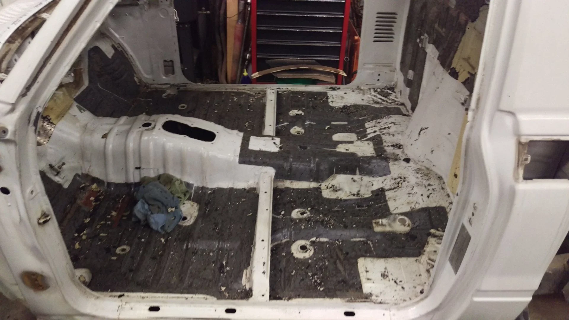

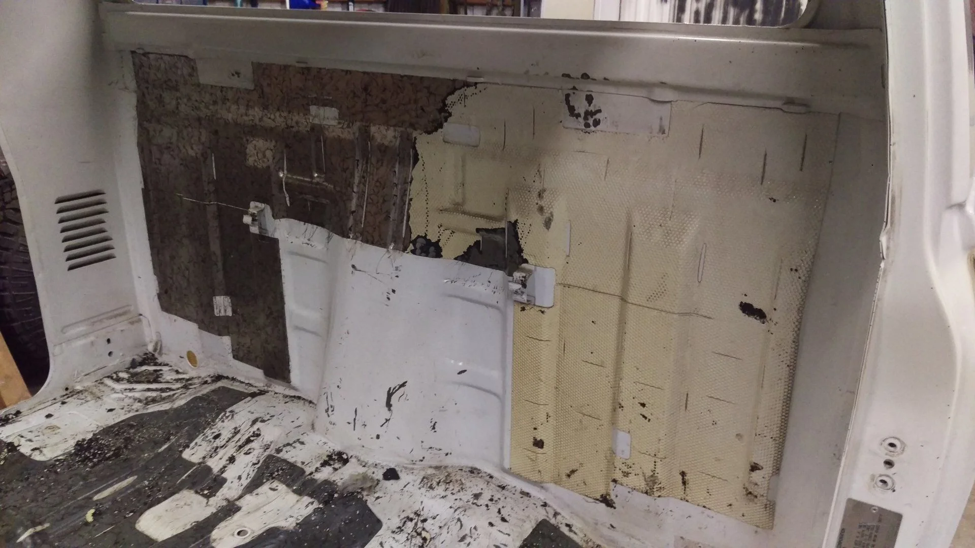

So im at the point where she has been stripped completly and once i got down to the bare body i needed to address any imediate rust or damages on the cab and bed. I noticed that under all the factory sound deading that some water had gotten under it and thankfully didnt damage anything, so i had once choice i had to strip all of the sound deading. Since i had to remove it all i really want to spray the entire cab on the inside with lizard skin and coat it the best i can, so thats my plan for the inside the cab.

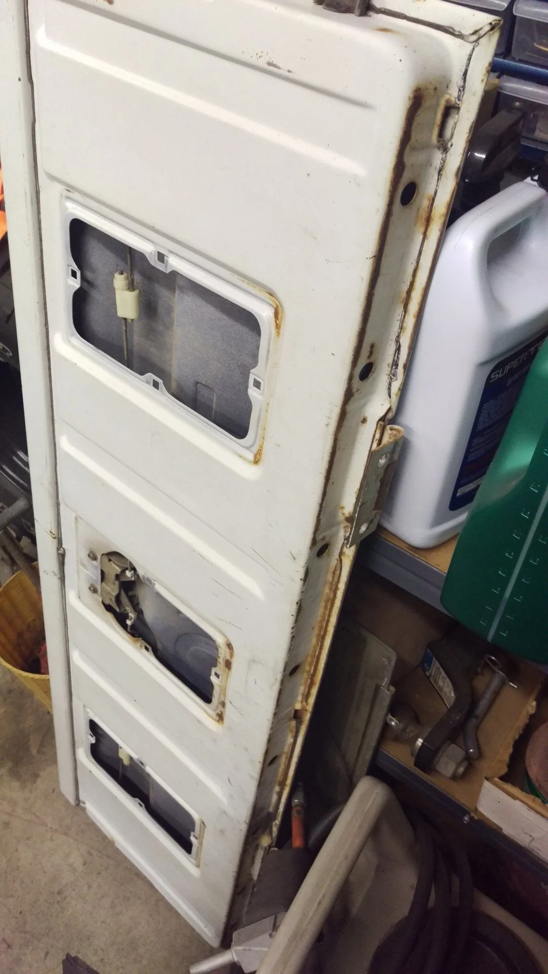

So there is some rust on the tailgate at the drain holes on the bottom, so i will have to cut and weld at the bottom to fix that problem, but all in all this tail gate is in great shape! I wish i could buy a brand new one still.

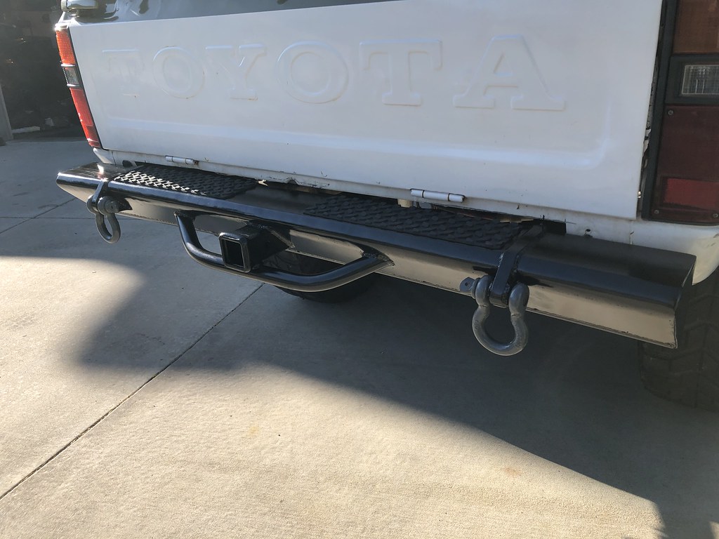

I will have to do something about that crappy homemade rear bumper aswell. Either go back to stock or see if i can build something nice for this truck, because theres really no options out there for full rear bumpers. This truck just has some weird body lines that make it pretty tough to build a bumper like whats on my 16 tacoma. So i will figure out something at a later date on that.

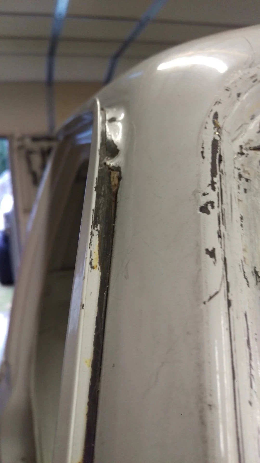

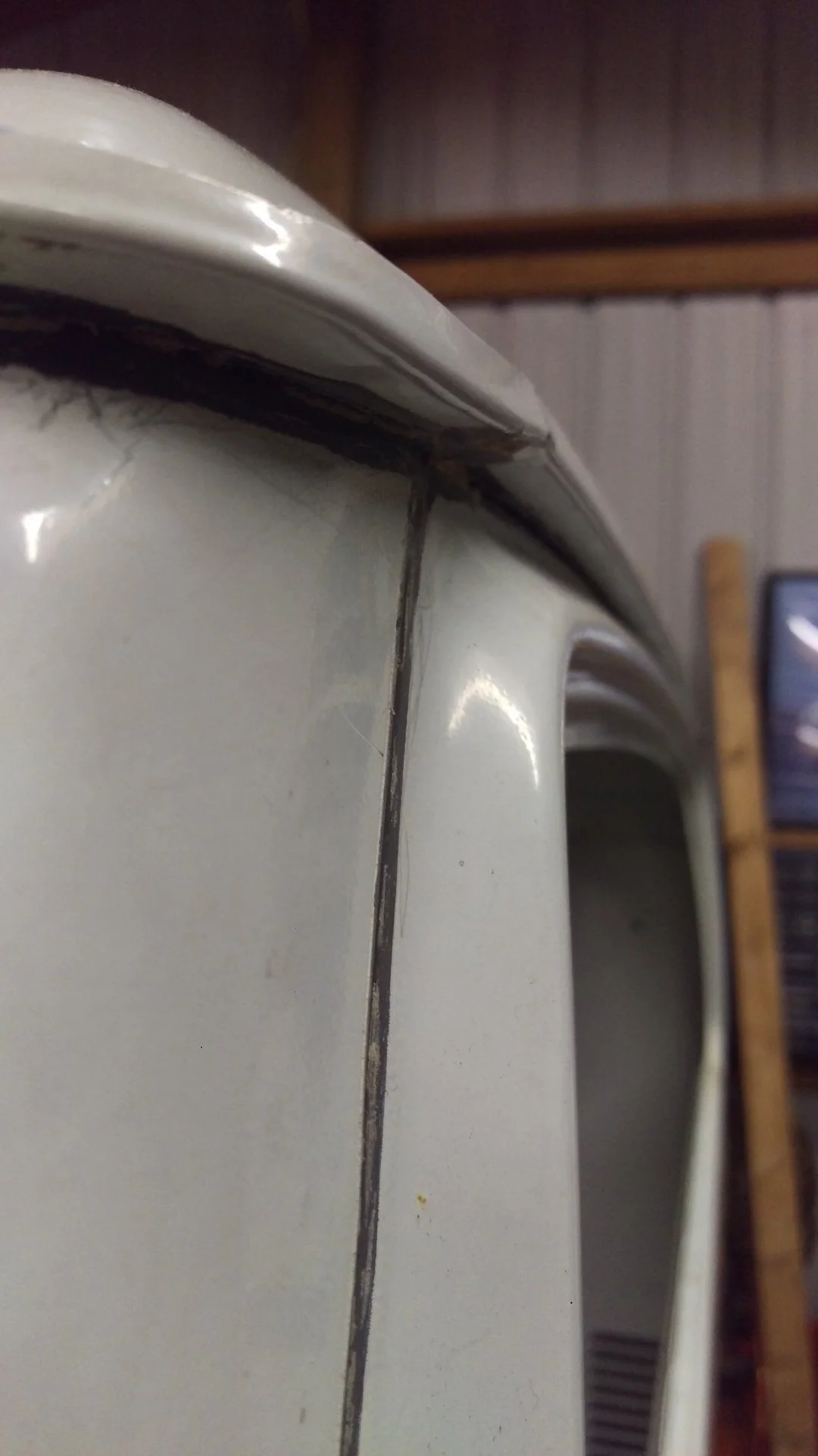

So i started investigating all of the seam sealer around the entire cab and it was cracking so bad and getting light rust under it that i decided to strip ALL of the seam sealer outside the cab and inside aswell as the engine bay. I figured if i am going to go this far then i better do it right. Now ive never really tried replacing seam sealer let alone making it look factory, so i think this will be a challenge for me. I still have to strip more on the bed but other then that i need to purchase a few tools to be able to apply all of the seam sealer that needs replaced, so im just doing as much research as i can right now on what all is involved. but heres a few pictures of what i have to work with here. I just couldnt live with what rust was already setting in under all of that sealer.

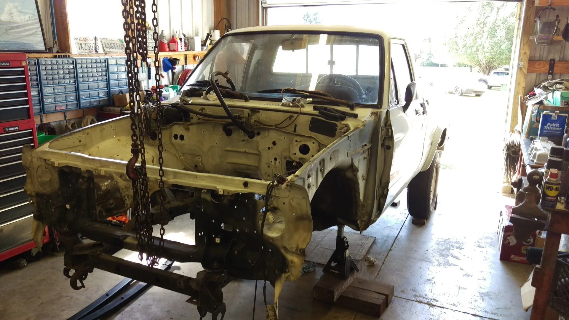

Any ideas on how you're going to get the cab off? :)
Digging the build - that truck was really clean to begin with too!
Well I appreciate it bud, yeah this truck was very well taken care, crazy that it was used as a gardening work truck for 15 years. Well it will either be by muscle, I got 2 older brothers at my disposal or by a chain block. I have a pretty strong steel beam I can also use in my shop.
Two brothers can definitely help! I used the beams of my buddy’s patio and some ratchet straps to get the cab off of my 85 F250.
I’ve also seen people get cabs off using 2x4s and cherry pickers too!

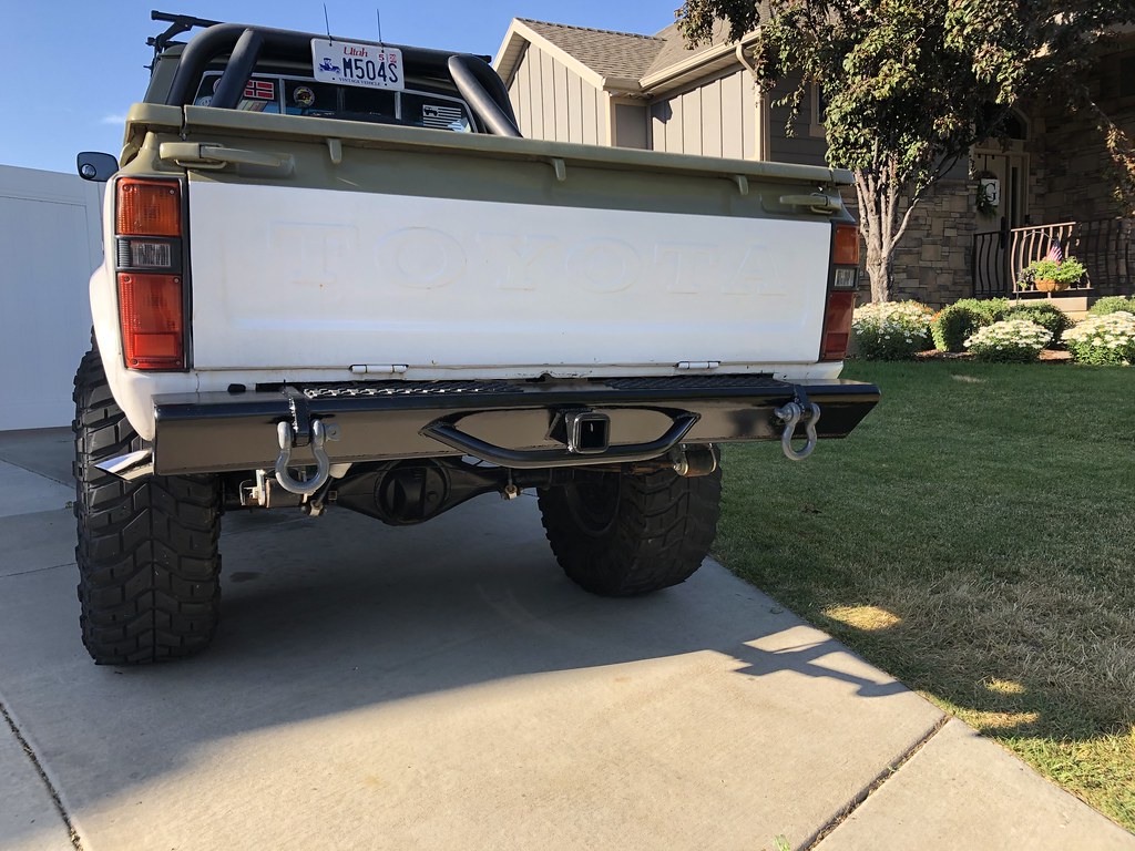

Man, I wish the 1980 that we got for my son was that clean. It quickly went from a "resto" project to a "just make it reliable and have fun with it" project. We went through the dilemma of finding bumpers with no luck finding anything we liked. Ended up building both and used it as an opportunity to teach my son some fabrication skills. I helped do more of the front bumper but he was able to do nearly all of the rear bumper.
SFSP0598 by Adam Tolman, on Flickr
Rear bumper by Adam Tolman, on Flickr

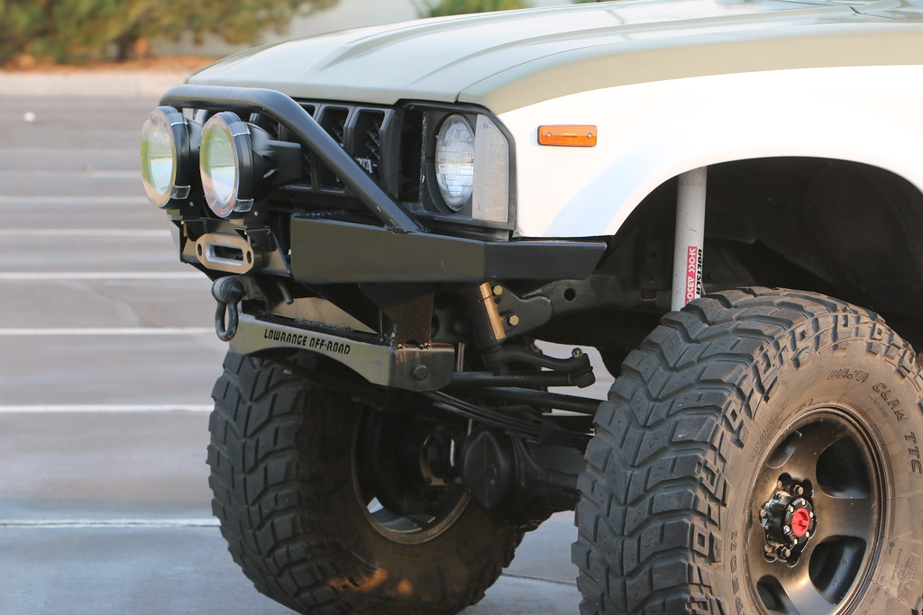

Hey those bumpers turned out really really well! Ive spent a good amount of time thinking and drawing a design for a front and rear bumper for these (and im still not happy with it) haha, the rear just has some weird body lines that makes it hard to do anything with. You mind if i keep your images? Not alot of decent looking bumpers out there for this generation, and dont worry i wont copy them, its just for inspiration.
