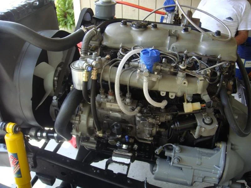

Rob, please help.
attachment.php
The short steel pipe on the lower radiater hose, does it bolt to the fan shroud or what ? Mine was just loose and not bolted to anything :confused:
Theo, yes it does, there should be 2 threaded boles on the bottom of shroud that it bolts to, I will go take pics. I could only get 1 back threaded though after I put that lower radiator hose heater on? but its tight.
