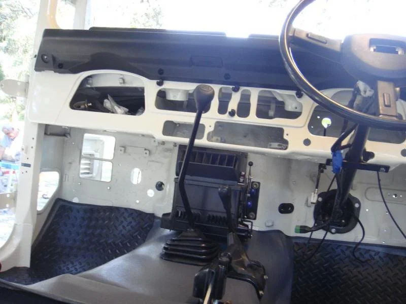

last ones for now
Never notice the bend in the shifter for a RHD rig. Guess it make it easier to shift in first from the Right side.

more photos, got on frame with new poly body mounts, windshield on with new rubber, rear seats on, molded ruber flooring in, heater restored by Aatlas in, steering column in, brake booster on, fuel tank all hooked back up, e-brake hooked up, antenna on, windshield wiper linkage on, clutch lines back on, ...... problems we ran across, please look at one pic i am posting, just right below the edic motor mount is a threaded hole in which when we starting filling radiator up with coolant it all starting coming out that hole, what goes in that hole (circled in blue alone)....other things were late model OEM transfer inner rubber boot and outer is way smaller and does not fit (probably having something to do with my factory 5 speed???) Theo, if you reading can you send me some pics of how your metal line that goes from outlet of sedimenter is routed to go near the inlet to injection pump, we can not figure it out...

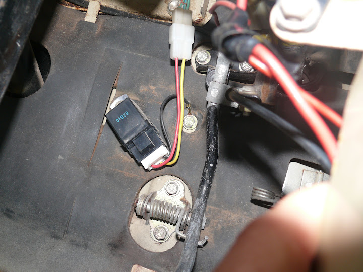

It seems my preheat timer, starter relay etc were fitted everywhere but in the correct location. The pre heat timer was actually just dangling loose :eek: Could you please post some pics of where you fitted all the relays in that pax footwell area ? I tried the TOYODIY site but it is not clear. Is it that U-shaped and half U shaped brackets next to the blower holes ?
Here ya go Theo. right next to heater blower hole under dash glovebox. also, the fuel relay is mounted under the dash on left outside area of glovebox (not inside but outside of glovebox, you will see the mounting holes align). and this roundish relay looking thing gets mounted on right side of glovebox underneath dash. Hop this helped?
Rob

As promissed Rob. Bear in mind that these were taken during the stripdown and I have not refitted it yet so I cannot vouch for the correctness
