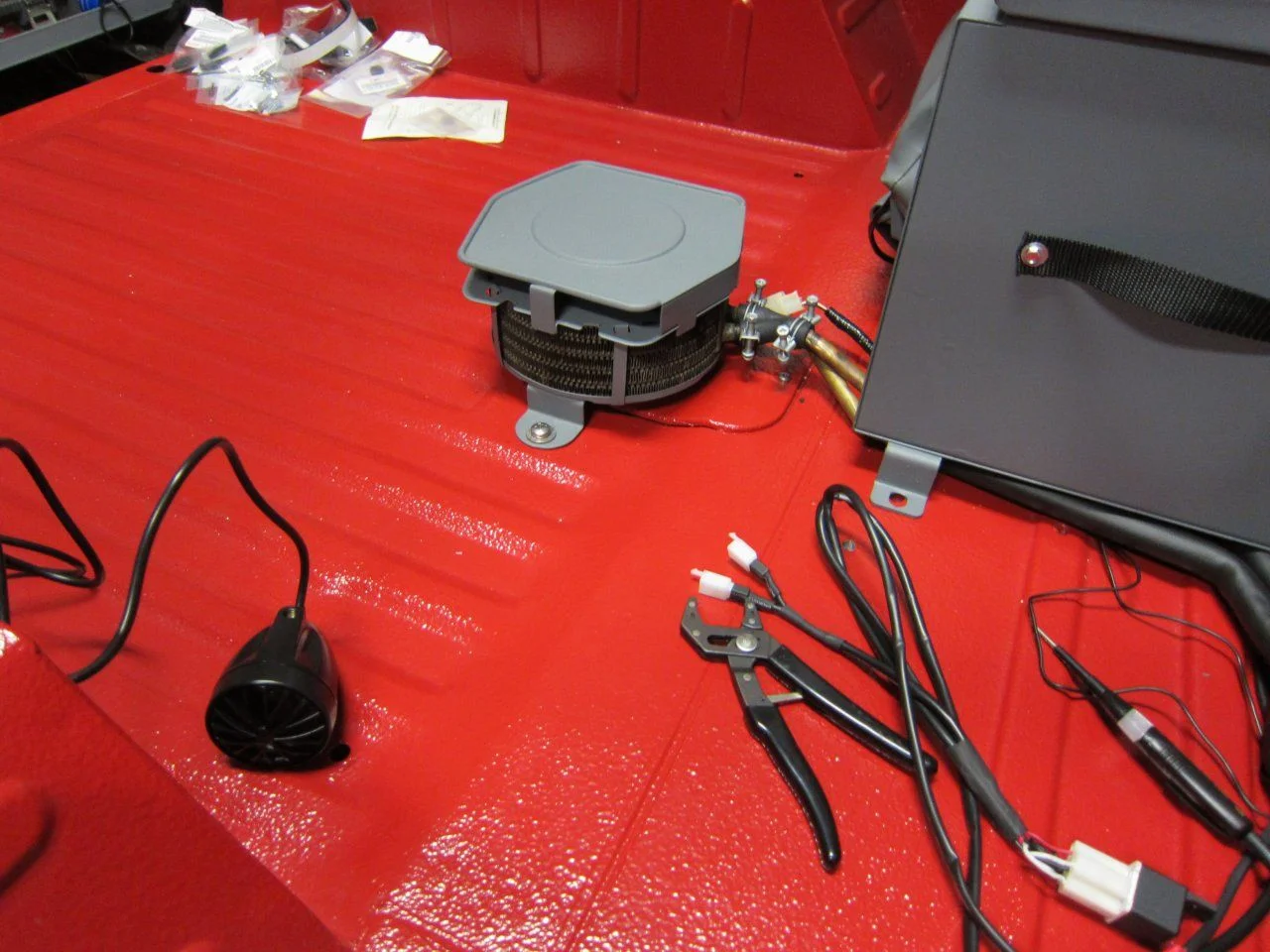

no pics, the heater is in the middle, between the seats but behind the seats. It would be directly behind the plastic center console.

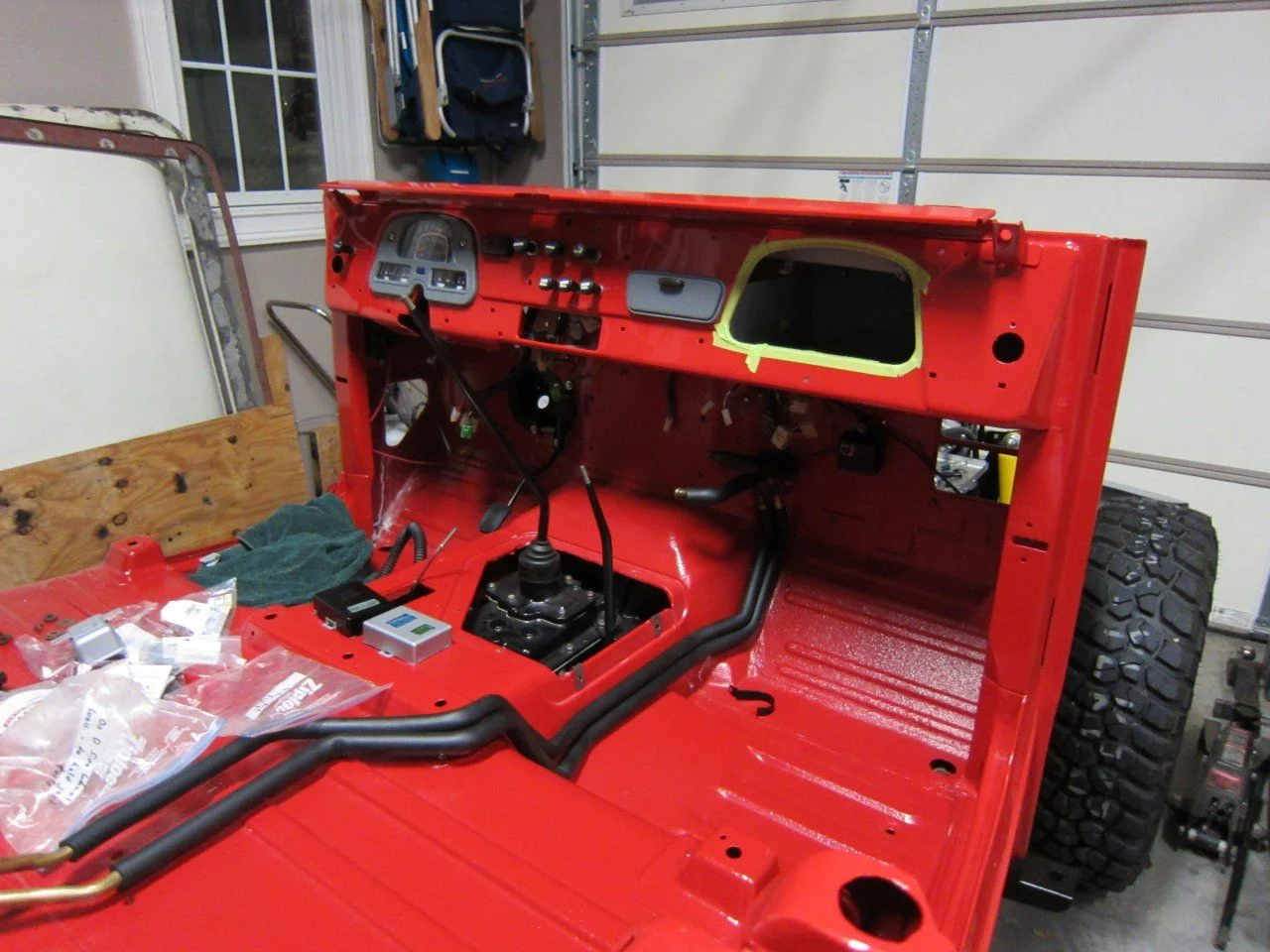

the hard lines run along the hump just above the floor then bend up just to the left of the passenger seat and go back to the heater.
here is the heater location.
img_3496-jpg.1309311
Heater & lines

And lines along tranny hump
