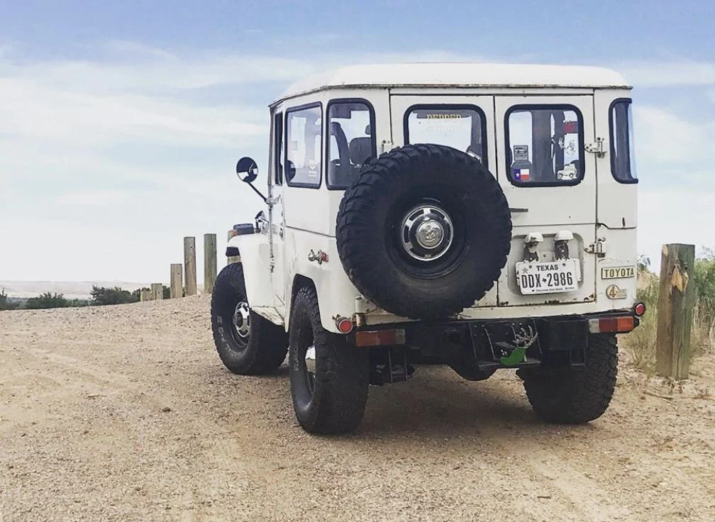

@rkymtnflyfisher did you have any trouble getting a shop to balance 33x10.50 on stock rims?
As a whole, no. One tire did take a lot of weight to balance it out so naturally that one became the spare.
Regarding the 33x10.5 tires on the stock steelies : I've gathered the common, BFG AT's do not or can not work, which is likely the case for most of the other tires, from the other companies, that same size. To combat this, some here have had the 5.5" stock steelies widened, via having them cut in half & a steel ringed spacer welded in - and the wheel welded back together.
Conversely, many here, including @rkymtnflyfisher, have found the BFG MT do work (albeit often with some effort, as @rkymtnflyfisher wrote above). Fact is, the natural width of the stock steelie is right at the absolute limit of being able to accommodate the tall, 10.5 tire.

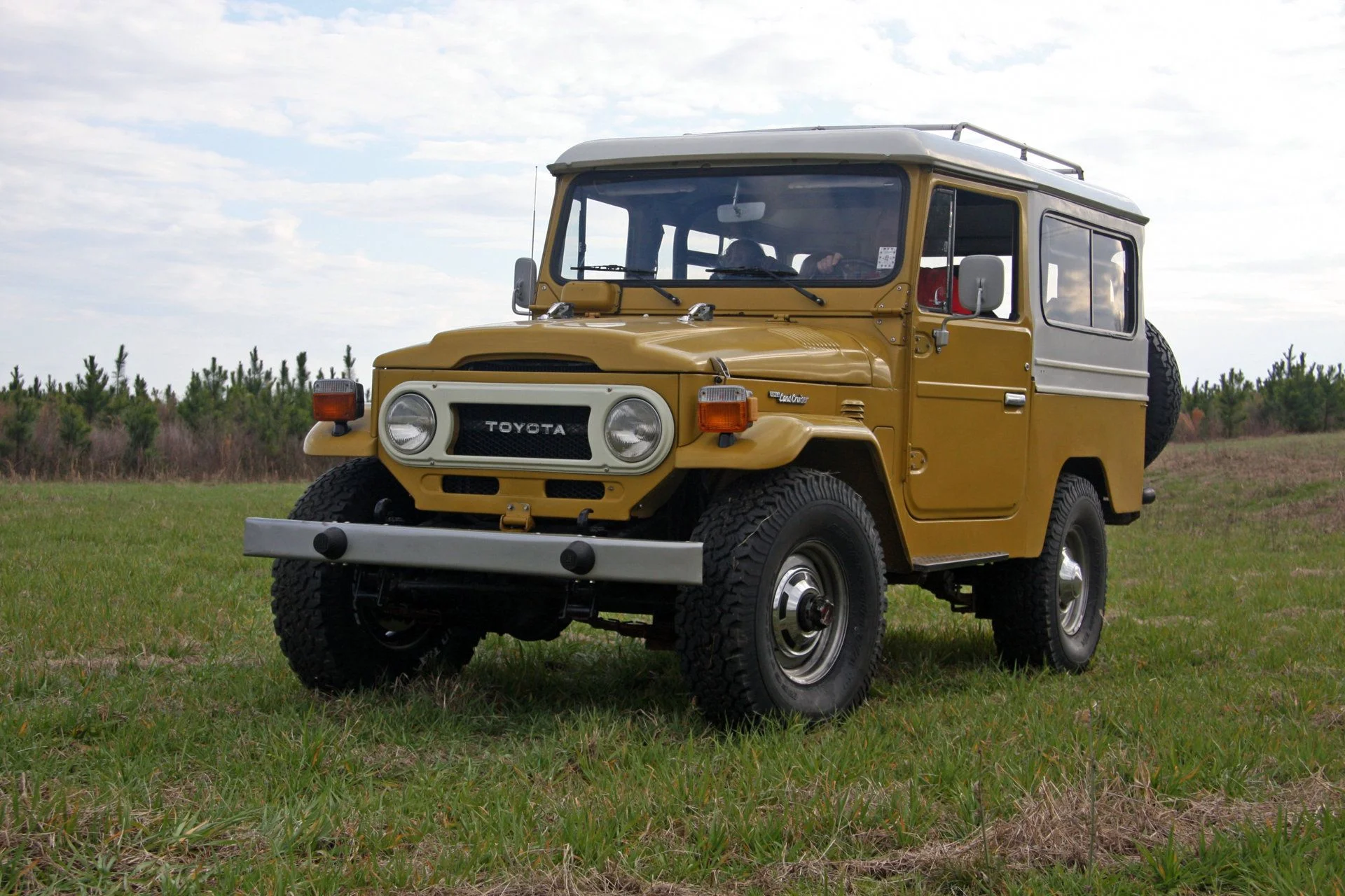

1979/80 was right at the end of Toyota using the stock steelies. And prior to the 1981 using the OEM white wagon wheel ones, I'm fairly sure most of the 79/80's used the aftermarket wagon wheels. Similar in style to the American Racing wheel one, able to be easily & inexpensively purchased today. They're not the exact same, but massively similar.
At least, that's what mine came with. And is what most of the original condition 79 & 80's I've seen have been sporting (not the gray steelies, nor the late model white OEM wagon wheel - but a simple, steel wagon wheel in off-white).

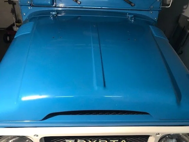

I have done a poor job of documenting my past projects, so for this impulse buy, I have decided to document as much as possible. This is my first 40 series project, it is apparent I will need to enlist the help of the MUD community. I have wanted my own FJ40 since i was a little kid. I found this FJ40 less than 5 miles from my house. I was BJANDCJ in a past life.
The lady in questions:
- 2/1979 FJ40 California spec.
- Sky Blue
- Dealer option Clardy A/C
The Legend:
Sold new in California, stayed until it was sold out of San Diego in 2009. From 2009 until 9/5/2019 is has been garage kept (car port last year) and driven 7,000 miles in the last 10 year. From the service record I have, it looks like it has been loved and fairly well maintained for the last 20 years
Current State:
The good:
- service records from 2000 thru 2019
- 2.5'' HFS CCOT lift. (no experience)
- SOR vinyl seats and cushions have been replaced.
- new OEM badges (originals saved)
- factory Toyota vinyl carpet (torn at driver right heel)
- most EVERYTHING works as it should
- very complete and original/ period correct
- good compression
- passed California smog in 2009 ( less than 8k miles ago)
* The transmission and t-case were rebuild in 2007 among other things. The work was done by Burbank Union Aurocare Center. * Anybody have any info on this outfit? (around 10k miles ago)
The Bad:
-The exterior was repainted the original Sky Blue before it was sold in 2009. Patina lost forever
