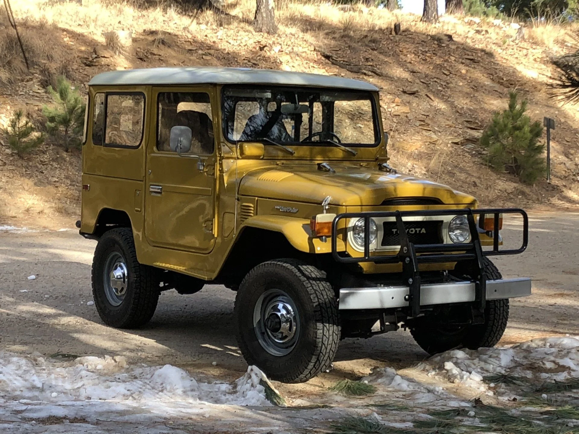

I have 31s on now but had 33x10.5 BFG A/Ts for 10 years with no issue. Mom and pop place mounted them.
Here is a pic with 31s. I actually prefer them but I don’t do any serious off road driving. Yokohama A/Ts.
@Mean One Why did you choose to go with 31''? Is there any practical advantage to having a smaller tire? Easier turning? I will mostly be using my truck to cruise around the farm, go on date nights with the wife.
Well, no real big reasons. I wanted to lower the truck a bit for a future roof rack (garage fit) and for the wife though she hates the machine and rarely gets in it. Also, I like the look slightly better than 33s. I have 31s on my T100 that perform very well off road so I wasn’t worried about giving up too much capability.

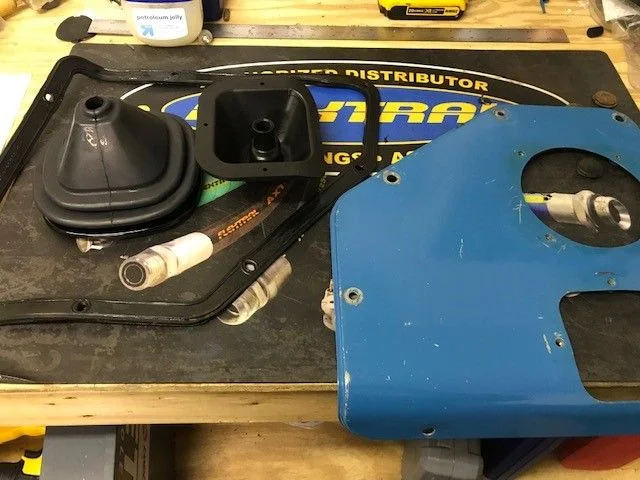

Not too much to report. I am waiting on a bouquet of various parts to arrive. This is my first sizable OEM parts order in the post @Onur era. I ended up spreading the love around between a few trusted MUD approved venders.

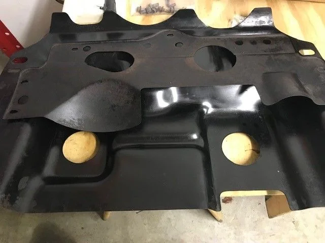

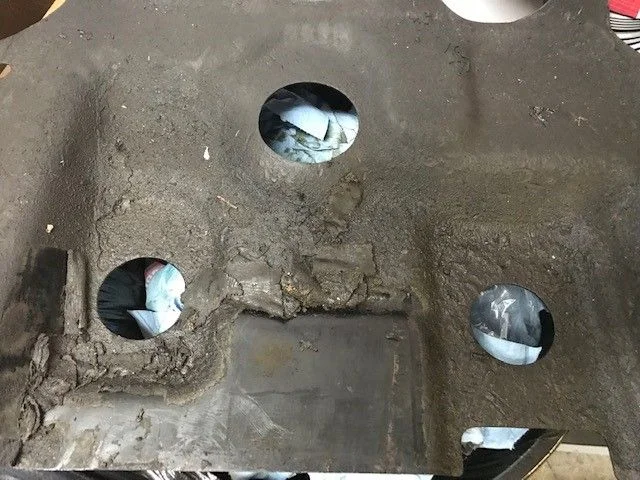

A little weight savings from cleaning the skid plate. This is when I would normally walk everything down to the powder shop, but I will stay to course and preserve not re-powder.

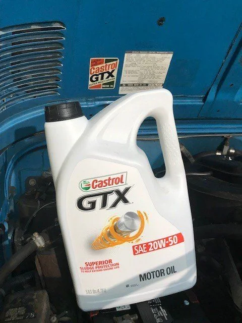

Vintage Castrol sticker under the hood, so i figured why change.

Skid Plates cleaned up nicely:

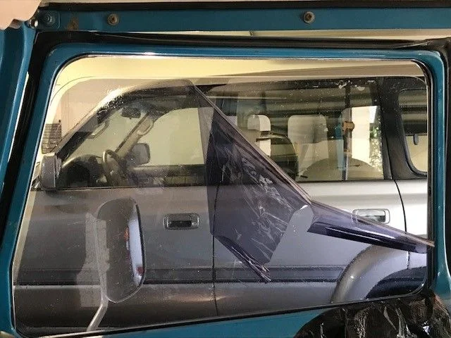

I was able to pull the hard top off without any problems. I have been soaking all of the rubber seals in petroleum jelly, with good results so far.

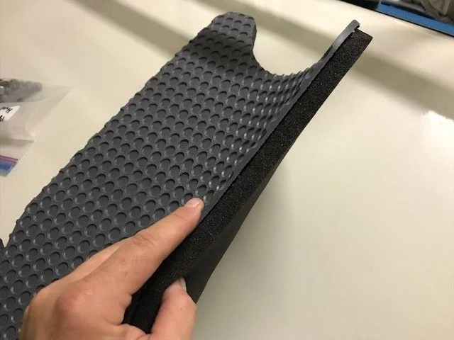

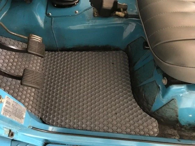

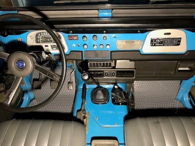

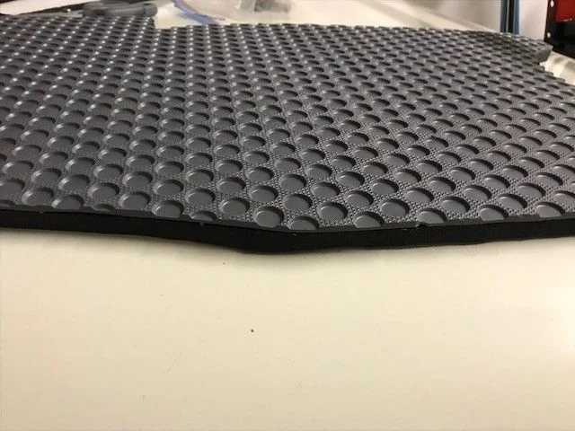

I removed the OEM rubber floor liners initially so I could clean and inspect the floor plan. But, I have decided to keep the floor liners out for the time being and just use regular floor mats with a 3/4'' Dynapad glued to the bottom for heat protection. It came out pretty well.
