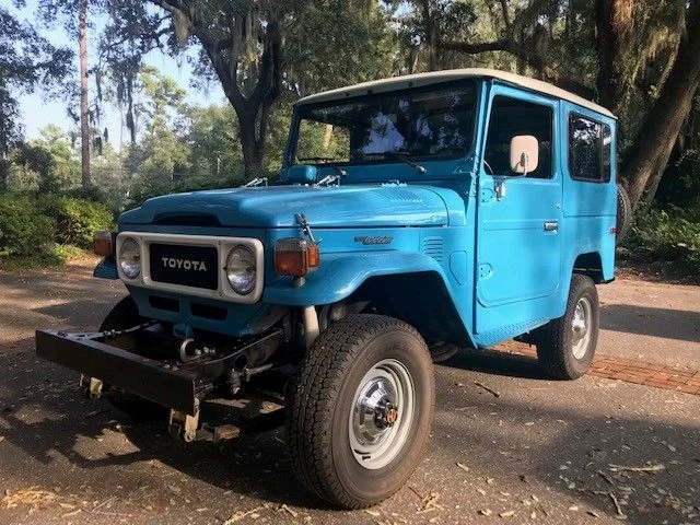

I have done a poor job of documenting my past projects, so for this impulse buy, I have decided to document as much as possible. This is my first 40 series project, it is apparent I will need to enlist the help of the MUD community. I have wanted my own FJ40 since i was a little kid. I found this FJ40 less than 5 miles from my house. I was BJANDCJ in a past life.
The lady in questions:
- 2/1979 FJ40 California spec.
- Sky Blue
- Dealer option Clardy A/C
The Legend:
Sold new in California, stayed until it was sold out of San Diego in 2009. From 2009 until 9/5/2019 is has been garage kept (car port last year) and driven 7,000 miles in the last 10 year. From the service record I have, it looks like it has been loved and fairly well maintained for the last 20 years

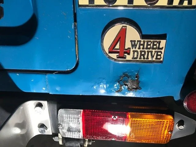

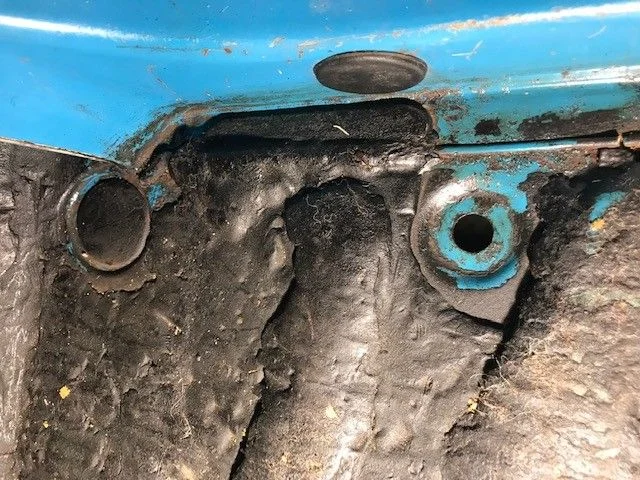

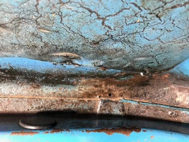

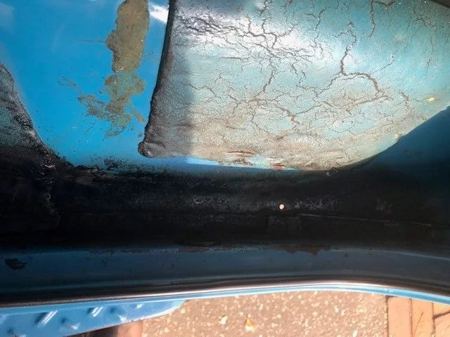

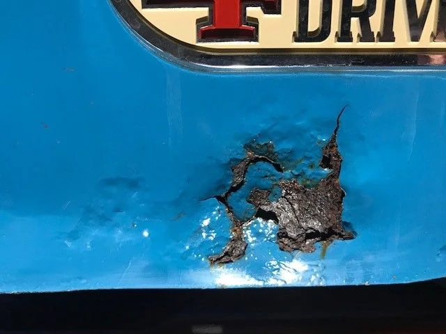

- There is rust on the rear quarter panels that has busted thru, zero signs of any previous rust repair or bondo.
- the clutch master cylinder leaking

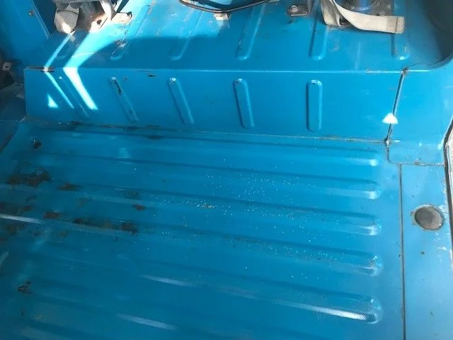

- surface rust around the drain holes on the floor boards.
-surface rust on the inside of the hood where a heat shield had been stuck.

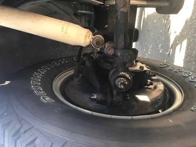

- steering box leak

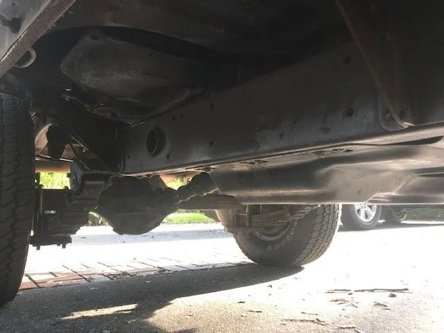

-hot pressure wash the exterior and undercarriage (complete)

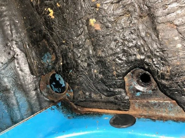

- sprayed rust converter on the rust spot on the undercarriage. (complete)

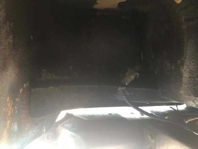

- spray fluid film in the body cavities to prevent rust from eating her from the inside out.

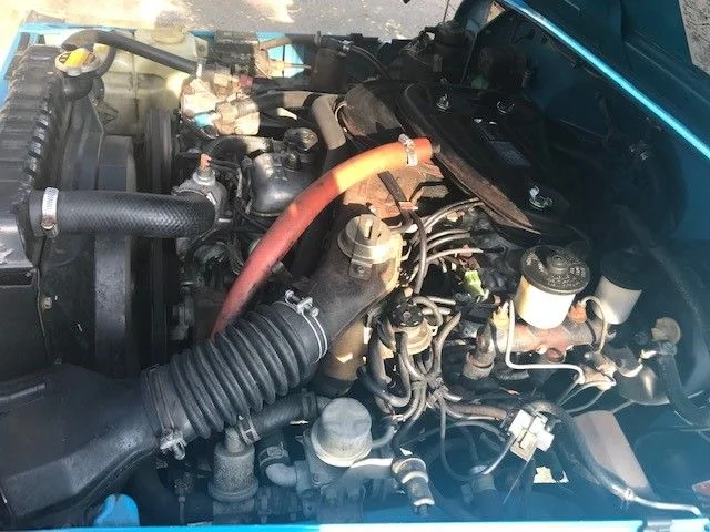

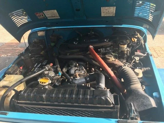

- California smog equipment looks like it will be hard to find parts for. I have been looking for the pump hoses? Please....
- Clardy A/C hose are leaking so i think i will replace with modern crimped hose or just shelf the whole ac unit or Vintage Air

I am going to start with the right rear quarter first. I basically spent all of sunday scrubbing the bottom of the cruiser with CLR and a scotch brite pad, and i am pretty confident there has never been any previous rust repair.
-Who makes the best rear quarter patch panel?
- Any special techniques or prep work I should consider?

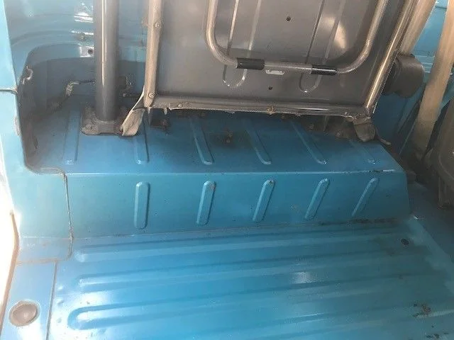

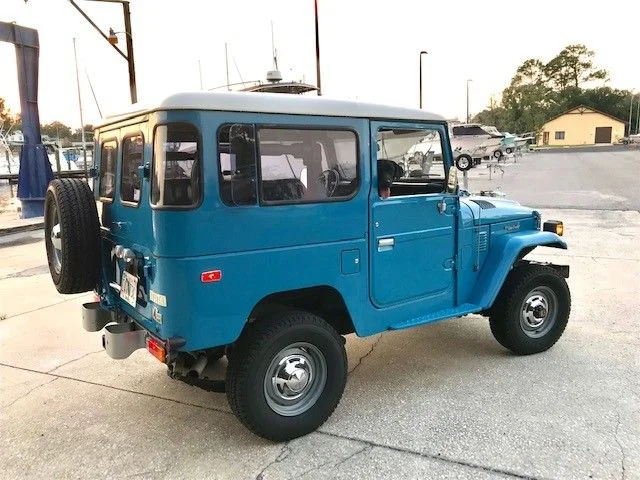

Pictures:
Nice 79! Not much needed on this 40.
I’ve been reading up on the Patina thread about slathering Fluid Film over original undercarriage and just running as is. Something I did not do with my ‘81 regretfully.
My OCD would want to attack the rear sill and quarter panels, but i would leave it at that.
Great looking rig... too bad about the repaint. I'd stop the rust but not go deep into cut-and-weld repair. She's already in great shape.
