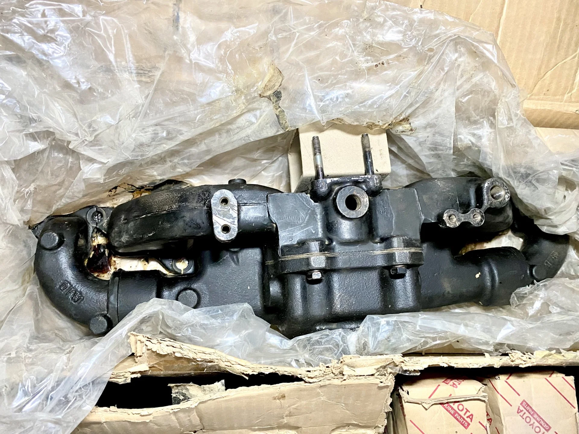

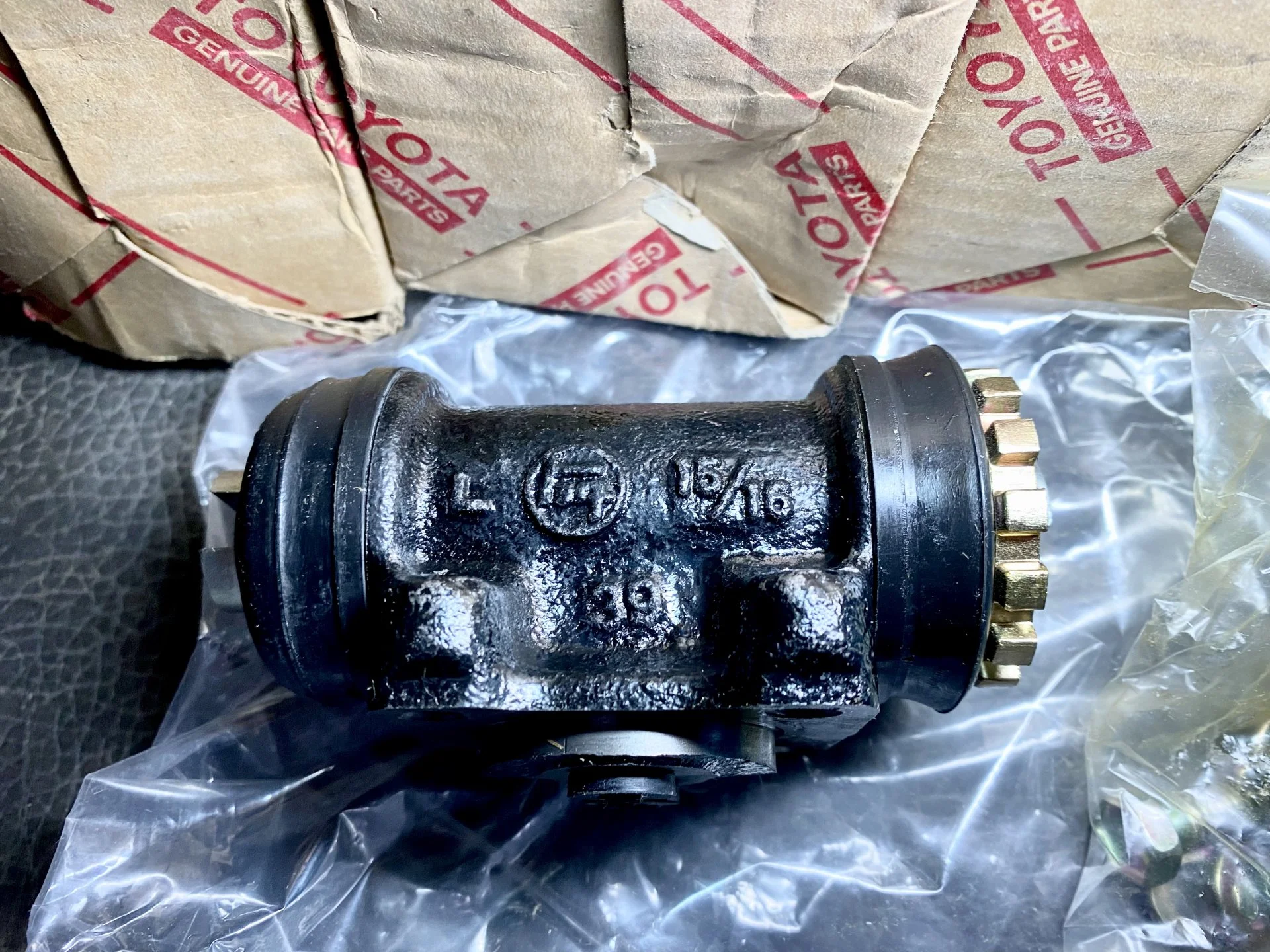

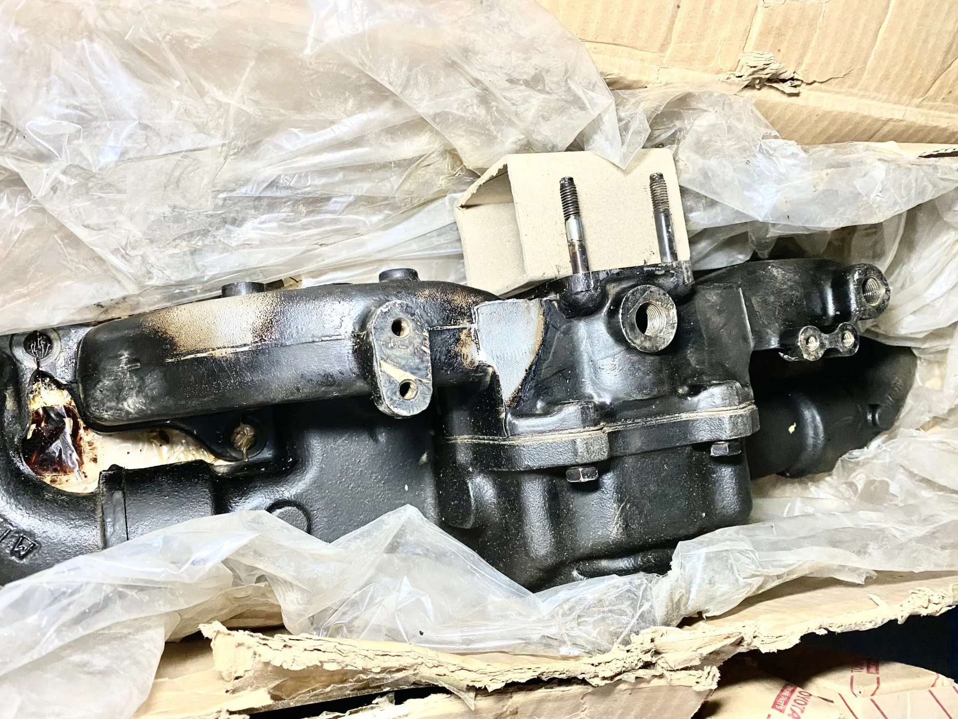

It’s not everyday you get a package from Yemen. @Onur

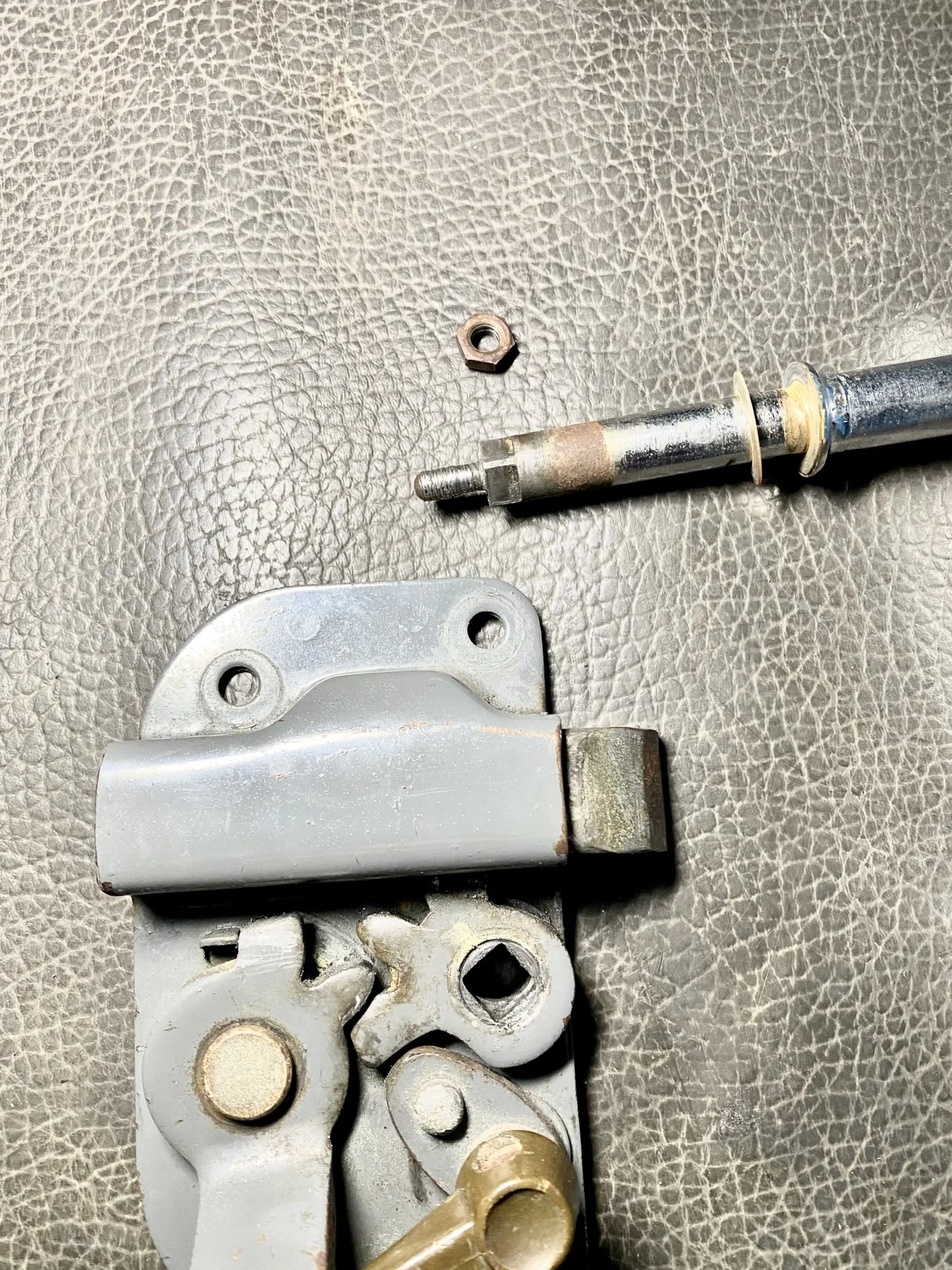

I sourced a new rear door lock to replace the rattling original. New used rear door handle to replace the stripped one.
Now I am the hunt for rattles. The Jump seats seem to be my main culprit. .
With your machining skills, you’d be the perfect guy to develop an Allen head shoulder bolt, flush-mounted on the back side to replace that handle pivot stud. That stud gets loose over time and leads to the incessant rattle. An adjustable solution to that would save lots of these from the scrap bin, and we’d all be indebted to you for it. Your manifold butterfly valve plugs are a work of art.

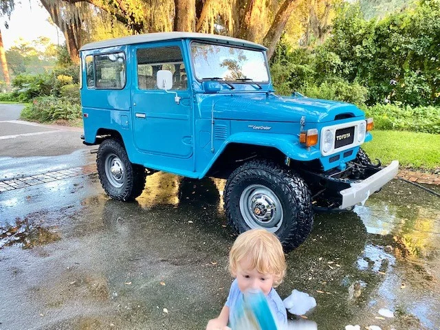

Washed the road off of her last night, time for a little wax and fluid film.

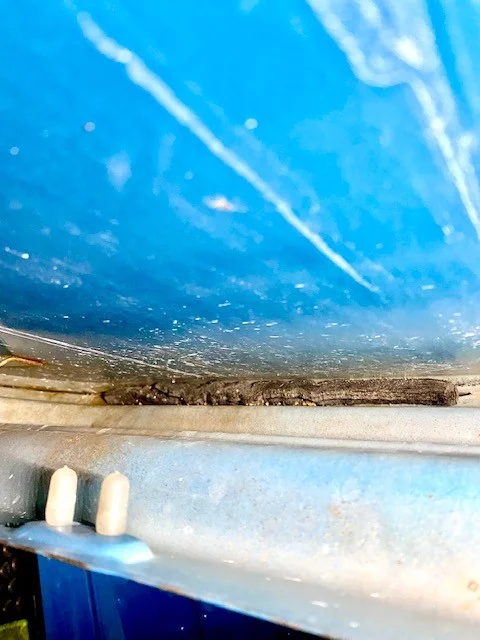

Last night I pulled the plastic door cards off and peaked inside. The rear lower door felts had been pushed down and out of the door track. They were both laying in the bottom of the door.
Felt laying in bottom of door:
Cleaned out door cavity:

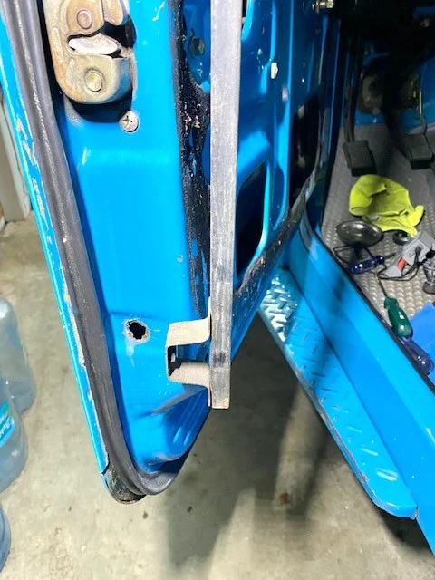

Drivers door, rear lower felt channel, is squeaking obnoxiously against the upper felt channel. The hole in the door the secures the lower channel is thin and broken out. I am assuming this is root cause of my drivers door glass rattle.
I have not decided if it will be best to TIG weld filler rod or weld in a patch panel from a donor door (stalled half door project)
