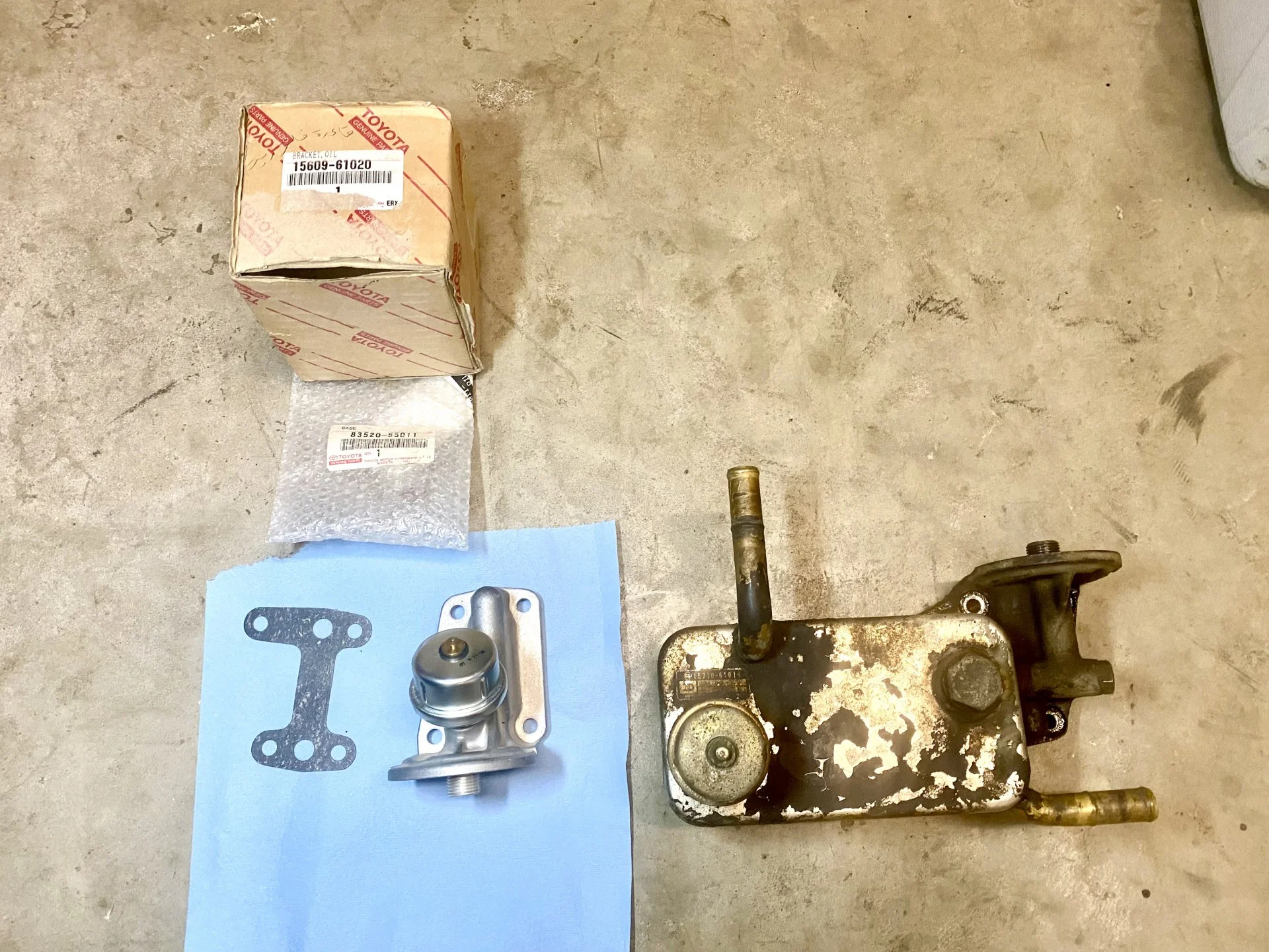

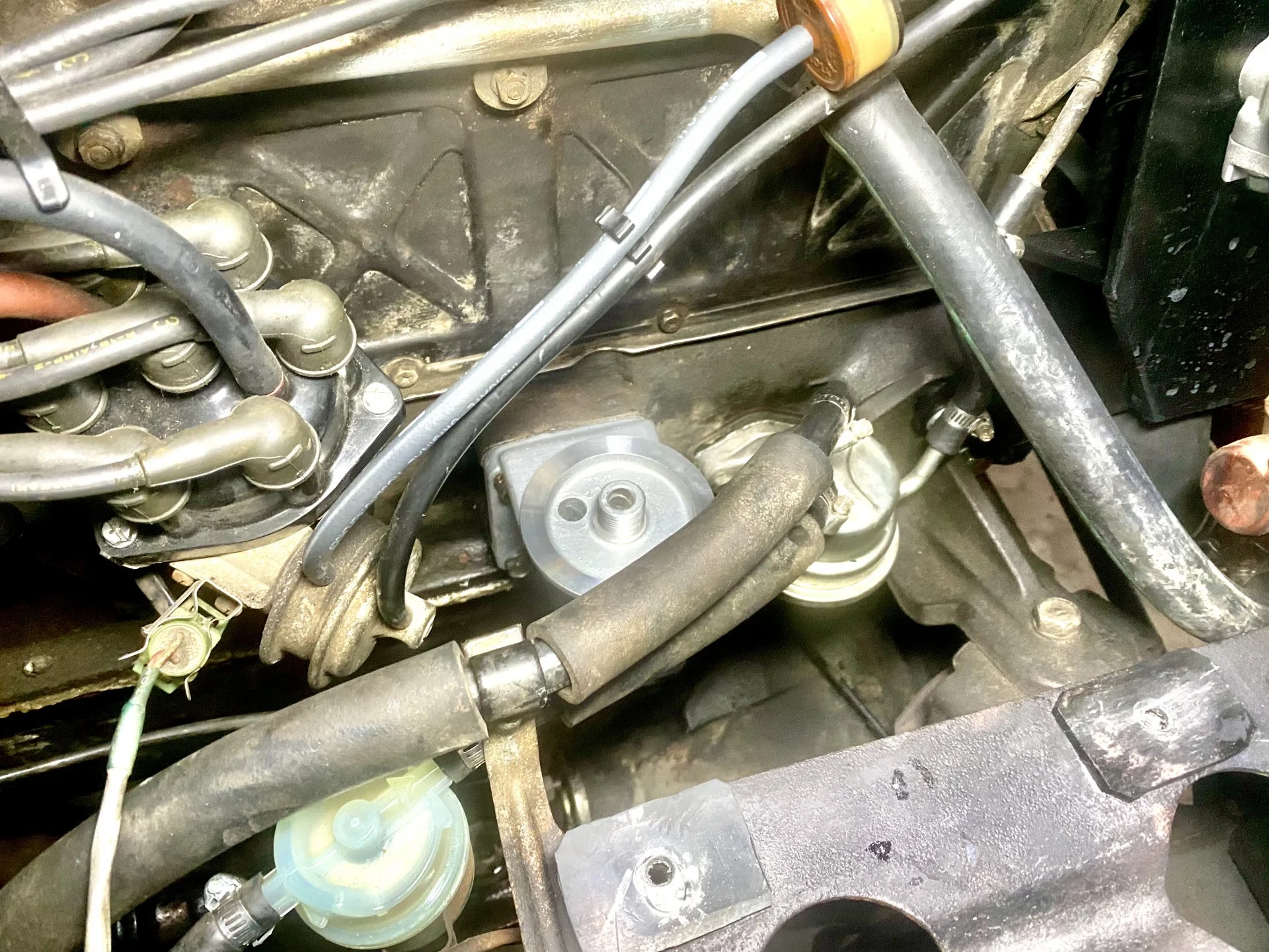

The main reason I eliminated the oil cooler was because my York a/c compressor bracket makes accessing the oil cooler hose impossible, without removing the a/c compressor, alternator and bracket, and that require removing the radiator, radiator shroud and fan clutch.
@wngrog said I could.
The main benefit is that I can more easily access the fuel filter and adjust timing.
