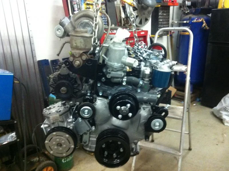

Just a little update

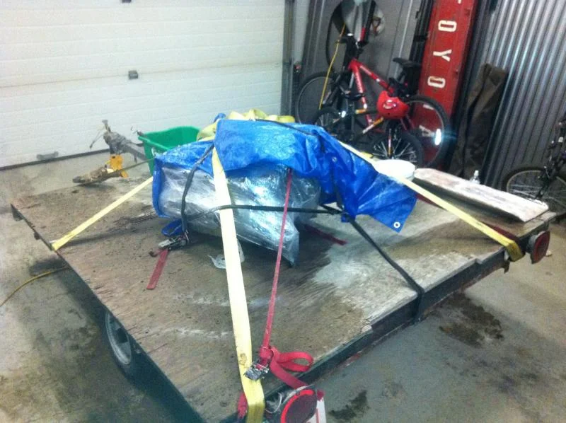

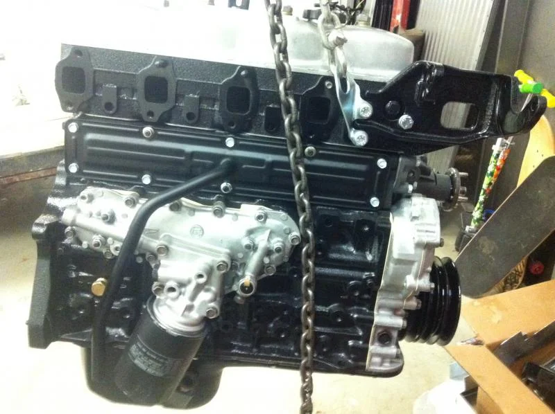

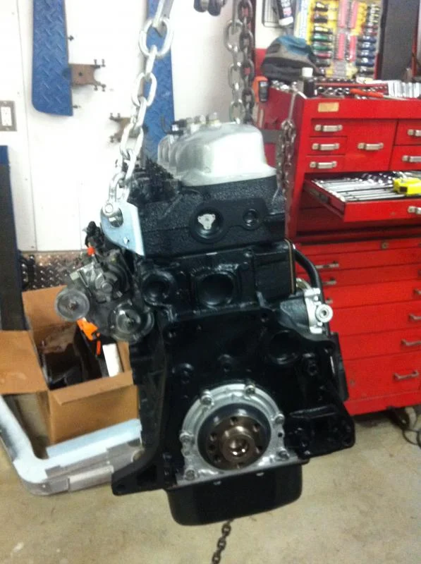

Brought home my 3B a month ago after a rebuild. New head and cam, valves, lifters, oil pump gears water pump, rebuilt IP etc, etc
so I wrapped it up and set it aside as I worked on the bed build project....

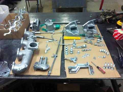

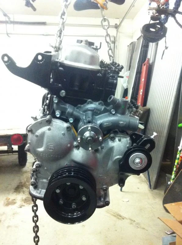

That lasted a couple weeks until I had some cruiserheads over one night and I had to unwrap it to show it off. Next day I could not resist and had to start prepping bits and pieces. I sourced a new to me set of injector lines from a BJ60 at pick n pull, then had them and all other steel bits re-plated. I bead blasted and clear coated all the aluminum parts with a good acrylic clear (dupont A-7480S).

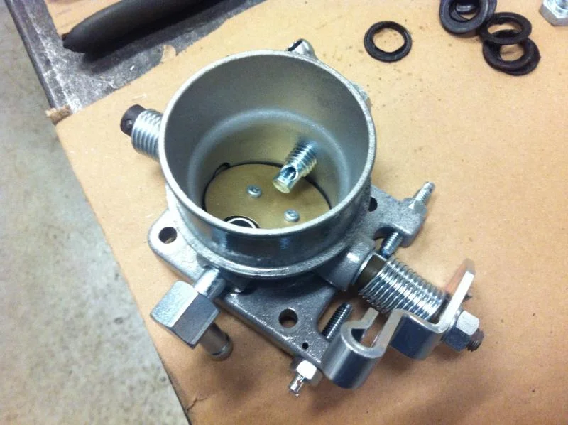

Re-assembled throttle body - I was surprised how nice it turned out.
Cleaned up and painted the EDIC
Glow parts all accounted for

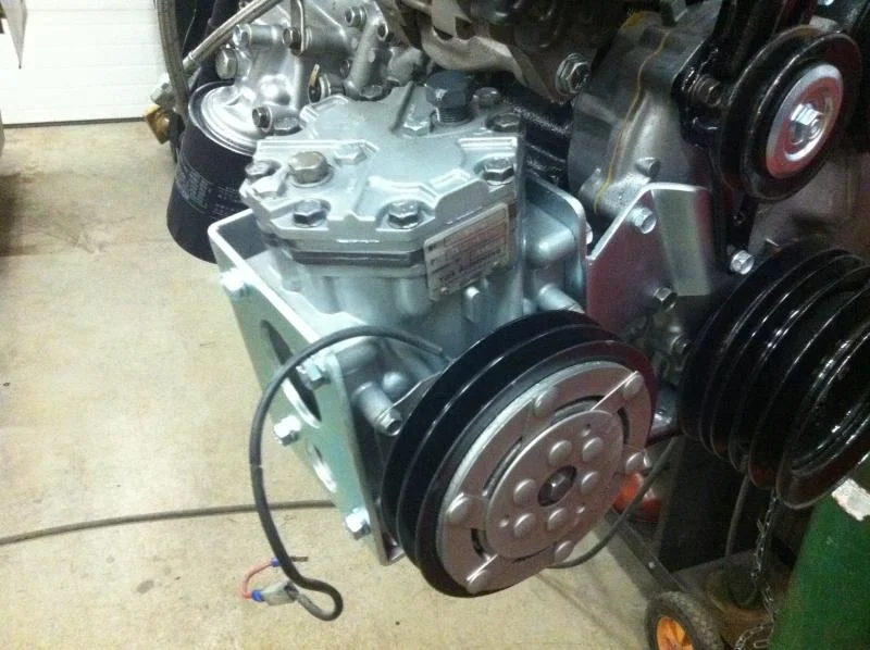

Mounted the York - I removed the top plate and tapped the suction and discharge with 3/8 and 1/4 NPT respectively - plugged for now.

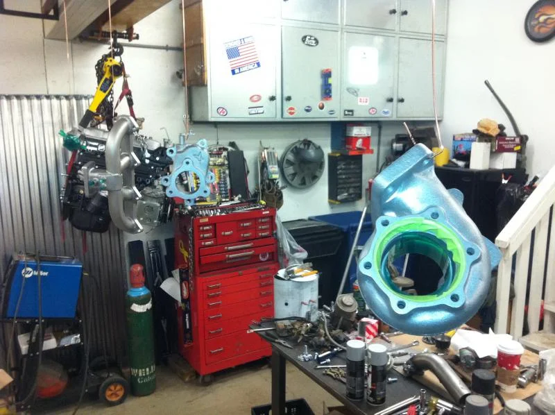

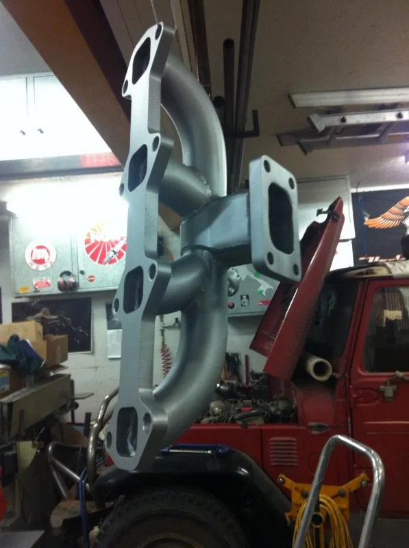

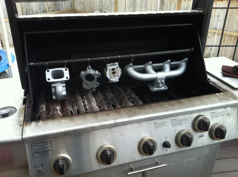

Decided I did not want a rusty exhaust header and hot side of the turbo so I stripped the turbo.
I am looking more for corrosion protection than for heat management so rather than pay $300+ for ceramic coating I found a rattle can product that will do the trick.
The directions on the can are more or less as follows:
get all the paint on in 1 hour - 10 mins between coats - this stuff is thin so light coats are best
let dry fully - I went overnight
Then you have to cure it through baking.
30 mins at 250F - 30 mins cooling
30 mins at 400F - 30 mins cooling
30 mins at 600F
My take on this paint so far - pretty tough stuff - during re-assembly of the turbo the wrench-on-paint test was impressive.

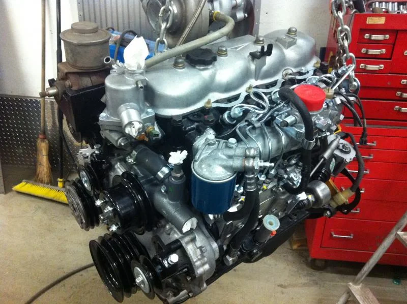

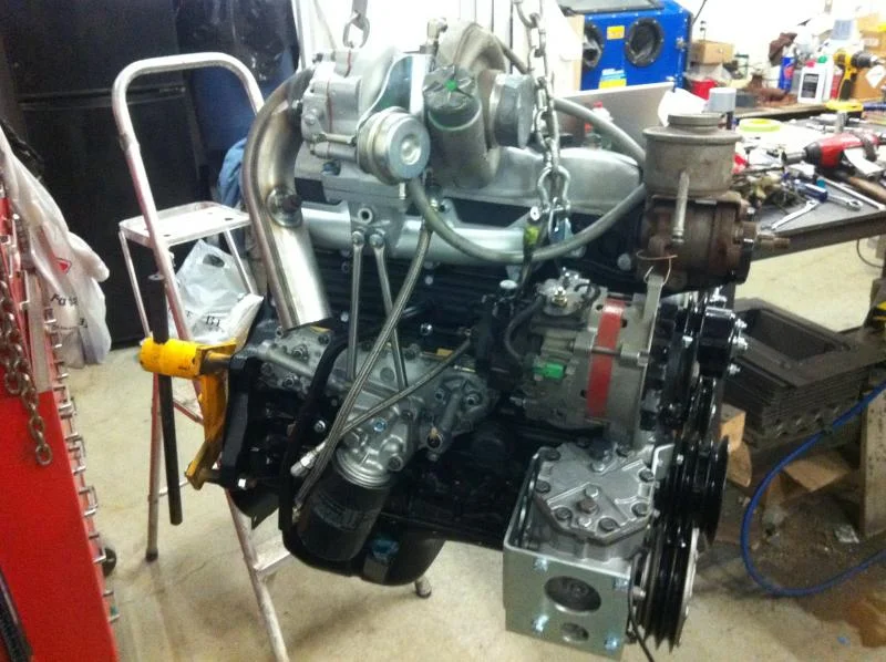

Just the alternator and the power steering pump yet to tidy up. Lines for the turbo too.
