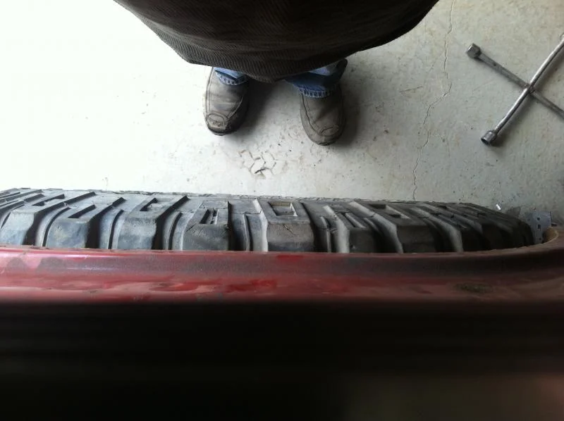

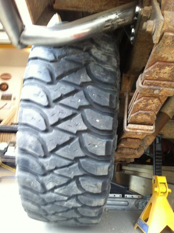

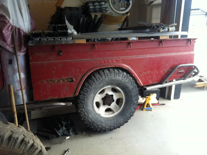

Anyway... here are some pics with a borrowed tire - 315/75R16
This is with the axle on a jackstand and a scissor jack pushing the worn out stock spring down a few inches. I have no idea where my new springs will put the wheel but hopefully about here.
This is with the axle on a jackstand and about 800 pounds in the bed - stock old spring. In this positin there is about 3" before the bump stop hits so in theory it could flex up another 3".
This is the same orientation as the above pic but showing the tire protruding. This is a 4.5" backspace wheel so a 2.5" would stick out another 2".
a few more pics - same conditions as above

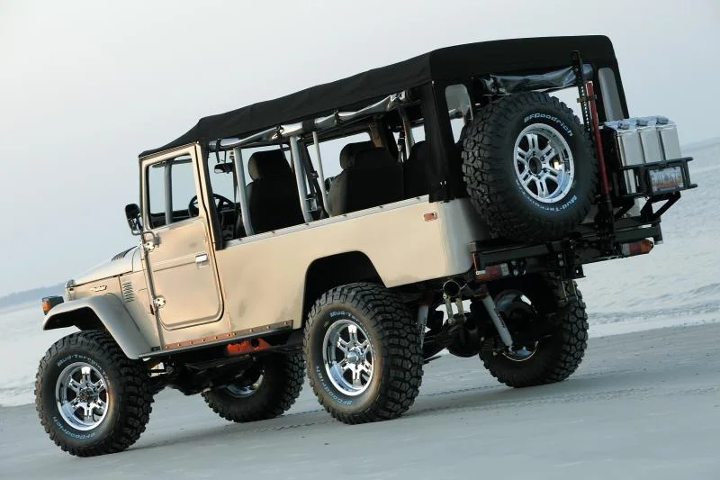

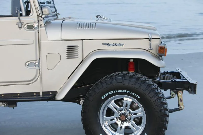

Some justification:
This lovely unit is running the same springs and tires, albeit 18" wheels. I think the shackles don't look extreme.

Hi Kevin,
You think these shackles DON'T look extreme?! Wow, what do you think would look extreme: 8"? 9"? 12"? What about a 2' shackle?
I love this troopy and it is truly amazing, but i have always been amazed that such a detailed resto used such rediculous shackles. I can't imagine you doing such a thing.
Josh

Hey Josh! Long time. I freely admit to an under-abundance of knowledge about shackles. My limited research tells me that compared to stock a lifted spring is shorter from eye to eye which requires a longer shackle to keep the shackle from inverting. Unless the spring manufacturer makes the main leaf longer. I'd have to go and check but I'm sure my new shackles are an inch or two longer than stock. The shackles pictured on Mark's rig look to my eye to be just a couple of inches longer than my aftermarket units.
I am obviously reaching for a way to use my 2.5" OME springs and 35" tires. Am I blinding myself to the truth?
Ok - just checked my factory and OME shackles. Both exactly the same. Front is 2.75" pin to pin and the rear is 3.5". Therefore the main leaf must be longer on the OME in order to get any lift.
My expert eye estimates the fromt shackle pictured on Mark's unit above to be maybe 6". So roughly 3.25" longer.
Further research (read Boolean search) tells me that to get 1" of lift you would need a shackle roughly two inches longer all else being equal.
