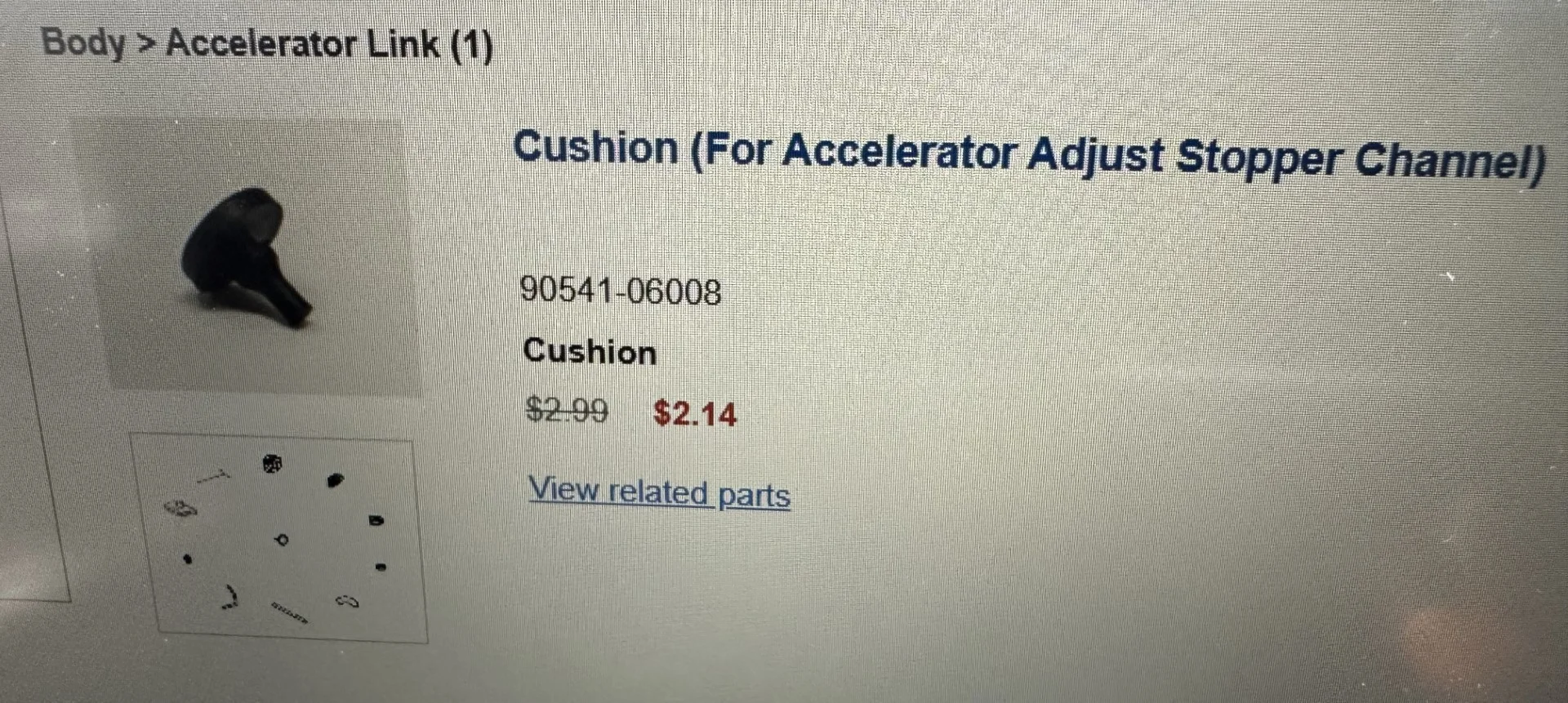

Is there a different cushion than this for the fuel door retainer catch for a 1978 FJ40?
I used part number 90541-03078, it fits in the smaller hole and worked great.
I think it is for a center console cushion for a door/lid.
The first one listed in the original post is one that will work on earlier ones, also the accelerator cushion, and the Brake and clutch pedal cuahion.

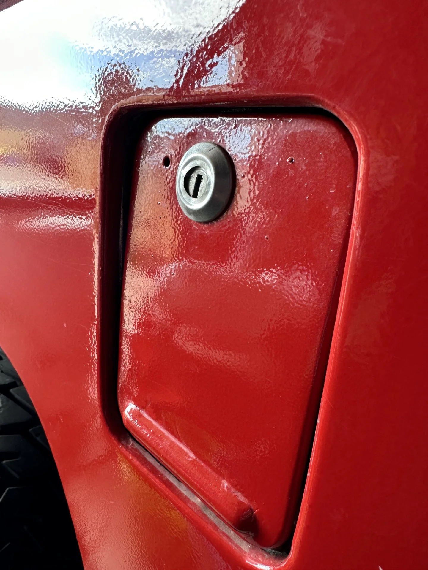

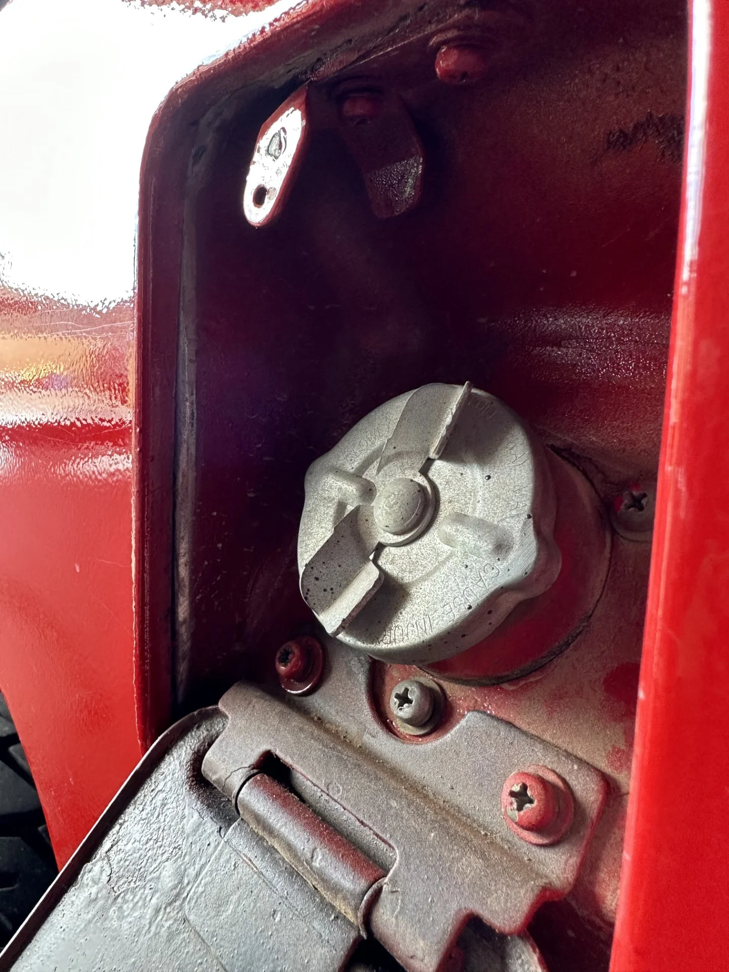

View attachment 3387423View attachment 3387420View attachment 3387421
What happen to your 69058- lock cylinder there ?
It looks as if the next door neighbors teenager used his Red Ryder and
substituted the copper BB for a Titanium one ?
Aka : armor piercing round ….

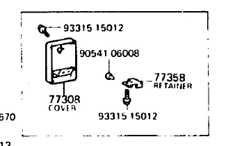

You do know that a OEM parts solution now exists for that flipper-down style set up 9/73 - 12/78 Right ?
Heck even includes a sparky new OEM Cushion and all the oem
updated mounting hardware for your strike , flipper-down fuel door hinge too , I think if you needed it ?
The 3 filler neck ones too
