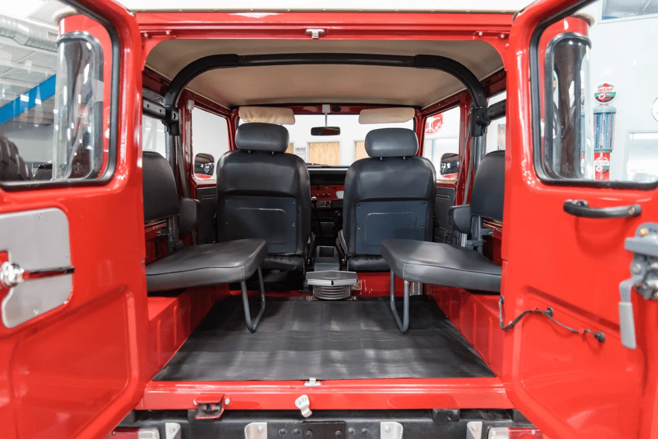

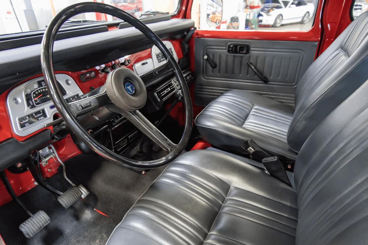

At the risk of being a PITA, wondering if you guys would take a look at this 78' and provide some thoughts about what looks good and what doesn't. I know these trucks decently well, but not in the way that many of you know them. This group spins circles around me on what's original, what's not, what to look out for, what to ask about, etc.

For anyone that takes a couple minutes to look at the pictures and give some thoughts, many thanks and a hat tip to you!!

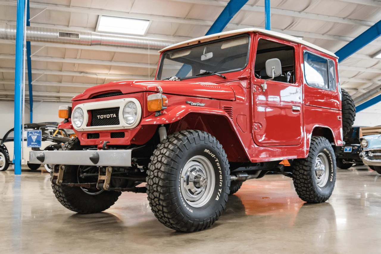

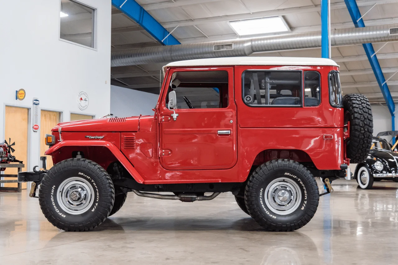

Here are a handful of the images from the dealer's page...many more are on their website posted above:
1953446
1953449
1953451
1953453
1953454
It appears to be a nice restoration.The black bumper stops I don’t believe we’re on the domestic bumpers. The A/C and PS have been added. Everything else looks good even if it isn’t original like the floor mats etc Make sure it’s emission compliant for your state. Anything that isn’t stock I believe was done in good taste- suspension, tires etc..Just saying from a quick look at the pictures on their website.

It looks nice but some things seem off for as much money has been put into it. The new tub looks good. But a few rusty bolts like the hood hardware, repainted emblems instead of new and maybe a paint bubbling from rust on bibb make me question what corners were cut. Also some things like ubolts already rusting through paint cover up.
If spending so much money why not spend alittle more to do all the way, it’s crazy to see big budget rebuilds and they cheap out on the pennie stuff.

I'm still learning about these but from what I've gathered there are a few things off. It looks like a US model with the front and rear heater and side dash heater vents but it has bumper nipples which is a big red flag, at least to me. The body looks clean and I don't see any red flags there, like I said I'm still learning and will wait to see what others think .
There is a sticker behind the drivers side door that looks faded, I can't read it but it does look out of place.

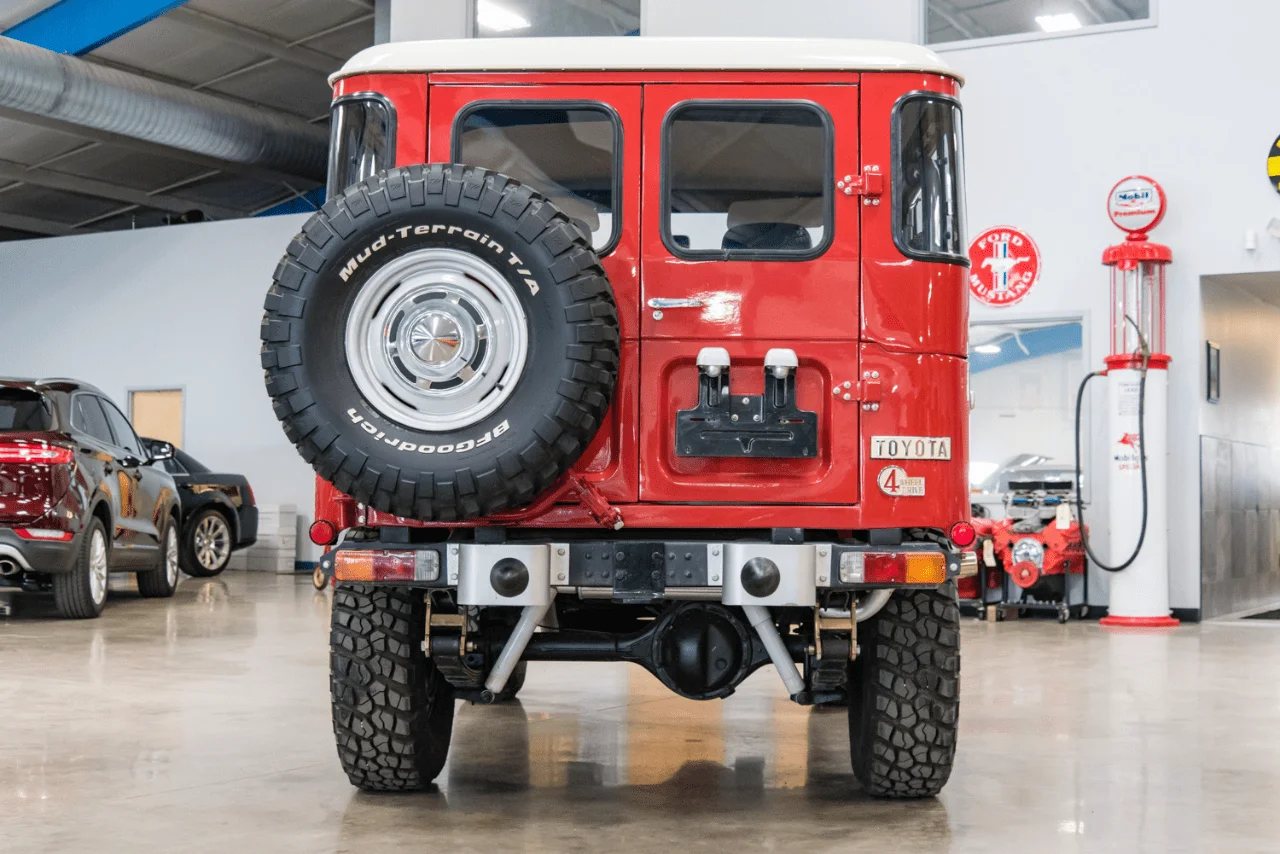

They did a nice job painting the u-bolts.
And what the heck are the bolts/threaded rod coming out of the rear u-bolt plates. The plates are rusty by the way.
I don't usually comment on other people's rigs for sale, but there are plenty of red flags here.
Can anyone confirm that the skid plate is in stock condition? My '78 FJ45 does not have a section cut out for the cat???/resonator???. Mine is a CDN market cruiser though. Not so much emissions junk as the US market.

The long shackles and body lift makes me queasy... :)

The black bumper cones are just an add on, they are a separate part. That’s what the holes are for on both front and rear OEM bumpers. Front bumper & rear bumperettes are OEM stock here.
I’d say the 78 would pull in the $35-$40,000 Price range on no reserve. Overall it is a nice restoration. Problem is it’s in the hands of a dealer, and they’re always high. I wouldn’t pay more than 40k myself. But I would have to see it in person as well.
