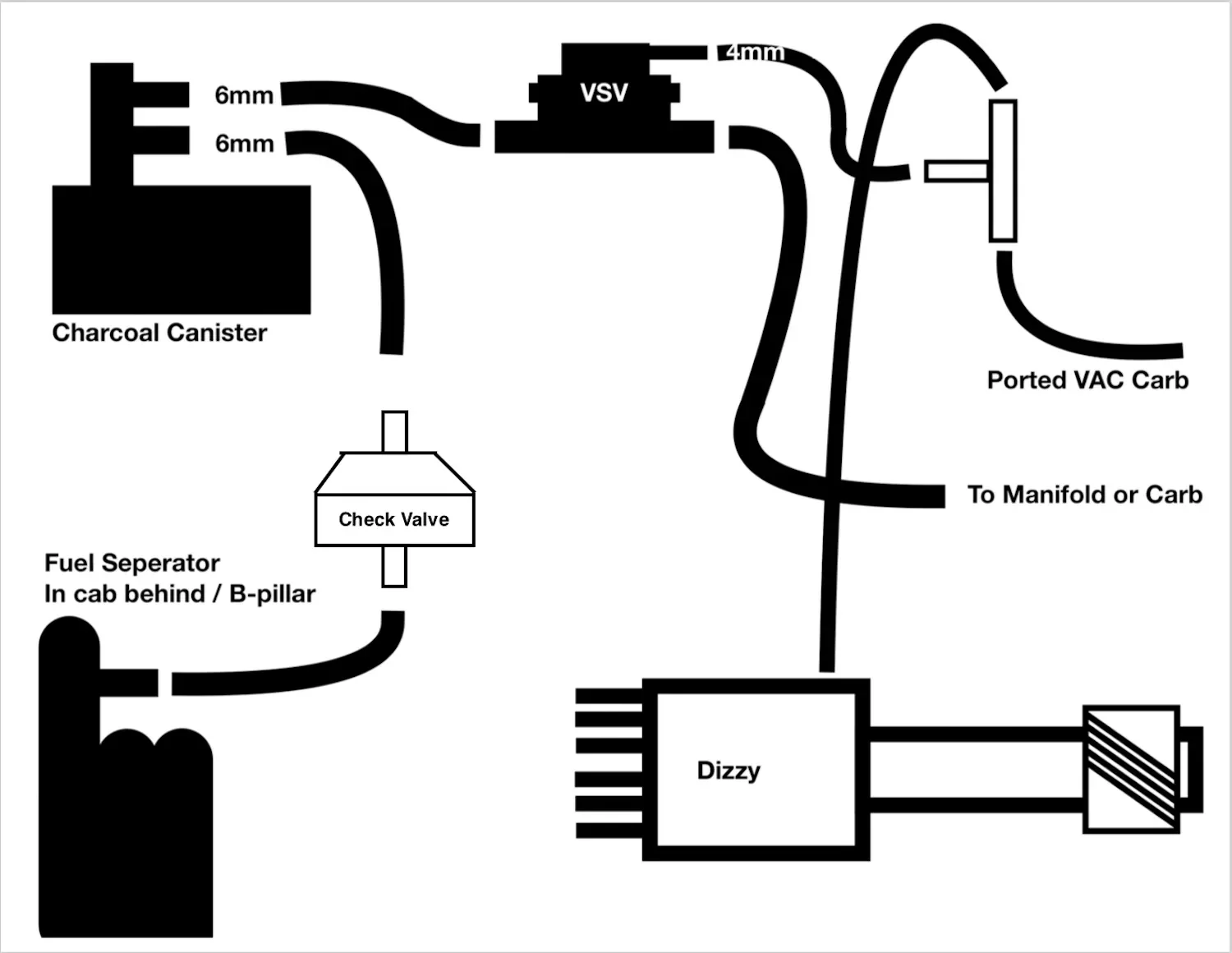

The redline cruisers diagram for vacuum hose connections works just fine if you want to keep a charcoal canister. My truck was de-smogged entirely (including the charcoal canister), and I purchased the redline kit so I could stop stinking up the place with gas fumes. I know some people love the smell of gas in the morning but for me its the difference between my wife and kids riding with me or not.
That said, to answer your Q you don't need the PCV valve. Here's the redline hose layout that you should be able to use (its pretty universal):
The main takeaway here is they use they small vacuum port off the base of the carb to activate the VSV (should be included with the kit), which opens the large vacuum port between your intake manifold and the charcoal canister. If you don't have a vacuum-advance dizzy, congrats, use that 6mm hose straight to the included VSV. If you do, use the included 6mm Tee as shown in the pic.

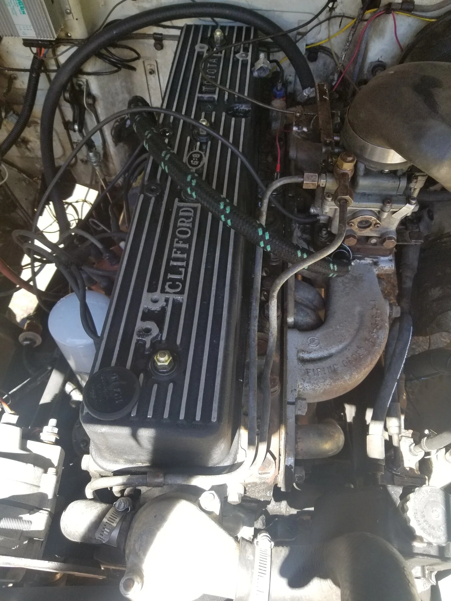

When I de-smoged mine I took all of that out for the Rochester carb and header. I forgot about the vent for the tank until I just replaced the tank and had to hook up the tank to the fuel separator and found the steel line going through the floor that is not hooked up to anything. Never had fumes in the cab.
