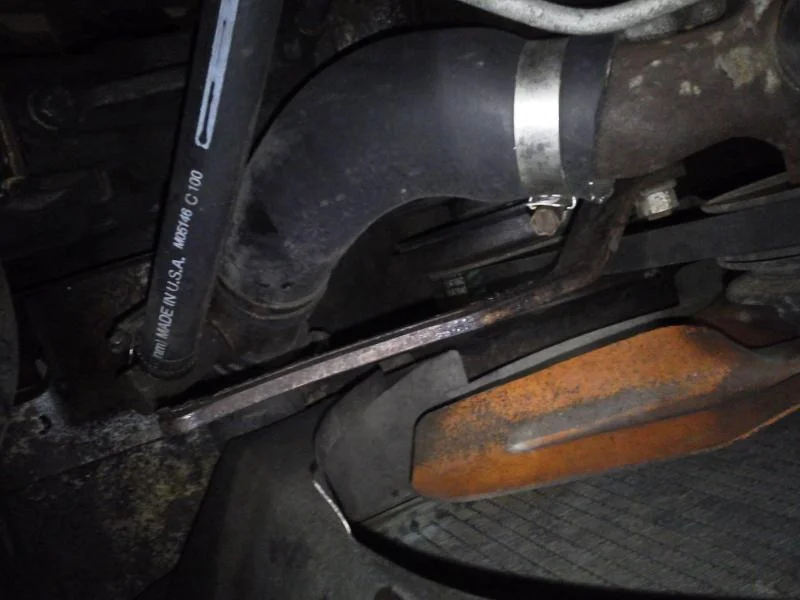

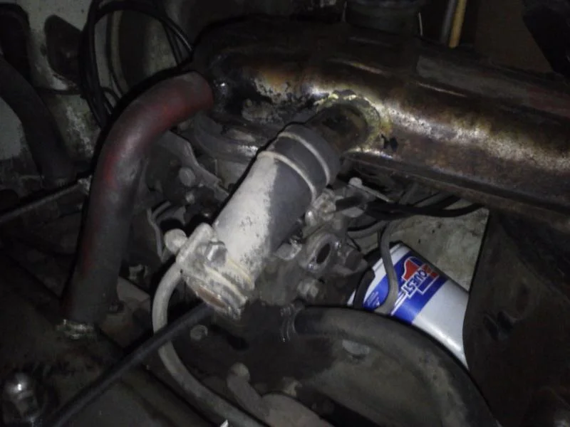

In the third picture the hose coming off the filter housing is plugged with a cork. I doubt this was OEM so where is it supposed to go?
Something in the first picture that was mounted to this random bracket?
During a previous respray they painted the radiator screen white. :doh: Just the two screws to get it out?

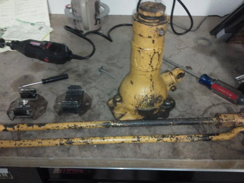

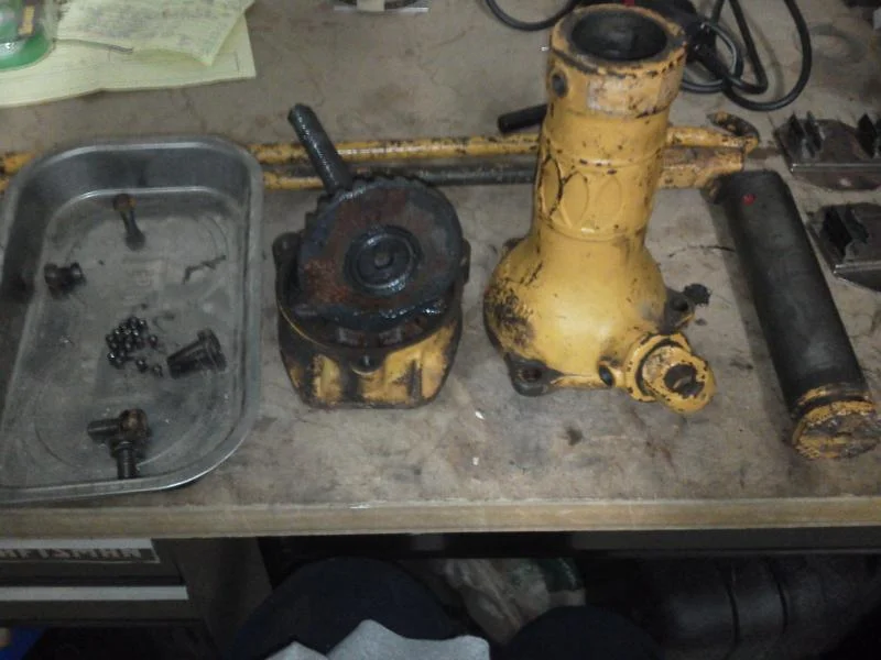

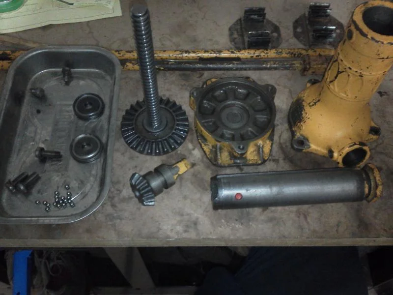

Then because it was midnight and I wanted to do something that I knew I couldn't screw up I took apart the original jack. Cleaned it all up. Now I just need to get grease and paint tomorrow to make it perfect. Thanks to Zags for his pictures and the inspiration.

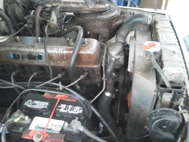

Take some pictures a little further back in the engine bay to help orient us to what you are looking at. Those pictures are giving me vertigo...

Here is a farther back picture. The close ups are in the first set of photos. The hose in question is at the 11 oclock position and is plugged with a cork. The random bracket is down at the 5 oclock position in the photo by the fan blade. So where does the hose go and what was supposed to be on the bracket? Thanks!

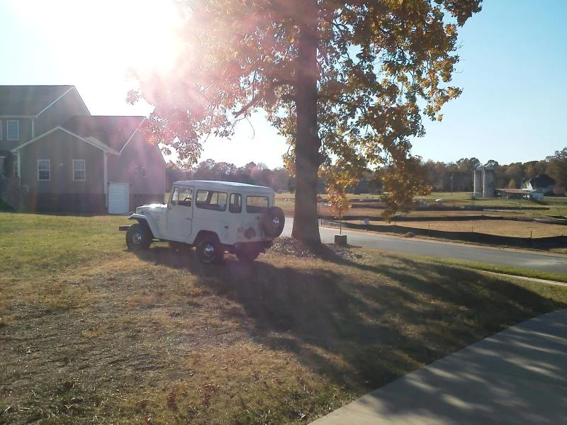

I took Herman out for another quick spin today in the neighborhood. I also replaced the air filter because I had five minutes and wanted to get something done. I think on Monday is when I am going to replace all the fluids and the oil pan gasket. So here are some pictures of Herman in front of what is allegedly the second oldest Hickory Nut tree in NC.:eek:

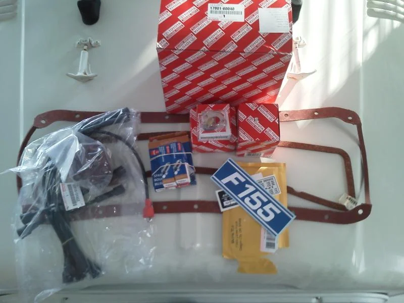

Last week I got the spark plugs, wires, distributor cap and rotor replaced. I ran out of time before I could get to the fluids and the points. So this week my time off will be used replacing the fluids, points, and adjusting the brakes. And hopefully getting it registered so I can finally drive the 40 around town. If all that happens by Wednesday then it will be off to get a new exhaust and muffler put in. Yay!
Your bracket and hose was for emission items that are now gone. Smog pump was attached to the bracket by the fan and I believe the air injection rail was attached to the air cleaner housing. Mine was all removed o when I got it but that's about as much that I have found out so far.
Thanks for the information FluByU. I didn't realize they had emission controls back in 1973... I Don't think that will be a problem here in NC considering the vehicles age.

I always thought that the air pump (smog pump) was always located on the driver's side of the engine, mounted low. But maybe in '73 it was mounted on the passenger side? Interesting...
