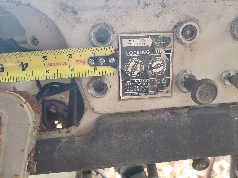

It's funny, as much as this rig is modified from original form I still have a soft spot for originality. Got myself a reproduction warn hub sticker and just had to get it in the same spot the dealer installed it on the parts truck.
And Voila...Close enough! Also, I started on the dash switches, that is the wiring for the light switch.

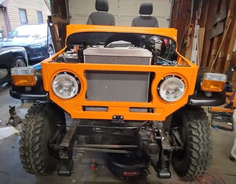

So by this time the truck started on the key, ran, and yard drove. So I took it outside to make sure it shifted into drive and reverse correctly and the brakes worked already etc etc...probably was about time to clean the shop too. Take note here of how bad the front clip actually fits, aprons are too high (or tub to low), fenders aren't flat, hood overhangs the bib by at least .5"...among other atrocities....

Looking at your pic , it look like the rear sill is too high , it should be about 1/2 to 3/4" above the rear bumper
This could be why the front clip line up is bad
You acually nailed it, good eye. I'll update my battle with body alignment from this past weekend.
