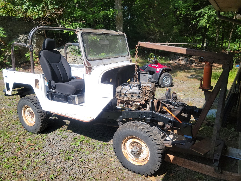

So right about the time I stopped updating the build thread, I put the 40 into storage anyway :meh:. I was spread pretty thin at the time and wanted to focus on wrapping up my 63' Ford, which was a lingering project for years. So the 40 got dragged onto the trailer and tucked away.
I think it was tarped on my trailer for a little over a year...But the '63 came out awesome! This thing is now my weekend go-to driver, my wife and I have put probably 20k miles on it the last couple years.

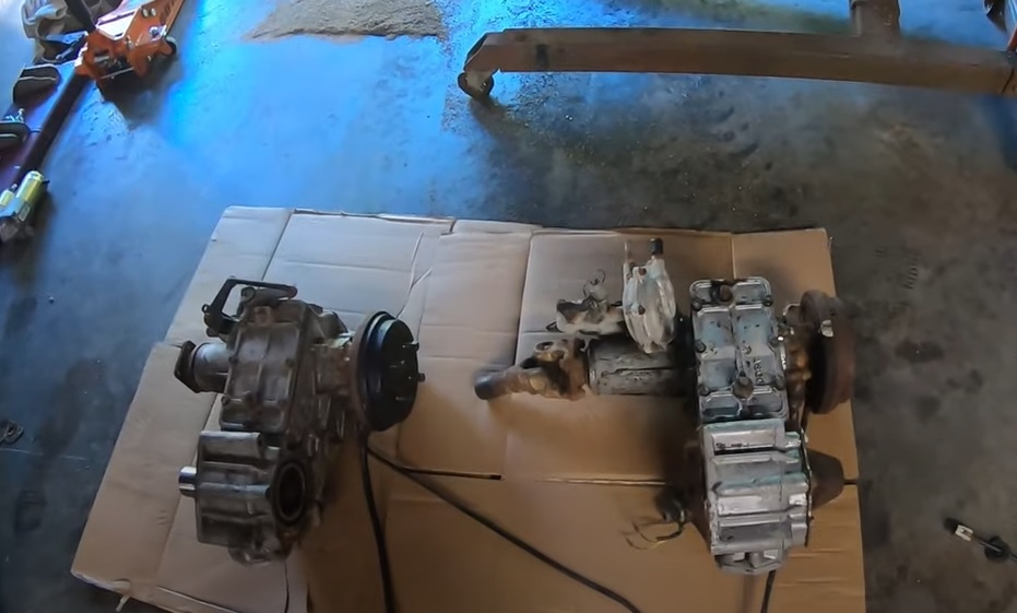

The Tcase ended up being a problem. The 4x4 shifter portion was frozen and garbage. I ended up yanking the case out of the parts truck, taking both apart, and building one functional case. This was quite the saga and is well documented in the video on my youtube channel. Anyway, once I put the drivetrain back together I decided to ditch the original 4x4 shifter assembly and faricate a twin stick:

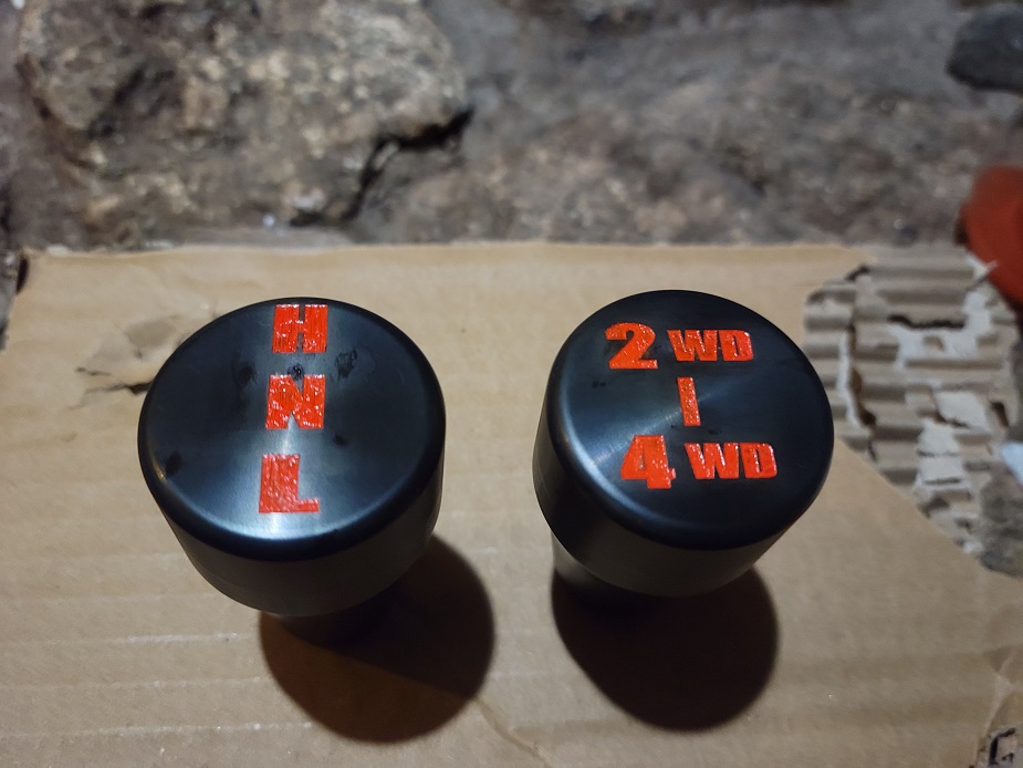

It's similar to other available kits. I just didn't feel like waiting so machined all the parts and built my own, it works perfect. I did buy these nice shift knobs though, then painted the inlays orange:

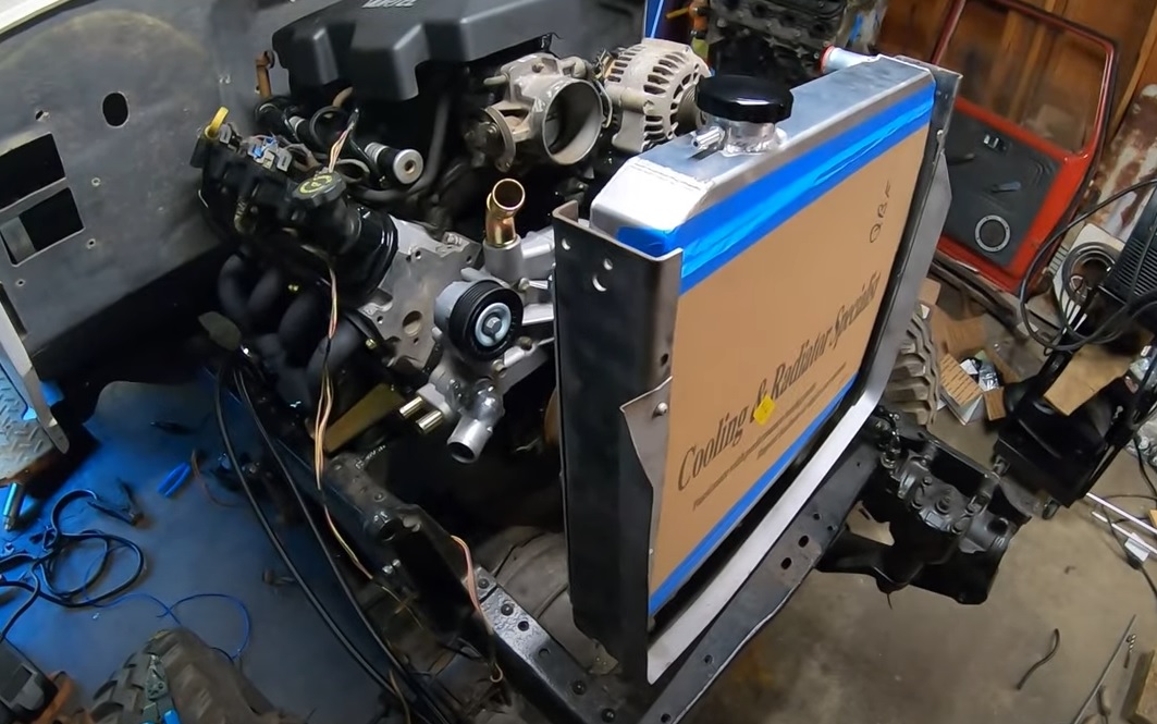

Anyway, with the list of items needed to yard drive getting smaller, I bought a 3 row aluminum radiator and mounted it up in the factory support. This one also has a trans cooler built in so I fabricated AN lines and ran them through the frame rail from the trains to the rad.
So, I wrapped up some odds and ends like radiator hoses and Power steering AN lines. I ziptied all my wiring out of the way, bungee corded the PCM to the fender, threw the front clip back on and ripped Jordy around the yard!

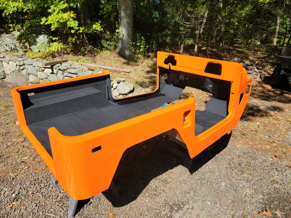

And topcoat done! my favorite color is Orange and although it looks bright in this pic, it came out perfect!
I've painted a few cars now, but this one came out the best of the for sure. Practice makes perfect I guess. Anyway, the party wasn't over yet. As soon as the paint dried I taped it off and sprayed the interior and firewall with lizardskin sound deadener:
And done!
I couldn't be happier with the way the tub came out. It's definitely the most rigid Mallotte tub out there. I added a TON of fiberglass too it all over the place, not to mention the aluminum and SS plates I glassed into it in all the critical areas.

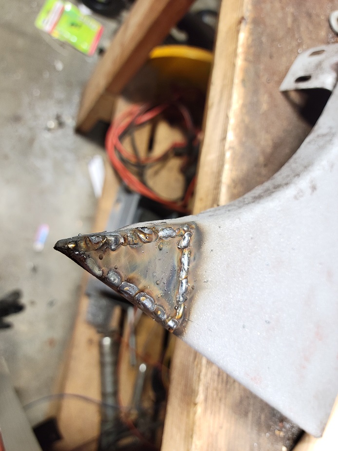

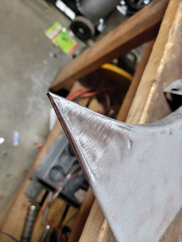

So with the tub complete I needed to take care of all the front sheetmetal. I had decided to ditch the OE fenders I had since they were trash and buy a new set from CCOT, but they hadn't arrived yet. So I went ahead with the windshield frame, hood, bib, aprons. I did a lot of sheetmetal work on all those parts to get them right, but a fun example was the front of this apron...it actually turned into a hilarious mistake that I put so much energy into these aprons, ill explain later lol.
Anyway, here's some rust repair progress. Gotta love recycling OE steel.
Multiply that effort by 100 and you've got a rust free front clip! :rofl:
