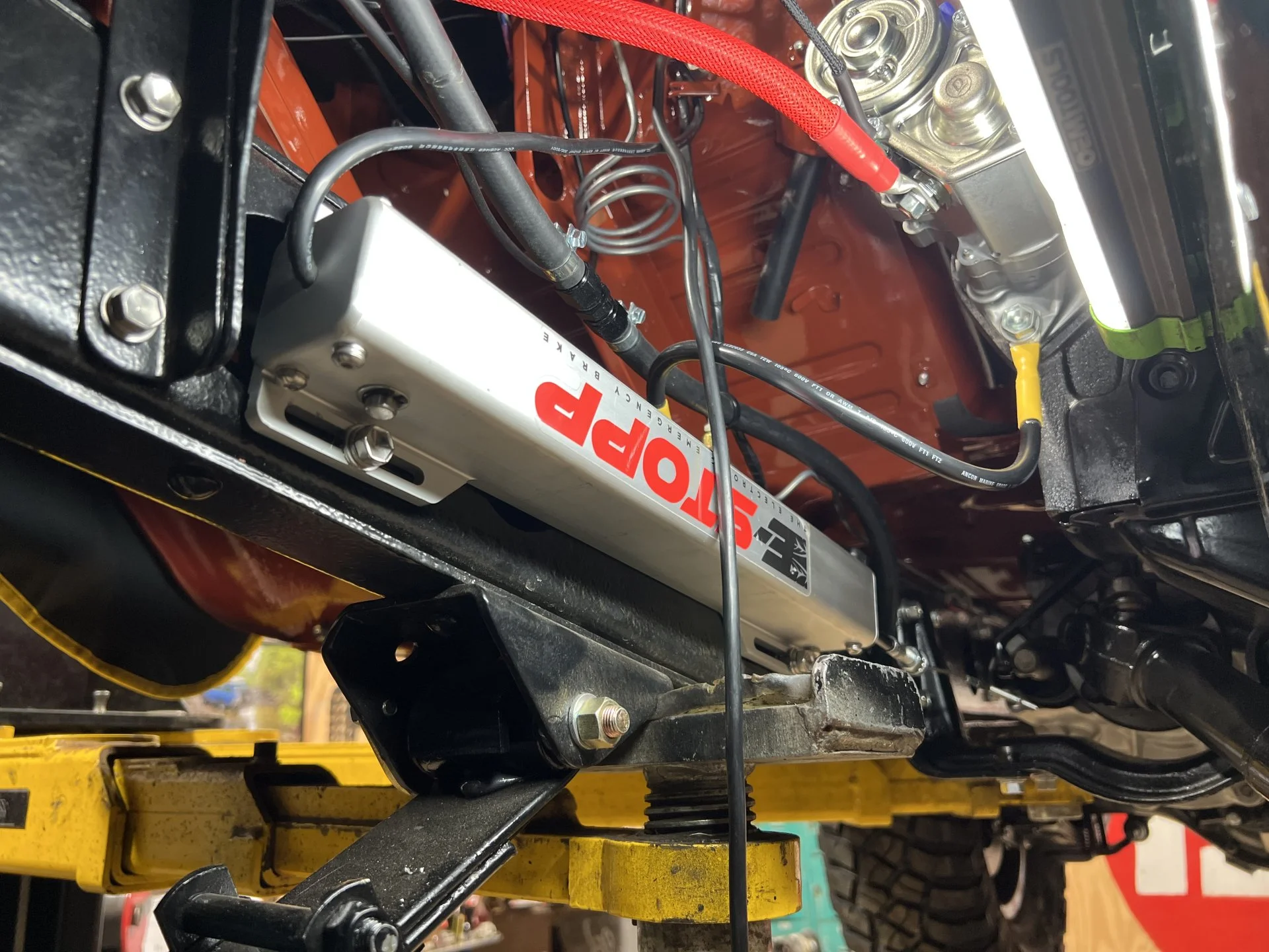

I worked on the E-Stopp setup today.
The only place with some empty real estate to mount it is on the passenger frame in front of the not used bellhousing frame mount.
I chopped it off and mounted the mechanical part.
Wizard will come out and build a bracket for the cables.

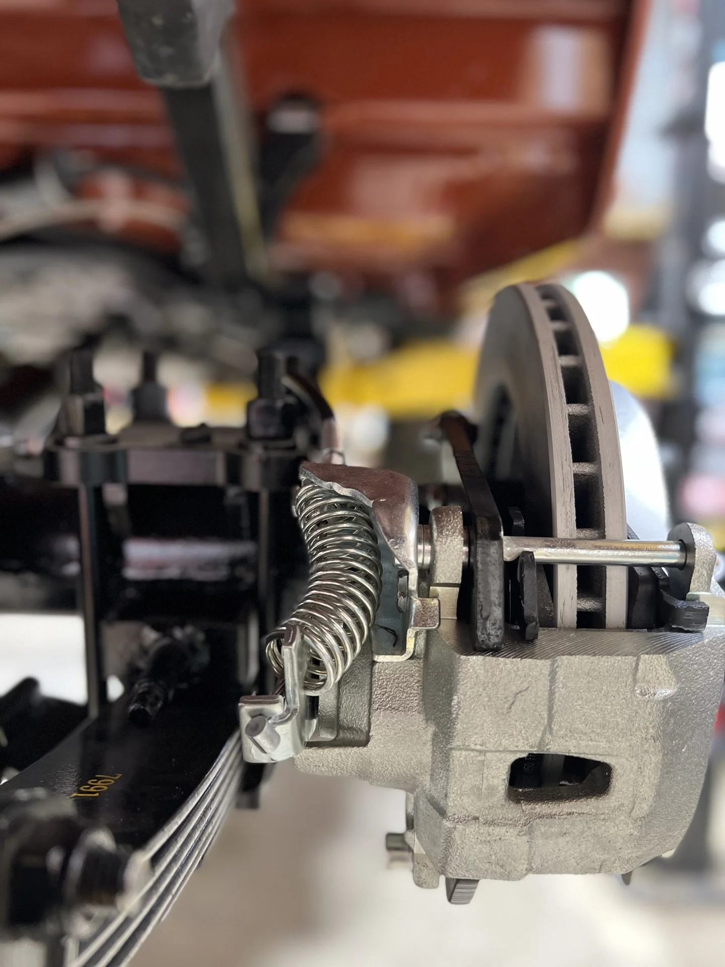

I’m using a Wilwood universal ebrake cable kit and ElDorado calipers.

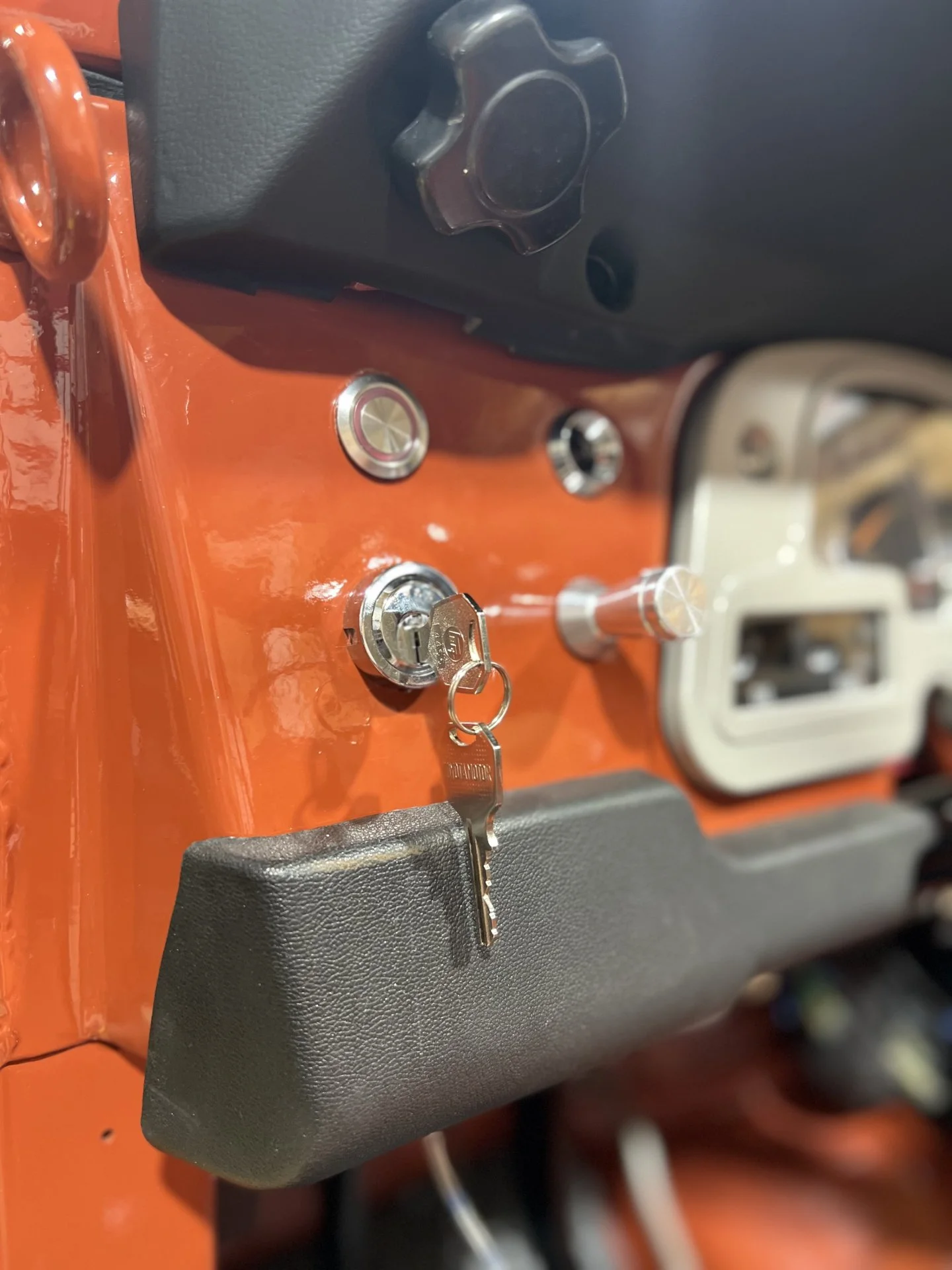

E-Stopp install. This thing is super slick.

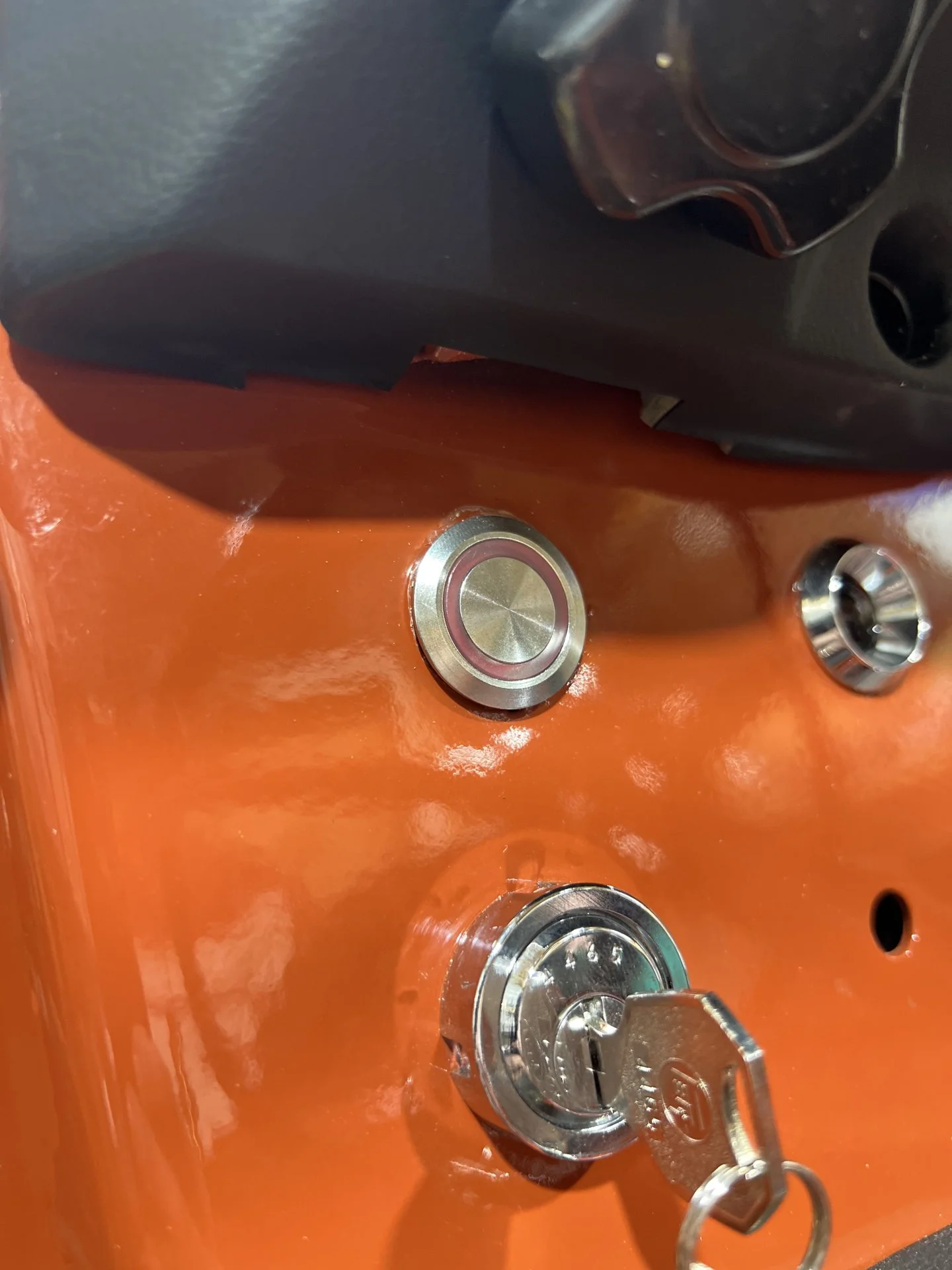

Old Brake light spot on the dash for the button. Same size as OEM.

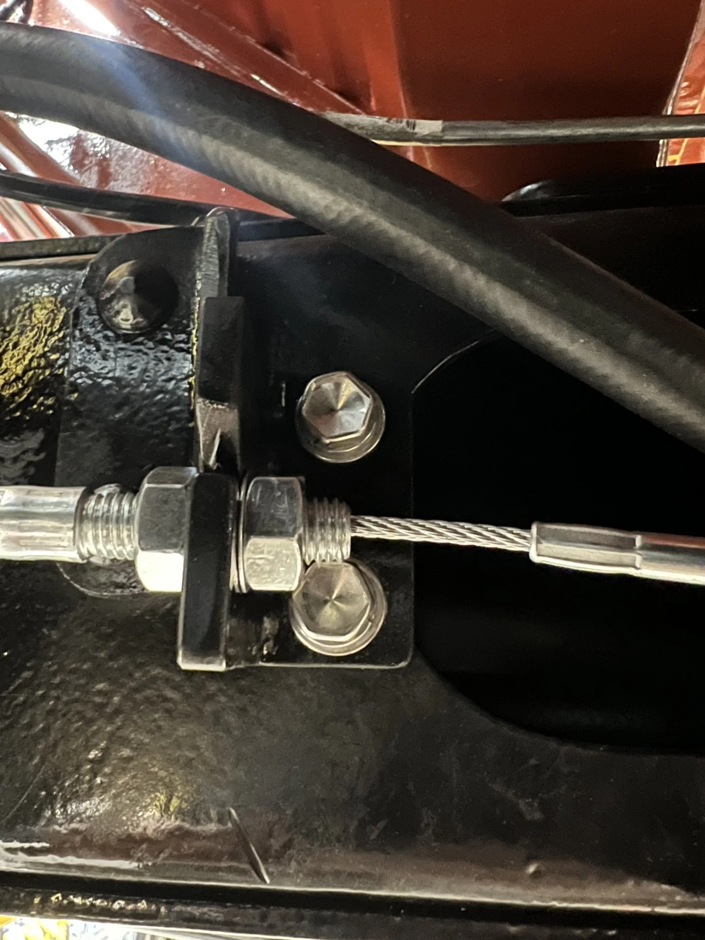

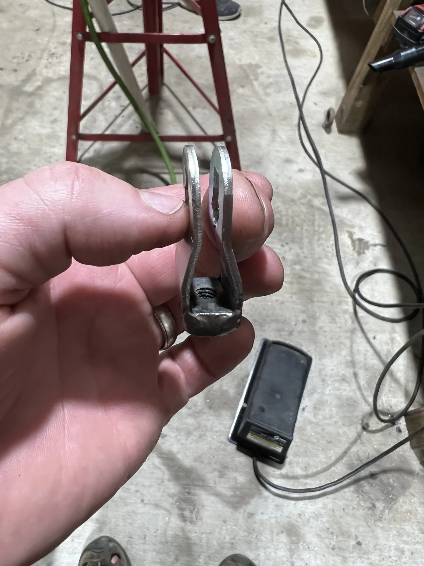

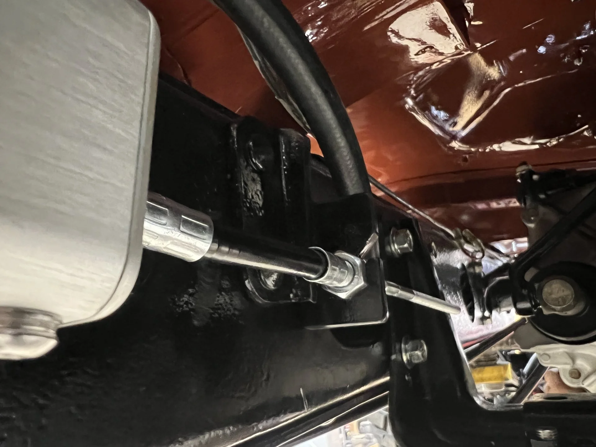

Then I used one of the drum brake cable ends from the Wilwood kit to mate the kit to the EStopp. Wizard tapped a thick piece of metal M6 and welded it in
This is the bracket that takes the real pull on the system. The EStopp itself does not take the pressure on it’s aluminum housing.

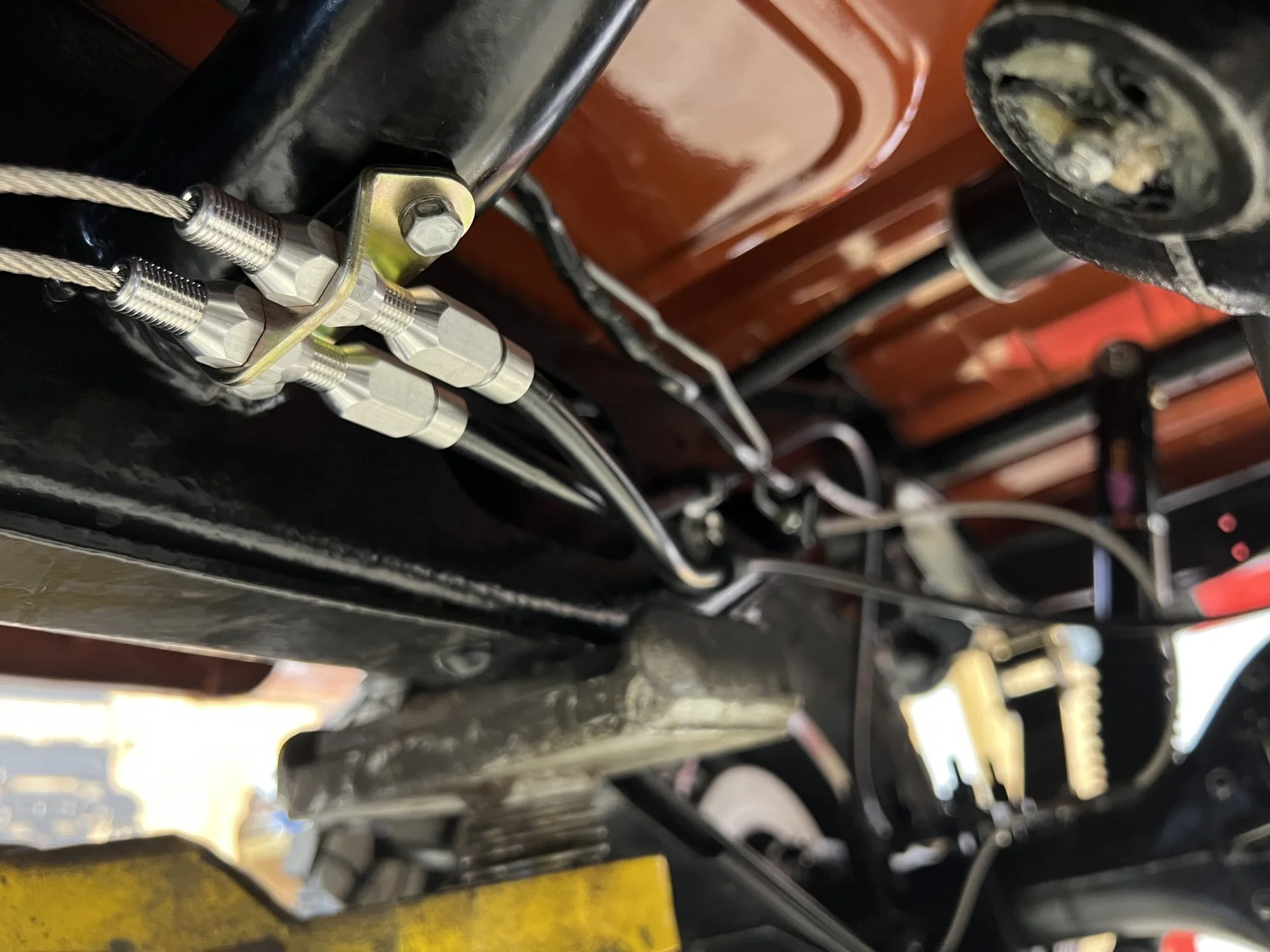

Then we put the cable junction on the torque tube. This just locates the two cables. No pressure.
Another of the pull bracket
Once we got the cable length correct we cut and the Wizard tig welded the ends
Closer of the junction

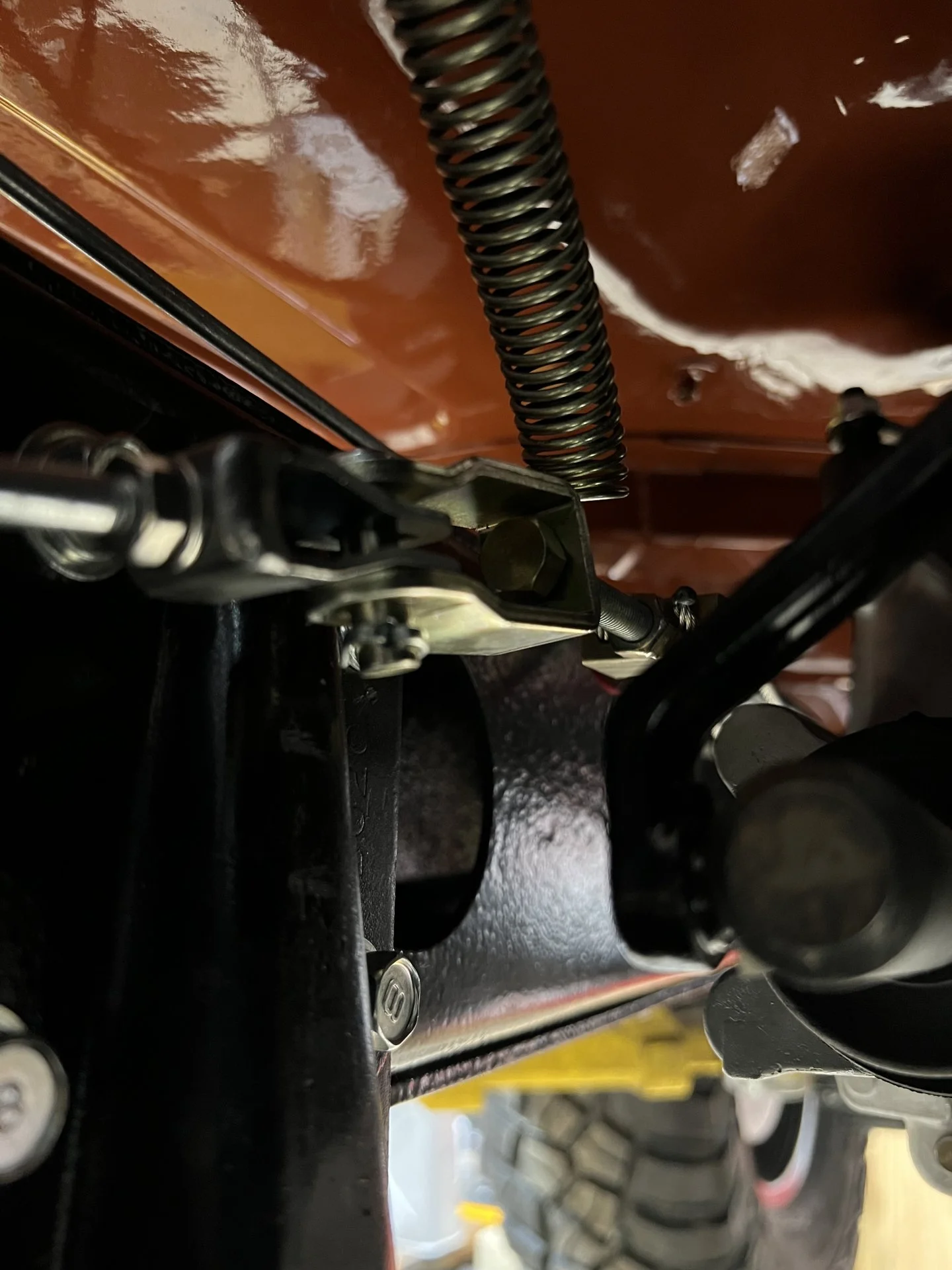

This is how the cables run
From the front. The spring is there to keep tension on the cable when slack because otherwise it will rattle on the crossmember
