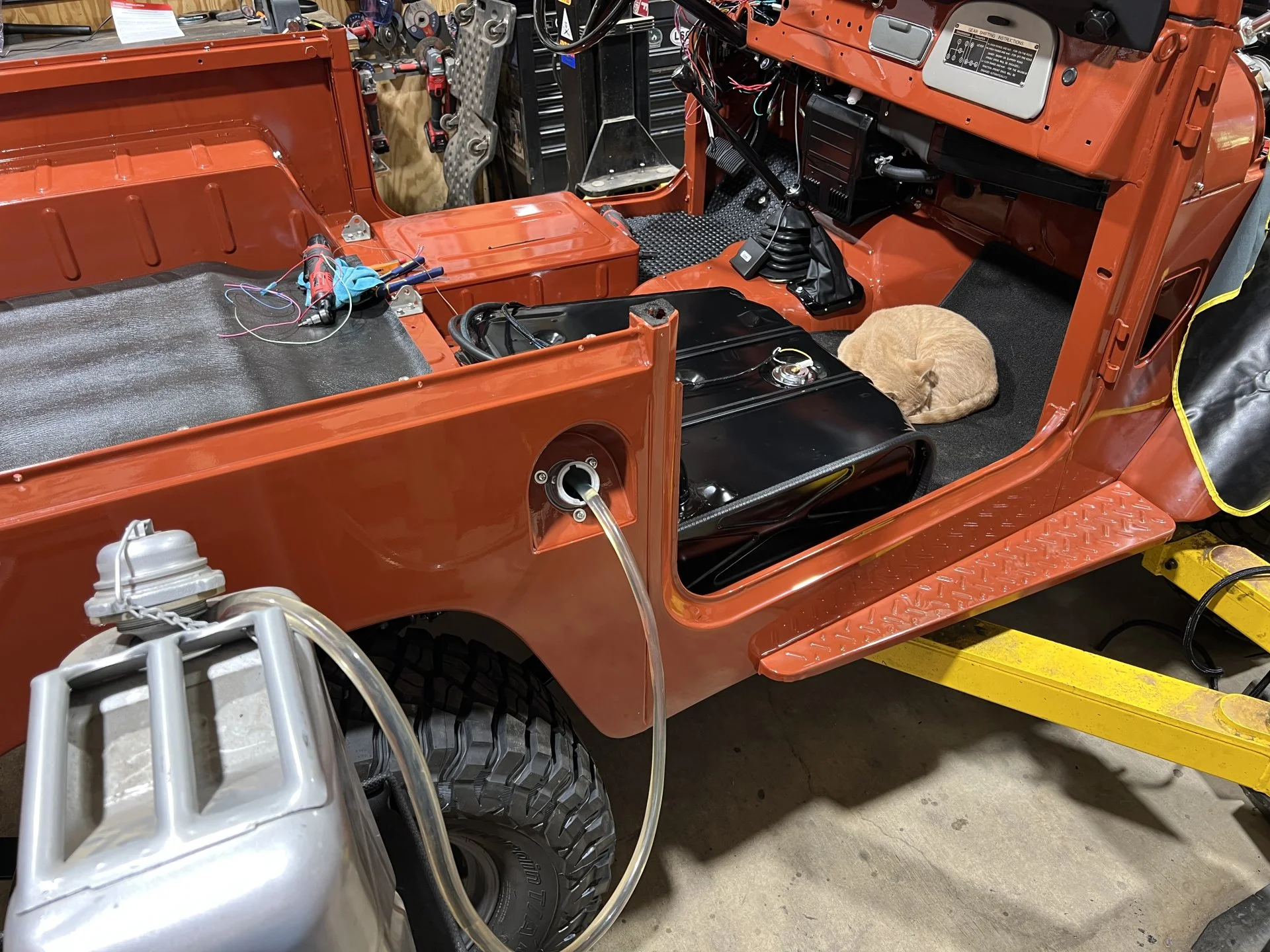

I was about to quit and the FedEx guy dropped some Summit stuff.

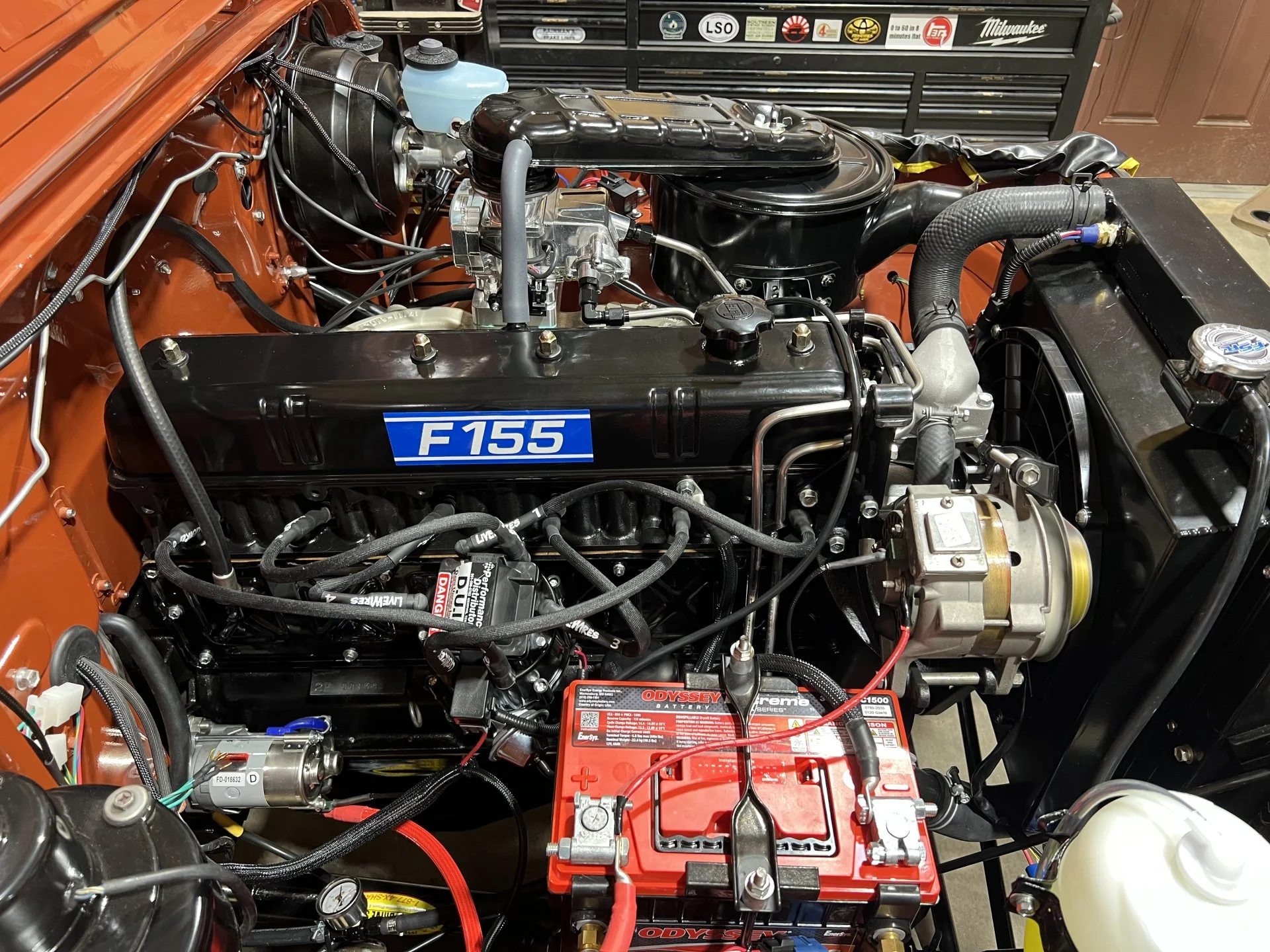

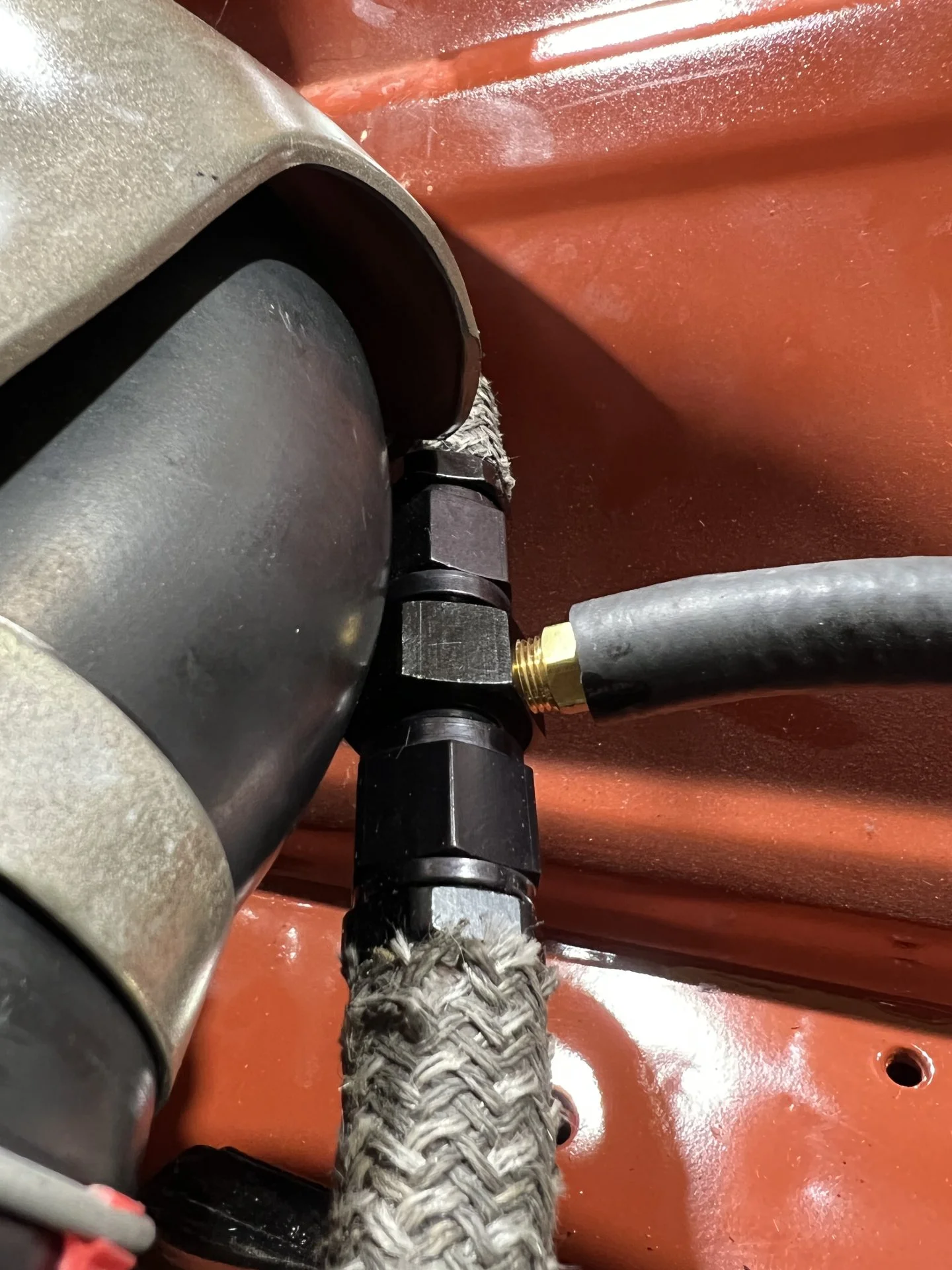

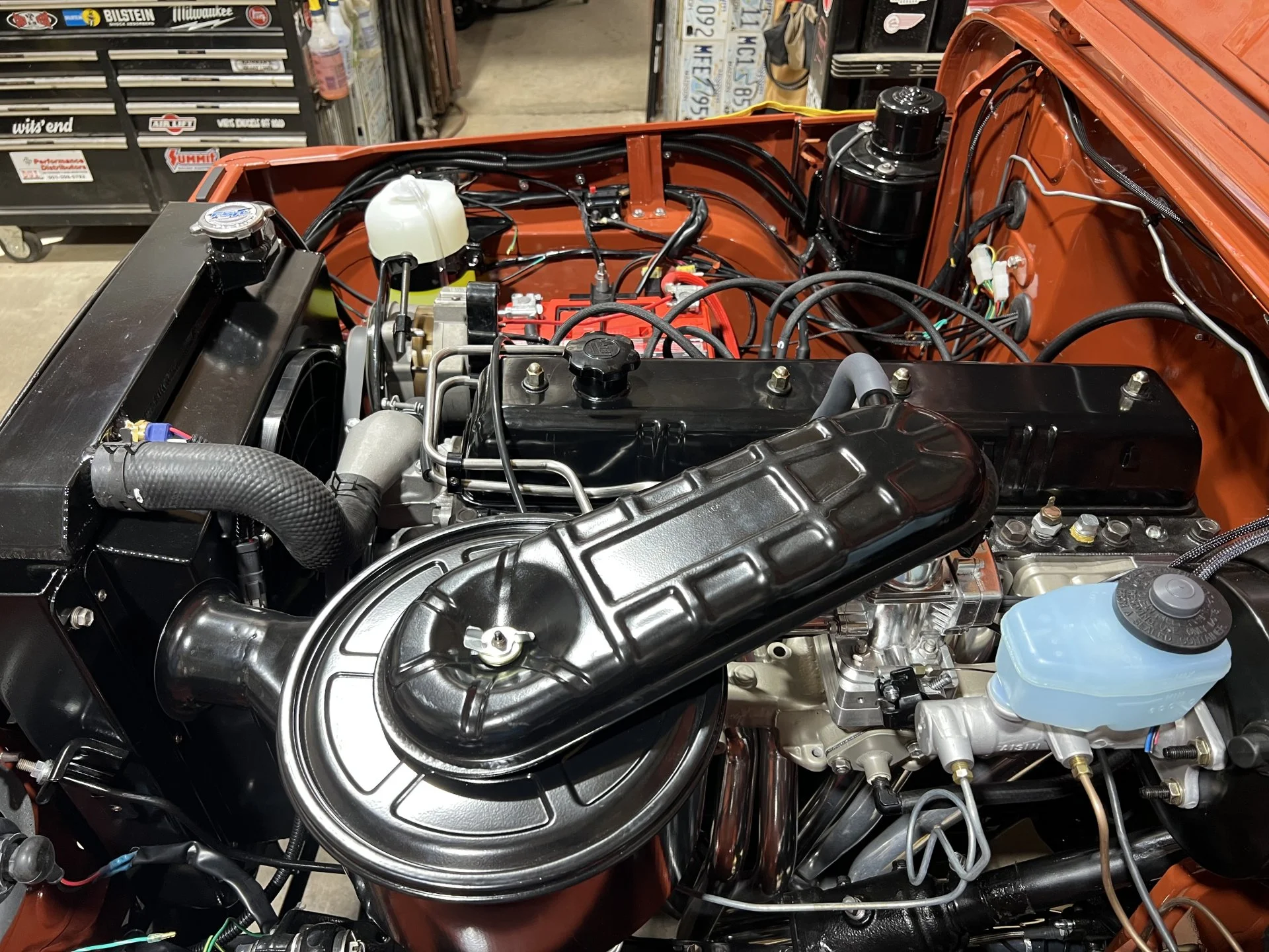

These Mosley fuel pumps have a nice vent. I put a T in the fill tube vent and send it out through the cap.
This is an -8 an setup for the 1/2” stock hose to a 1/8” NPT barb. 5/16” hose.

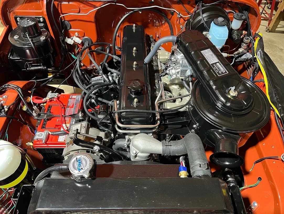

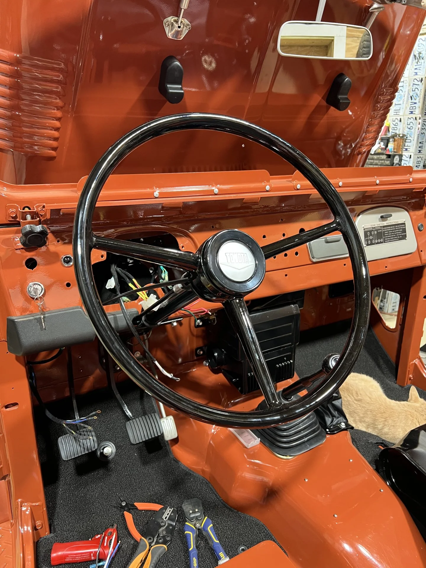

I settled in today for a long week of wiring.
Taking it in three stages.
1) Mate the early Coolerman harness to my setup.
2) Sniper
3) Dakota

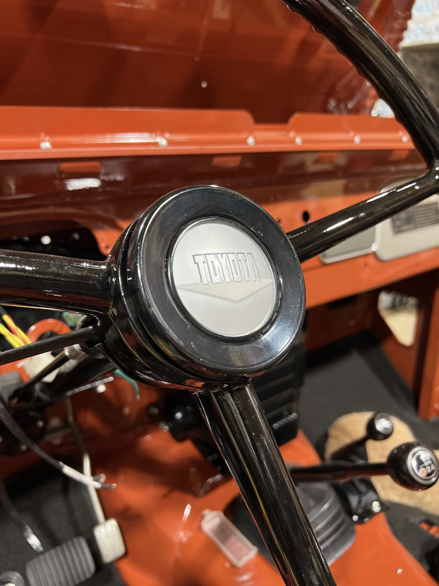

Before I got started I installed this beautifully restored wheel and button via @Birdhead
Thank you, I hope you’re happy w/ it. Remember, any problems and I’ll stand behind my work.
Got some harmony in the hard fuel lines and I’ve not set the Dakota to talk to the Sniper yet but overall I’m super happy with the way this thing sounds.
You are so helping me finish the 45! I am very impressed and that does not happen easily. Beautiful work
Thank you sir.

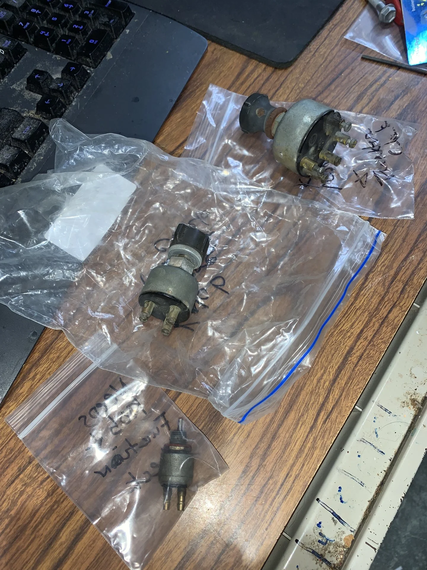

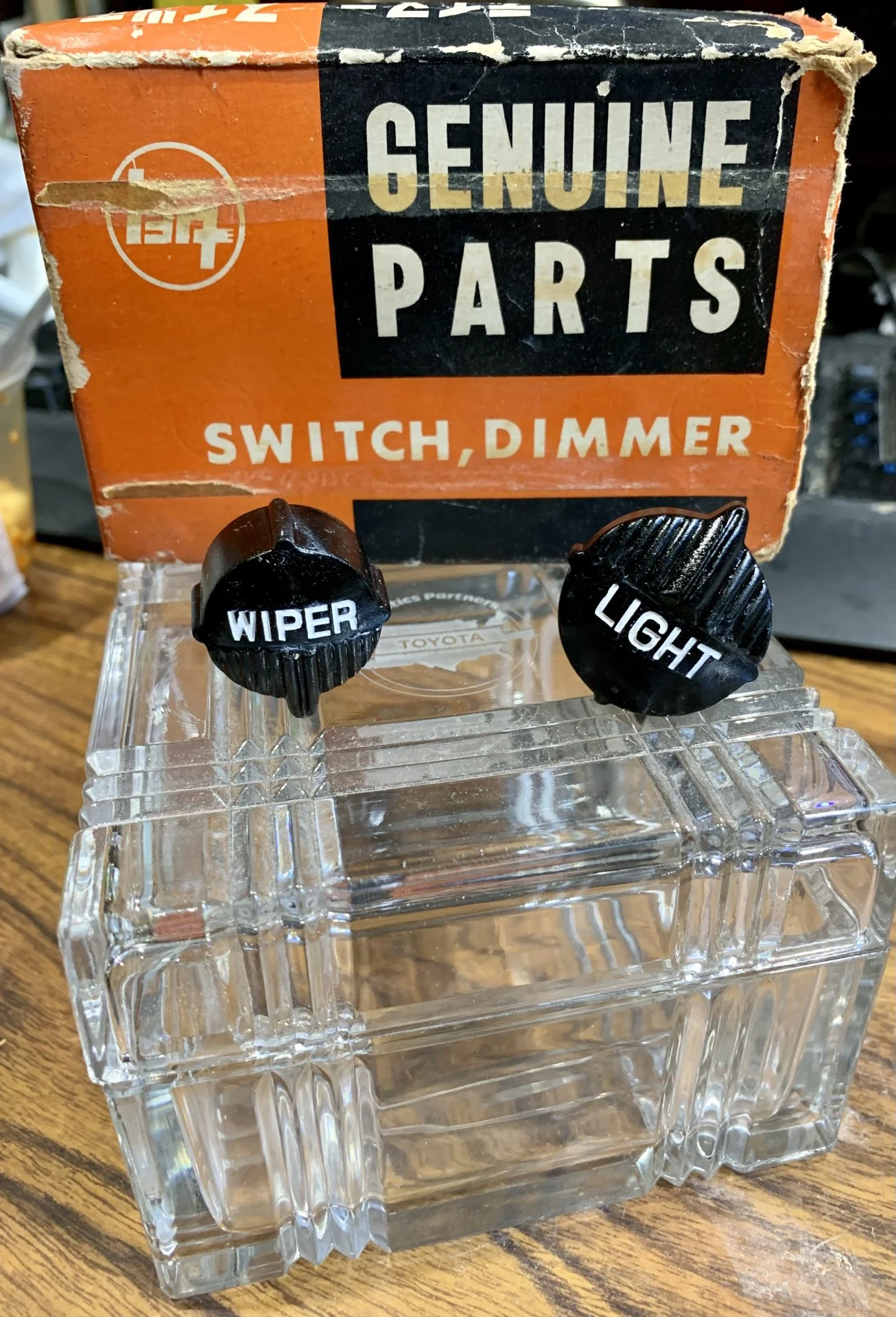

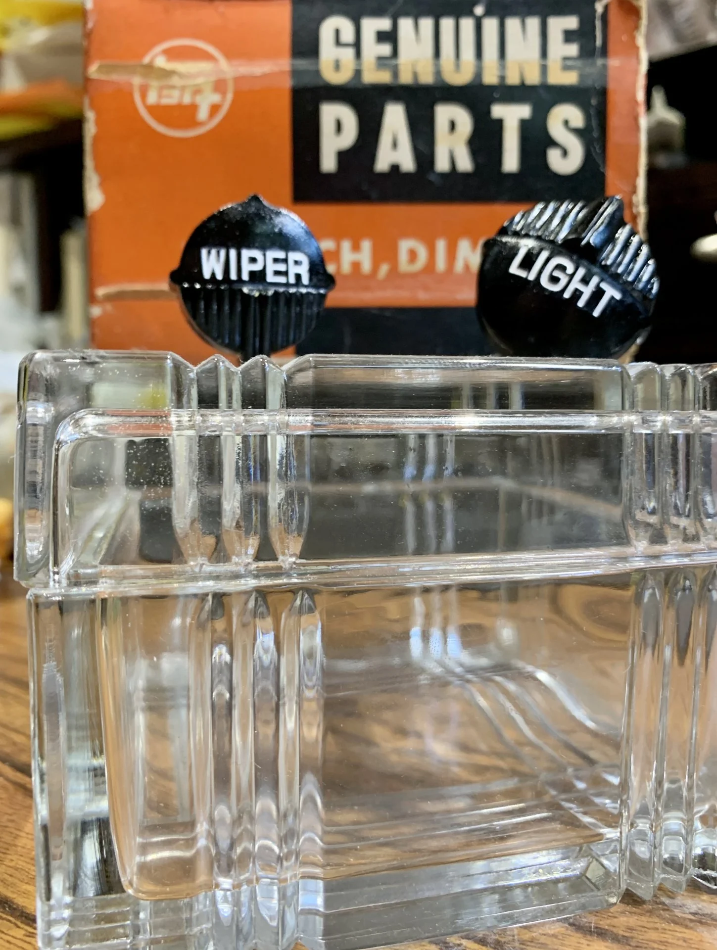

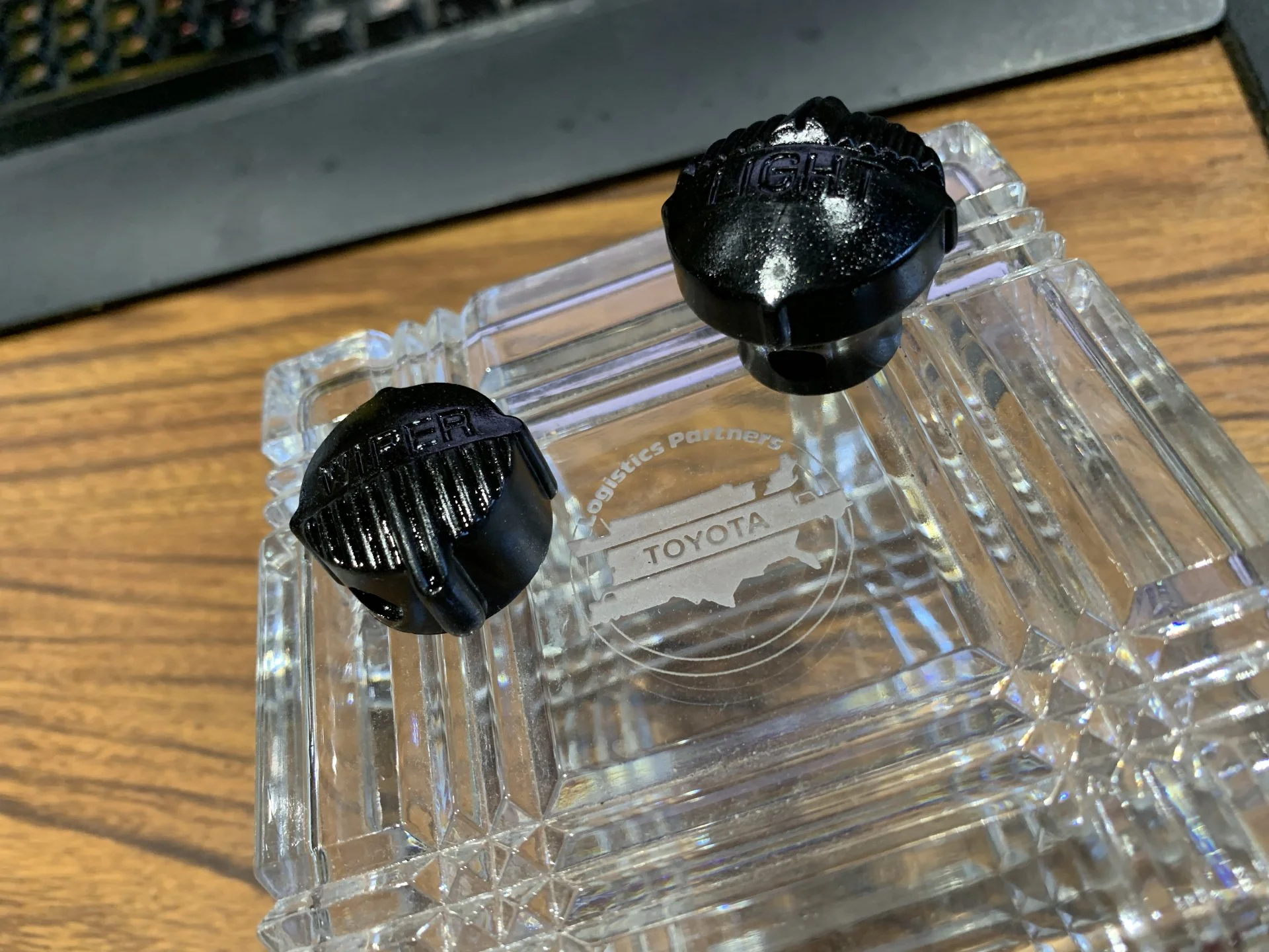

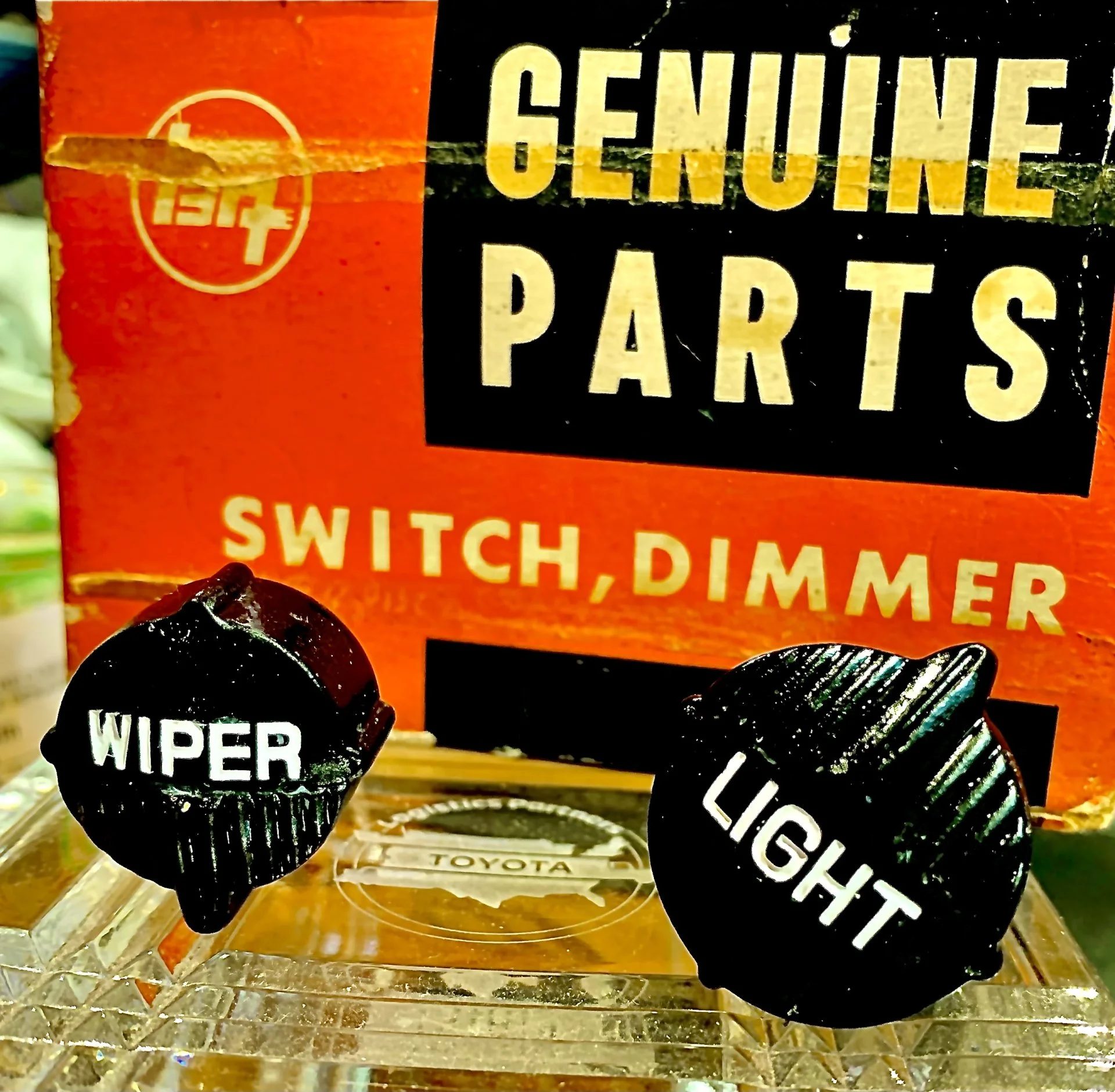

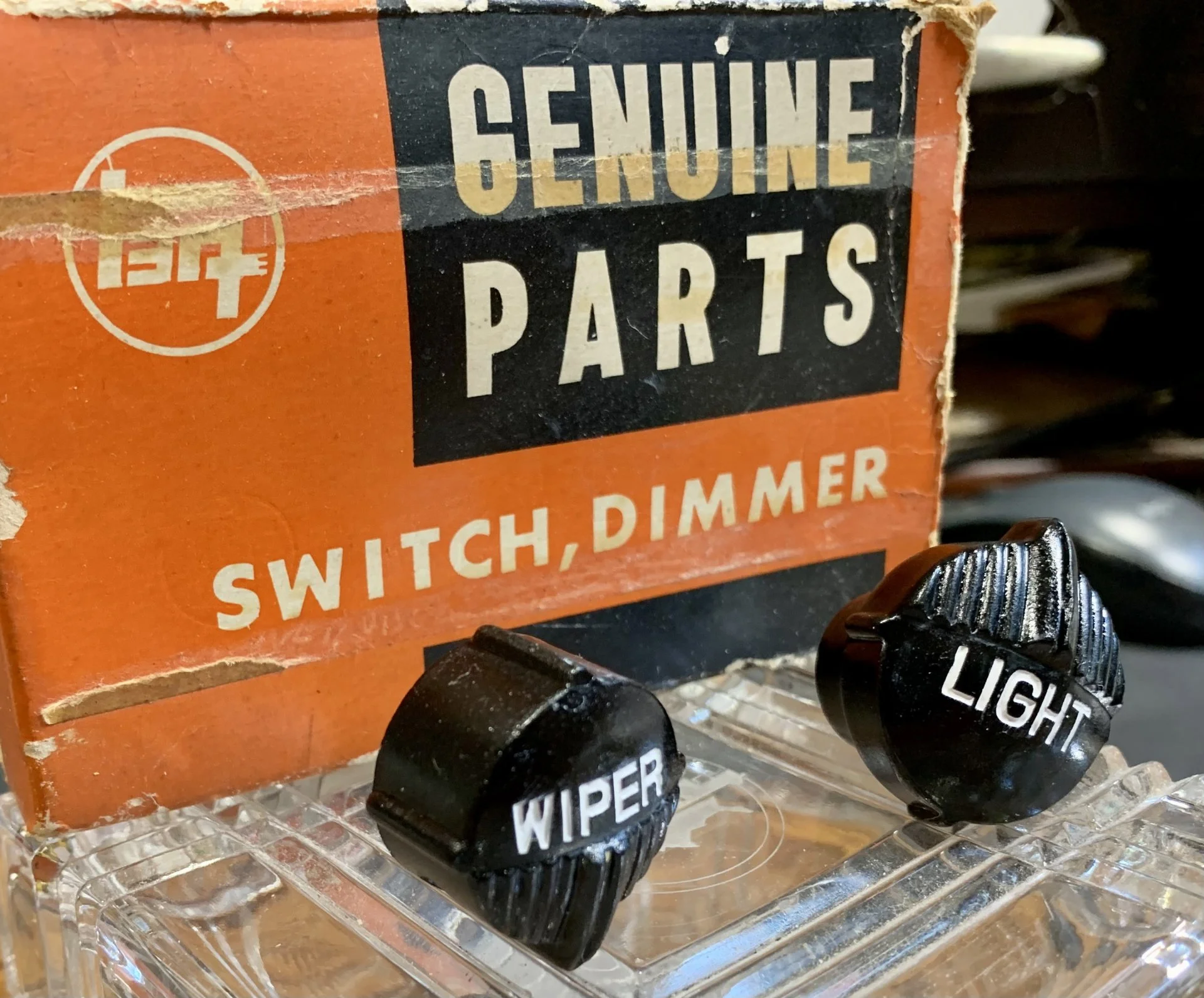

switches , knobs and control cables update :
- SKUNK-WORKS Project Code Name " Operation Rags 2 Riches " .
- Pre-Restored condition directly from @wngrog carefully packed box 📦 he sent me here at the Laboratory …
- all parts hand intake evaluated , bagged and tagged …
- then , all parts hand kleaned to a doctors office sanitary condition level …
- knobs are prepped and ready for the white “ substance “. to be hand applied with a steady eddy hand held device ..
- both LIGHTS and WIPER rotary type switches have had been , FULLY bench tested using a Digital Volts Meter , for correct full functioning across the board ,
then prepped to a day 1 PLANT A-11 conditioning level and special conversion coating applied as well to the carbon based metallurgy only …
- stay tuned , for more exciting step by steps updates later today.... :)
- it only gets better from here till @wngrog receives his overnighted EMS Express mail box of TEq joy
H55F fast very soon …
NOTE
: only 1st or the 3 applications of the White " Substance " has been applied ............fyi

These are really nice. Thank you @ToyotaMatt.
Wow! Just wow...

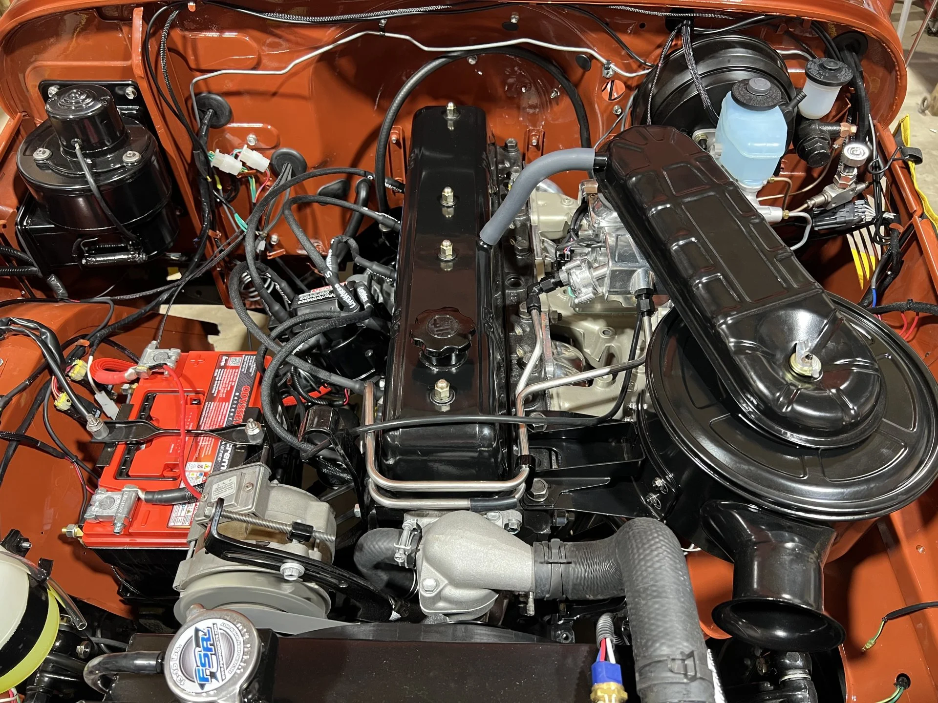

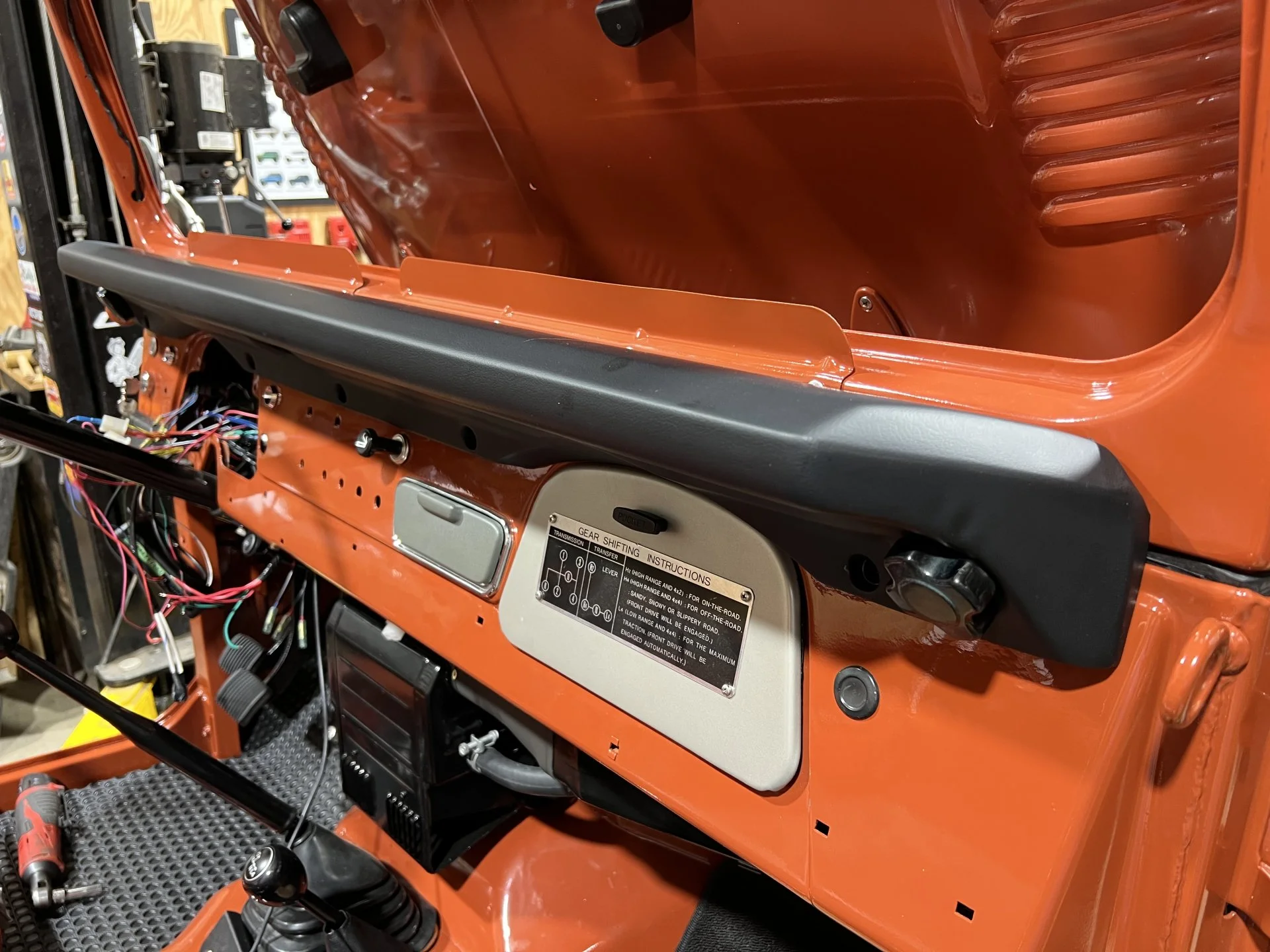

Your have done a masterful job with this beautiful 1972. Extra credit for getting the early harness to work in the 1972! (I think Cowboy is the true brains behind this operation...)
I see that you have not installed the horn relay yet. You may have to mount it to the firewall due to harness/year length differences. On the early trucks it mounted on the innner fender.
Really wish I was able to build you the custom harness this 1972 needed but you have made it work.
