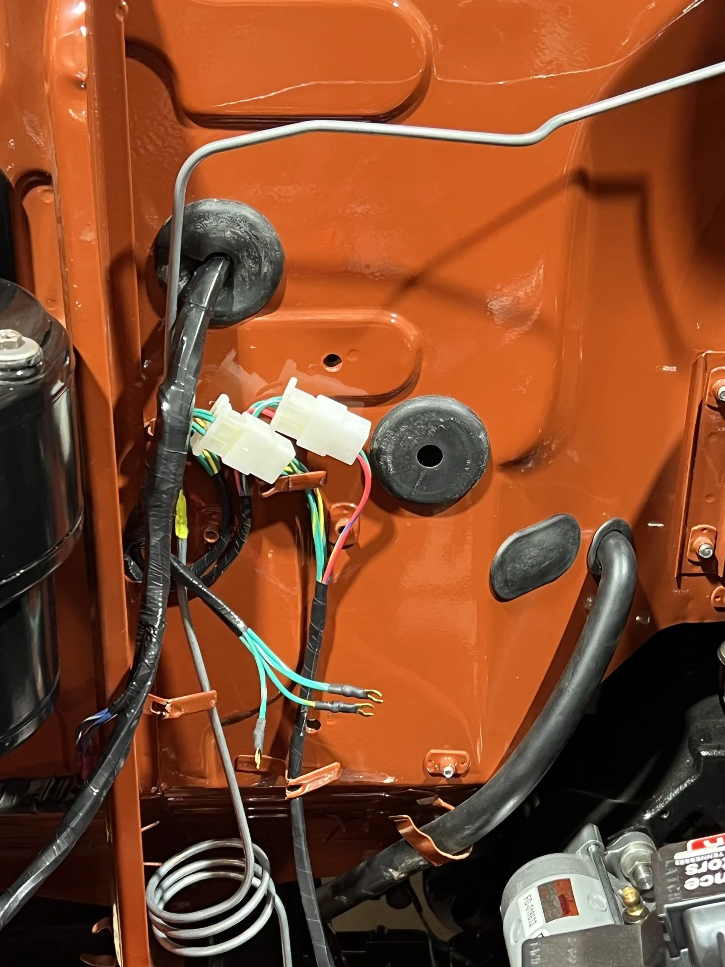

Lots of grommets going in and screws to fill in all these firewall holes. I have a passenger side cowl vent tube but not a drivers side. If anyone is sitting on one please contact me. City Racer is out

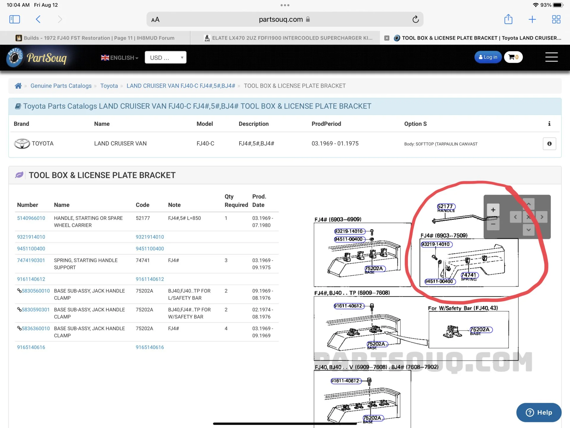

My very original 71 has the same on both sides with bolts in them?( look original undisturbed)
Yep. That’s what I remembered. Big bolts.
Wonder what they were for….
Not sure at all. No idea really
Anything seat belt related should be 7/16-20. I think this is where the jump seat belt mounts, I am going to install seatbelts in the next few weeks so need to figure out exactly where mine go. Any of the auto parts stores will have this size as does seat belt planet. There is one standard bolt in the later roll bars as well. My understanding is that it was a US regulation…..
Back to wiring. Other than the fuel pump the Sniper is wired as is the 1 wire FJ60 internal regulator alternator.
The DUI and the alternator share the same switched 12v (black/yellow) wire designed for the coil.
It’s a lot of wires to be properly loomed at tucked.
Dakota and Sniper wiring.

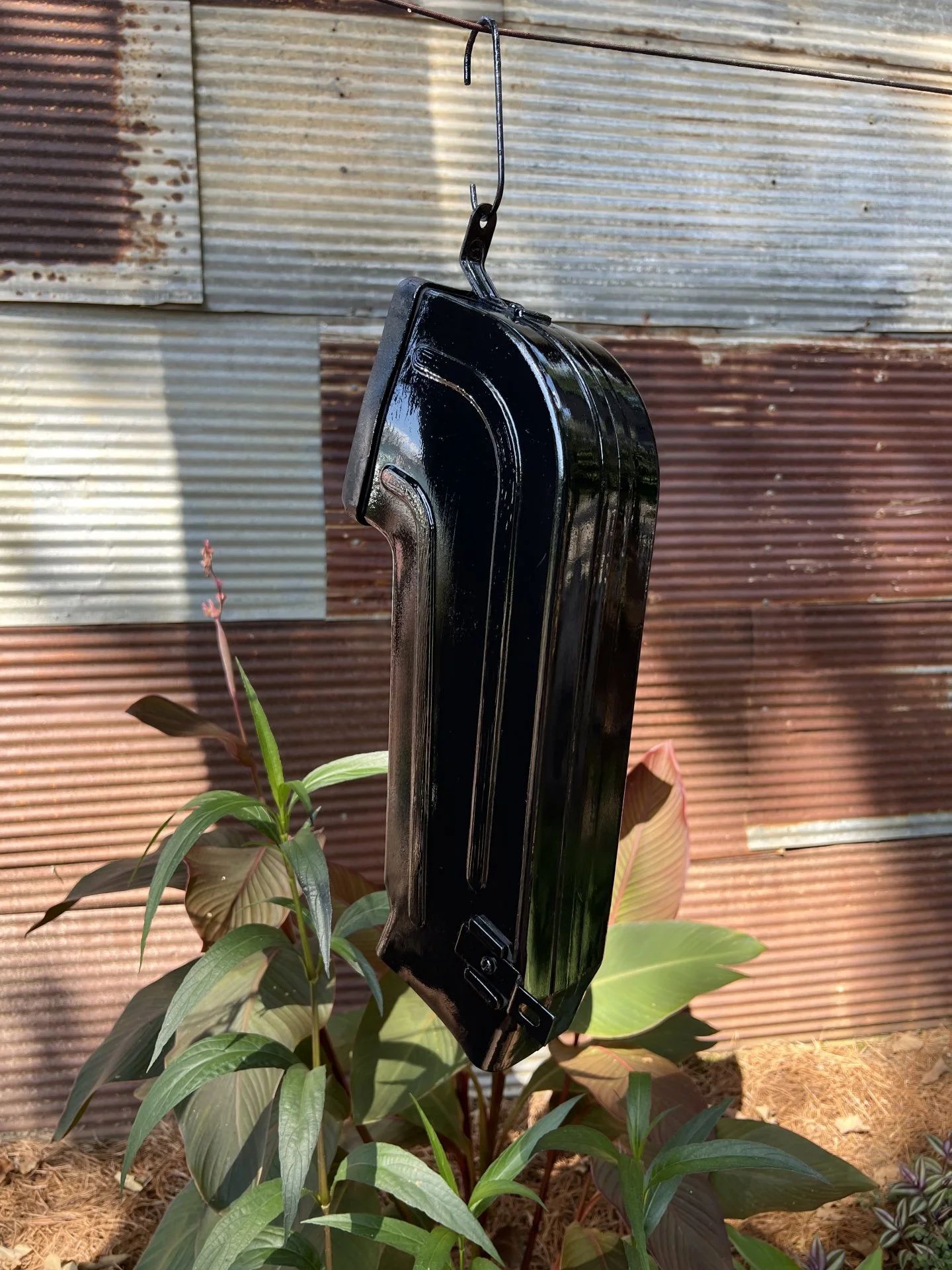

Went to install the blower tube and even though it looked clean off the truck it did not look right in the truck. So I pulled it and hit it with some plastic paint
Yep
