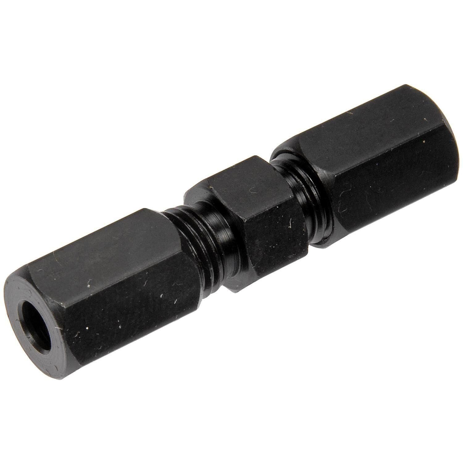

Now I can dig into this job without fear of turning into a weeks long suffer feat. I'll try to get the old soft lines off, but if I fail, I can just put new ends into the existing lines
The things I learn from this forum.
Never use compression fittings on brake lines. Read the info in the specifications on your link. You can use a double flare and coupling nuts with an inverted flare to make junctions or replace the entire brake line.
